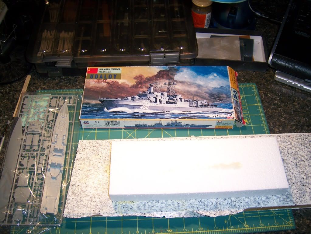

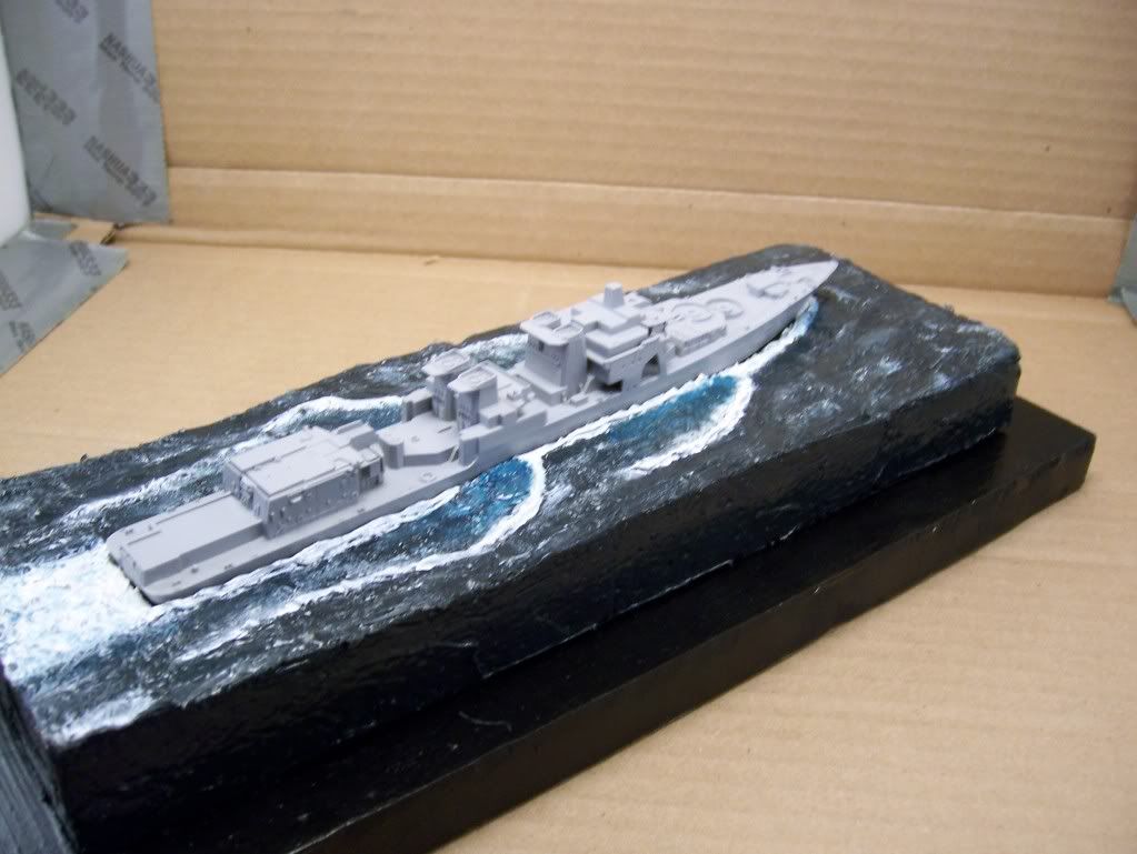

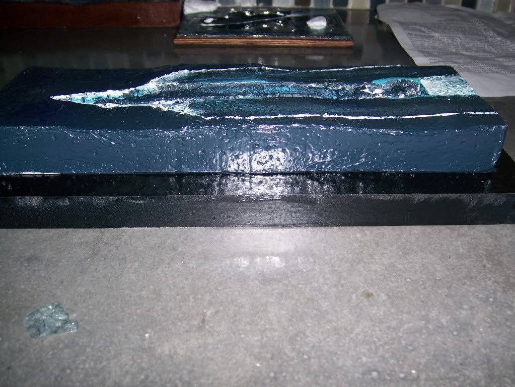

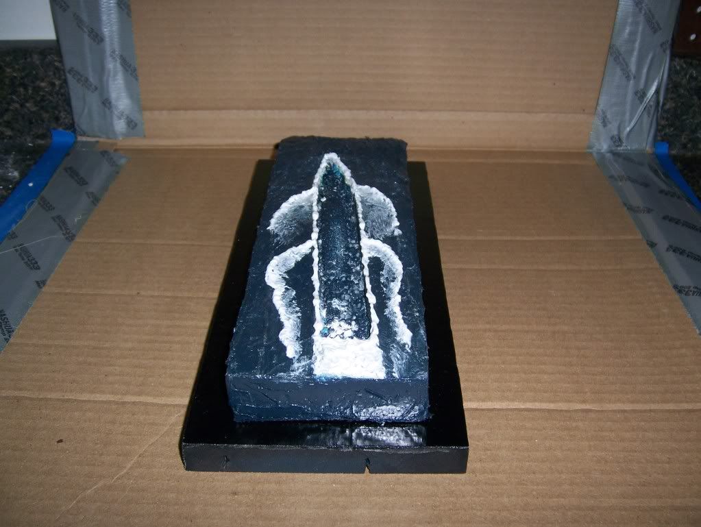

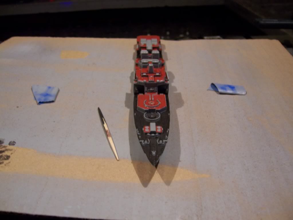

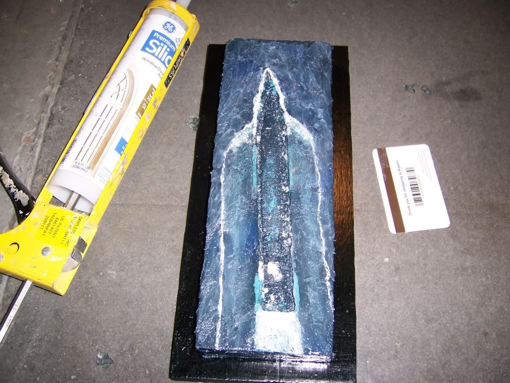

Hey all here is my third ship build it is as stated above. It will be the RMS Admiral Kharmolov 678 of the Nothern fleet picture shows 606 but that was pre 2004. I am trying a new water technique using silicone. Critiques are greatly appreciated.I started this for a GB on MSW.

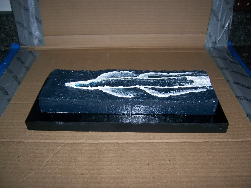

Water Base: Wood base and Foam I want to simulate rough northern waters.
In Port: Building

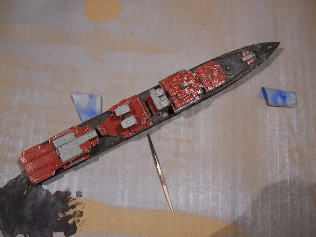

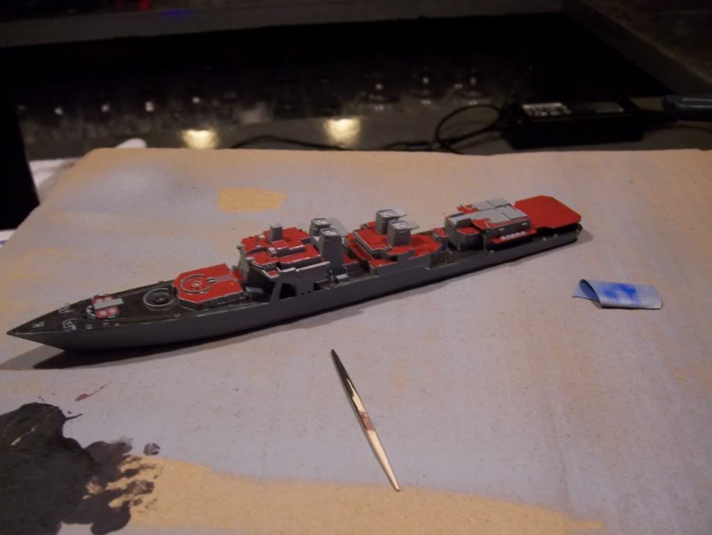

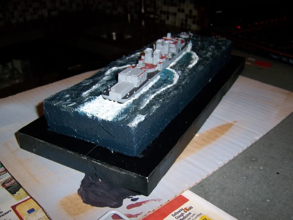

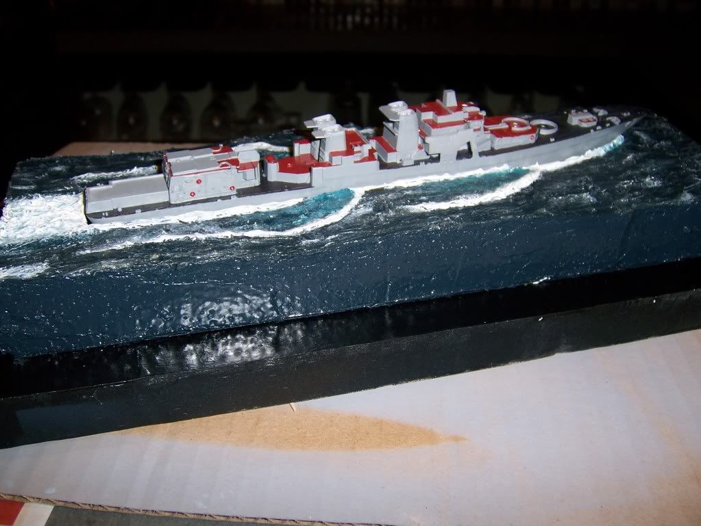

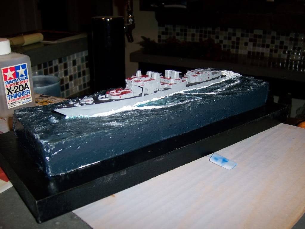

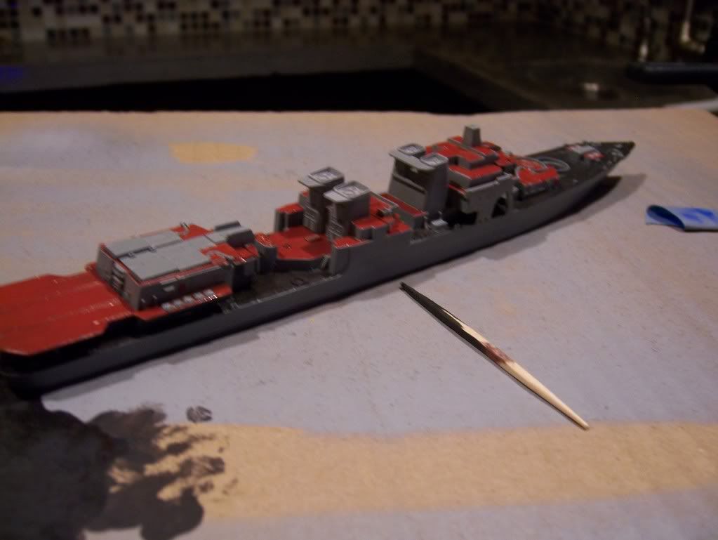

And the Paint job. the deck is black,dark ghost gray,hull red and touch of gunmetal, and top deck is yellow ,red,dark ghost gray. Im not liking the paint job the paint came out a little goopy for some reason and I mixed for like 5 min. Then came out grainy on the model and I used Tamiya grey primer. weird, anyway I thinkk I got the colors almost on compared to my ref pic. critiques are welcomed.

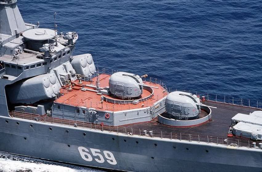

Refrence:

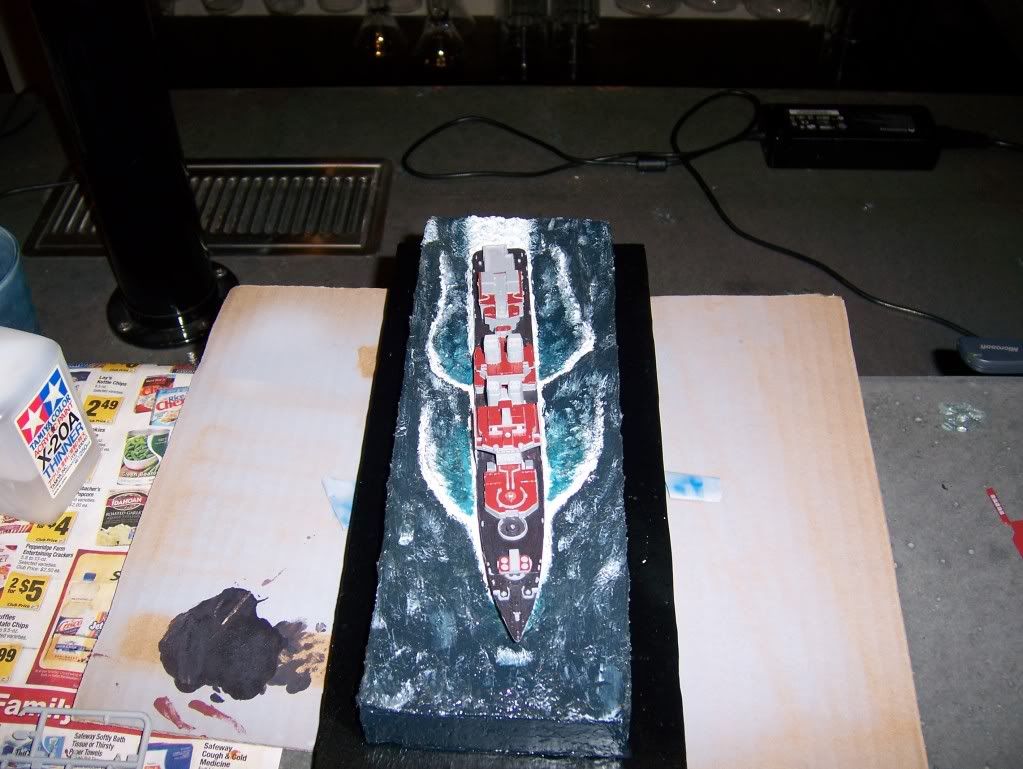

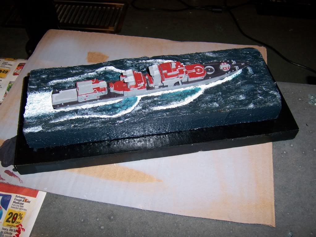

And in water base:

Your water and your ship colors all look pretty good and pretty accurate. There aren't a lot of photos of Kharmolov but it looks to me like you do have the wrong color in a couple places. The hanger roof and the bow SAM launchers both look to be all light gray instead of having a gray and red combo. At least in 2006 and 2008.

Until now you have given you much trouble.
But I think the color information is not really.
The hull and superstructure are dark gray. The main deck is brown leather and the other walk decks have this rusty-orange color.
Pass the water is white (in the original 5-10 cm) and dark red or even green underneath.
What I also found something wrong is the color of the gloss. All decks are dull and the superstructure and the hull are satin.

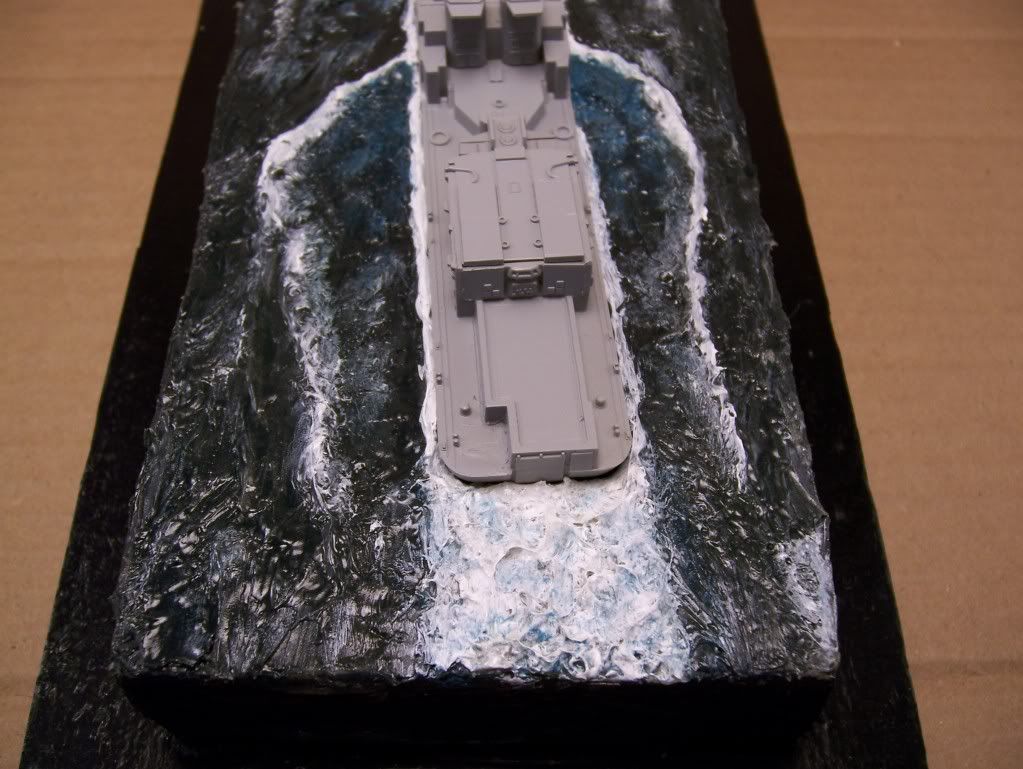

As for your water view, and I shall be the "new" kind of not quite clear?
That with the silicone, there is still a very long time.
The presentation of the waves, you should also look at you again closer to photos.
It is presented with almost a little too intensive.
It is very static.

I did some checking. The model you are using represents the first ship of the class, the "Udaloy." As you have said, the kit doesn't have the cross swords radar you need for the bridge and hanger roofs, which you need in order to represent Kharmolov. What you will have to keep in mind when using the reference pics of the Udaloys, is that ships assigned to different fleets have different colors, and the choices of which color goes on which area of the ship varies from ship to ship, and from time period to time period on the same ship. Good Luck.
