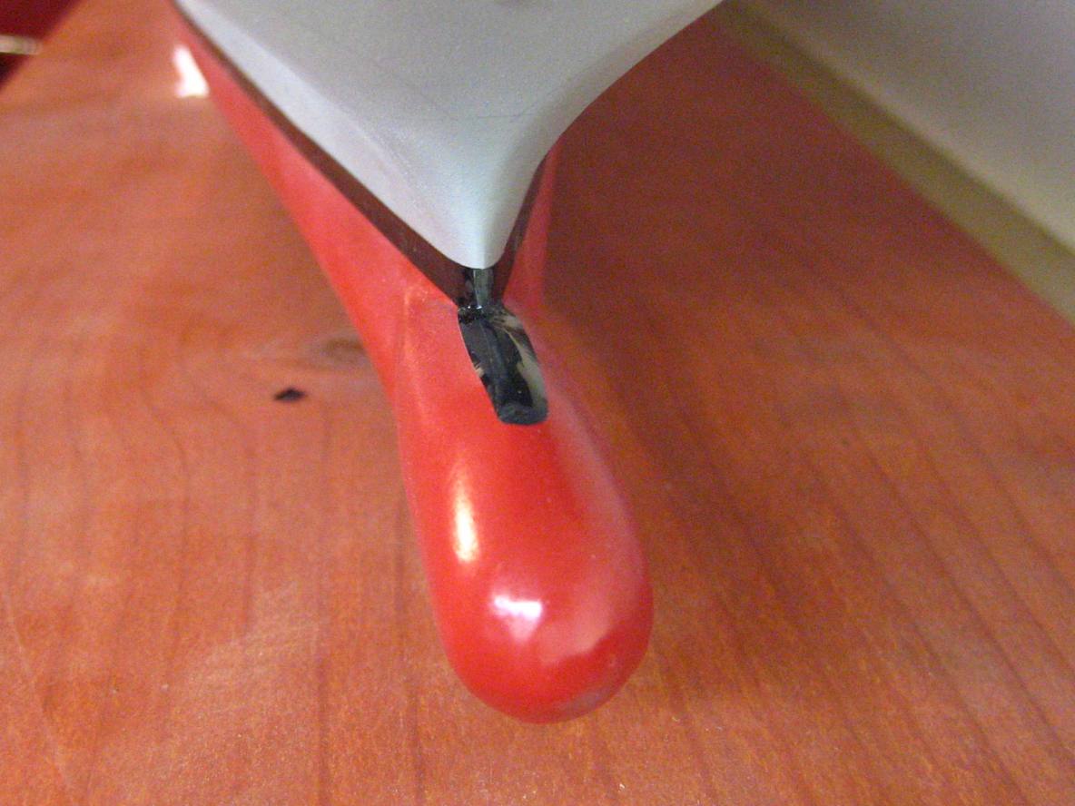

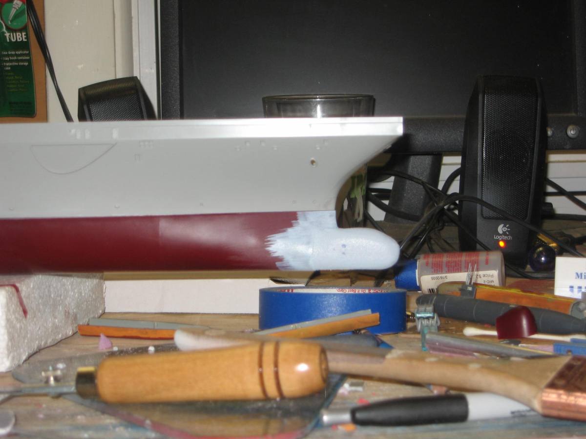

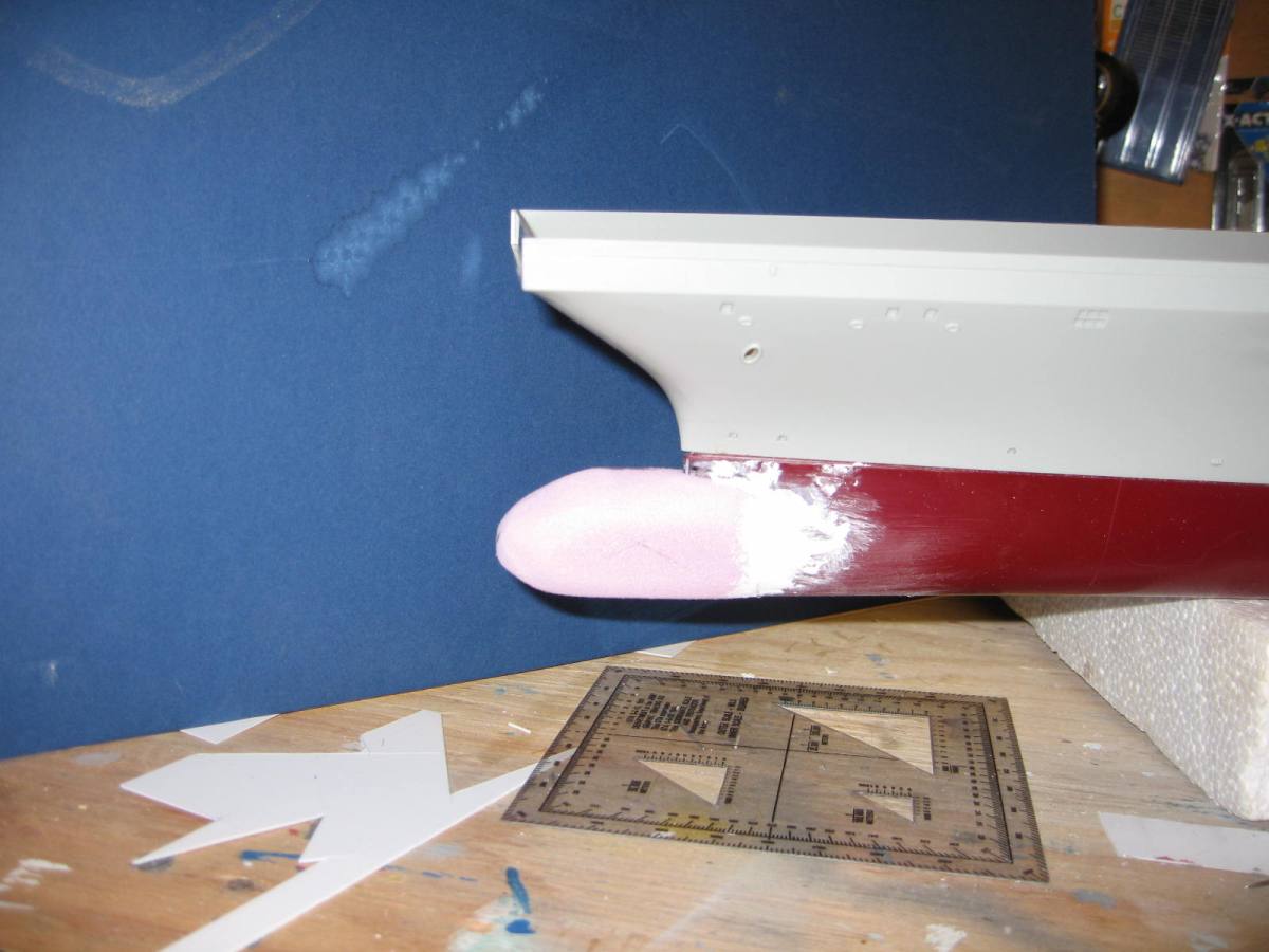

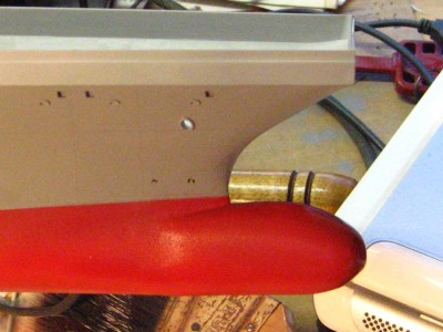

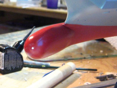

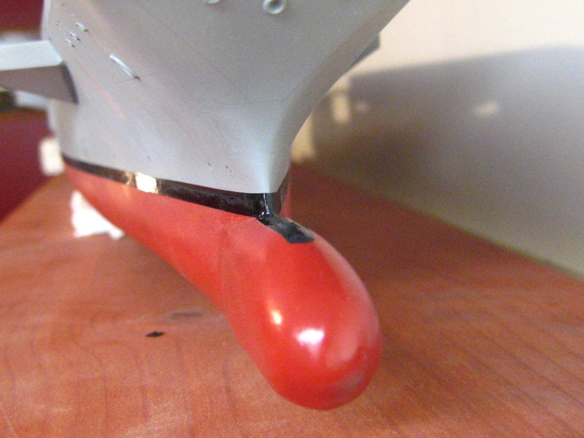

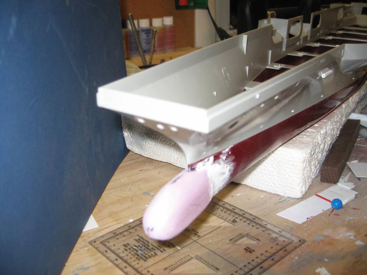

Well, I figured it is about time that the Reagan got her own thread here. Normally I would not build 2 models at once, let alone 2 massive CVN's (I am working on the Bush at the same time) but in this case it just made sense. the Bush is a commission build, and I had planned to build a modernized CVN for my fleet anyways. Seeing as the Bush and Reagan are nearly identical, I figured it would greatly speed up the build process if I did 'em both at the same time, as well as give me a test platform to work out the kinks on my own ship, then the customer gets the perfected versions on his.

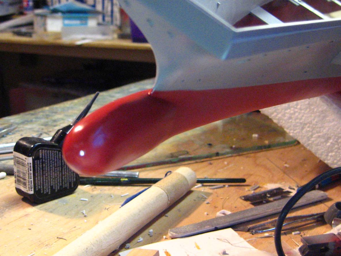

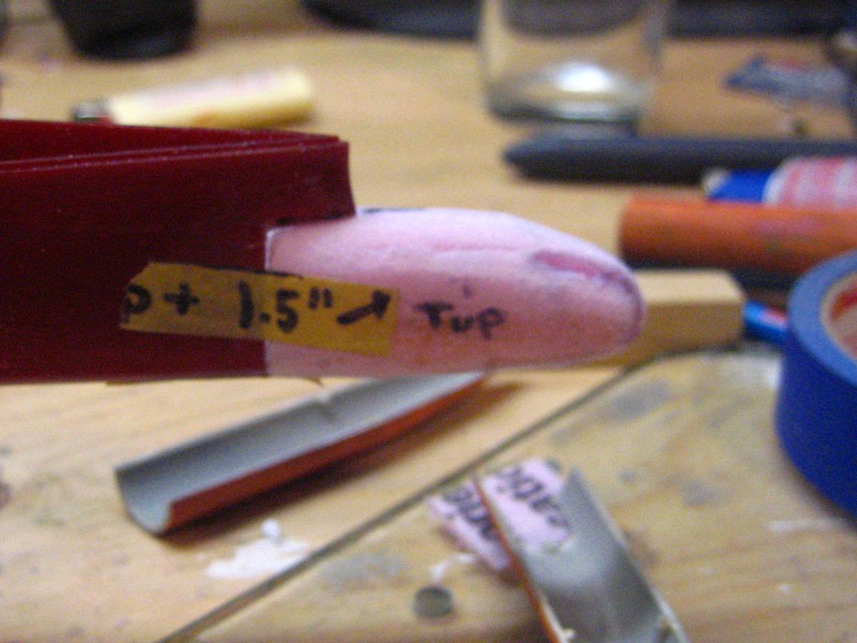

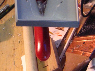

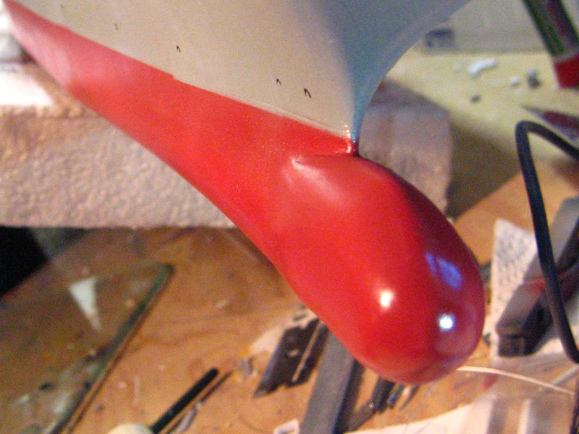

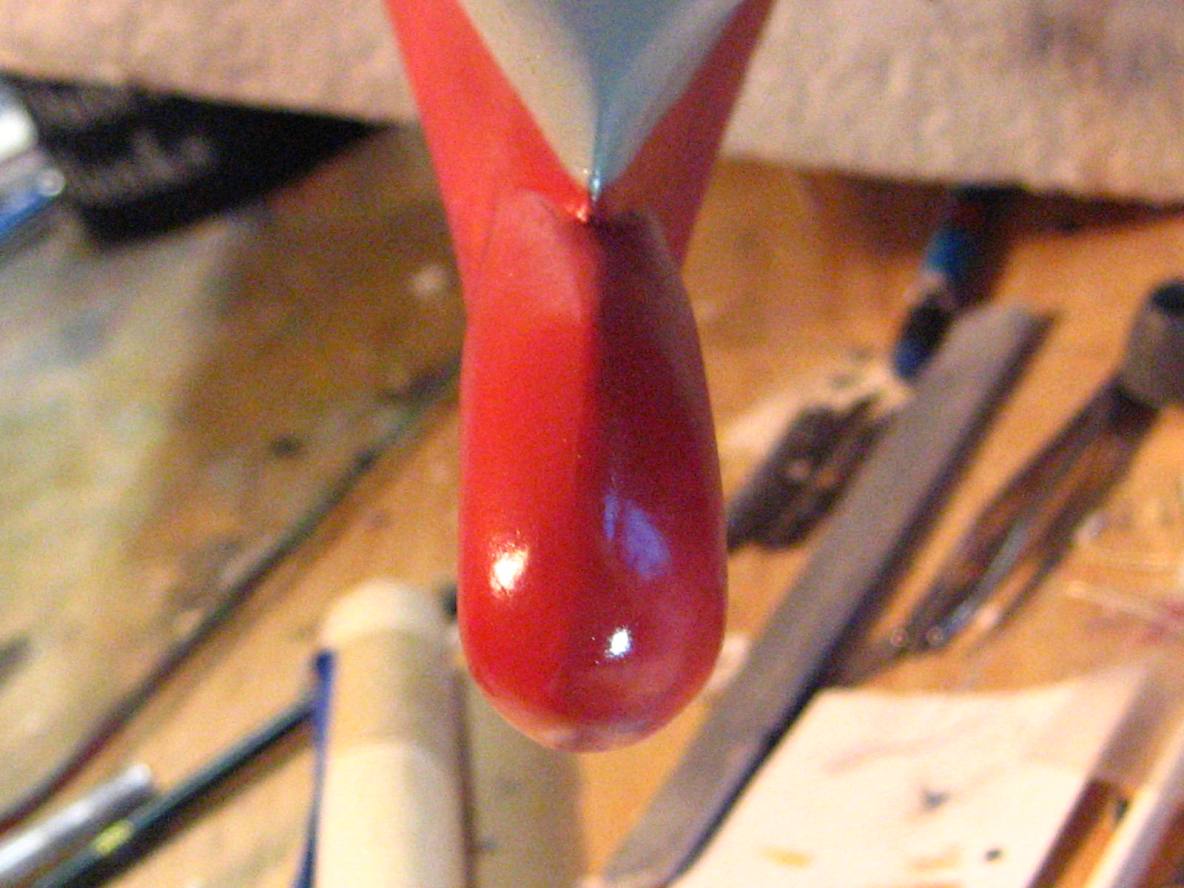

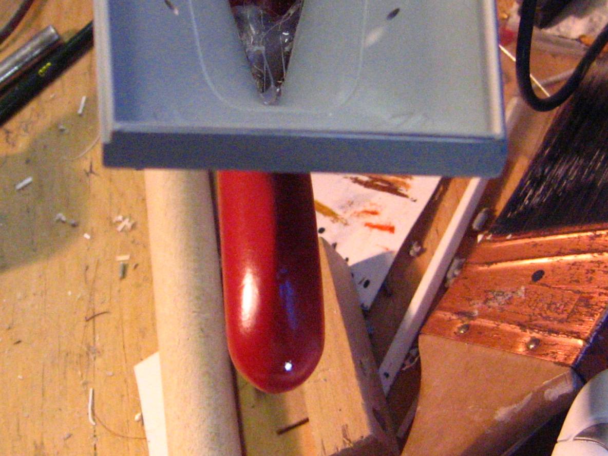

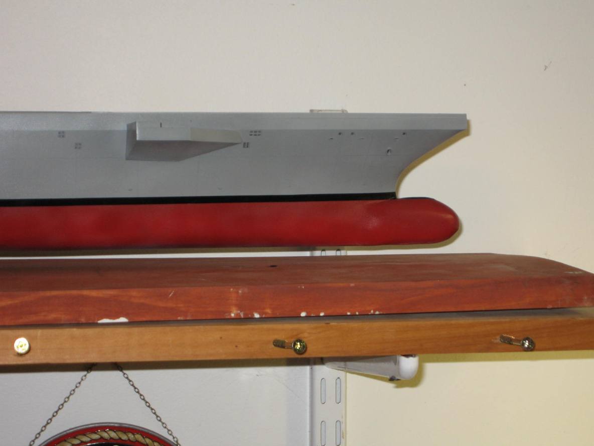

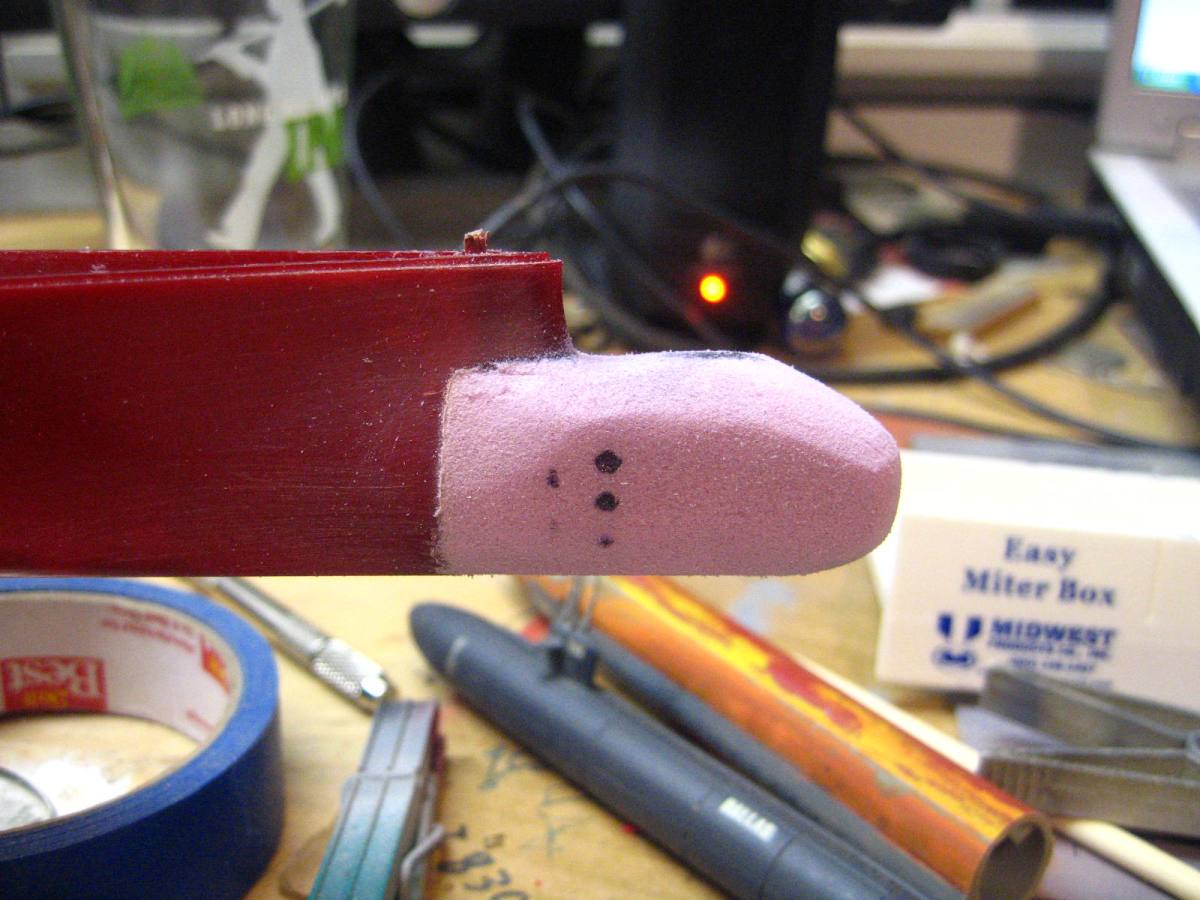

What I initially thought would be a rather simple aspect of this build turned into a huge challenge: the Bulbous Bow! When looking at detailed reference pics, the shape of that bow is way more complex than it looks at first glance. I initially thought it was basically a tube with a rounded off end, man was I wrong! It has a "ridge" on top, and curves in, then out on the sides, I wish I was better with computer programs so I could draw a cross section to illustrate the shape, but needless to say it was not easy! After many attempts, I have a result that I am happy with. there may be an easier way to have done this, but what I did was cut the bow area off and install a block of styrofoam insulation board with the shape of the bow drawn on it. I then got to cutting and sanding and filling until I was happy with the results.
File comment: attempt 1-aborted
File comment: attempt 3 or 4- aborted
File comment: attempt 6 or 7, first one to make it to primer- aborted
File comment: lucky 9 or 10- looking promising
File comment: could it be???
File comment: I think we have a winner!
PostPosted: Thu Jan 19, 2012 9:32 am
Posts: 2576
Location: Connecticut, USA
A lot of careful filling and sanding was required to cover teh rough texture of the foam board. I used a mixture of wall spackling thinned with water to coat the whole bow area, then wet sanded it with 600 grit paper, followed with a generous coat of future and more careful wet sanding. The final result seems to be a seamless transition from the foam board bow to the plastic hull. I'm happy!

PostPosted: Thu Jan 19, 2012 11:57 am
Posts: 1034
Location: Pittsburgh, PA
Nicely executed, Ryan!
Perseverance pays off!
Did you think about trying some balsa foam? It might have required less filling & sanding than the styrofoam.
Bob
PostPosted: Thu Jan 19, 2012 12:01 pm
Posts: 2576
Thanks Bob, this area tested my patience right off teh bat! Never heard of balsa foam , but I am always looking for new techniques. I honestly hope to not have to do another one of these bows any time soon, but if I do I will certainly be looking for a better way!

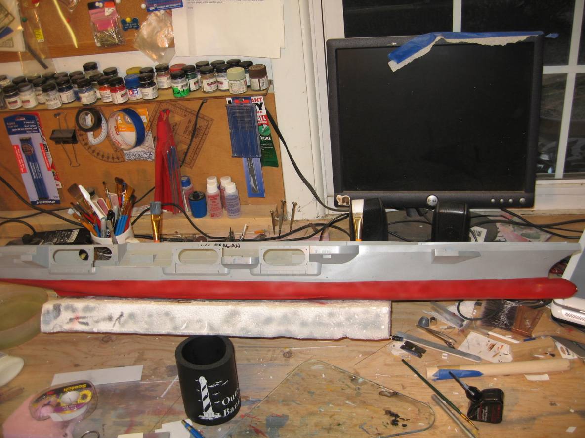

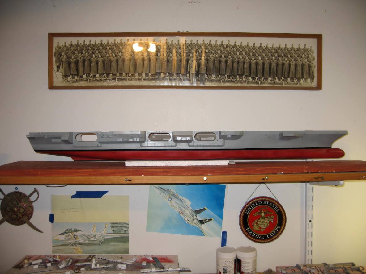

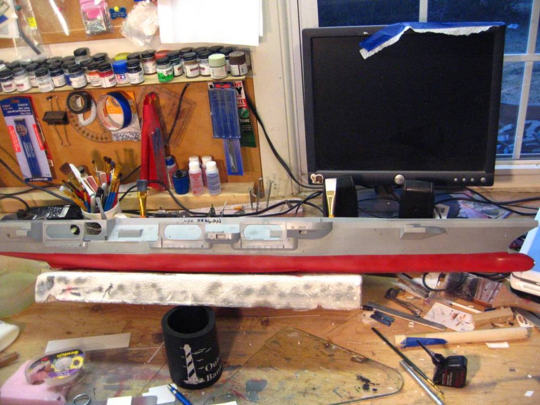

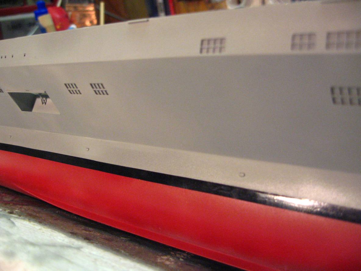

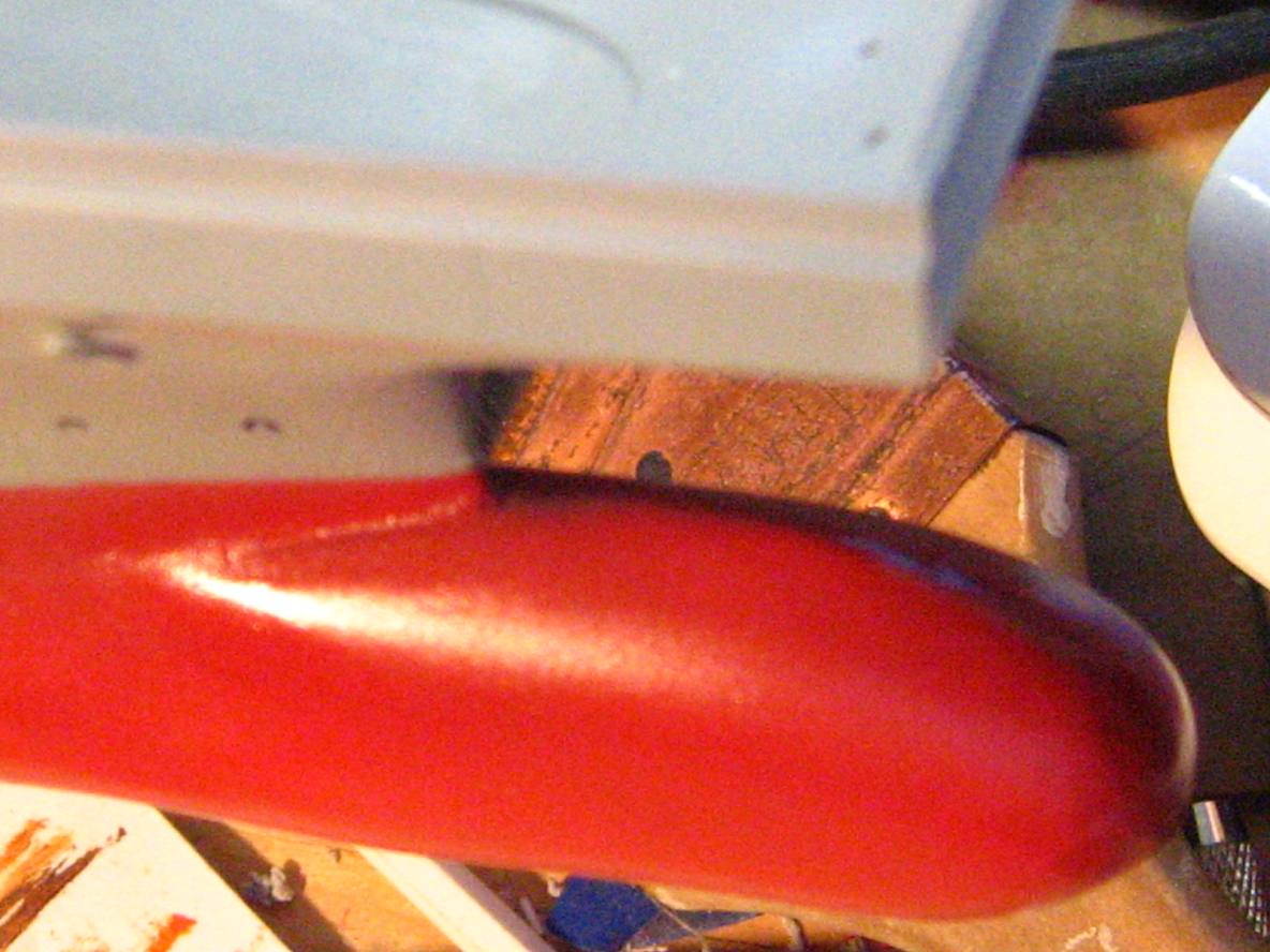

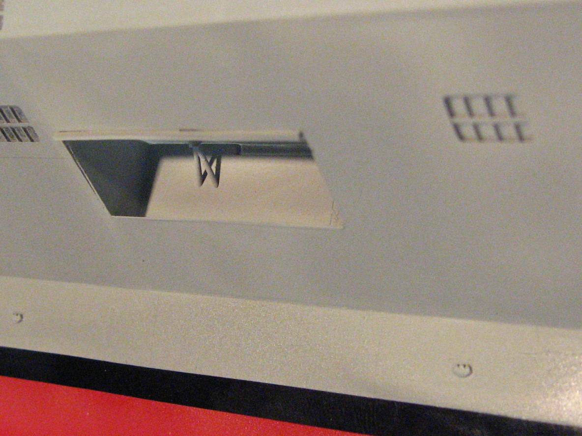

Progress continued this weekend, Reagan got her waterline, including a difficult stripe across the bulbous bow area. Many portrayals of this ship have the bow completely hull red, which honestly would have been much easier, but I am striving for accuracy here, so that meant adding the boot top there too. I think the result is worth the effort. Hangar is nearly complete for the reagan as well, I did not take in-progress pics of the hangar, since witht he exception of a few very minor details, it is identical to the hangar I built for the Bush.

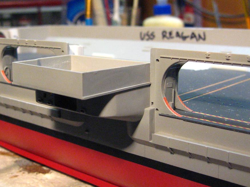

Small update on ronnie. For all the details, you can see the WIP thread of my USS Bush. Reagan recieved all of her port side hull mods over teh past 2 weeks, and her hangar bulkheads have started being installed. She is behind the Bush, and recieves less attention as she is for my fleet, and on no time deadline.

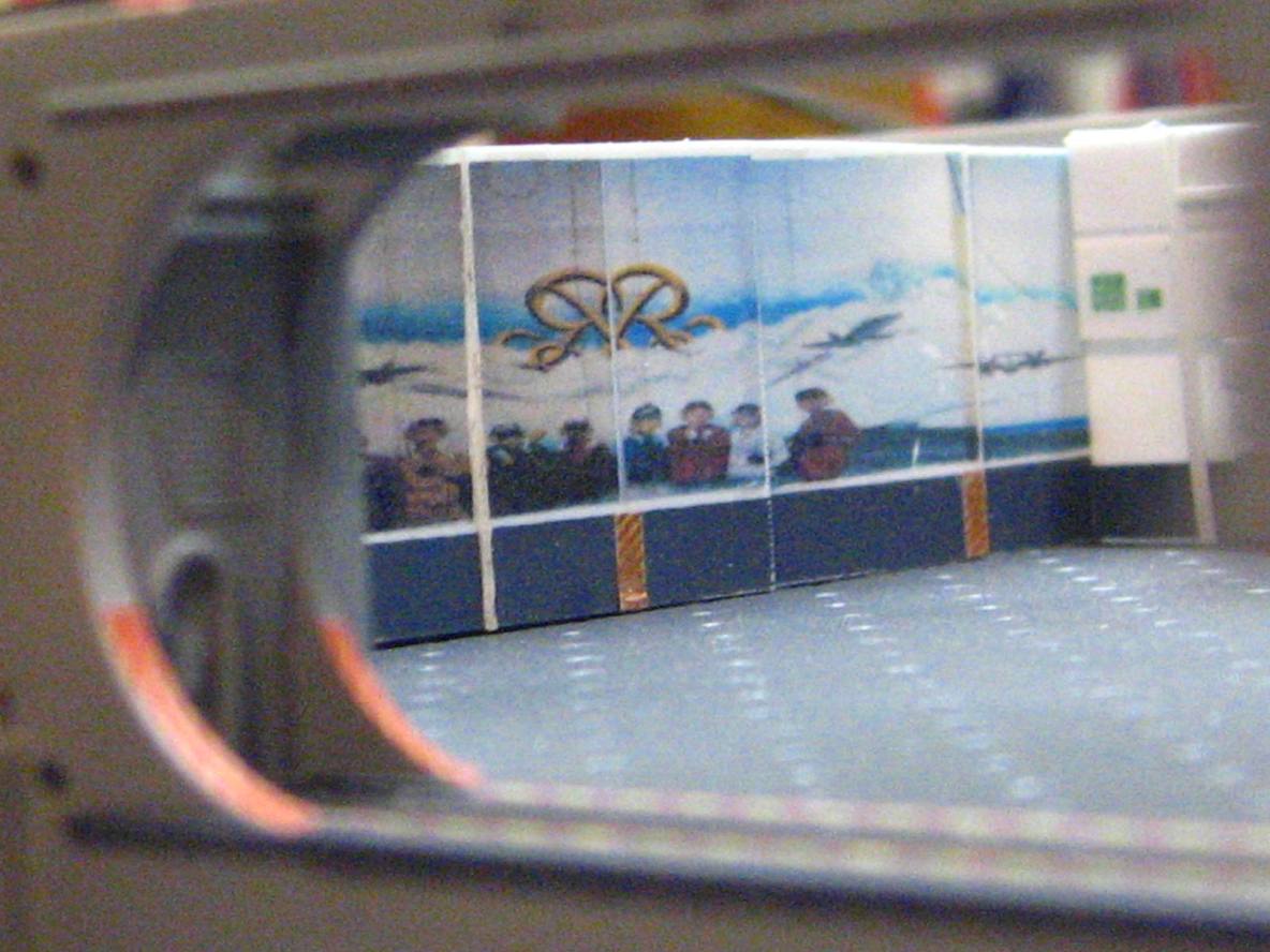

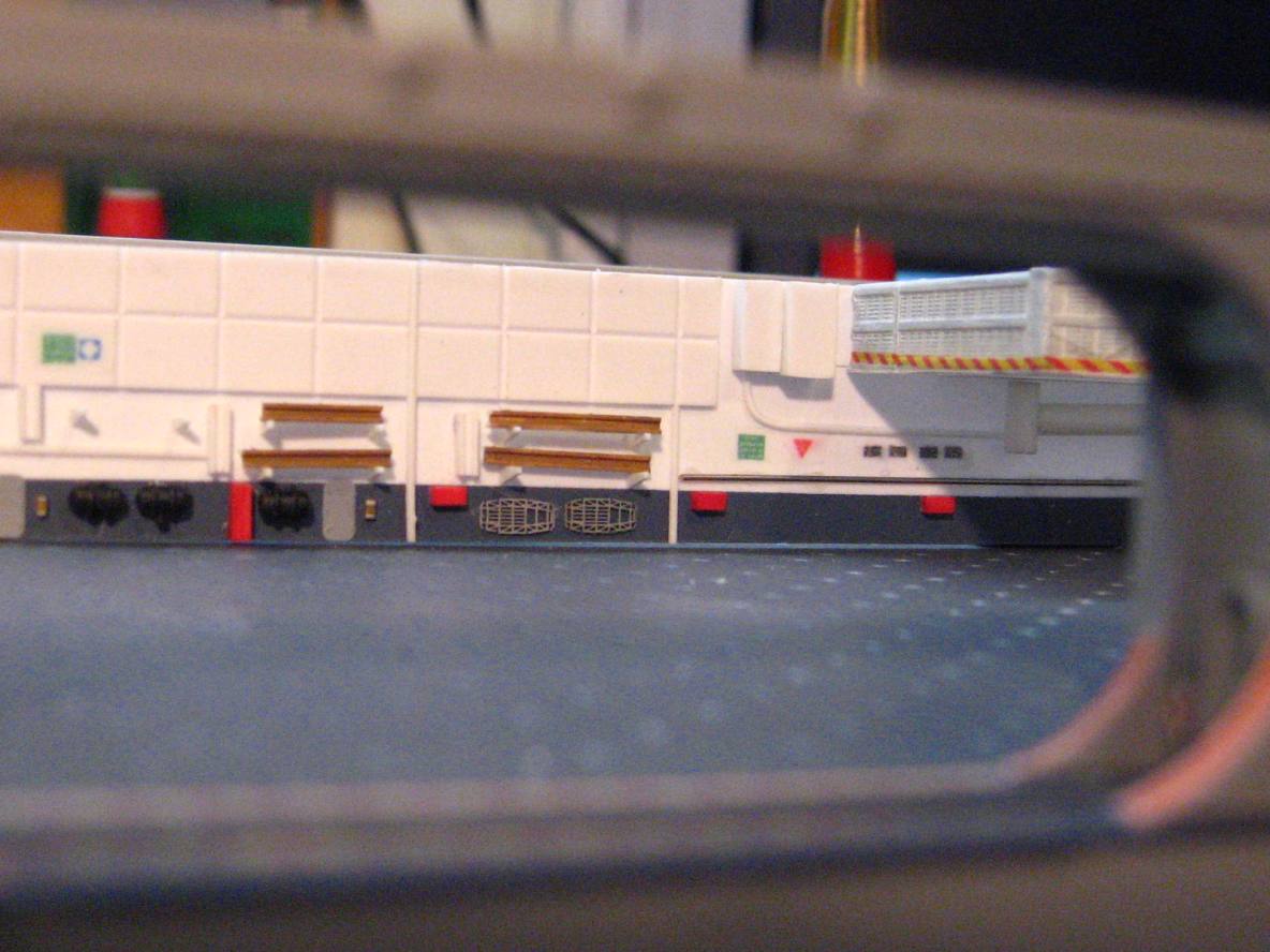

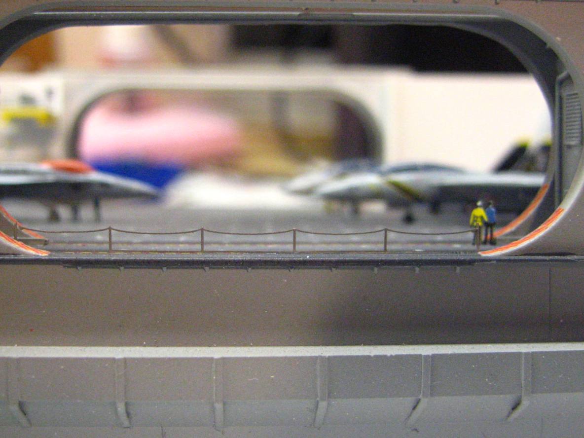

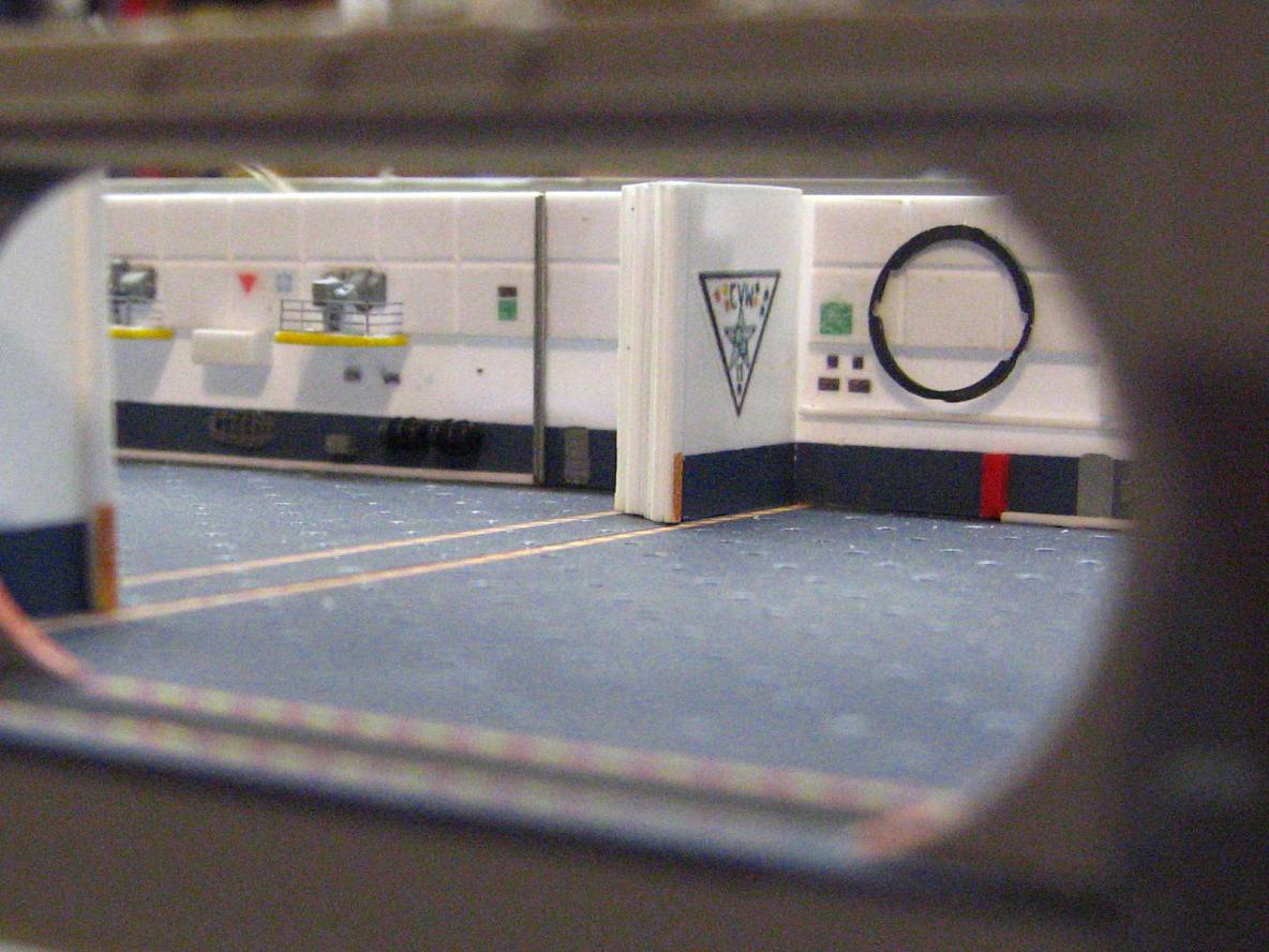

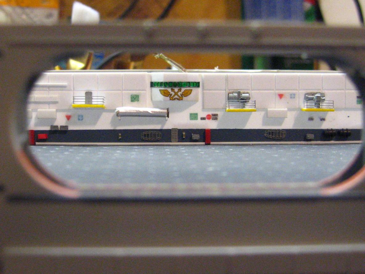

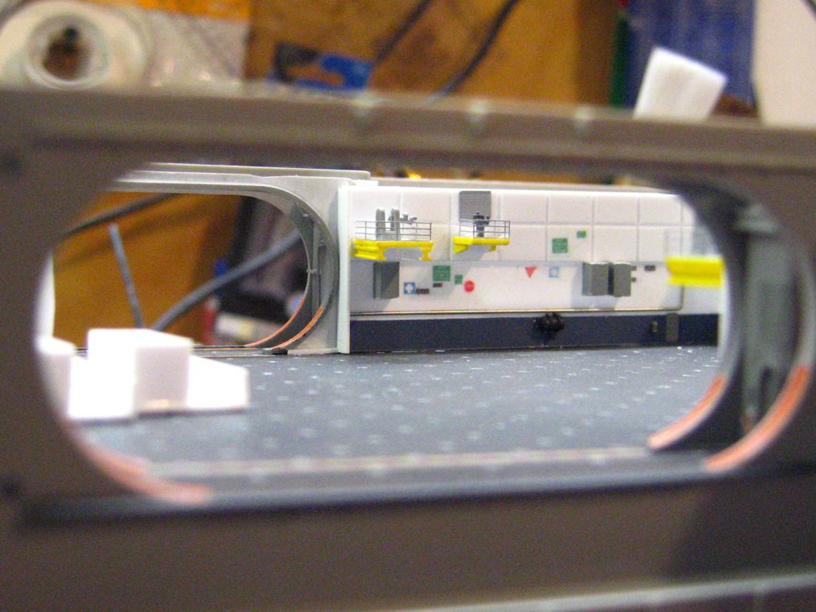

The hangar installation has progressed some more, just need to finish up the aft end of bay 3, then I can start populating the deck with the airwing.
File comment: I finally remembered to install the inner rails BEFORE closing up the hangar on one of my CVN's!

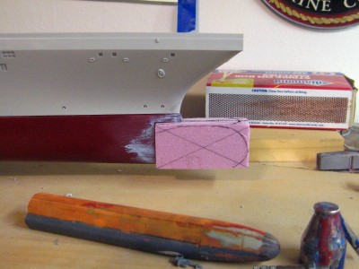

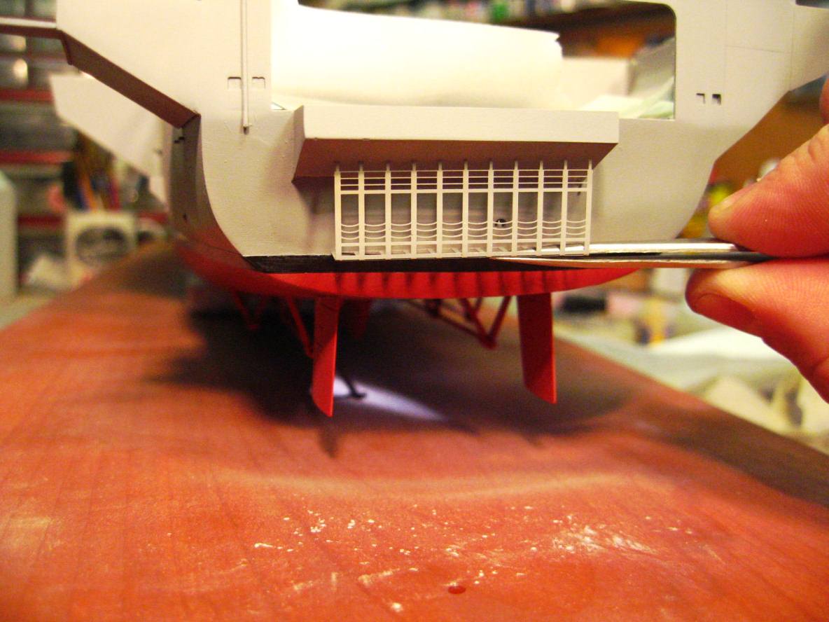

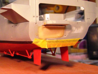

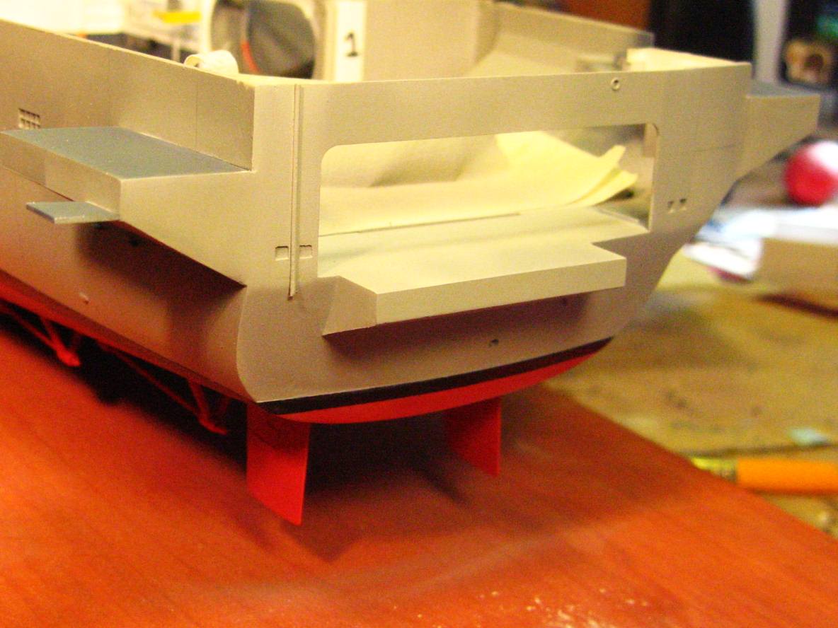

In all my builds of this kit, it has always bugged me that the stern boat dock included in the WEM pe set just does not fit right. Well today I concentrated on the stern, and in looking over reference pictures I realized that the stern deck portrusion that the dock attaches to is entirely the wrong shape and size (for Reagan at least). That being said, I broke out the razor saws and the dremel tool, and hacked apart the ship's stern and rebuilt it to a correct shape. And to think I thought I was completely done with the hull... The boat dock is going to match up to the stern beautifully now! :woo_hoo:

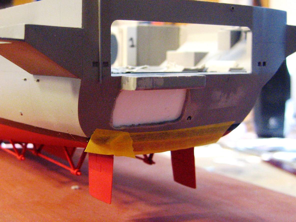

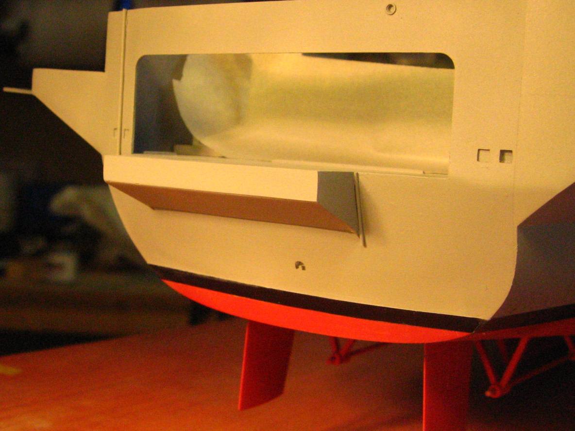

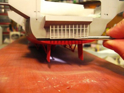

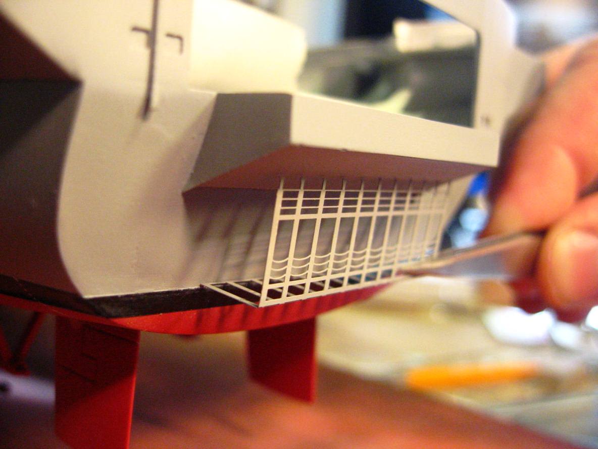

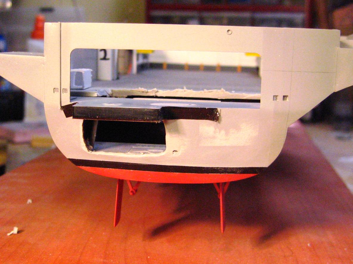

I think the fact that I jumped back in with a large-ish modification to the hull will go a long way in keeping me on track here, I am excited about this ship again!

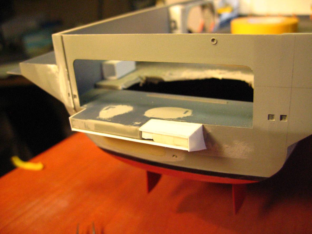

The photos below illustrate how I went about making the stern corrections. Started with an ugly hole cut out there, and ended with a (in my opinion) beautiful extension that looks like it was part of the kit all along.
The one major difference with this hack job compared to the previous ones I have done is how I filled the hole in the hull. In my previous attempts I put in a backing and then added my putty filler of choice, sanded, primed, and filled qnd sanded many more times. Well this time I tried something different, because these holes are pretty deep, and can take the filler putty a LOOONG time to harden. I put in a styrene backing, but made sure that all the sides were sealed, then Imixed and poured some fast setting resin into the hole, and 5 minutes later it was rock hard and ready for sanding. One shot and done this time, I think this will be my way to go from now on.
I also did a lot of other hull work that I didn't bother to take pics of. I cleaned a lot of areas up that still had some tiny flaws visible (areas that I mated the new weapons sponsons especially), and added some piping around the hull as well. I did not like the filling job I did on the port midships area before, as when my flashlight hit it at a certain angle, there was a small divit visible, so I re filled and sanded and painted that area as well. I am going to be my toughest critic on this build, striving for as near perfect build quality as these mortal hands can get! Though I would love to have her done in time for mosquitocon in the spring, my only real deadline is the 2014 nationals in VA.
File comment: Started super ugly
File comment: still kinda ugly, but gettin better
File comment: now we are gettin pretty
File comment: and now, the whole reason for the alteration, the boat dock fits perfectly!

It might be too late, but have you thought of putting in the access hatch and stairs that lead from the dock platform to the hull?
