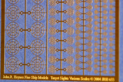

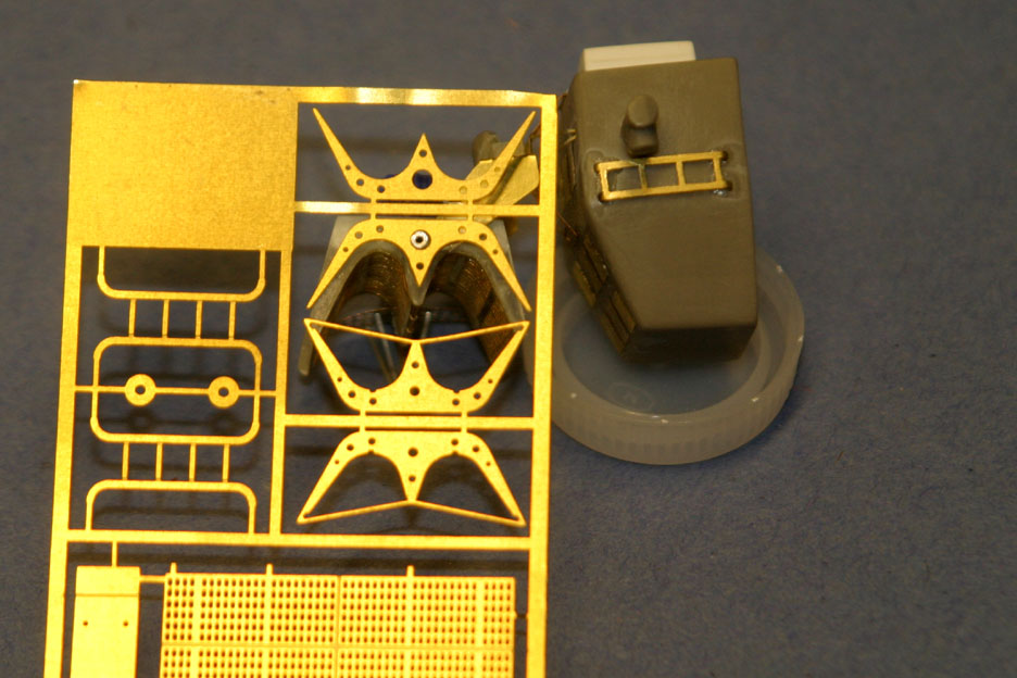

Hi everyone,

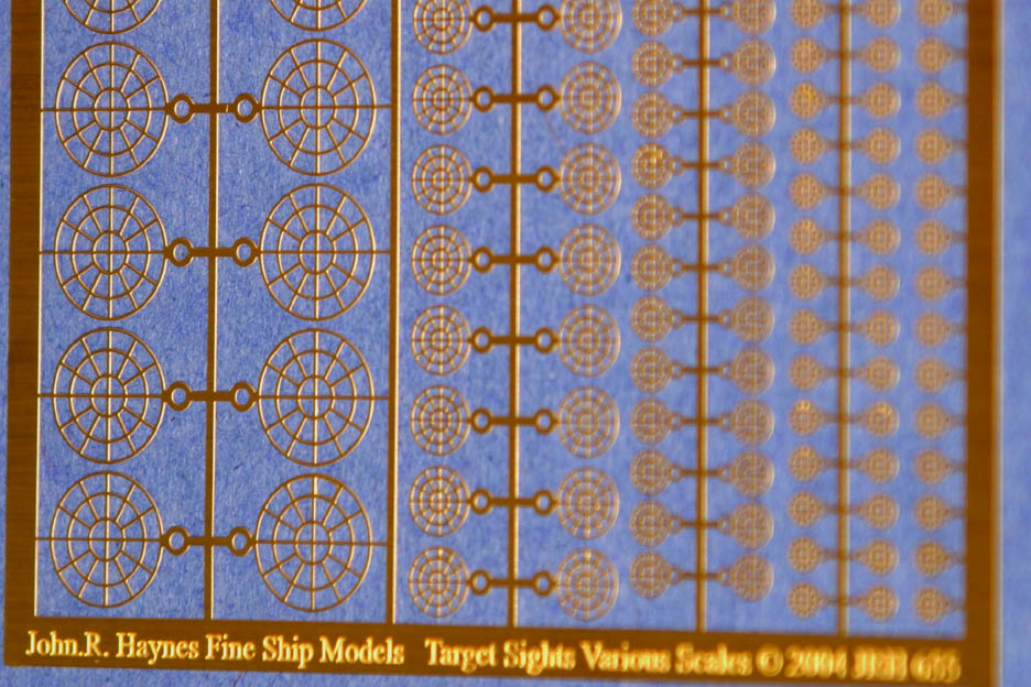

I just got a big shipment of fittings and PE from John R. Haynes. One of the PE sets I got was Target Sights. The set has the correct style USN sights in scales from 1/24th to 1/96th. Instead of the German machine gun sights I’m going to use the 1/96 scale sights for the Mk-39 Gun sight. I got more styrene shapes in a couple of sizes and I should have one finished soon. Sorry for the quality of this image, but you can get the idea of how they look. The set cost 5 GBP which is $8.34 USD. Even though the pound is worth more than the dollar John R. Haynes products are a reasonable price if you buy them directly from him like I do.
:cool_2:

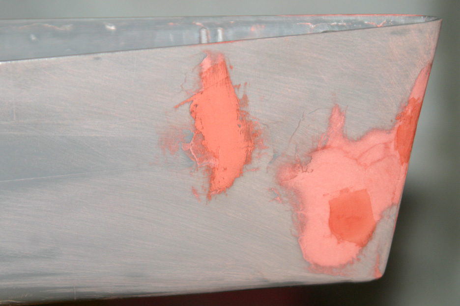

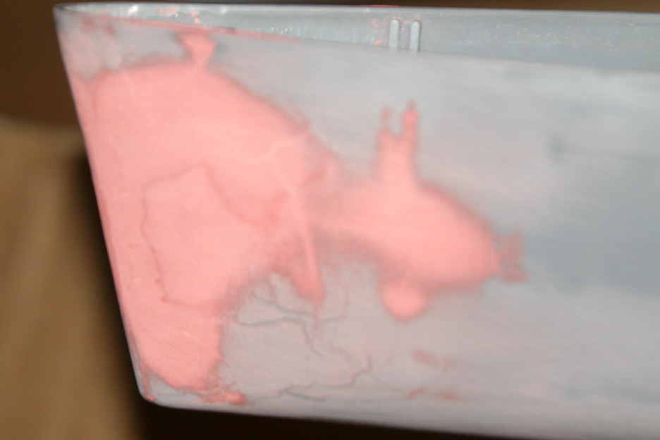

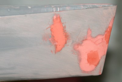

Yesterday I did more body work on the hull, it's alomst finished.

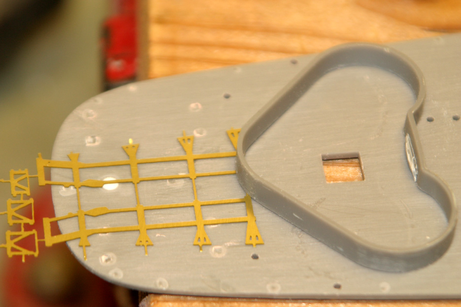

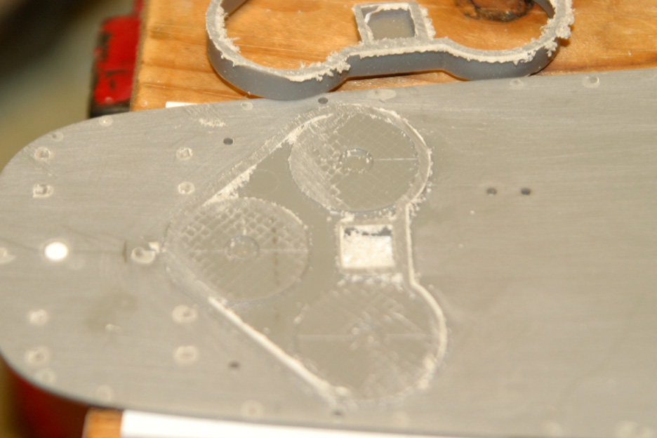

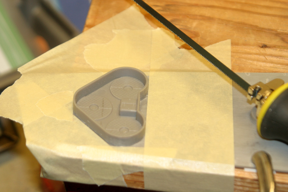

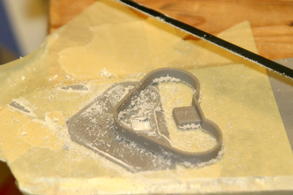

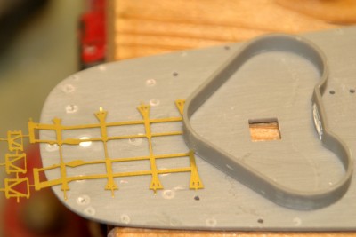

Then I removed the stern 20mm gun tub off the deck. I used masking tape to protect the deck while I cut off the tub with a coping saw. The shape and size of the tub is close and was not the problem. I need to move it forward to give me room for the PE roll off depth charge racks.

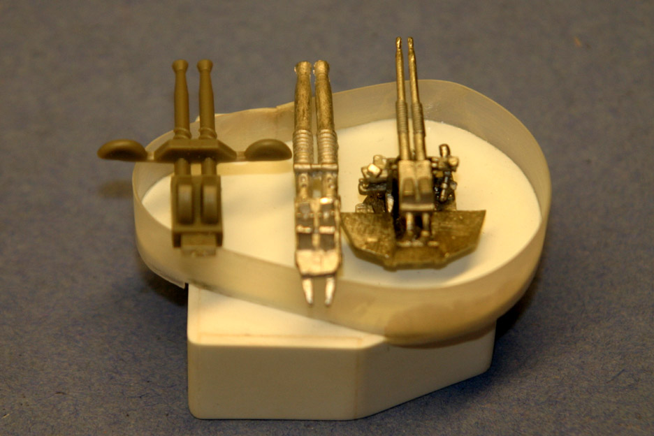

Now lets compare twin 40mm guns. The kit part on the left John’s 1/96 in the middle and HR Products on the right. There is a hugh difference between John’s and HR’s guns and I rest my case.

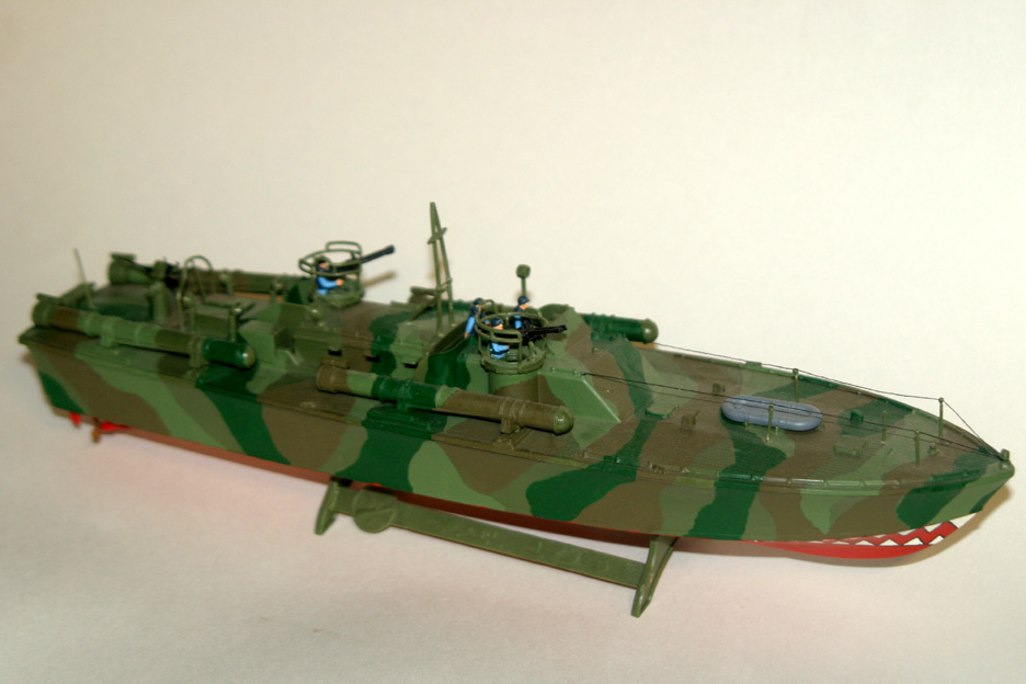

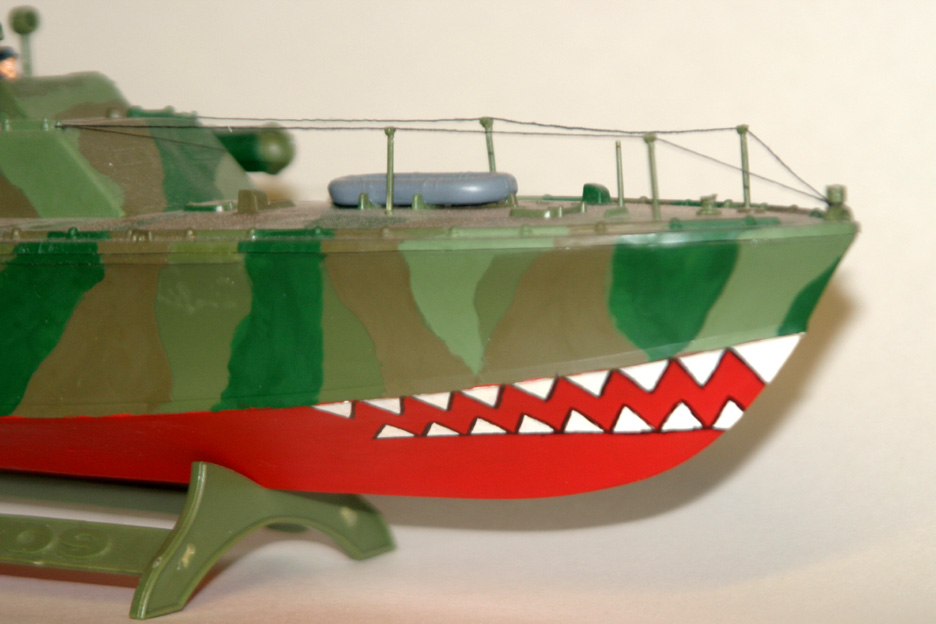

Hey Everyone,
This is a 1/72 Revell PT-109 I built my way about 10 years ago. I moved from Massachusetts to Rhode Island a couple years ago and my wife and I haven't finished unpacking yet. The 109 just surfaced after openning a few more boxes. Check out the TEETH!!!!!!! :heh: :heh:

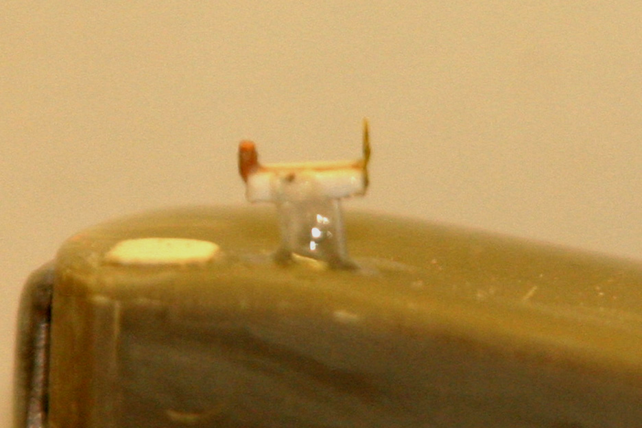

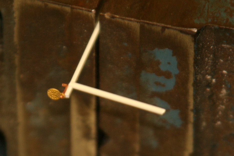

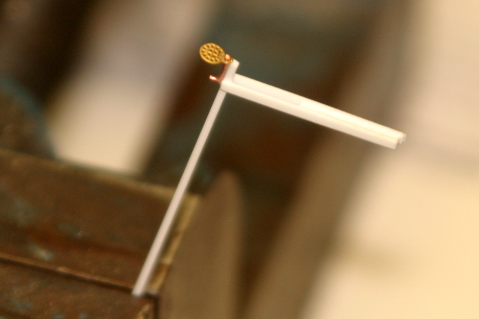

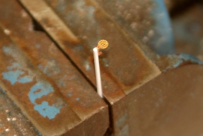

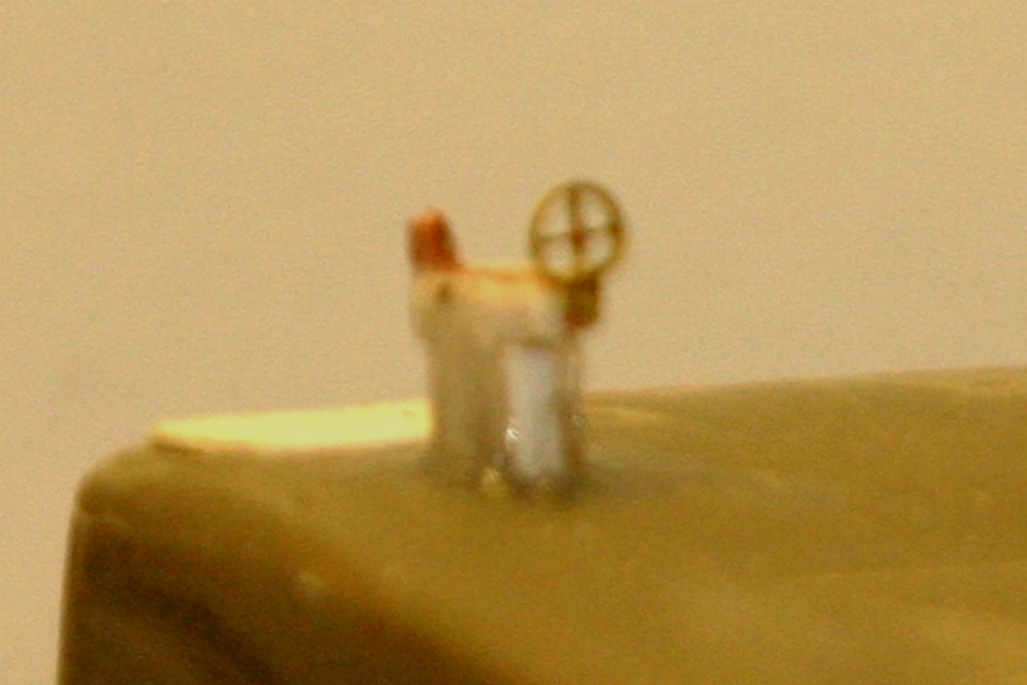

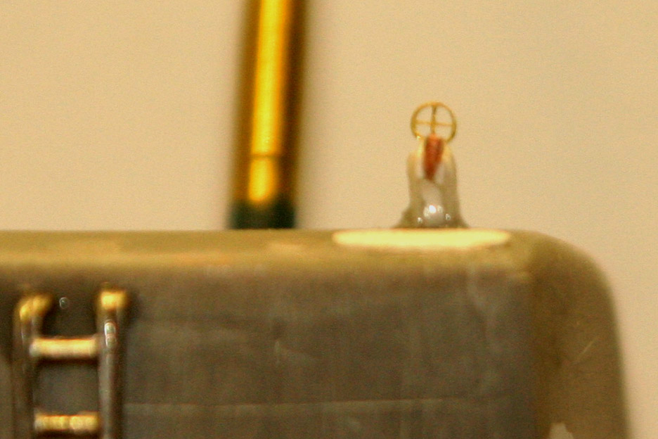

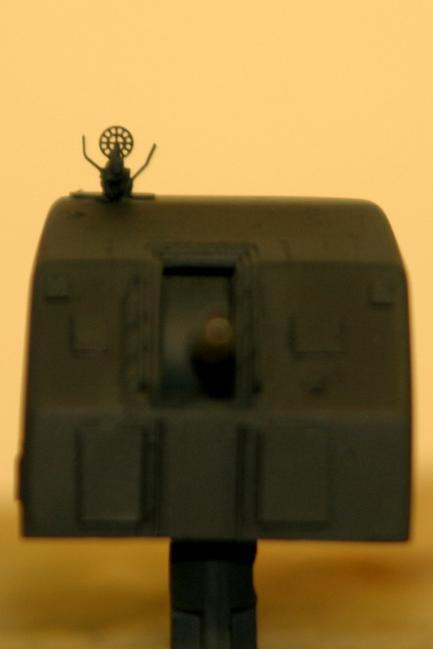

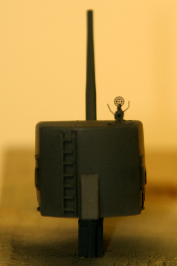

Hi Everyone,
Enough of the PT boat with teeth on with the build!!!!!!! :heh:

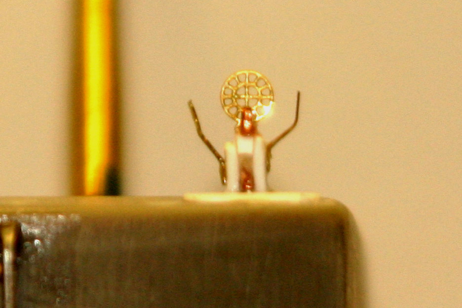

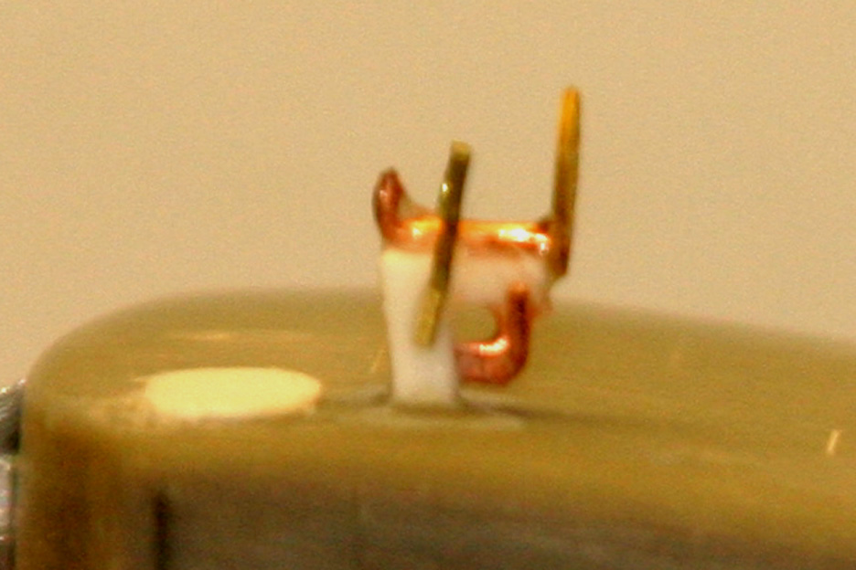

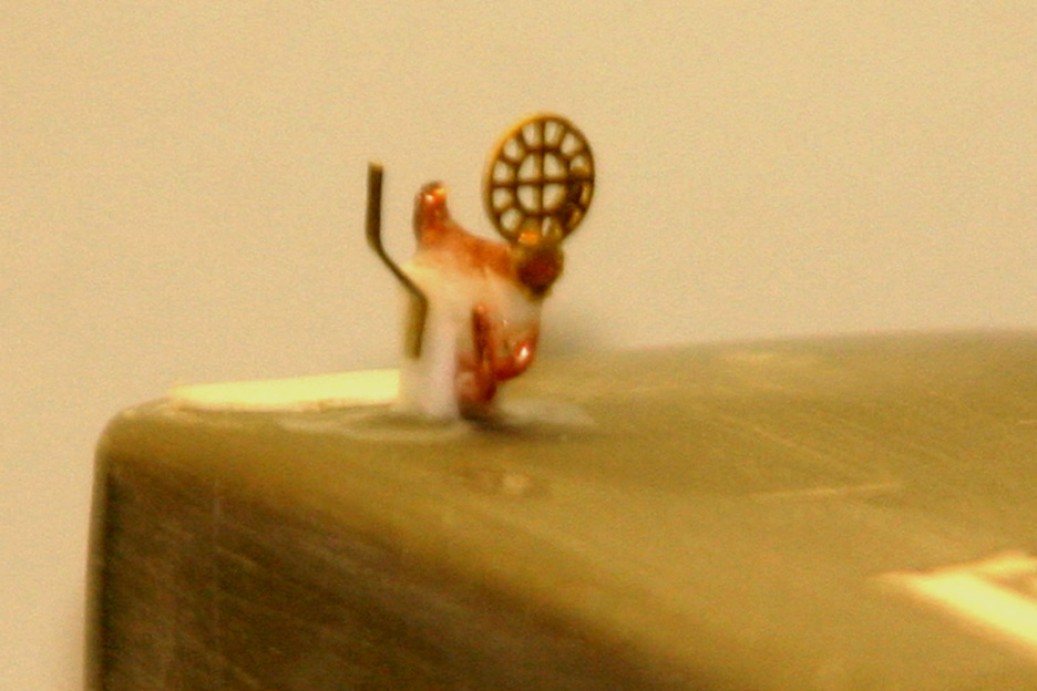

This is my second try at making the Mk-39 Gun Sight. I’m using the new 1/96 scale PE sights from John Haynes. The parts I precut are useless except for the wire piece that the sight is glued to. They are just too small to glue together without them sticking to the tweezers first. :heh: :heh:
What ended up working was cutting the pieces longer than necessary and trimming them to size after the assembly was completed. The sight and copper wire rear sight are glued to a piece of .030 square styrene cut about 3 inches long. By doing this I could hold it in my small drill vise to glue on the remaining parts together. The sides are made from .020 x .040 styrene, cut 1 inch long and glued on. The linkage is made out of .015 copper wires I bent and cut to size; those were the hardest parts to glue on. The control handles are made from the thinnest piece of the PE rails from Toms set that I’m not going to use. First I trimmed the .030 square stock and the .020 x .040 side pieces to size and glued the assembly onto the turret, then the control handles were attached last. First the 2nd try then the first try as a comparison.
Front View: :cool_2:
Side View: :cool_2:
Rear View: :cool_2:
I’m sorry for the somewhat out of focus photos of the Mk-39. To properly photograph them I need a macro lens for my camera, but I have spent so much on my next build I don’t have any money for camera accessories!!!!!!!!!! :big_grin: I have pictures of my first and 2nd attempt at making the Mk-39 Gun Sight. You be the judge, which one looks the best? The only problem is that I still need to build four more of them!!!!!!! Feel free to comment on my work, I appreciate your comments and criticisms!!!!! :thumbs_up_1:

I finished the body work on the hull today. Before I used the Bondo on the hull I tried it on a piece of scrap from the kit. Today I sanded the Bondo on the scrap test piece so I had a flat area. Then using super glue, I glued a piece of .010 styrene onto the Bondo test part and set it aside to dry. I checked it out tonight and it seems to work just fine. :thumbs_up_1: :big_grin:
Tomorrow I'll estimate the size and shape of the bow repair performed on the Haggard after ramming the sub and I'll cut and glue a couple sheets of .010 thick styrene to the bow to simulate the repair. By doing this I'm actually setting the date of my build to the day the Haggard’s repairs were completed and she sailed from Ulithi 21 April 1945 with battleship Iowa to support the Okinawa operation. Eight days before she was struck by the kamikaze that almost sunk her.

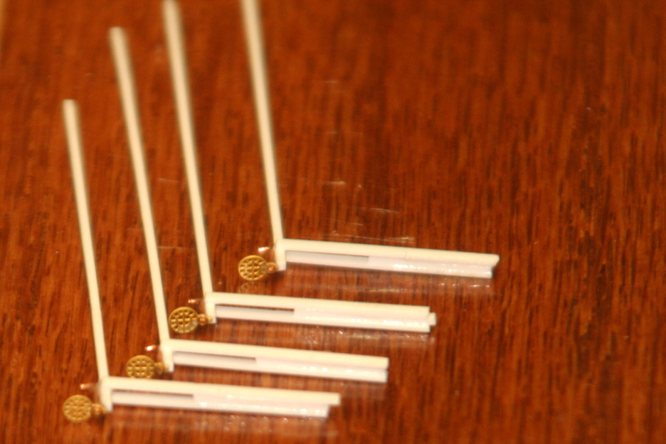

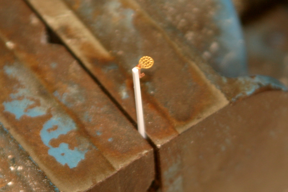

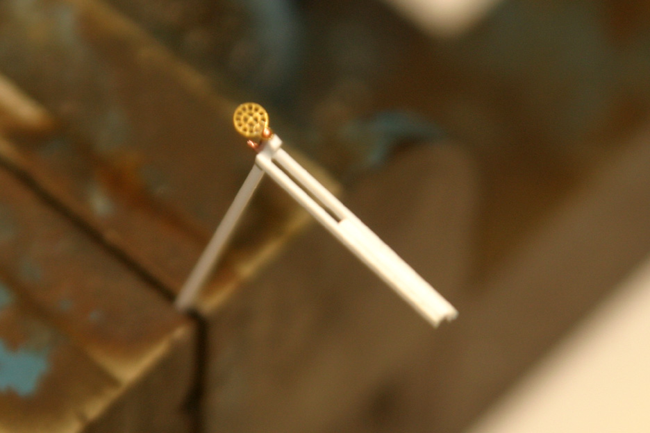

Today I worked on the Mk-39 gun sights. After they’re finished I’ll glue them on and paint all the 5 inch turrets and then move onto plating the bow to simulate the repairs the Haggard received after ramming the sub. I was going to do that first and give myself a break from those small gun sights.
I was surprised how fast I was able to assemble the last four Mk-39’s. I saved so much time and aggravation by leaving everything long and trimming the pieces after the assembly was complete. There are six steps to assembling the Mk-39 the way I'm doing it. First, glue the copper wire rear sight to the front sight. Second, glue that to the .030 square stock.
Third, glue the first side on and make sure it is perpendicular to the sight.
Fourth, glue the second side on with the spacer in between.
Fifth, glue the front linkage part on. Last, allow the glue time to dry, and trim off the excess.
The control arms I made for the first Mk-39 are not going on the last four. They are so weak the first time someone touches them they'll break off. I really don't expect them to make it to the first sortie down at the pond. All I have to do is glue on one more linkage piece, trim the excess off, and glue them onto the turrets and break out the airbrush!!!!!!!!:woo_hoo:

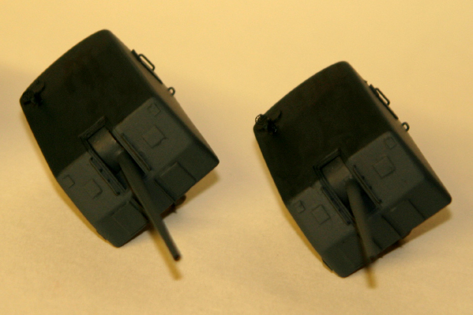

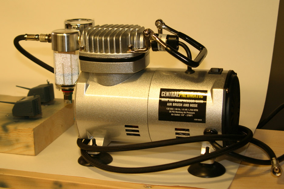

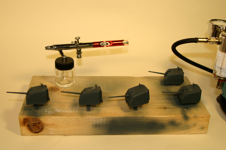

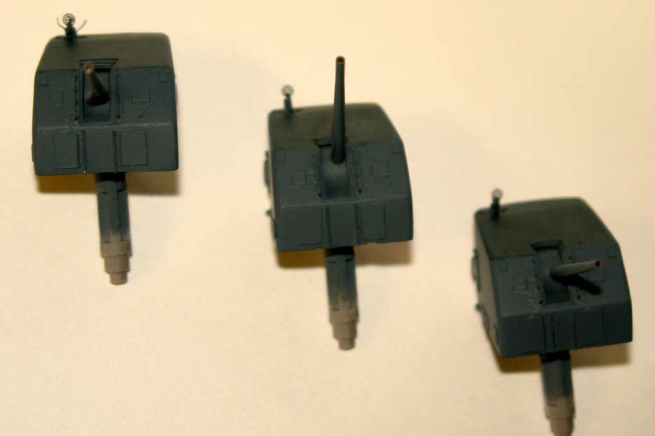

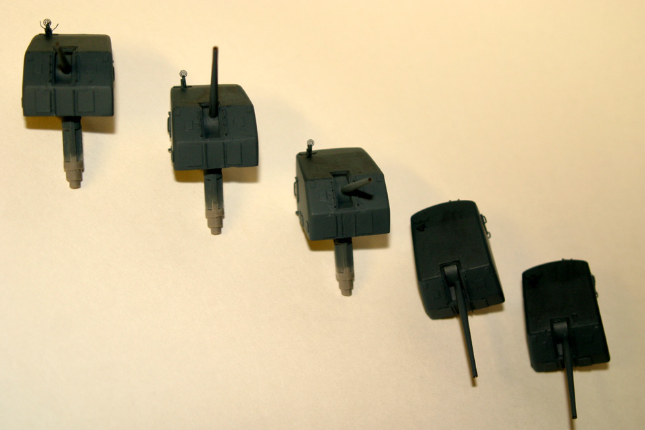

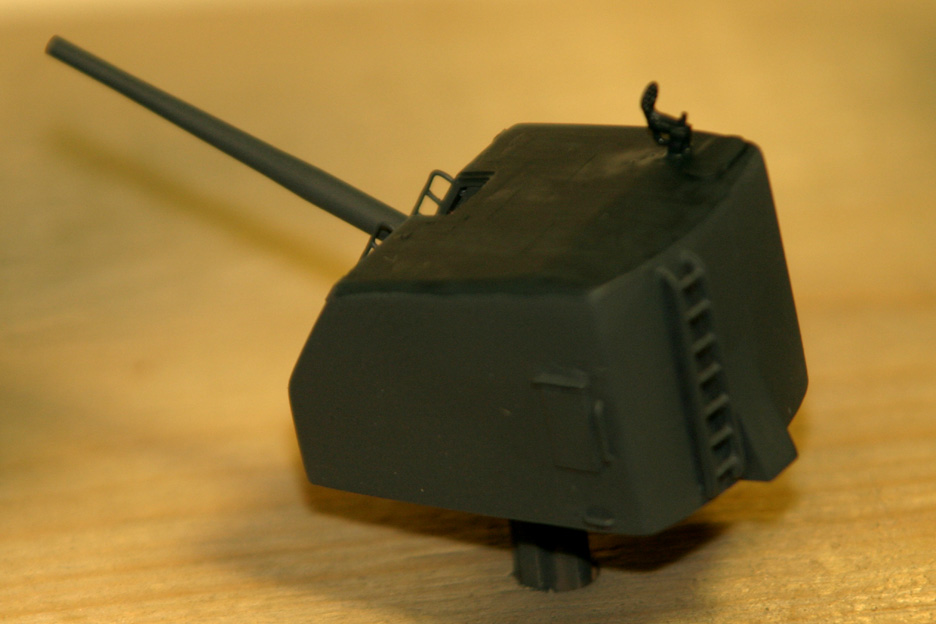

Hey Everyone,

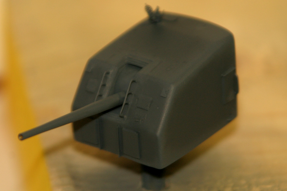

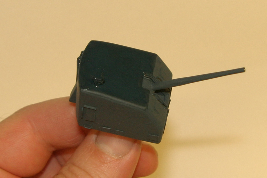

This is the day I've been waiting for; I finally painted the 5 inch turrets!!!!!!! :big_grin: :woo_hoo: I used a birthday gift to paint them. The new compressor worked great!!!!!! :thumbs_up_1:
I painted the turret tops deck blue by hand and it looks like they could use a second coat.
I need to get a few jars to put thinned paint in. If I had one I would have used the air brush for the 20-B. I will take a few photos of the turrets in natural light, the flash photography doesn't capture the real color.

Hello Roger,
Excellent results with the gun mounts! I think these are the best I have ever seen using the Lindberg kit parts. Congratulations on such superb results.

Yes! Congratulations Roger, the turrets look great. I know the flash can ruin the color of the photo - no big deal - I can see the paintjob is beautifull. Neat!
