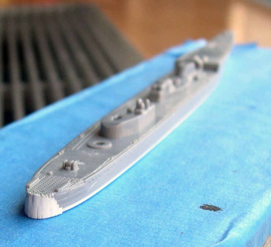

However, it eventually occurred to me that the lack of raised tie-down lines would make it easier to cut off and relocate the turret base for #1 turret for a Yugumo. The portholes would be a great bonus to ease detailing. And, I had an unbuilt PitRoad Yugumo kit that was completely worthless to me, though the bridge seemed to have potential.
So, the first steps were to waterline the Aoshima hull, mate that to a waterline plate & shape the basics of the PitRoad bridge. (Let’s ignore the bridge work for now. I began with it just to see if I could fashion the basic shapes correctly for the project. I will return to it in detail further on).
I also placed a breakwater on the forecastle where the forward edge of the linoleum meets the treading of the anchor deck. Doing so required scraping away some of the deck treading ahead of it. Which is ok, as the breakwater on the real thing did intrude forward.
I then removed the forward turret base ring, as the other significant difference between a Kagero and a Yugumo hull was the re-siting of #1 turret of the Yugumo type 1.5m further aft for better stability. That’s approximately 2mm in 1/700. I saved the ring for placement after painting the linoleum deck.

The next step was reshaping the stern. While the Kagero and Yugumo classes have virtually identical hulls, there were some slight improvements for the Yugumos. The most significant was the extension of the hull at the waterline at the stern by an additional .8 meters. This small change actually improved top speed and maneuverability.
In 1/700, this change adds .045 inches, or just over 1mm. to the waterline. I chose to cut & glue triangular wedges from .01” x .04” styrene strips to the stern, with the strip widths greater than 1mm, knowing that sanding and shaping would shave down the extension.

Well, I then added Tamiya putty to fill in the gaps and smooth the overall shape. More sanding eventually yielded the correct stern contours.
I also drilled out all the hull portholes, shaved off the porthole eyebrows and plating lines, and added a degaussing cable. The shape and placement of the cable, at the rise of the forecastle deck from the main deck and at the stern, is specific to one of the three yards in which a Yugumo was built, either the Maizuru Naval Dockyard, the Uraga Dock Company or the Fujinagata Shipbuilding Yard. I find myself leaning towards completing this build as Kazegumo, so that meant utilizing the Uraga Dock pattern. Fortunately, a change to another ship requires only minor alerations of the pattern as long as I finalize my choice before I paint.
