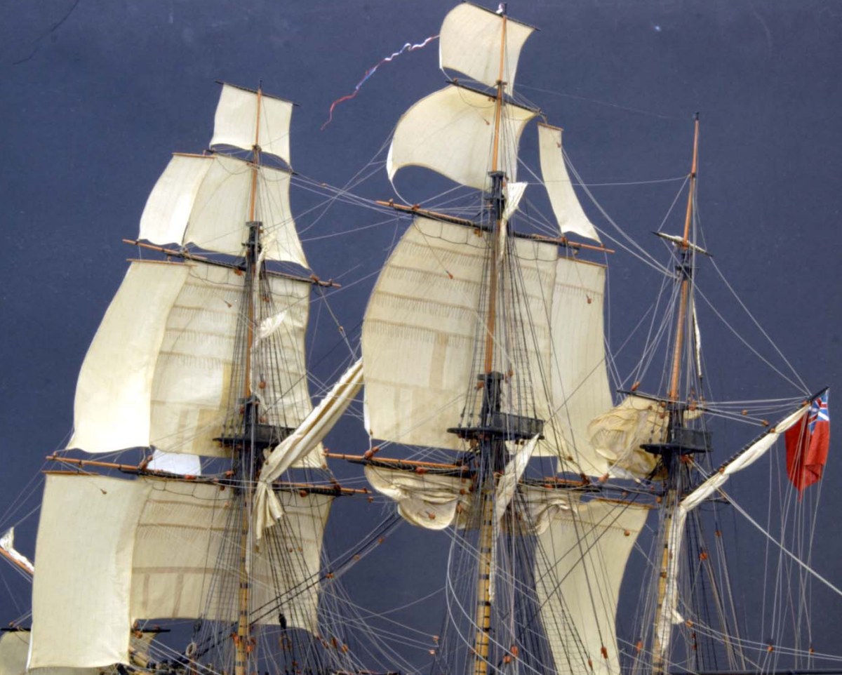

The sail looks really nice ! I am not happy with how my silkspan sail worked out... The sails are just too large in this scale for silkspan to do the job.. I have some fine thread count cloth I will try next.. I will try gluing strips like you have used and see how it goes... Sails are a bit of a beach ! LOL
PostPosted: Fri Feb 10, 2017 2:56 am
Posts: 5386
Hi there Victory Builders!
my opinipo for what is worth -as an ex-sailmaker own business-now canvas producrts business...
Beware! :big_grin: of making the sails look too ' 3-D '
I also currently have a vested interest in making small sails (as you both know with my little Mary Rose-!)
- albeit mine is 4 x smaller
so I have been studying other modellers o the net , McNarry, Reid et al
have a look at the link below
- good feel and colour I think
link
http://www.shipmodel.com/models/diana-h ... rline-exm-
( alas images are too large to post @ 2100 px wide)
http://www.shipmodel.com/files/diana-hm ... ana008.jpg
edit: Jim Baumann
I have downloaded and cropped the image to the relevant area
as below
:wave_1:

lovely looking Sails Jim.... Really sweet looking Frigate.. I wish he shared how he made them... I am a little surprised he did not add a crew for her... Probably what the client wanted.
PostPosted: Fri Feb 10, 2017 11:41 am
Posts: 5386
I am sure he tells you how in his book !
Period Ship Modelmaking
here is a cheap( ish ) copy in the US
http://www.ebay.co.uk/itm/Period-Ship-M ... Swk1JWefm8
probably worth a look !!
he also has an e-book version of the same for considerably less
http://www.pen-and-sword.co.uk/Period-S ... dle/p/8082
hope it helps
JIM B :wave_1:
