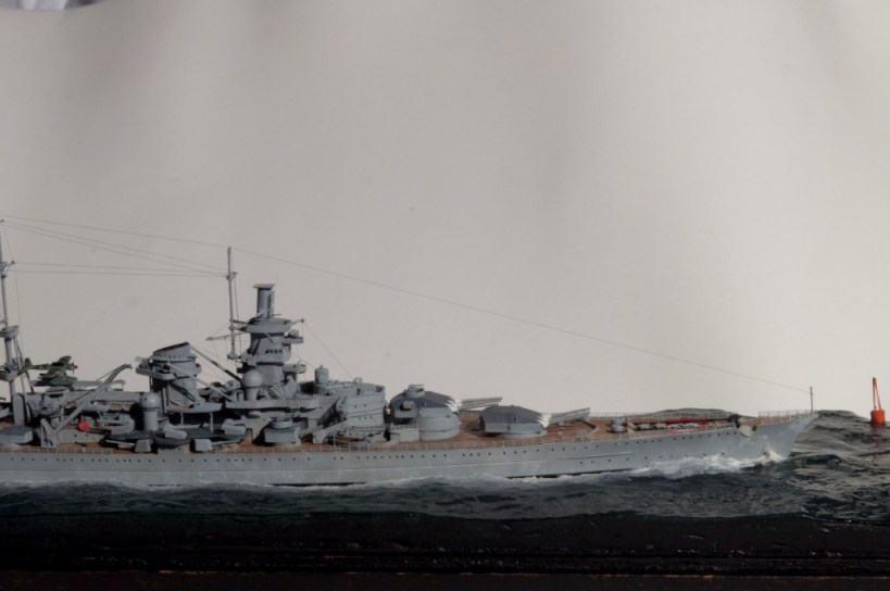

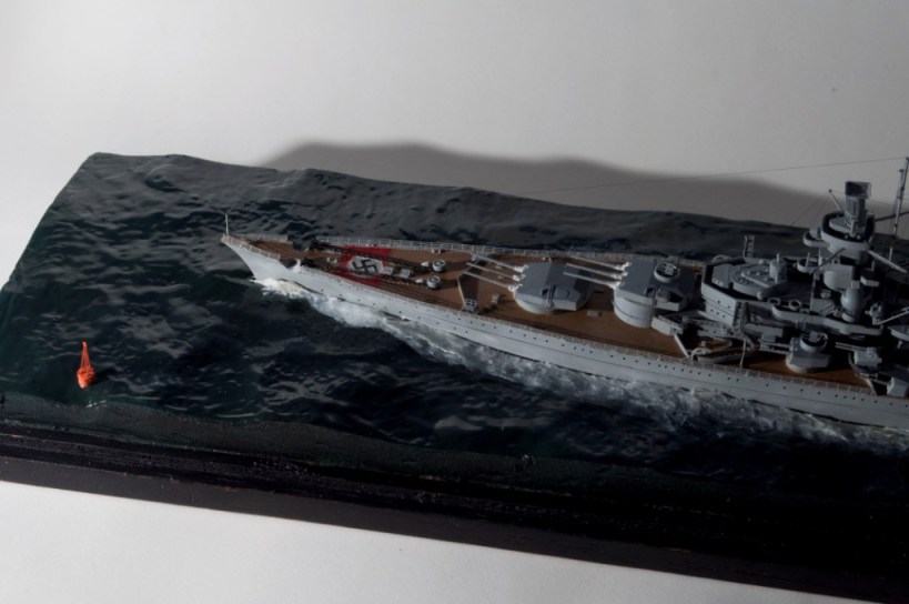

At the same time ..........
viewtopic.php?f=60&t=124569

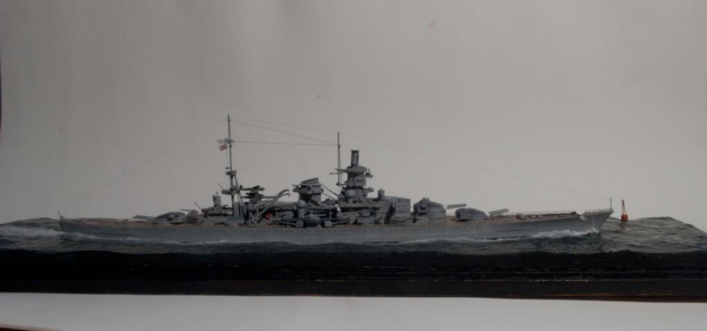

Here comes the sister ship. Yes, another
Scharnhorst (Tamiya 1/700)
Details:
Photoectched Eduard and W.E.M. for Scharnhorst class
Chains: Cooper wire
Paints: Humbrol
Mast: Needles 0,8 � 0,6 mm.
Main Gun: Moldel Master Gun Barrel
Single Secundary Guns: Needles
Rigging: Uni caenis 20 den
Sea base: styrofoam � Acrilics color - tissue paper � fiber filler and gloss varnish
Some pics:

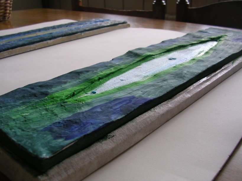

That is the best looking sea base I have ever seen. I see that you have listed some materials that you used to create it, but would you be willing to expand on the list to include a how to on how you achieved such outstanding results? P.S. I think the Scharnhorst looks amazing as well, the water just flat out blew me away. :)

Kometa
Posts: 368
Location: Galicia (Spain)
Re: DKM Scharnhorst - Tamiya 1/700
Post by Kometa »
Thanks for your kind words.
Paul:
There are several methods for water.
Here are several: viewtopic.php?f=4&t=37923
(I use the method of Frank Spahr) http://www.finewaterline.com/pages/tips ... swater.htm
Also: http://www.u-modelismo.com/foromodelism ... pic=1423.0
At this time I use something similar to Werner De Keersmaecker (http://www.modelshipgallery.com/gallery ... index.html)
I try to explain it with pictures

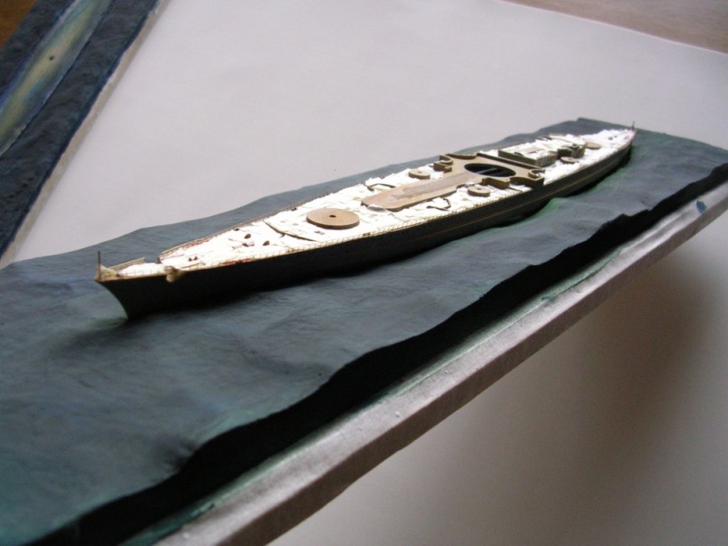

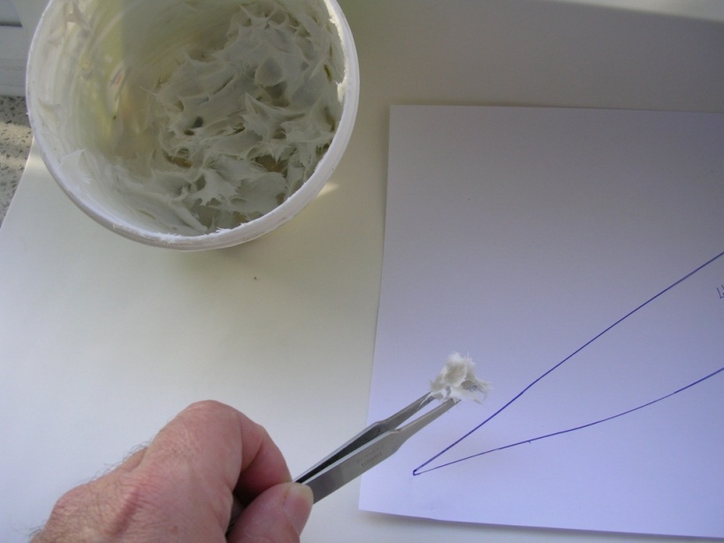

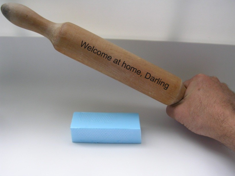

A)
Styrofoam and a special tool
B) Press
C).- Paint
D) Gloss varnish
E) Add waves (tissue), White paint and another gloss varnish, and more waves with � fiber filler
Finish:

Thank you very much for the reply with link and the how to pictures, very useful. I will definitely be utilizing the styrofoam technique to generate the swells in the future, I have been using acrylic gel medium to date which has a nice "wavelet" component but the swell was lacking! Thank you once again and congratulations on a fantastic build.

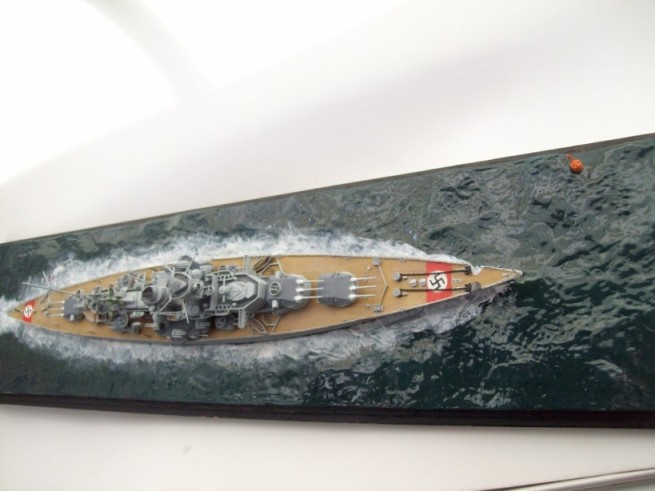

Hi again
Here another pics with a better camera.
