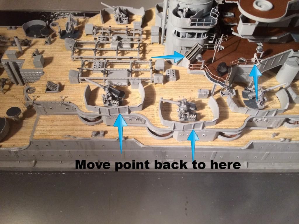

Jeff Sharp wrote:
Thats when I noticed that Trumpeter accidentally put two shields on the wrong side of the ship. The third shield back on each side should actually be on the opposite side.
This made me think of something when I read it yesterday and I've confirmed it on the ship. My kit's mostly packed away and I haven't had a chance to see if this is correctly replicated on the model or if they made the same mistake that they did on the 350th CA-38 San Francisco. Both have the same feature, I can confirm, and it's a subtle but potentially annoying one for those that want to fix it if it exists on the 200th Arizona.
The Navy, in its wisdom, decided that the splinter shields that were to be added to ships during the King Board upgrades in 1940-41 were to be essentially the same shape for ease of construction. That means that the shields on the port side were rotated 180 degrees and installed on the starboard side (or vice versa, depending on your point of view). So, the "point" on the outboard side was FORWARD on the starboard side of the ships and AFT on the port side. Trumpeter had them all forward or aft on the San Francisco, and I'm wondering if the Arizona kit has the same issue.
For reference, Plate III on San Francisco's Guadalcanal damage report and Page #6 (boat deck / superstructure deck level) of Arizona's Booklet of General Plans.

I appears to me when looking at my kit that they are in fact mirror images of each other. Jeff, hate to say this but you may have to redo one side of the kit that may have been correct Hoping that you don't have to.

Holy crap! I can't believe I have to back the bus up again on these splinter shields! No wonder the shields on the plans appear the way they do! When I initially noticed it, I said to myself "Nah, no way were they really like that. Must be a mistake!" Got to get creative now to make it right. Does anyone have any extra shields they are not using? Anyone doing a pre '41 version?

Ok, so this may not be as bad as I initially thought. The port side is in good shape. On the starboard side I just need to reposition the point on the 3rd and 4th shields. Hopefully I can do a little scoring and bending to reshape these two shields.
Back on the flag bridge, I fabricated a couple of saluting rifles, scraped the WEM photo etch on the flag lockers and added the KA etch detail. No more egg cartons!
