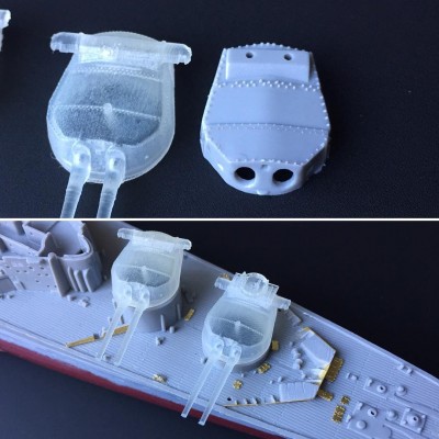

Progress - turrets arrived as well. Yes, worth the upgrade totally! Saves time on construction too and Im gonna compare - may be add those brass barrels. :) Time to set these into daylight and get them "cured".
18513301_1879607785644466_2203348622626521088_n.jpg [ 111.03 KiB | Viewed 1489 times ]

Glad you like them :wave_1: have to point out though, you have A and B turrets the wrong way around in that picture :heh:

Well I wouldnt make that mistake when assembling :thumbs_up_1:

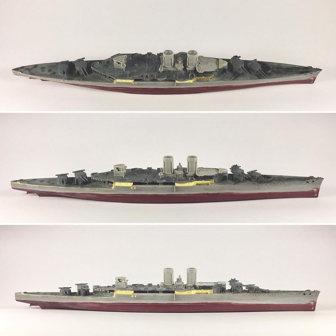

An update on the Hood. Few comments:
1) Turrets.
Ive received the turrets and tried to paint them. Paint doesnt stick too well, and I didnt know I had to scrape off attachment points, so that was my bad and hence you see scraped off sides of the turrets. The issue though is that it seems like the roof of the turret has a finger like texture on it and Im not sure how to properly remove it. Anyone has ideas?
2) General comment on Flyhawk as I go alone - I think it calls for the absolute top end modeller. I suspect Eduards PE set is going to be much better-stronger, even if brass is a bit thicker. I think longevity is important and I think Flyhawk is so thin you can break it by looking at it. SO thats why Im not doing cages on the funnel tops. Ill weather them best I can, and hope rigging above will distract.
3) Hood hull halves are an utter nightmare for me to merge, putty galore, etc. Im gonna do best I can and this is a hull with paint stripped from it from first try. Super annoyed but Im still hanging in there!
4) Trumpeter instructions are pound for pound worse than Revell and worse than Bismarck, and the order and logic of assembly, as well as part numbering is messed up. You just dont join A1, A2 with G3 roof and B2 rear wall to make a little box. Its like an alien came up with this system who is devoid of earth logic, but I digress.
on to pics:
File comment: 1) and 2)
File comment: 3)
File comment: Just a scale of the project so far

Looking good! :thumbs_up_1:
For the turrets, did you follow all the preparation steps for 3D printed parts, cleaning, leaving them in sunlight and/or under a UV lamp for a bit, priming? If nothing else you absolutely need to prime the parts, ideally with something a bit stronger than hobby paint. I use acrylic car body primer, comes in rattle cans from my DIY store for doing paint touch ups on your car. Not sure what brand you have where you live but there's bound to be an equivalent.
What attachment points? I don't recall having to sand anything off on my turrets.
The texture is a result of the 3D printing process, it's basically the rows it prints in. It doesn't bother me that much. I've seen threads on this site where people go to great lengths to smooth it (there was talk of lightly sand blasting the parts) but for me a couple of layers of primer and then paint does the job of covering it very well.
