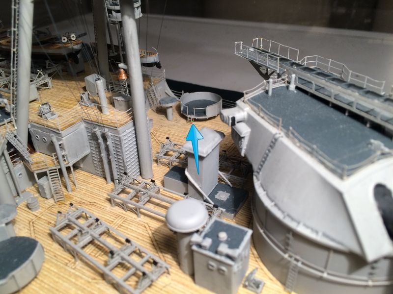

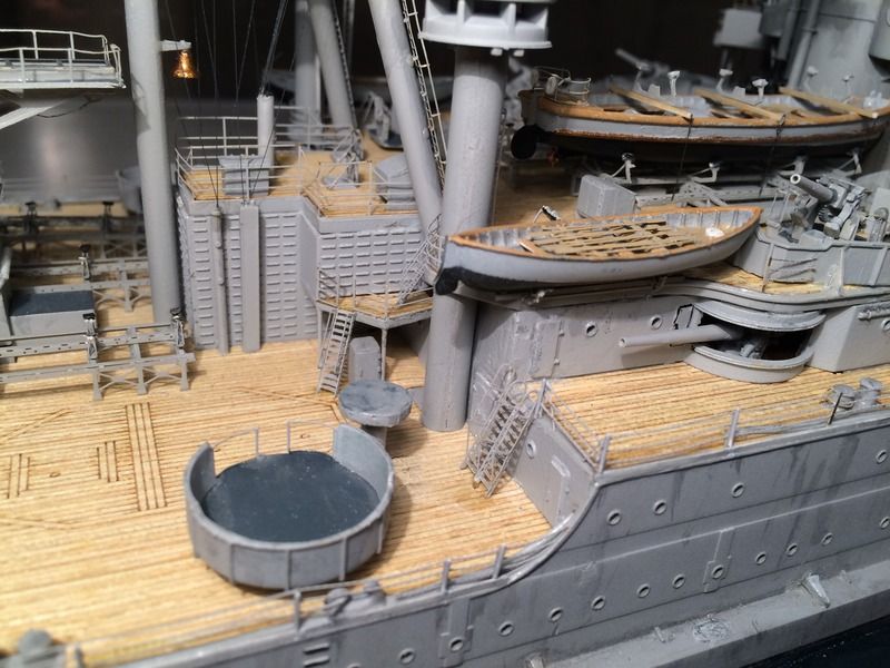

Always on the lookout for new detail to add to my model, I've decided to add more detail to the aft gun tubs thanks to Jon Rykert making me aware of the awesome photos of USS Tennessee after her last refit in Jul '40. Finding detail of any of the Battleships gun tubs is rare but this one of Tennessee's aft tub give us a glimpse of the detail on the back side of the tub.
You can slightly see a single bar railing and steps up to the tub.
I decided to replicate this look on my tubs.
Was this detail on the Arizona? I have no idea. I cannot confirm nor deny it was there given all the film and photos I have studied. If the guns were in place then I would say the railing and steps would definitely be there as well but, was this detail added after the guns were installed on the other Battleships?
PostPosted: Sun Dec 13, 2015 10:54 pm
Posts: 8339
Nice touch. I like it.

PostPosted: Tue Dec 15, 2015 7:49 pm
Posts: 674
Hi Jeff:
I think it enhances the otherwise bare gun 'tub'. In all likliehood, it was there. Looks good.
Mark

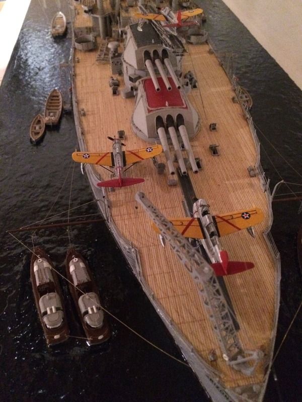

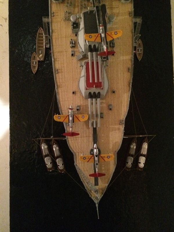

All boats and birds are now in place. I can finally start adding crew members.

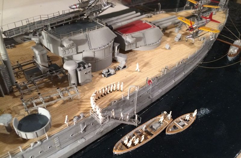

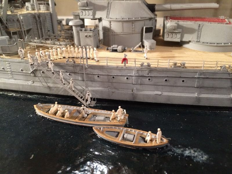

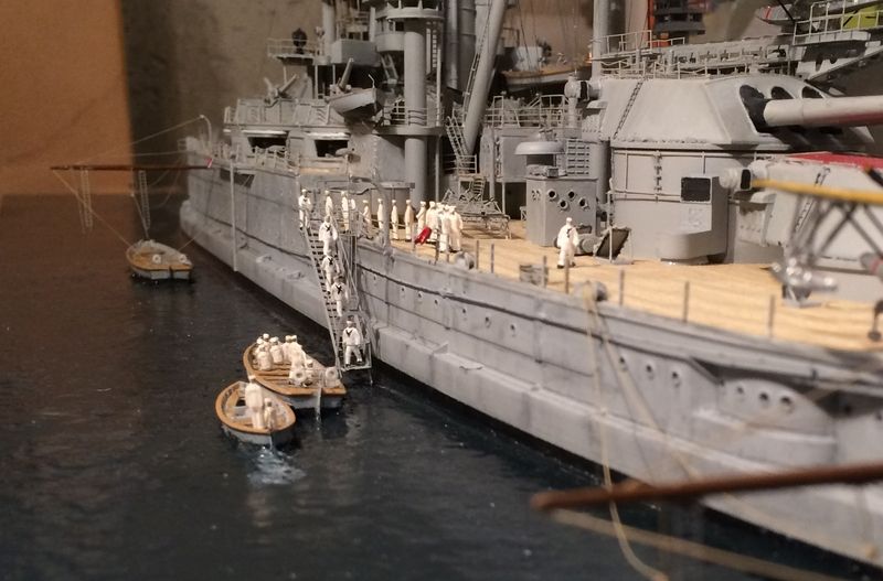

The first group of crew members have made it aboard but only for a short time though. They are lined up for liberty.
This photo taken aboard Maryland was the inspiration for this scene. The major difference being Summer whites vs Winter blues.

Curious about the furthest aft "boat boom". These were used not only with Jacob's ladders, but also for aircraft recovery. A sled or net was towed from the end of the boom, streaming aft and the aircraft taxied onto it and was hooked, such that the crane could hoist the aircraft from it's from the bridle. As such on Alaska a secondary brace boom is provided, but with a single boom a forward guy line would be necessary, I would think. Anyone know much about the rigging of these?
