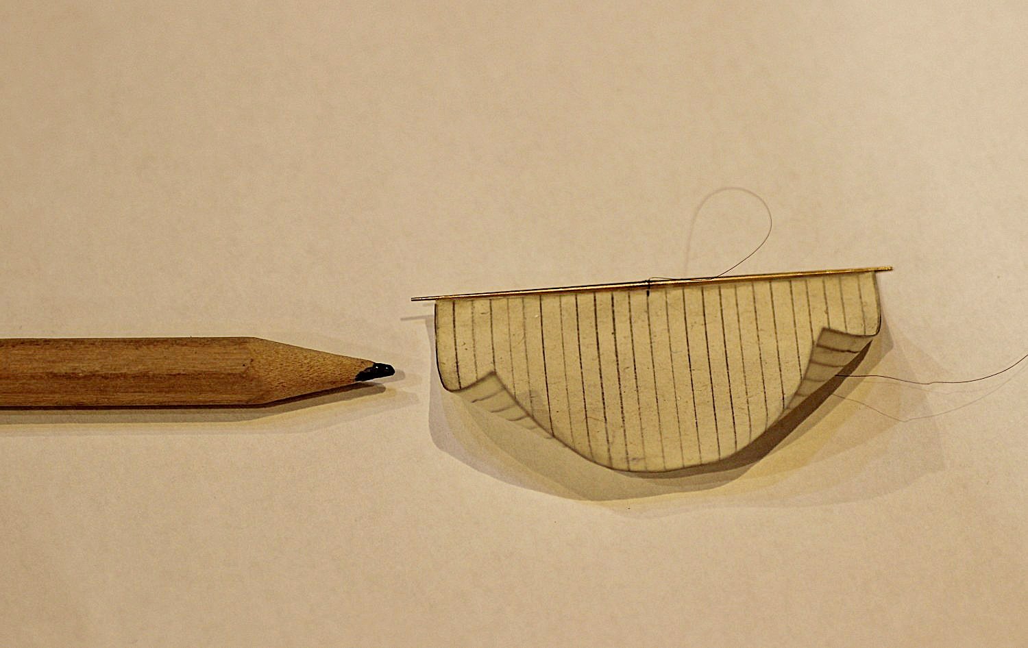

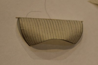

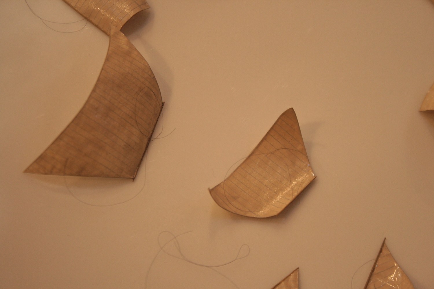

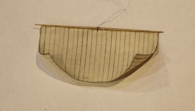

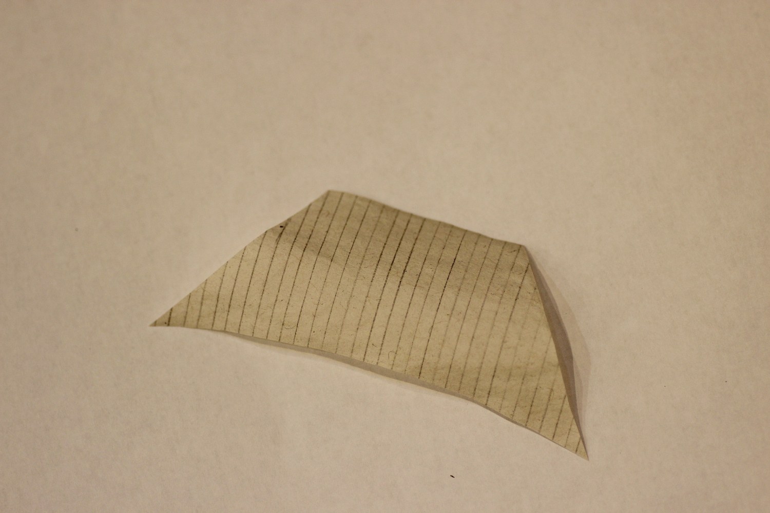

Today I was given by another lady friend (!! :smallsmile: ) some more lace type mesh.
( the darker one laid next to the previously favourite white one )
I have studied and debated this; I think the new mash may have a tighter weave ?

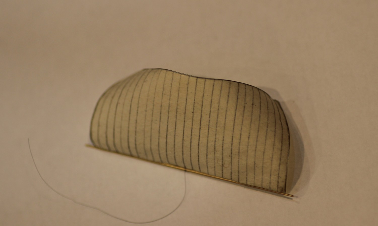

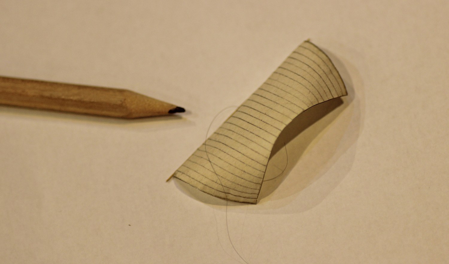

anyhow-- have also made another set of sails --this time using 2 mm seam spacing
Have cut and moulded these in the oven as before
and I have been gluing 0.1 mm copper wire ( butt edge to edge join! to the paper ) around 3 sides to simulate the boltropes
but also because that way I can shape the leeches to orientate correctly to sheet tension and direction.
It also holds the shape permanently !
The sail attached to teh yard is the lower foresail,
is are shown here BEFORE painting
( I shall be using watercolours --hence I have sealed the paper with varnish)
we shall see if the layers of thin paint will degrade the harshness of the seams and give a softer feel
will report in soon :big_grin:
regards
Jim Baumann

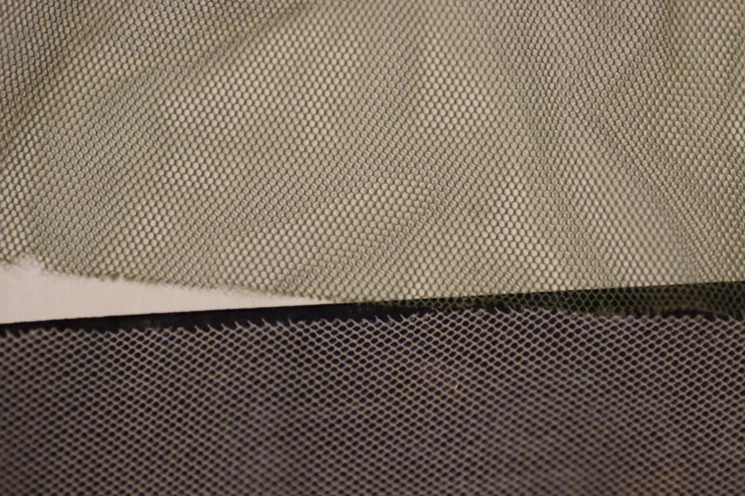

well now....
The netting has NOT stalled the build, but it is always at the forefront of my thoughts...
I reckon I need to install the netting before the ratlines, ( otherwise the netting install will damage the ratlines)
although the netting will make the passing through of lines( halyards and hoists etc to the belaying pinrails at the bases
of the masts more complicated and mean that I will inhibit any access to the waist and aft decks; so must
carefully consider that I am FINISHED in those areas...
so I have been making paper templates for the netting sections using
'post-it' notes--using the tacky side ( much de-tacked further with fingers !!)
==> to adhere gently to the central longitudinal bars whilst doing a gentle pencil 'rubbing' of the outside perimeter...
Now then....!!!

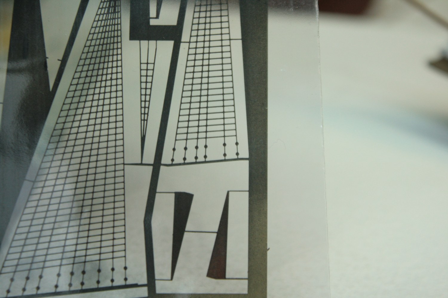

" our " HMS Victory man Dafi.... really very kindly indeed sent me some of his netting.
now coming from him of course--he being the "�ber-stickler" for precise detail... :big_grin: :wave_1: :thumbs_up_1:
obviously then.... it is a nice diagonal weave and is woven of satisfyingly thin thread lines ,
so that really is unarguable with, to this netting now not being the preferred netting for my model of HMS Mary Rose-
-allowing a view of the decks whilst being ' netted' !
a MONSTER enlargement comparative photo of the 'old' and the ' new' below....===> I think my mind is now made up! :thumbs_up_1:
DANKE !! :wave_1:

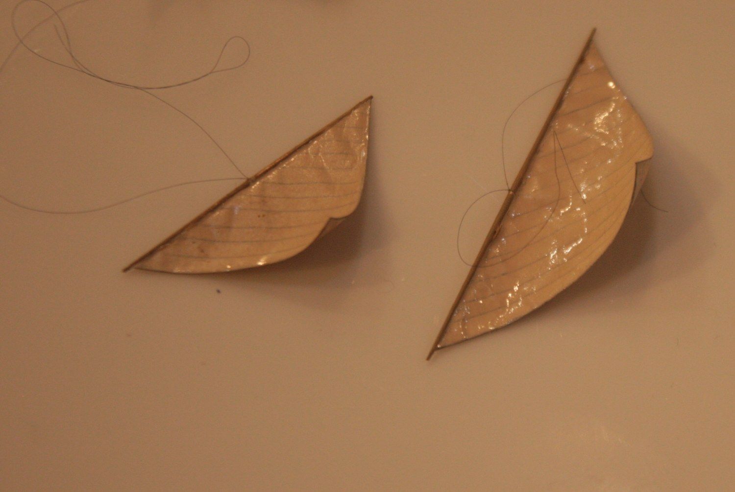

well after a few evenings of gluing 0.1 mm wire to the outside edge of the sails,
some paintwork directly on the sails and gluing to the brass tapered yard-arms,
I decided to let it all dry for a while-!
-before overcoating the sails inside and out in matt varnish .
I will then very gently work into the sails a bit more with watercolours, a few very subtle light hues.

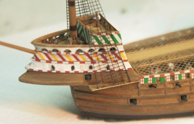

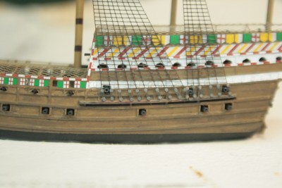

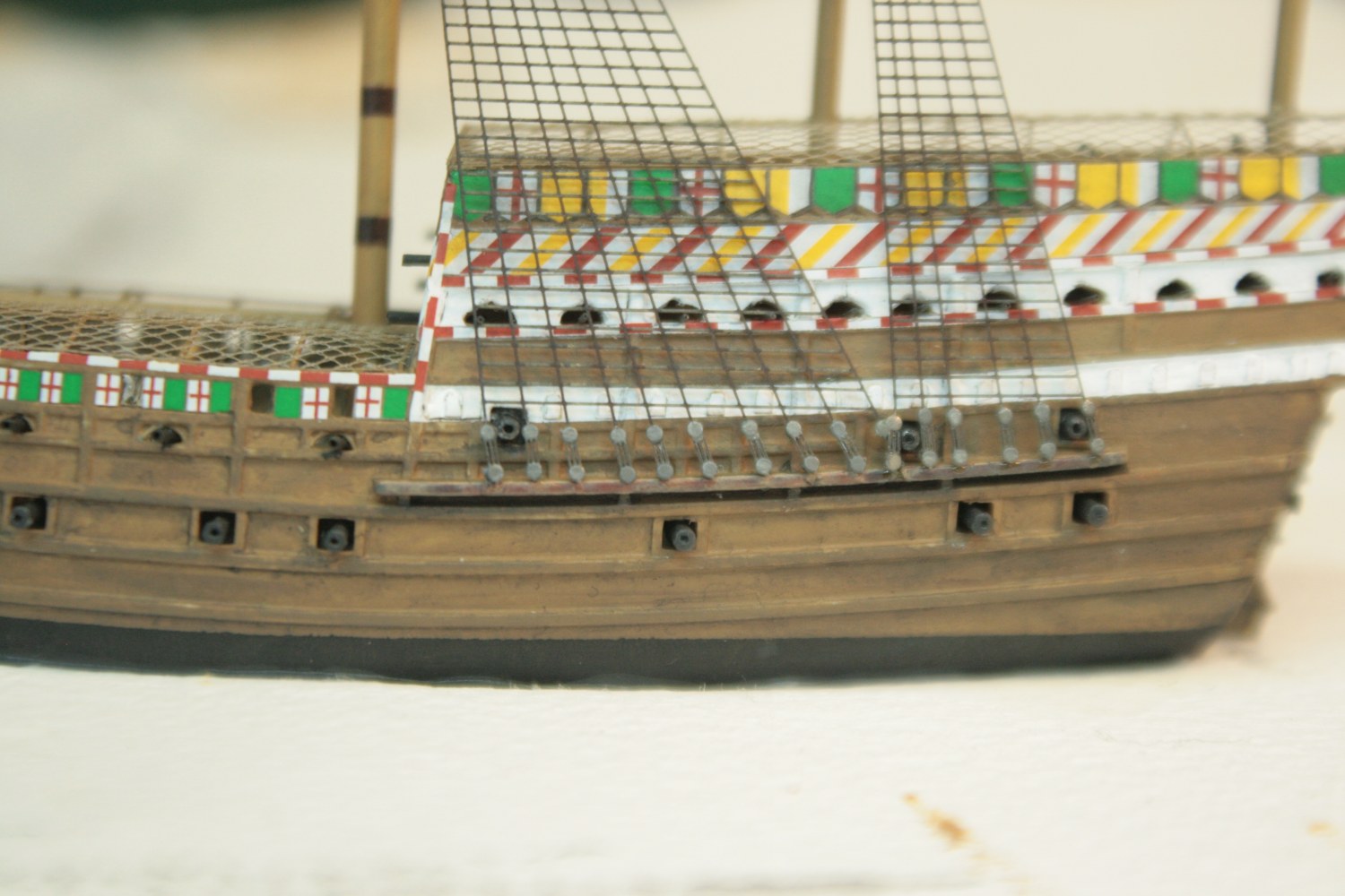

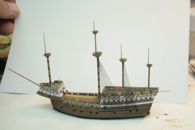

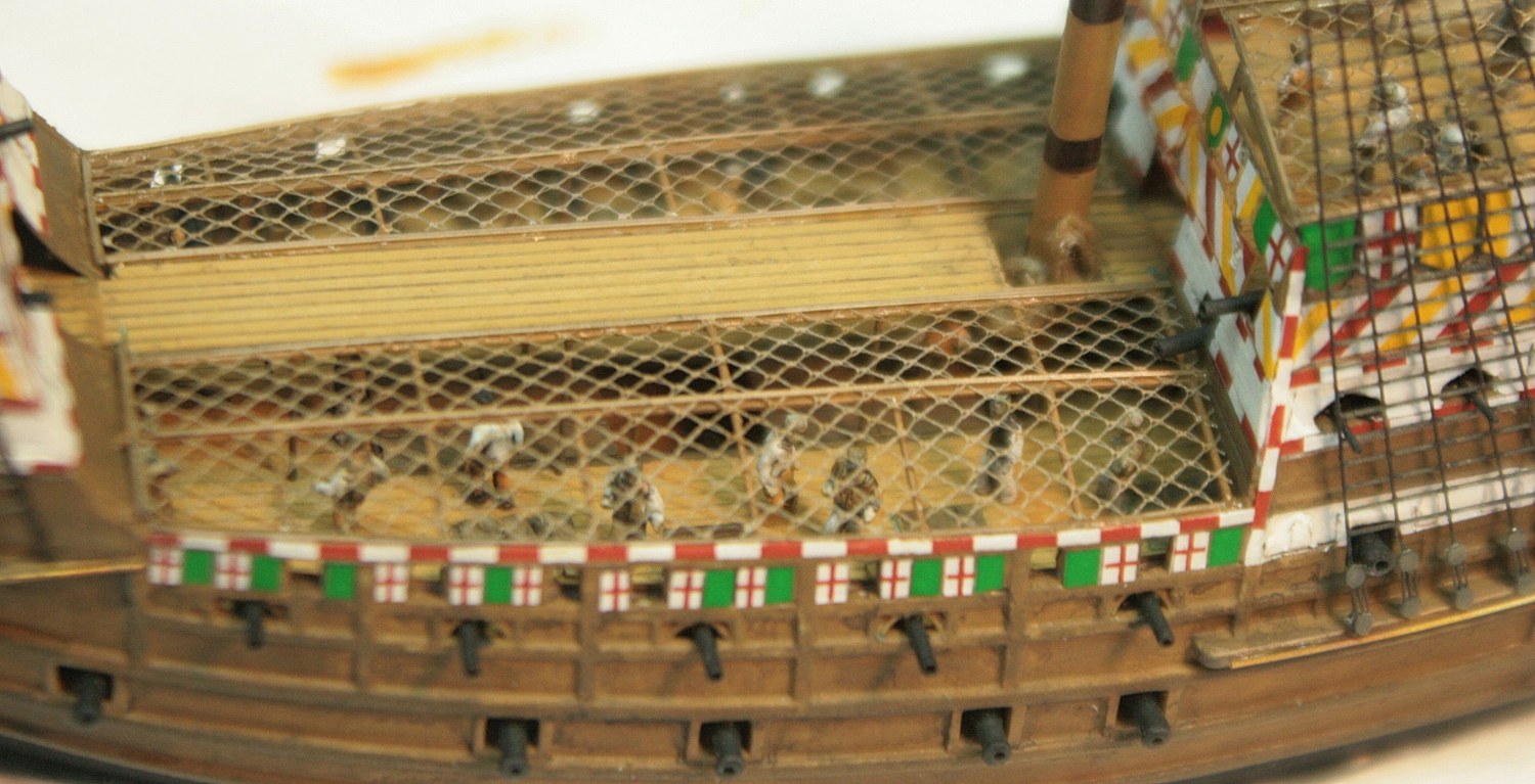

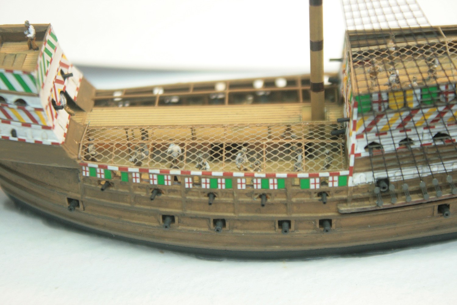

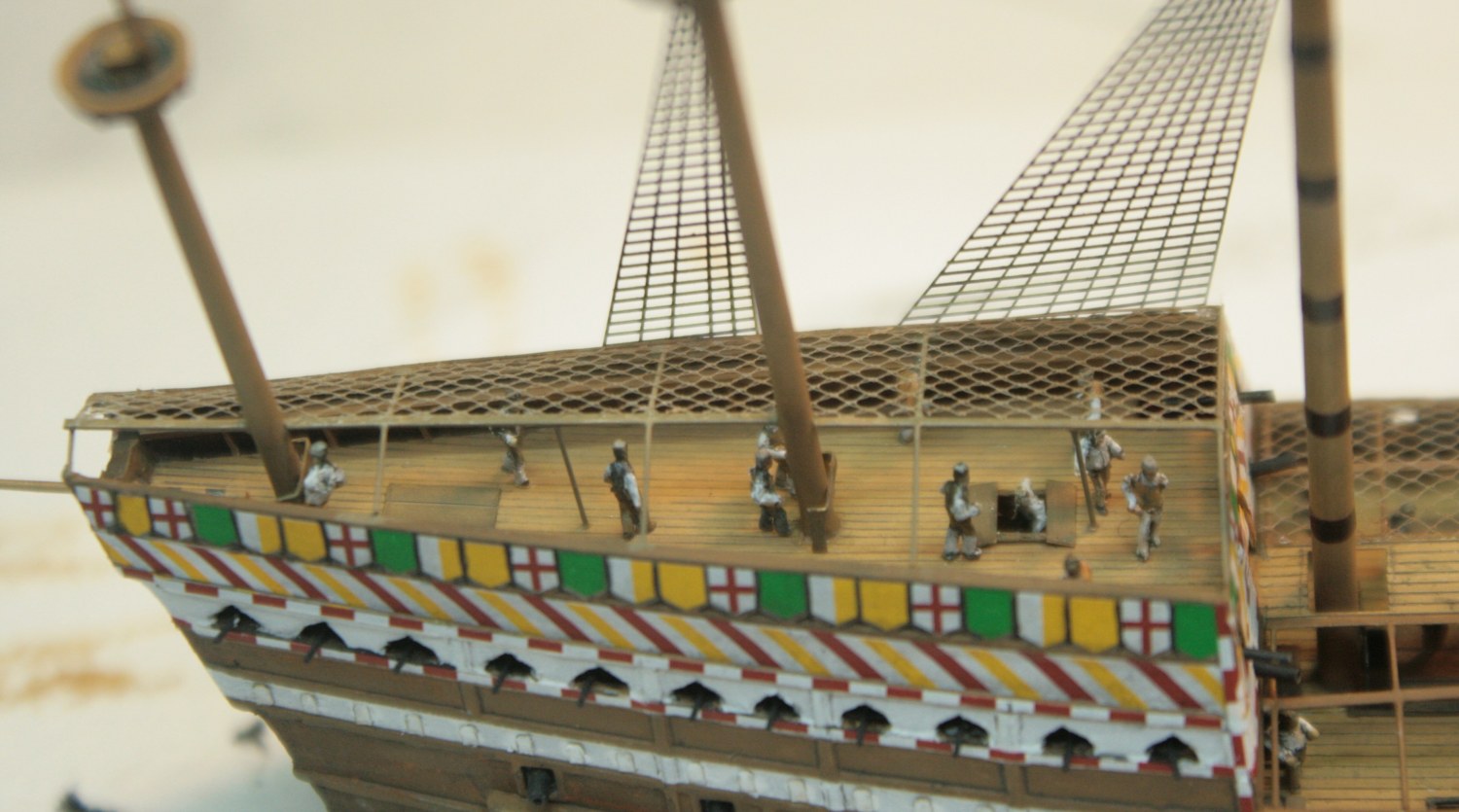

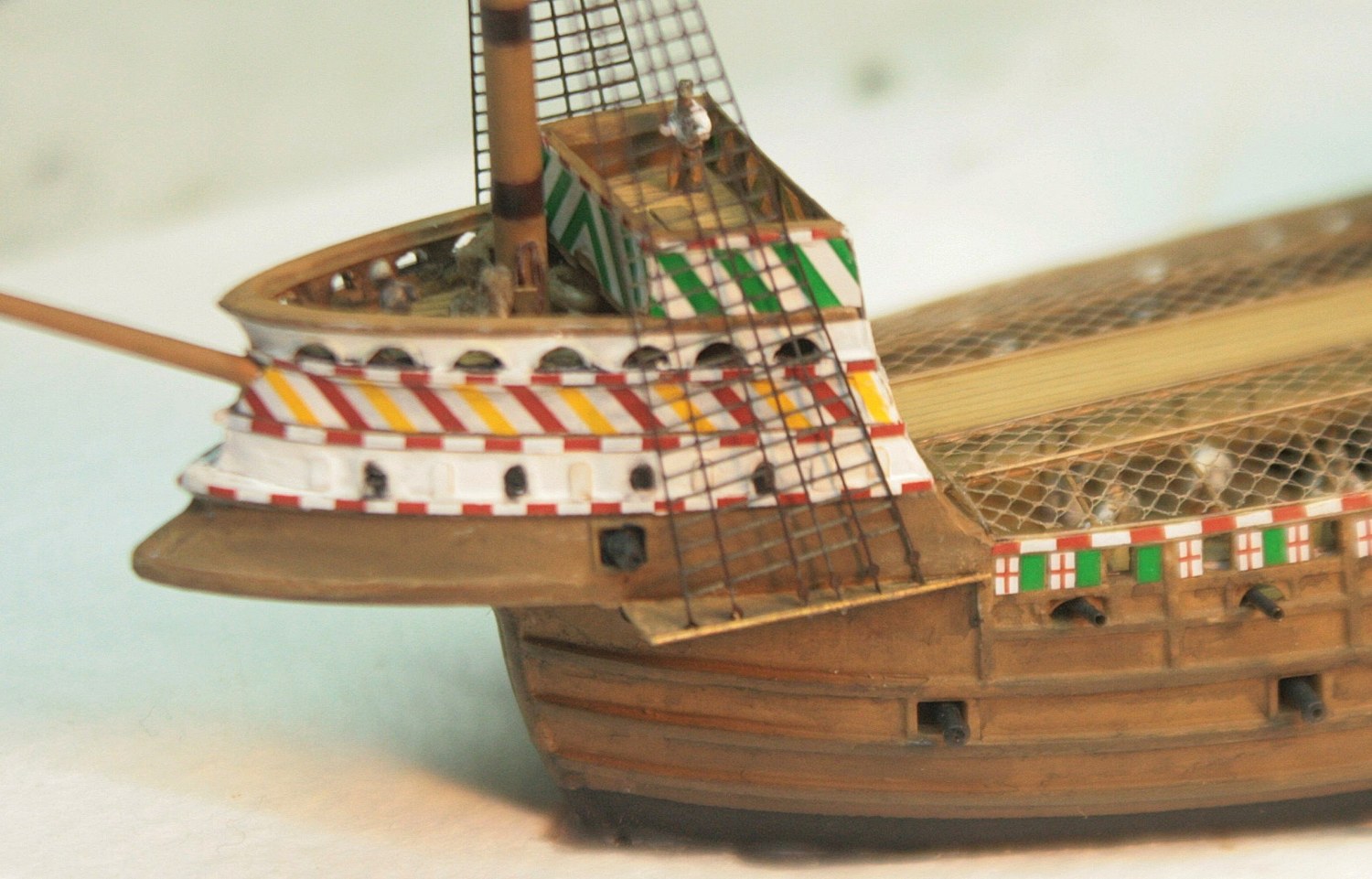

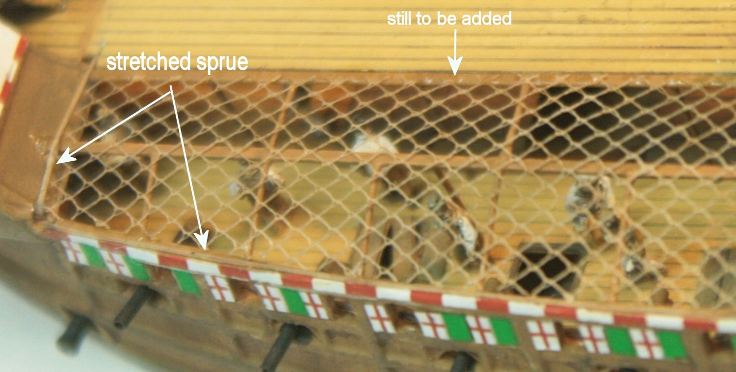

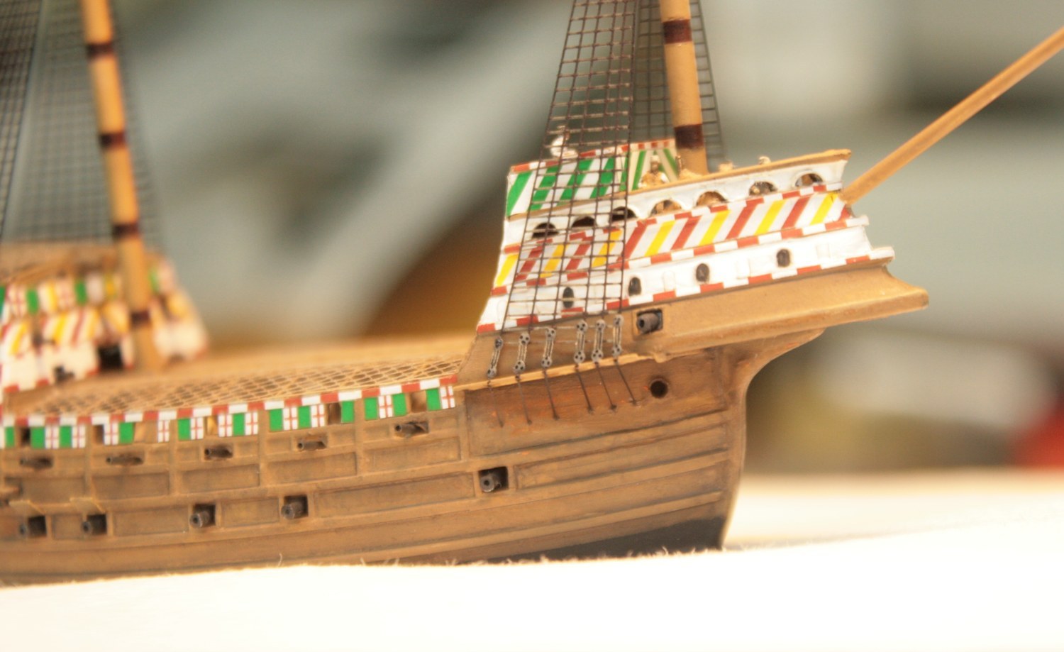

inevitably... I had to try out the netting in action on the ship
i have only applied half -
so that I can still place some rope coils on the belaying benches at the mast baes
( coils are in build now )
along with the coiled tails of the halyard braces and the sail braces
anyhow
herewith some pics of the much discussed and fabled antiboarding netting
and some of the ratlines port side--

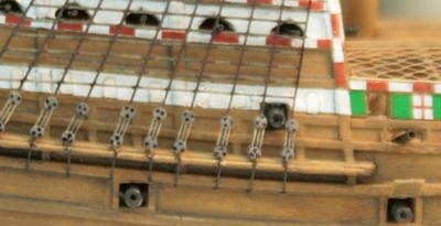

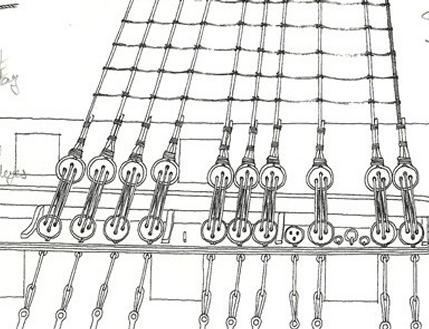

The ratlines were quite tricky to get aligned to allow the footropes to be horizontal
The AOTS book shows the footropes to be inclined--but I have yet to see any ratlines with the footropes at an angle on any ship
The netting was glued on with tiny bits of CA, the nylon or polyester based mesh being quite recalcitrant to my
gluing endeavours...
Once installed the outer cut edges were covered up with thin pieces of stretched brown sprue that hid the raw edges

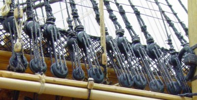

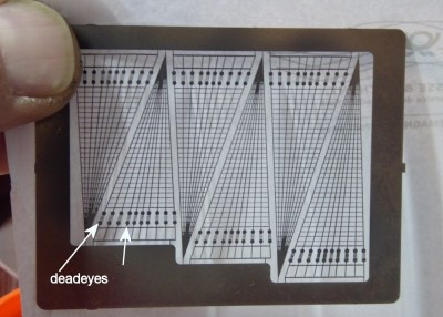

The Scale Warship ratlines were OK-- but I felt that the dead-eyes were a bit spindly for my linking
so I cut some more substantial deadeyes of a 1/600 "Saemann" set (from Germany
which looked more in keeping to my ideas
The overall end effect is better-
-I intend to add the dots and lashing ends with a fine Rotring pen

the mesh--was dyed in a really really( almost treacly!) strong mix of instant coffee, as neither tea of other dyes would touch it!!
I ' fixed' the dye ( hopefully ) in a bath of vinegar ) -- useful that Katrin's kitchen is well stocked !
Before adding more mesh...(!) I added rope coils at all masts on the belaying rails at the bases of the masts, as well as some rope coils on the waist deck and foc'sle
These wree made by winding thin beige thread around cocktail sticks 5 turns at a time, covering in white glue to soak and then wiping away excess.
Once set I slipped the off the cocktail stics, cut, shaped and applied!

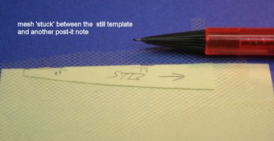

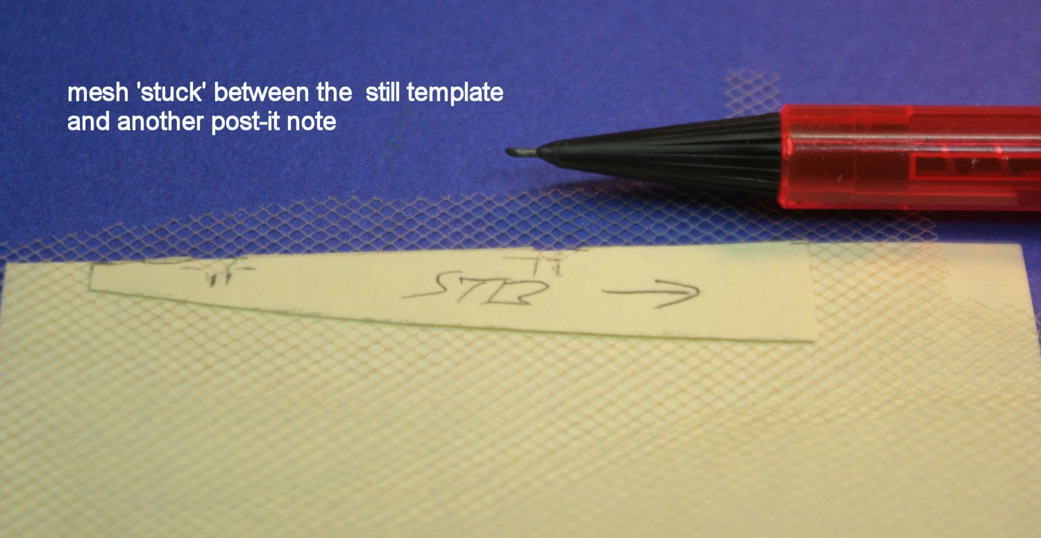

Cutting the mesh with scissors ( sharp new Fiskars orange handles needlework long blade) was very successful, the cut edges were crisp and accurate,
however so as to prevent distortion of the netting whilst cutting I sandwiched the mesh in between the tacky part of a post-it note
and my template( made using the tacky part of the post-it note.
This meant that the open edges of the mesh were supported whilst cutting and template removal, without distortion
Once glued in place using minute amounts of glue applied on the end of a piece of copper wire, I covered the raw edges with pieces of stretched brown sprue .
This gave a crisp outline and a welcome bit of contrast in brown and beige
==> result was satisfactory!

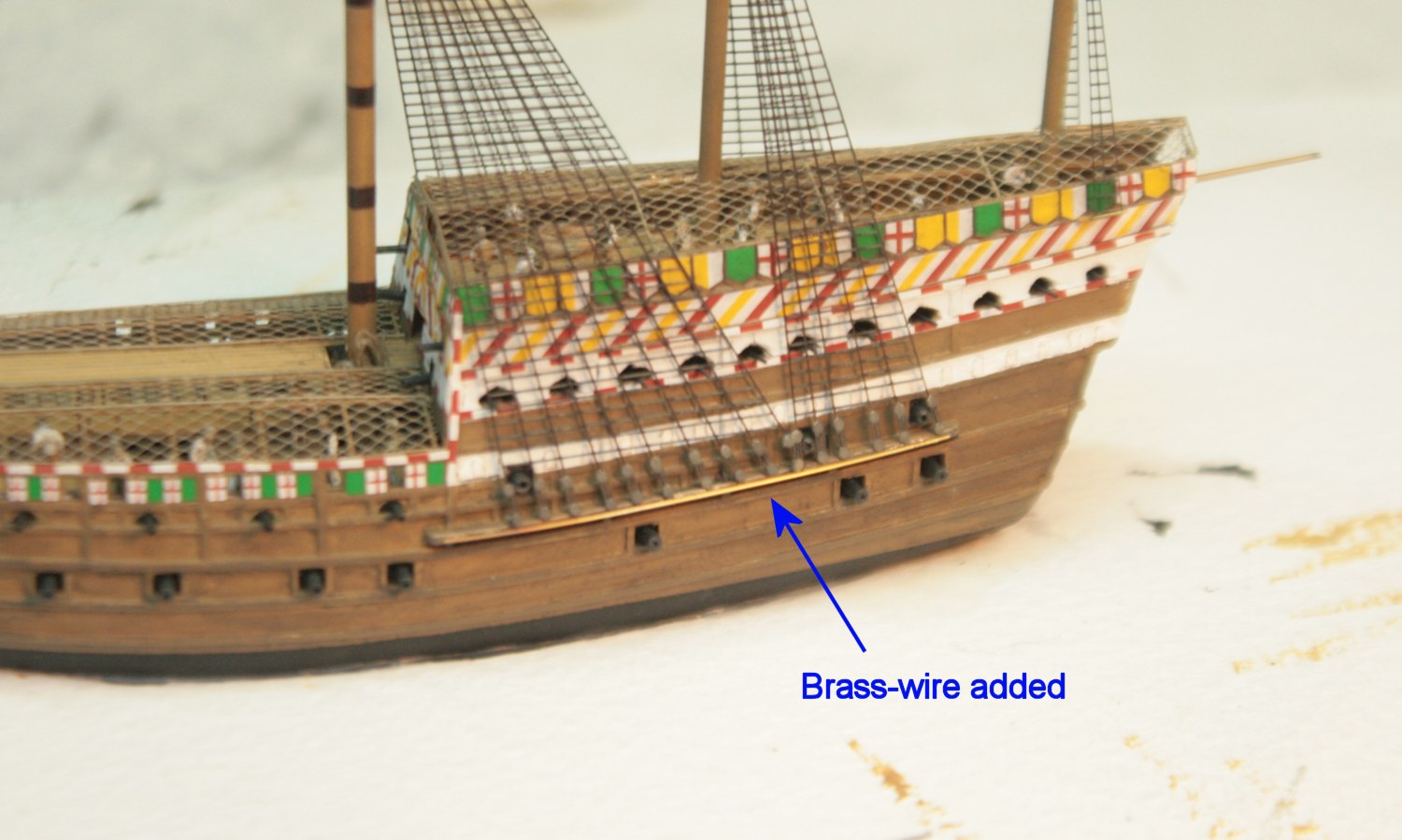

the fwd ratline ' shelf--a bit conjectural amybe-- but needed because of the shape of the vessel was added
afterwards I completed the installation of the ratlines, these were generally ok--though suspect my mast positions may have been out a wee bit.
It is unfortunate that the horizontal foot-ropes are etched the same diameter as the vertical shrouds,
I endeavoured to disguise this somewhat-not completely successful alas-- by dry-brushing the foot-ropes from above downwards only in a lighter brown
The channels ( shelf!) that form the bottom of the ratlines are alas a bit clunky on the kit moulding ( note to self--assume nothing! )
-I mitigated this by gluing on a piece of brass wire --this reduced the visual impact a bit...
The deadeye lashings--which I used from the an old Saemann PE set -- were all added., blocks painted on a lighter wood, individual
lashings lightly drybrushed and the 'eyes' marked in with a Rotring pen- this required quitea few gos at times as the deadyes are very small and it was not always perfect first time !!
the 'chains' underneath the channels were added uisng black stretched sprue glued on and trimmed in situ with liquid cement
( as per my usual rigging method
see here: viewtopic.php?f=4&t=37536
the effect at normal viewing distance is pleasing as it removes the ' blank' look of the deadeyes otherwise
( Of course the best option would be to do it ' properly !!! )... but I fear that I doubt It could do it repeatable accurately...

bothersome...
Eureka! :big_grin:
I had ' dotted' almost all my deadyees incorrectly-- :doh_1: :doh_1:
a quick repaint this evening and tomorrow I shall 'dot' the correct way round.
==> Moral of the story..-- do not rely on what one thinks one knows.... :big_grin:
the correct way is a below

Oh Jim, how could you!!!
But the rest is wonderfully done :-)

Ah, yes, I was just about to point out that your deadeyes were upside down but you beat me to it :)

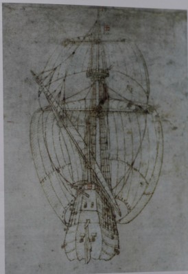

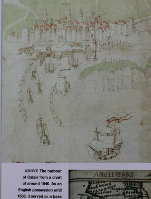

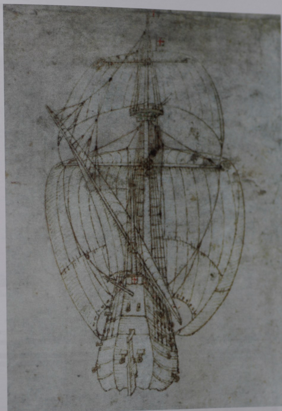

whilst on the subject of matter sailing ancient...
some illustrations of the perios suggest that the latten aft sails--mizzen and bonaventure where set in an unusual fashipn
ie with the leech to windward
( kind of asymmetric spinnaker style !--
encs images below
I have made the sails already so I shall be presenting the model like this-- it is an interesting look ,a talking point backed up...
rightly or wrongly by illustrations of the time :big_grin:
( I guess it was less effort to present the yard like this rather than get the yard round the mast to clear shrouds on to the stb side? )
encs
waddayallthink?
JIM B :wave_1:
