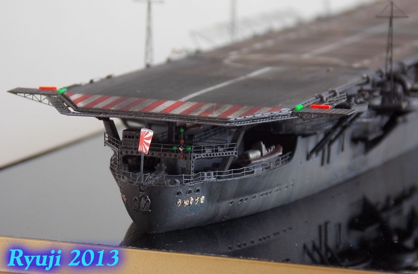

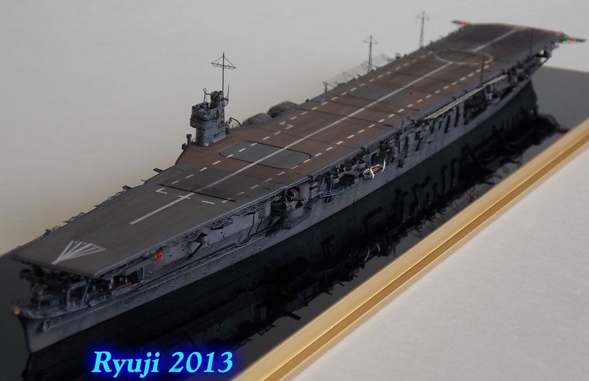

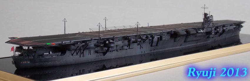

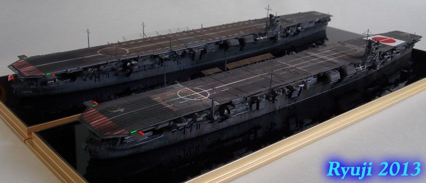

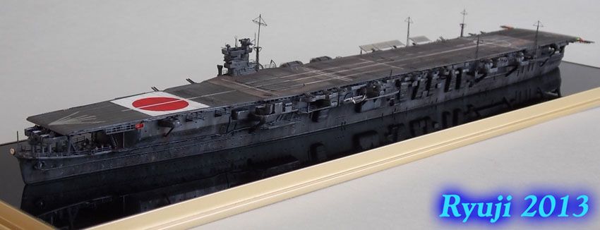

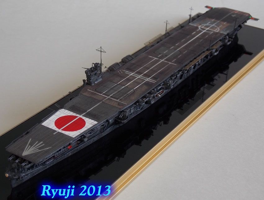

IJN Soryu 1938 version (Fujimi with Fujimi photoetching set).

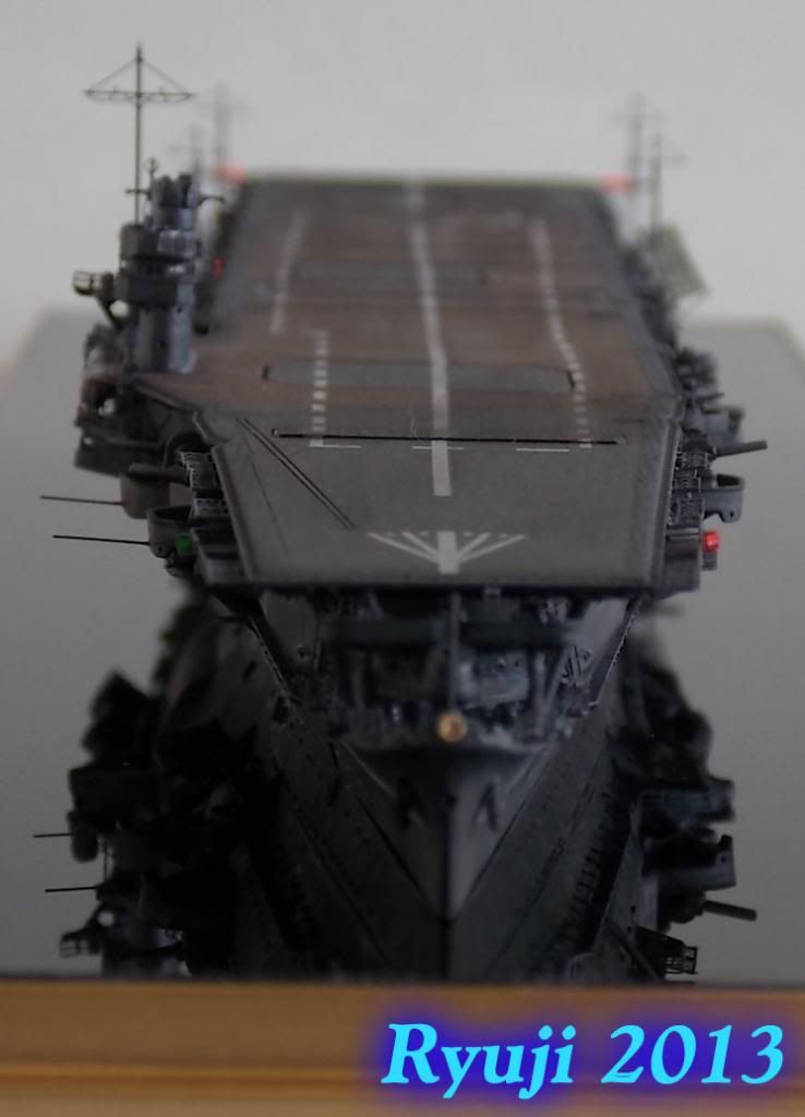

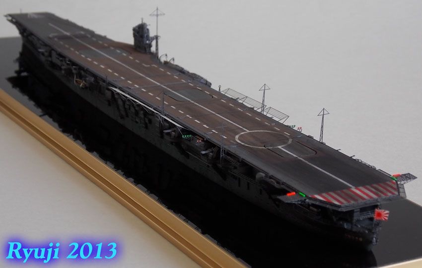

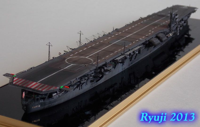

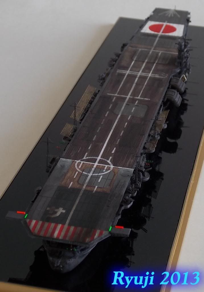

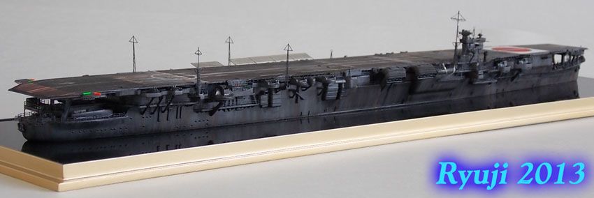

1942 version (Aoshima with Aoshima and Fujimi photoetching set)

PetrolGator
Posts: 2353
Location: Herndon, VA
Re: 1/700 IJN Soryu 1938/1942
Post by PetrolGator »

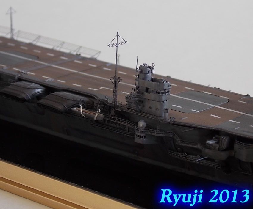

Uh, wow?
How did you do the fantastic deck weathering?
Again, wow.
- Chris

Angeliccypher
Posts: 1381
Post by Angeliccypher »
I second Petrol on both the WOW and how did you do the deck weathering?

Christian M.
Posts: 967
Joined: Sat Oct 06, 2012 4:34 pm
Location: Cologne / Germany, sometimes Poznan/ Poland and Chessington/ UK
Post by Christian M. »
Angeliccypher wrote:I second Petrol on both the WOW and how did you do the deck weathering?
And I'm n� 3 on board with WOW and how did you make this awseome great weathering... :wave_1:

Post by Ryuji »
Thanks!
First i painted with lacquer color (Gunze flat brown), then I wet the surface with enamel thinner and painted the weathering effect with enamel flat black. Then with a dry brush I painted with Tamiya enamel flat earth.
The enamel thinner/paint not attack the lacquer, so if I exaggerate the effect, I can clean and reduce the weathering with the thinner.
*BTW, I posted bigger size images in my Deviantart page. :cool_2:

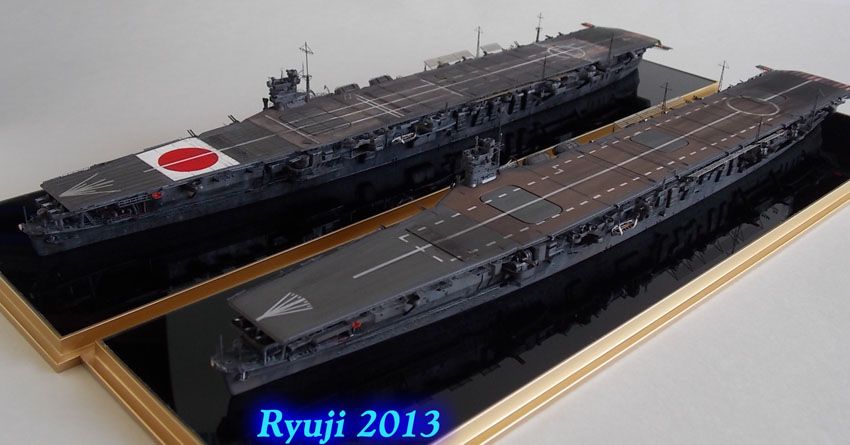

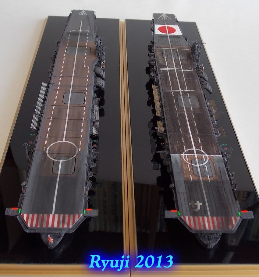

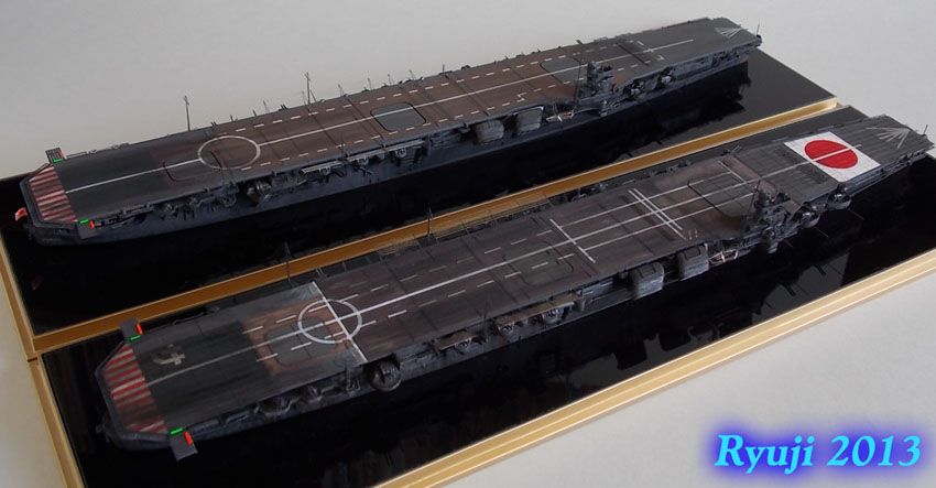

Great project, great builds. So, what was lacking from the Aoshima PE that required some of the Fujimi set?

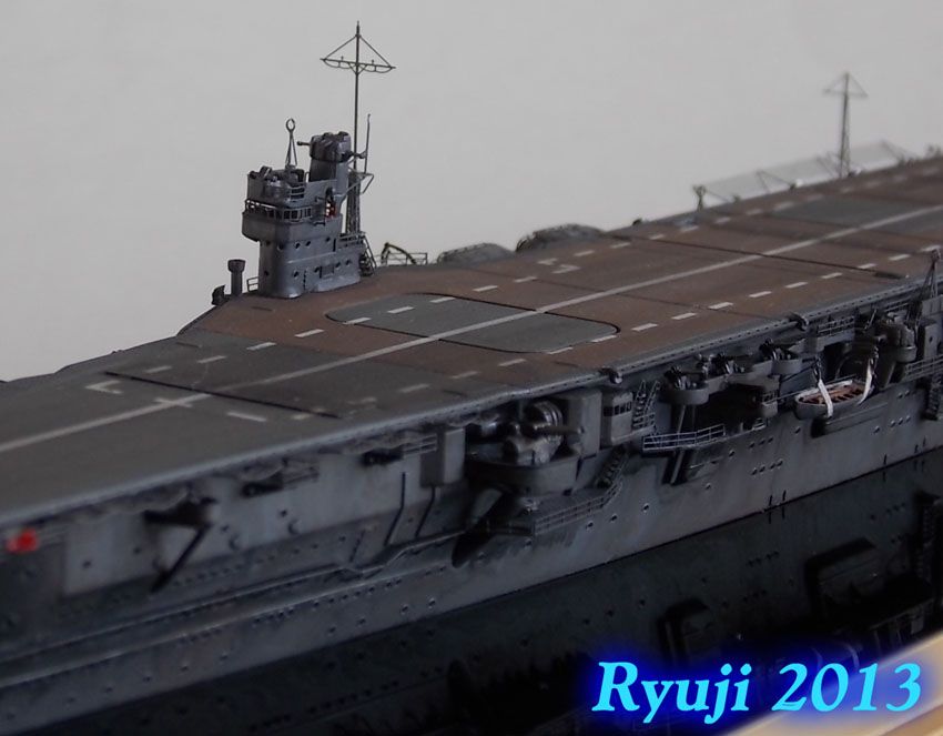

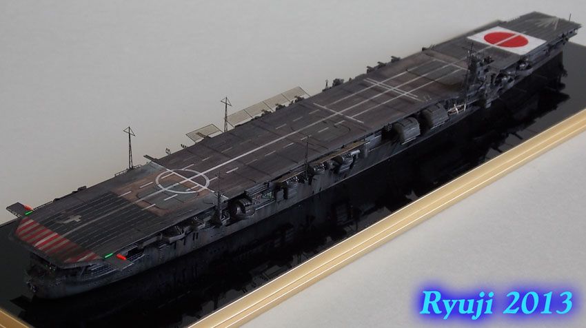

Silly question what did you use for the aircraft landing lights? And how did you get that bright color!? Wonderful job!!!

redoctober27 wrote:Silly question what did you use for the aircraft landing lights? And how did you get that bright color!? Wonderful job!!!
I used evergreen plastic strips and painted with Gunze fluorescent color (red and green).

Dan K wrote:Great project, great builds. So, what was lacking from the Aoshima PE that required some of the Fujimi set?
Thanks! Aoshima set is a bit incomplete (not include catwalk parts) and Fujimi set have better mast and antena parts.

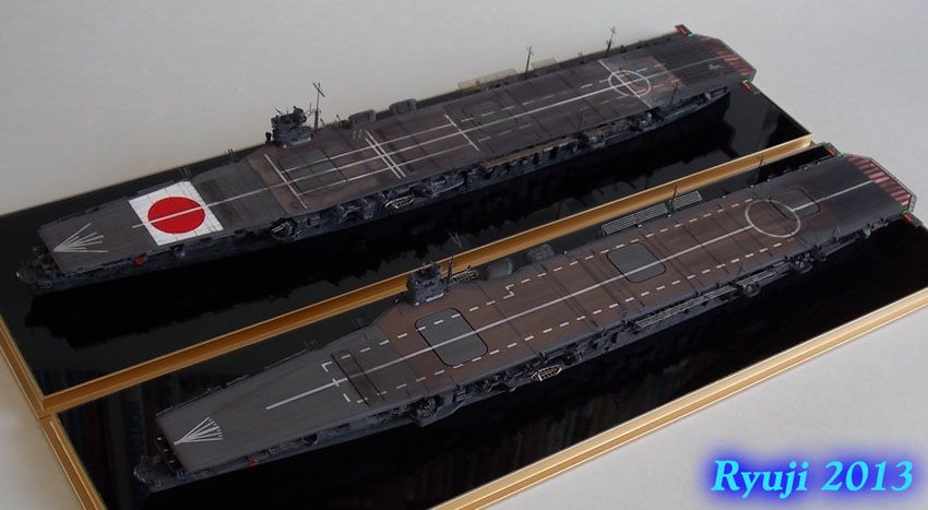

Excellent work Ryuji!! and like I wrote before great comparison project :thumbs_up_1: :thumbs_up_1:
