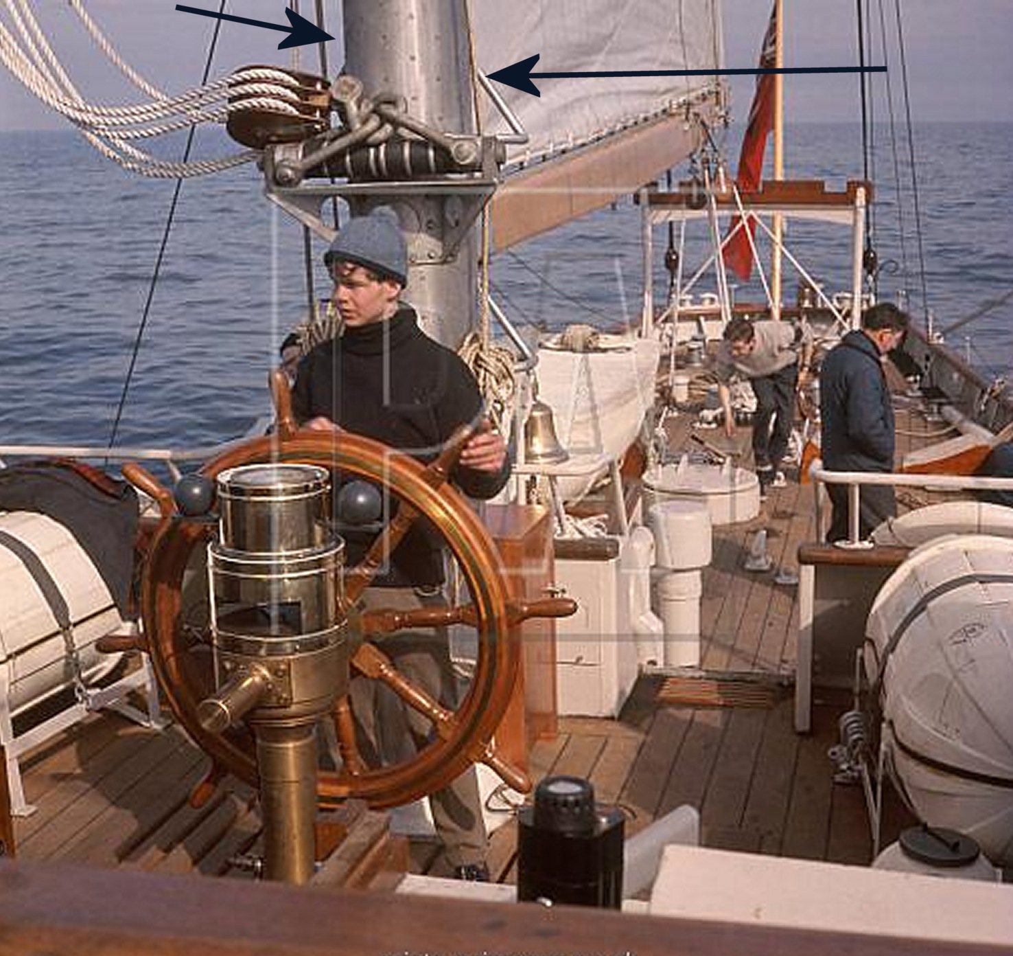

Some candid photos posted in various threads on the net from people who sailed on the vessel give good view of much of the deck detail

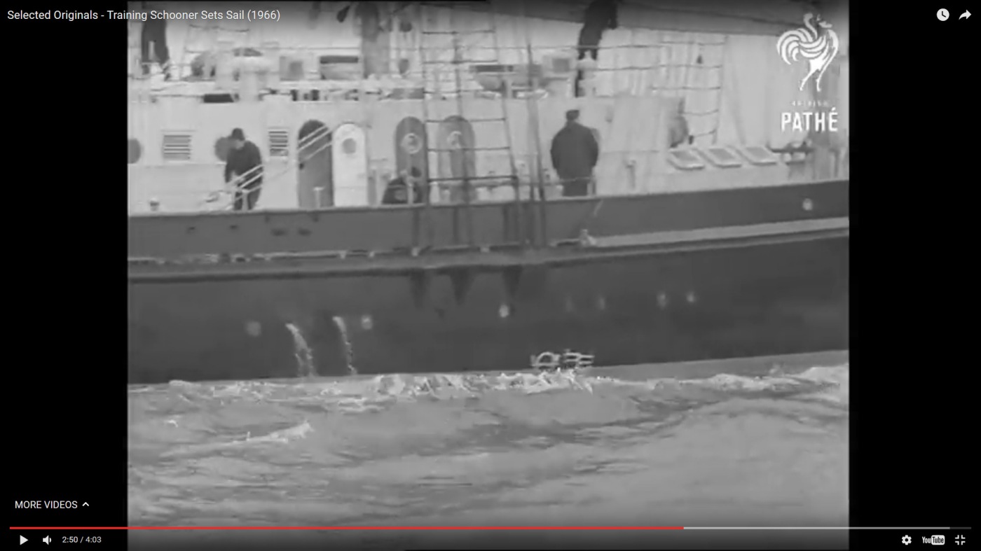

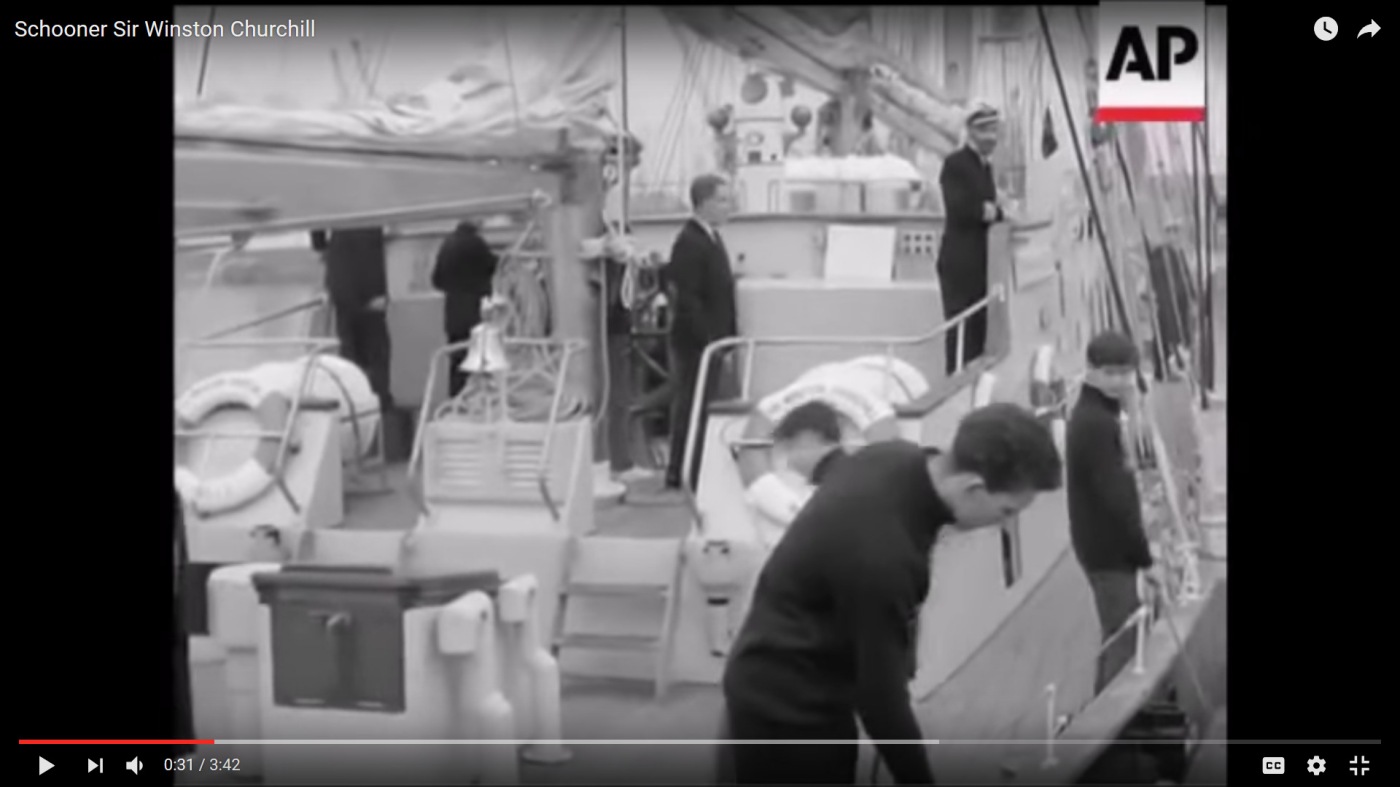

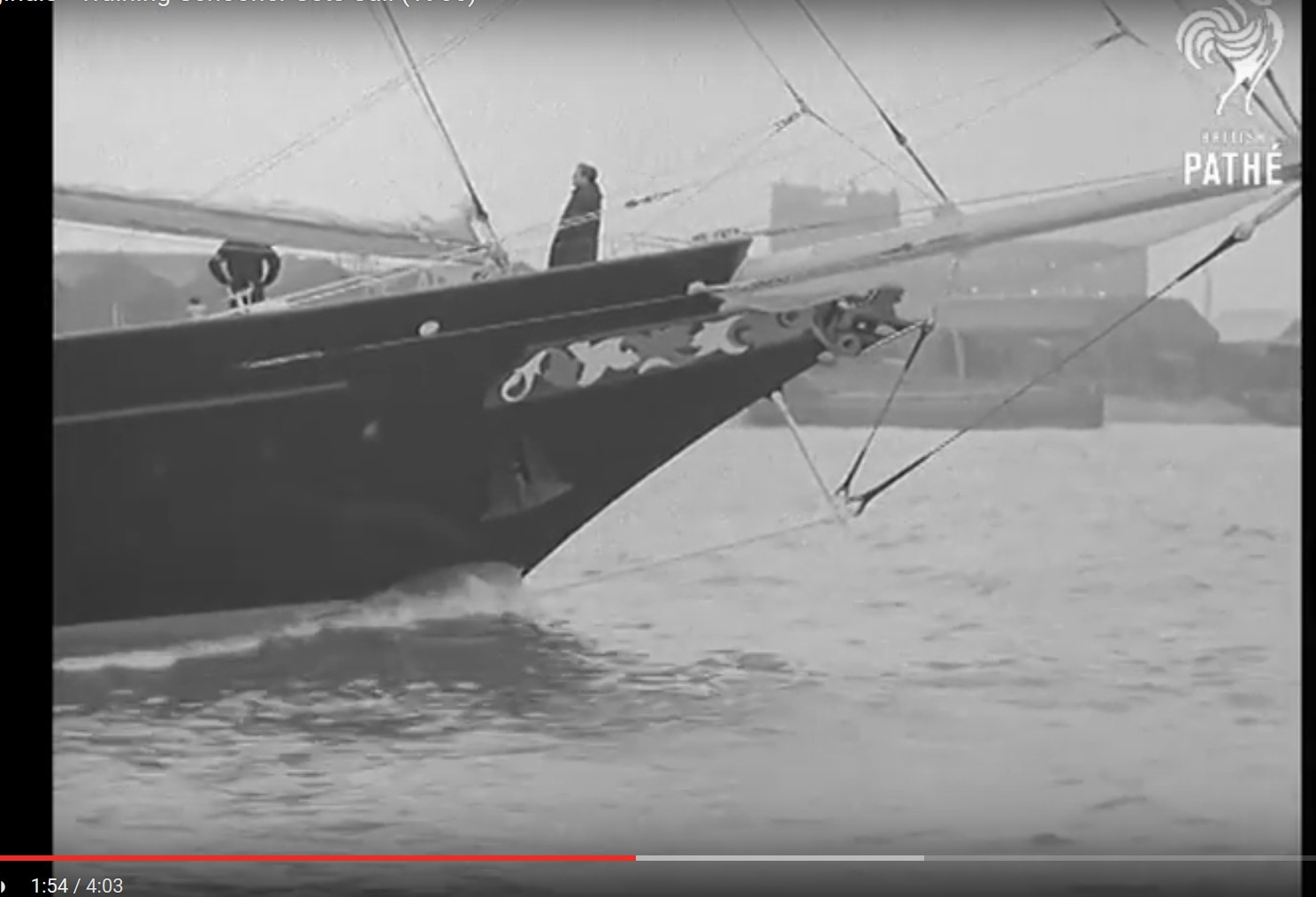

By far the most useful source of images so far has been grabbing screenshot stills from old Pathe News- cine-reels
examples below

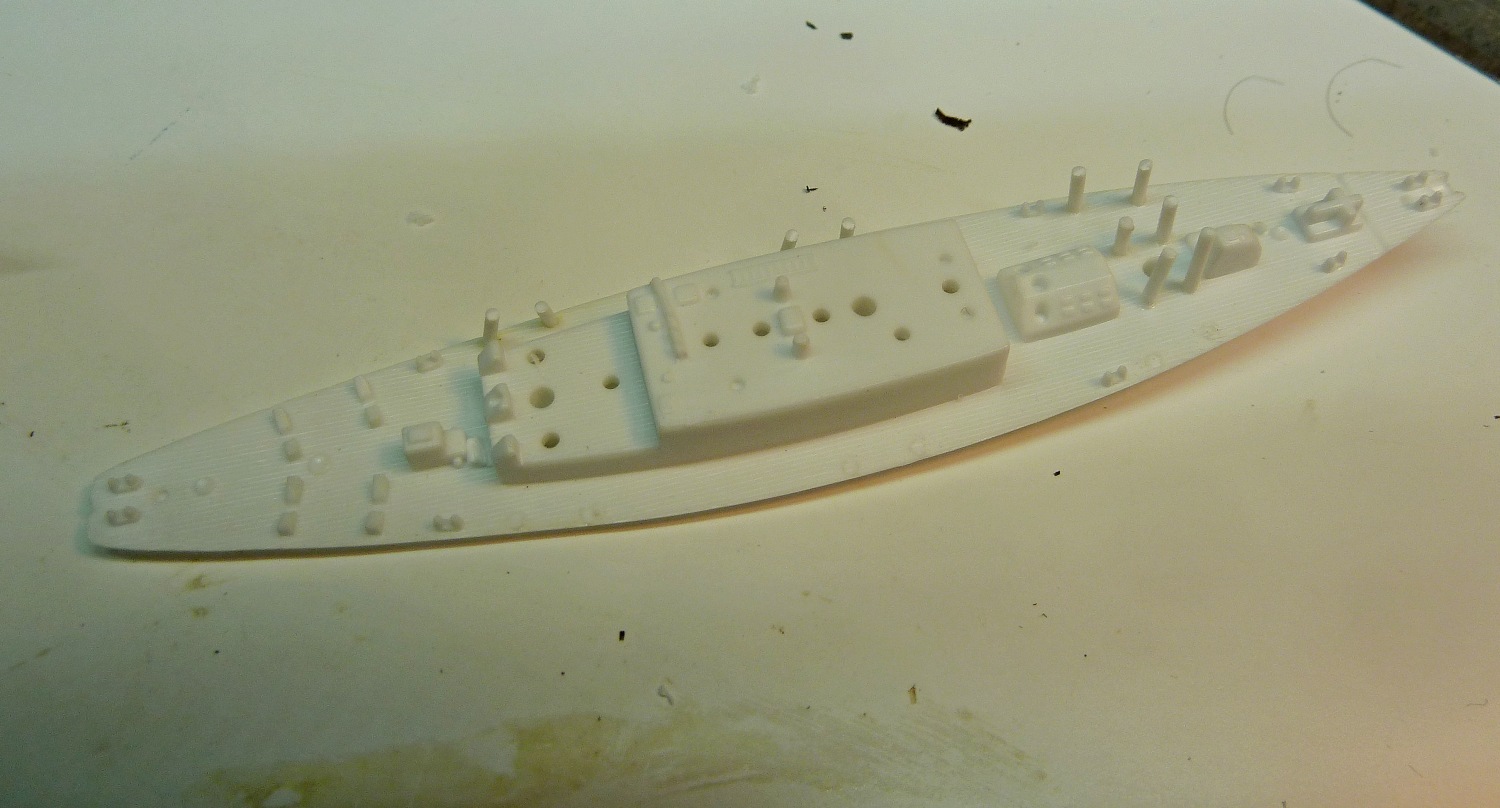

The hull in outline scales well and looks pretty good!
Every hole on deck had to be plugged with styrene rod

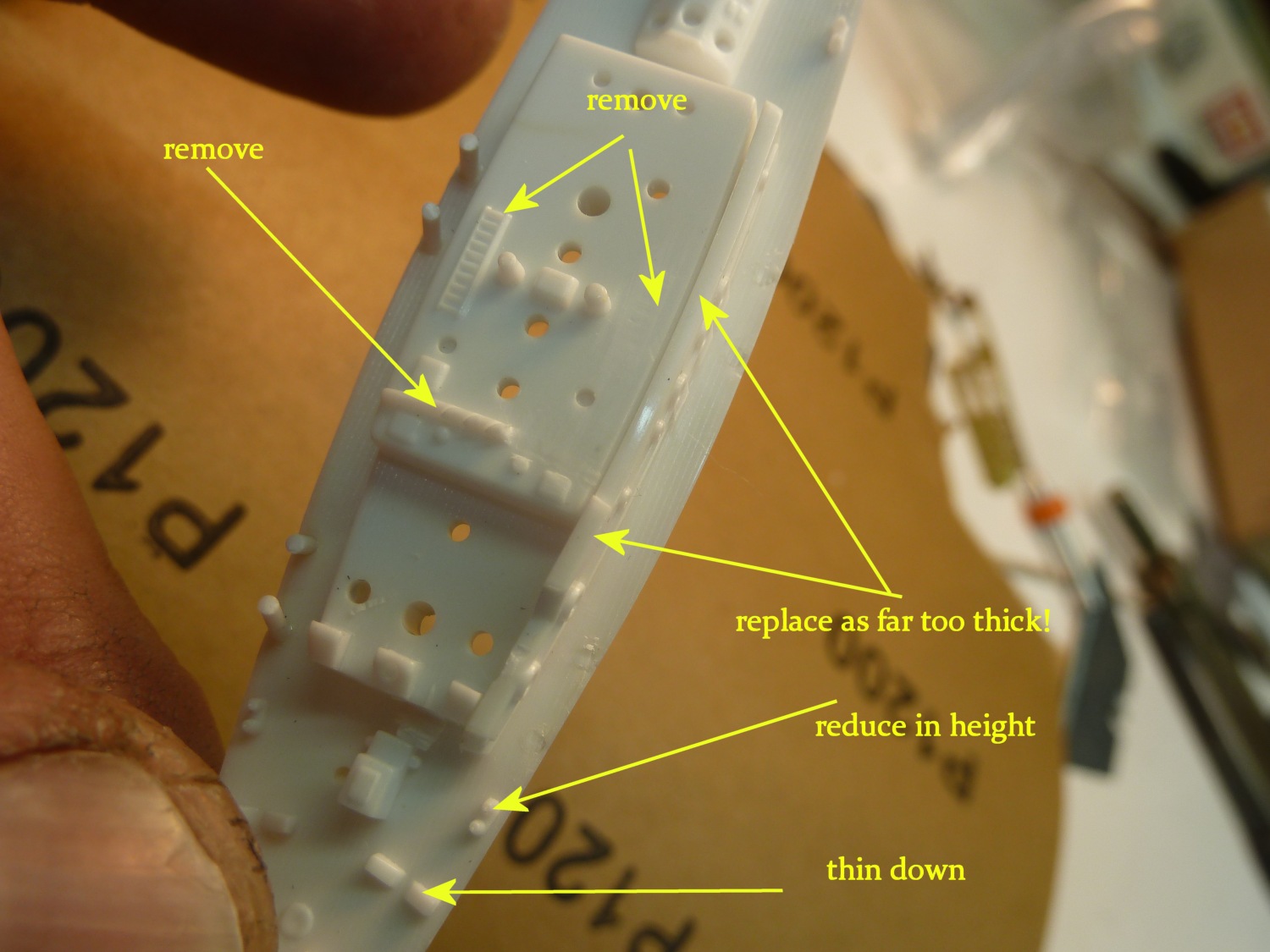

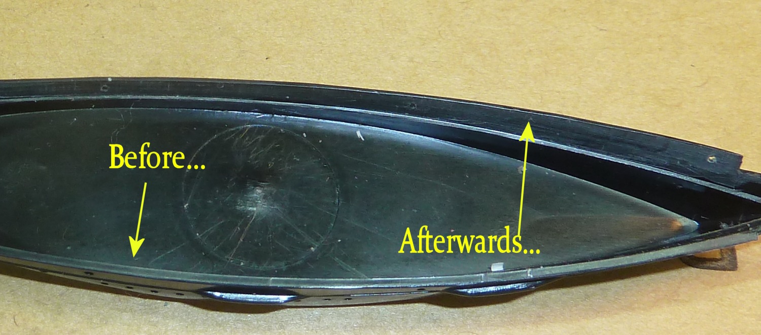

I immediately started thinning down the vastly over-scale thickness of the topside bulwarks

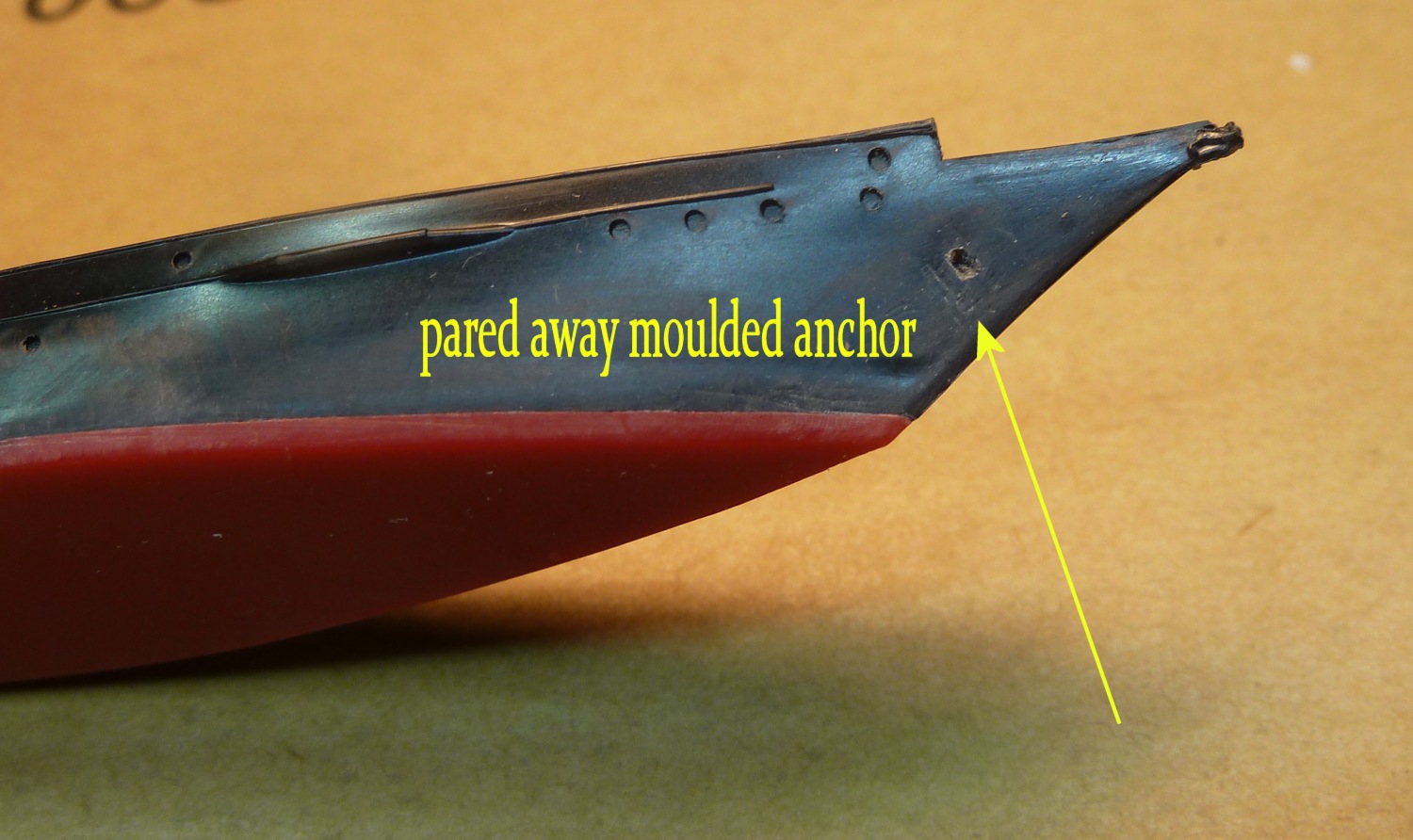

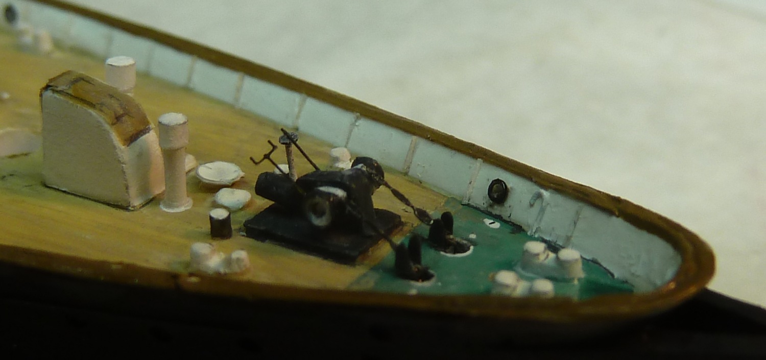

along with the odd shaped and sized anchors

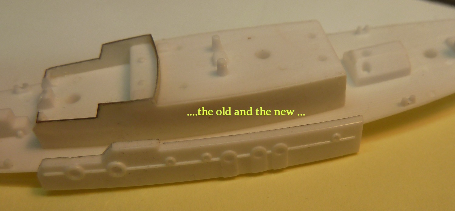

The cabins side parts which would also form the bulwarks of the central helms station cockpit
were vastly over-scale with clunky detail --so much so that the cabin doors in scale would not have had sufficient room to open !
Much scraping later, some new cabin sides in much thinner material,
some brass strip and copper wire and patience ! :thumbs_up_1:

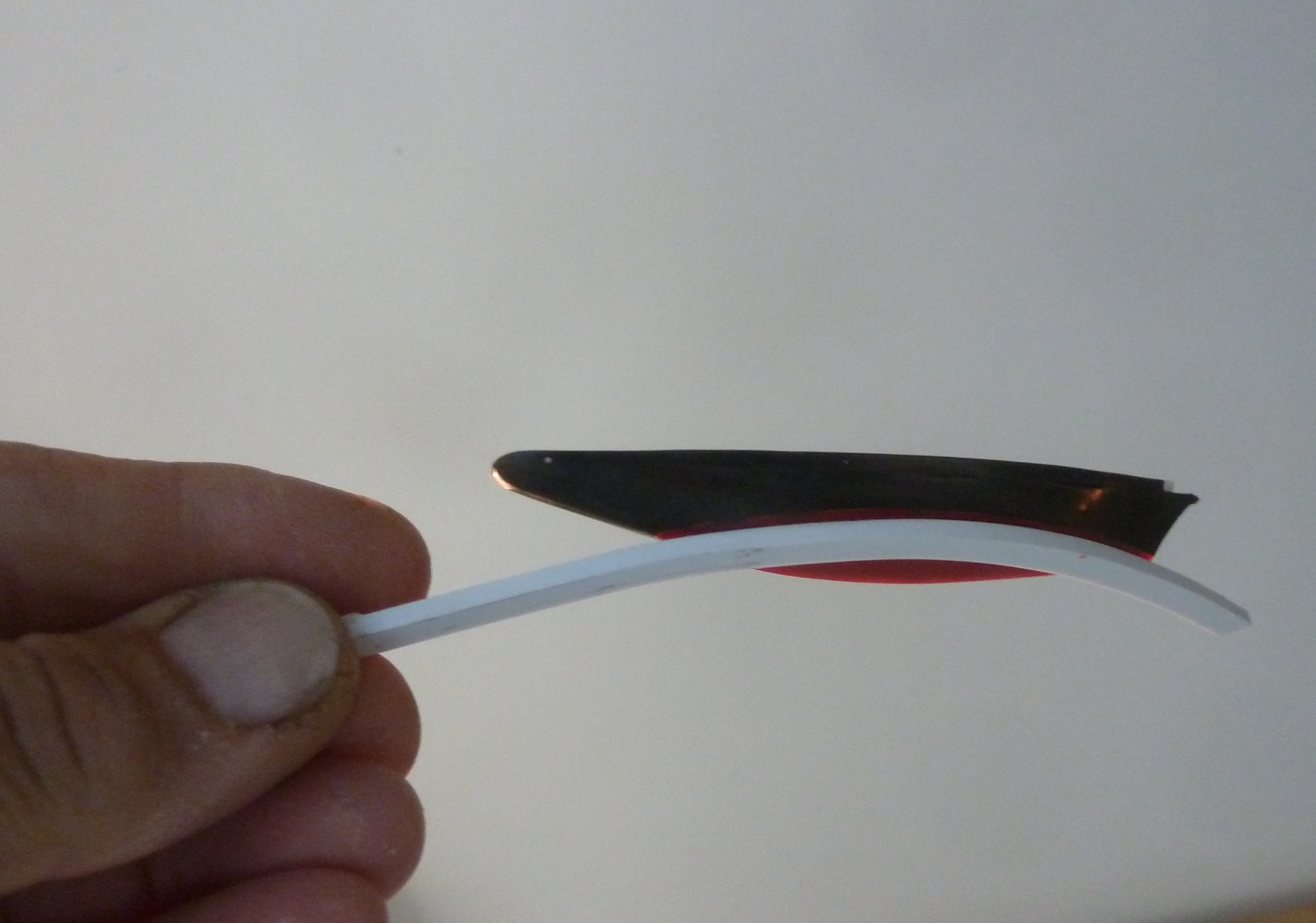

The pared down inner bulwarks on the hull sides were now not the smoothest of surfaces--and being white would show any undulation
I 'homogenised' the surface in readiness for white paint and detailing by using BECC self adhesive vinyl strip secured top and bottom with CA
( as opposed to thinner decal sriping, alas that media in this instance would be rather too more compliant to the uneven under surface :cool_2: )
and the excess cut away with a sharp blade

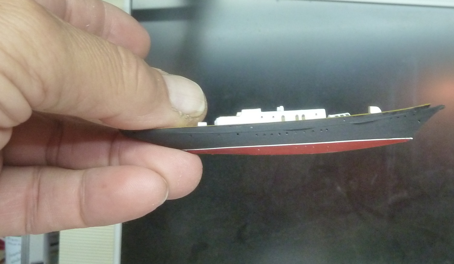

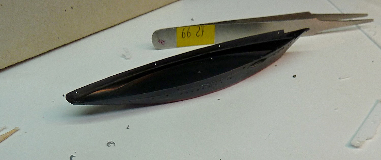

I wanted my model to be 'on the wind' with some heeling...
To achieve this , I added a rudimentary lower hull blank on the starboard side of thick styrene block strip
More updates once that has been sanded to shape... :smallsmile:

I sanded to shape the added section of the "underwater" on the starboard side which gives a reasonable amount of heel.

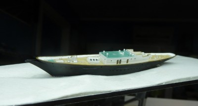

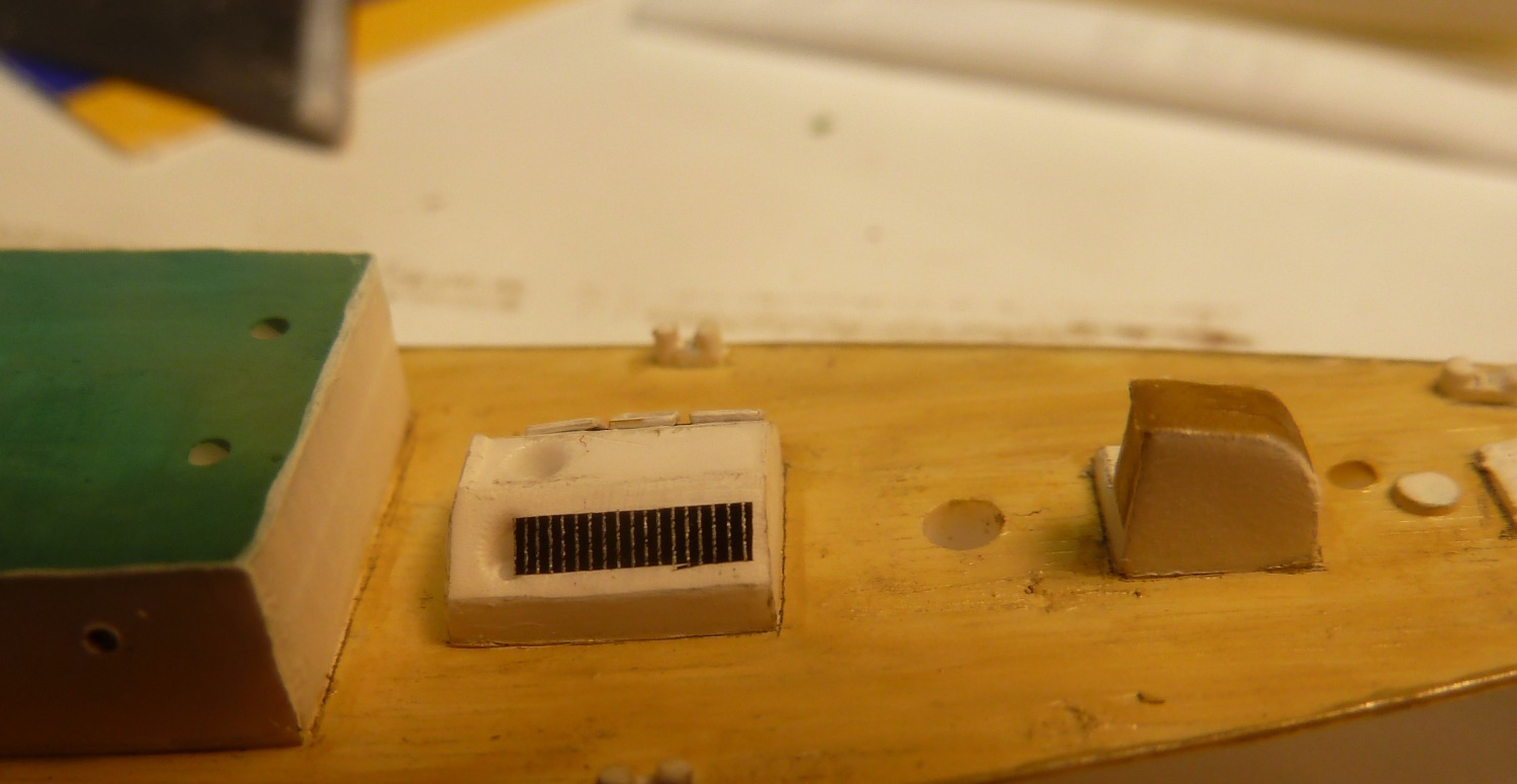

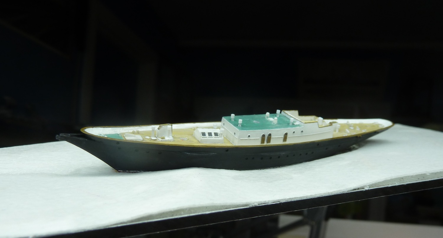

I turned my attention back to the deck and superstructure; in particular the skylight which had distinctive and large lifting lids
which had vertical safety bar grating on them
obliviously anything that I would make would be over-scale--but I also knew hat plain skylights would not do...

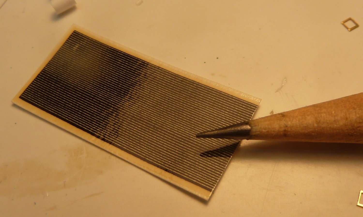

In my decal stash I had a piece of black 'grille' decal I bought in the late 1980's
--it must be 30 years or older-- made by a company called MABEX
I laid a strip of the decal into the skylight

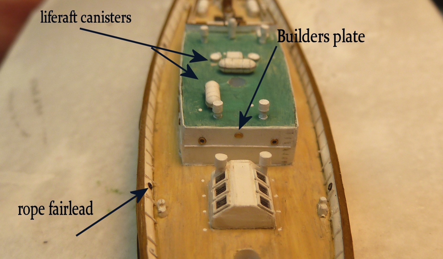

and then made the frames by cutting up some model-Railway ladderstock ( oo - 4mm =1Foot - 1/76 )
when all married up it looked quite pleasing to the eye

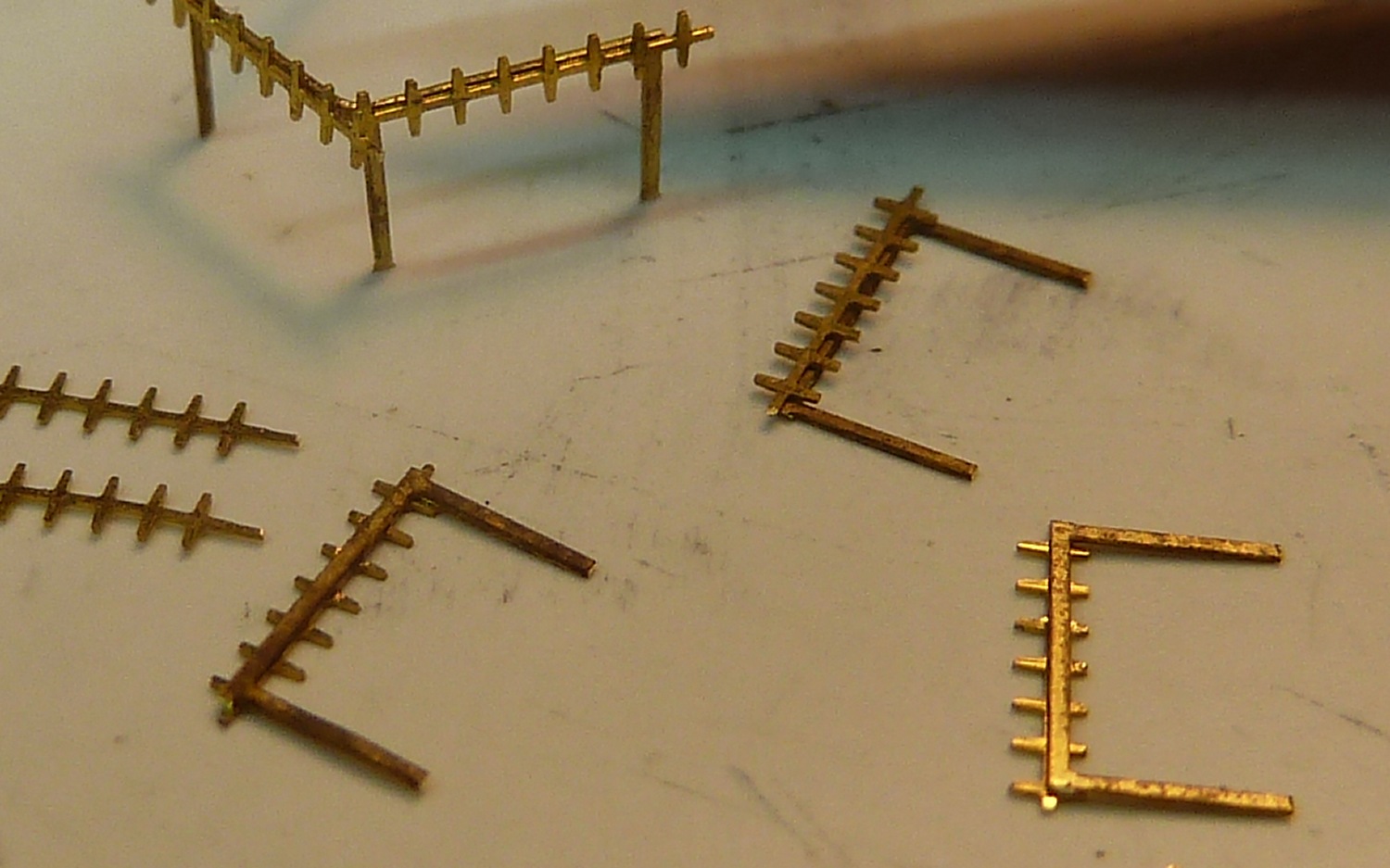

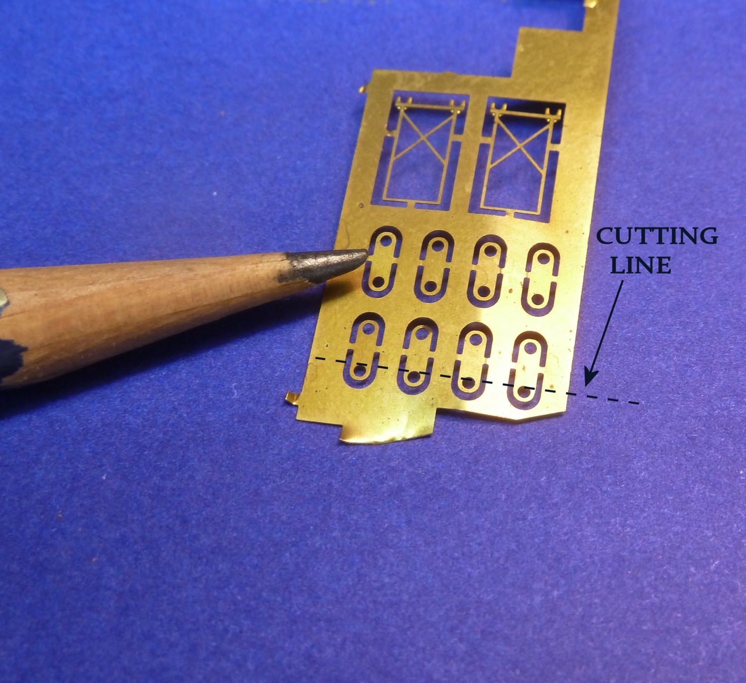

I also needed to find some narrow round topped cabin doors with a porthole in then ..........==> x 6
I did not have any in 1/350- so ended up using some old PE ( l'Arsenal Liberty ship...)
I think these were fold up yokes..(?)
anyhow-
- the image below illustrated it better than any description !

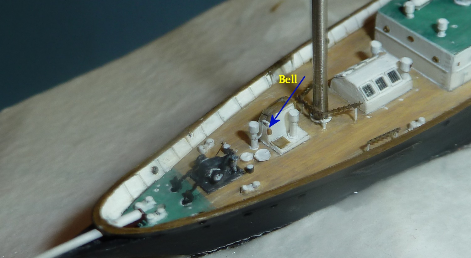

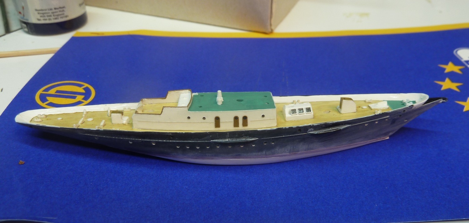

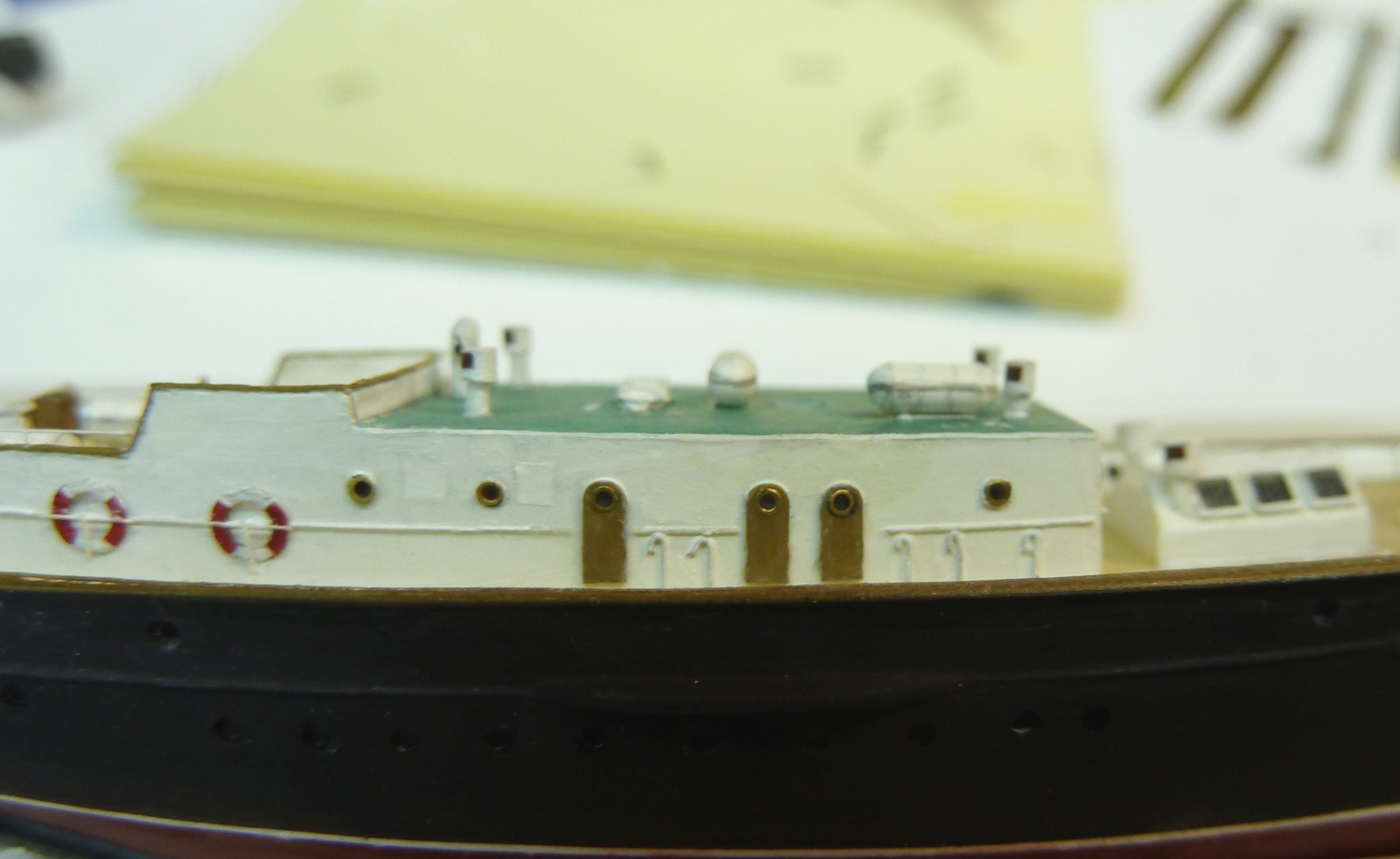

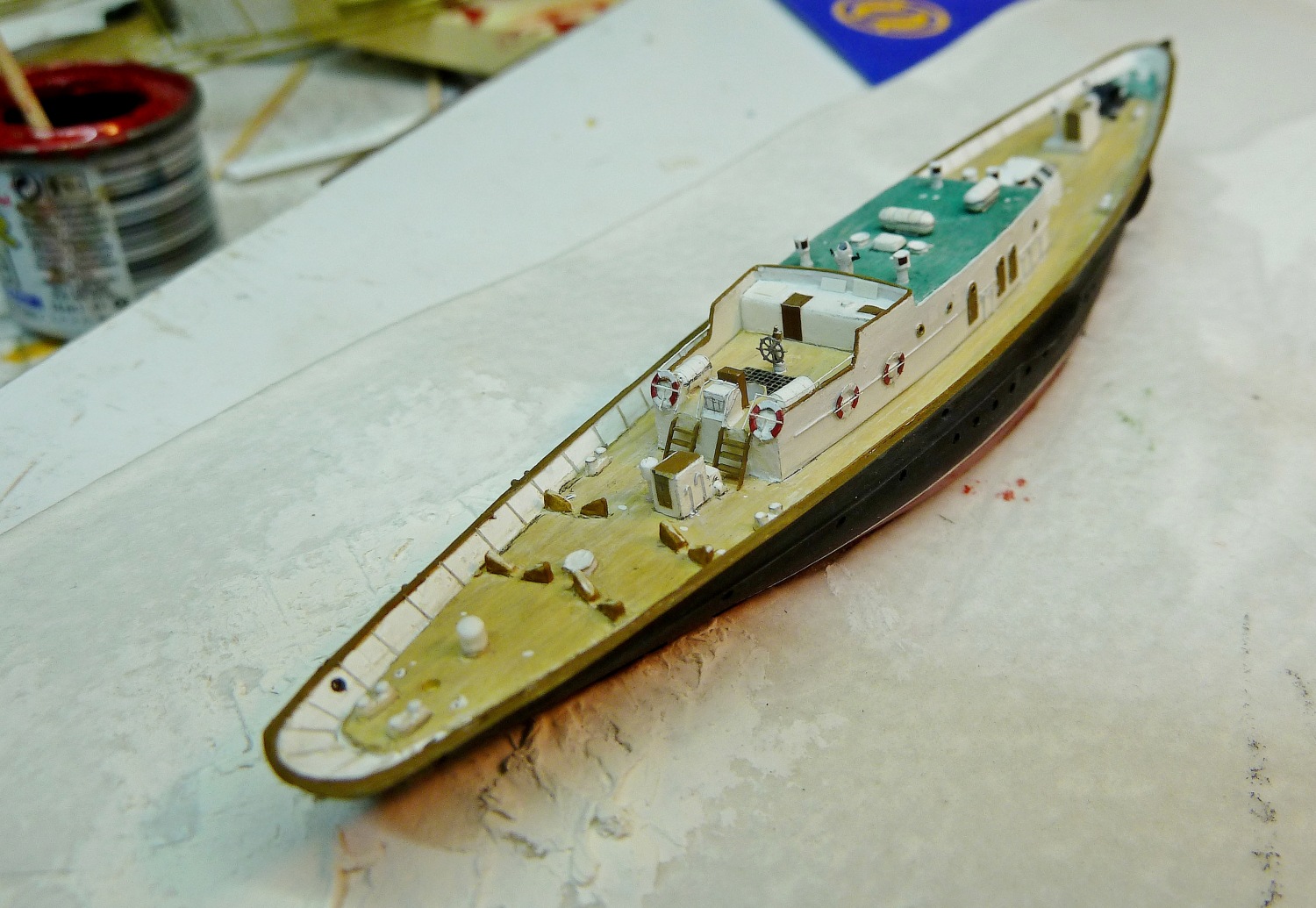

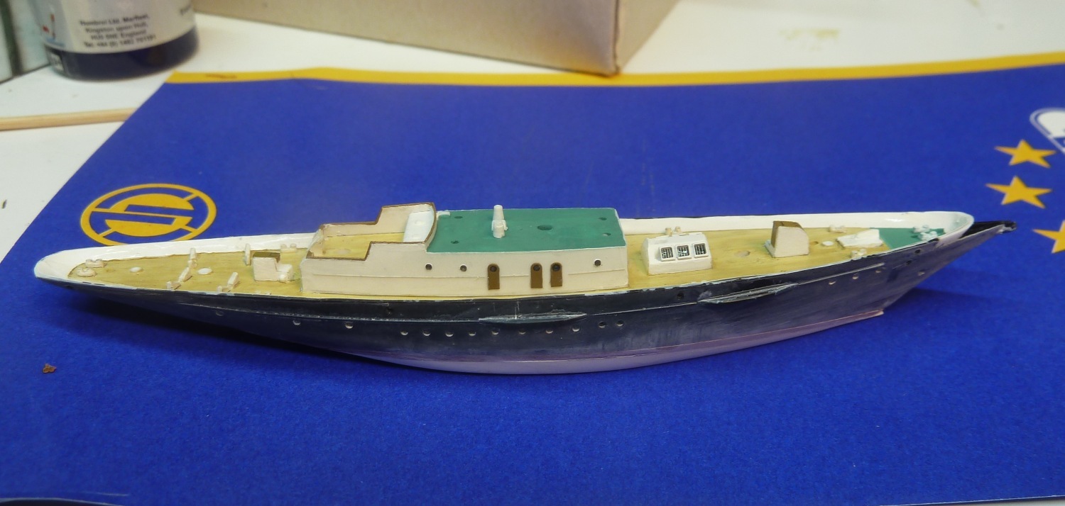

I installed the deck- dribbling thin CA around the edges fwd to aft
-after further scraping to ensure I managed to get it down deeper in the hull recess aft
I added handrails along the cabin-sides made of sprue
overall it is looking ok so far
:thumbs_up_1:
JB

When launched in 1966 Winston Churchill carried Ratsey and Lapthorn sails ( small red logo), a garish decor aft of the figurehead and silver painted railings around the cockpit helm deck and white anchor winch as distinguishing features

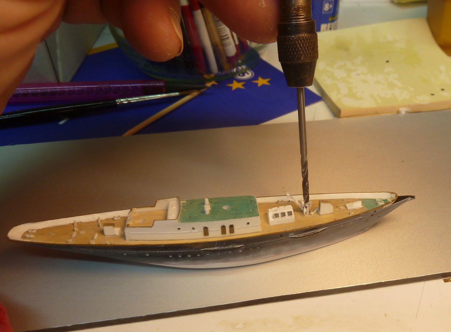

I drilled the mast positions all the way through the hull
and the drilled all the way through the baseplate to ensure that masts cannot ever move

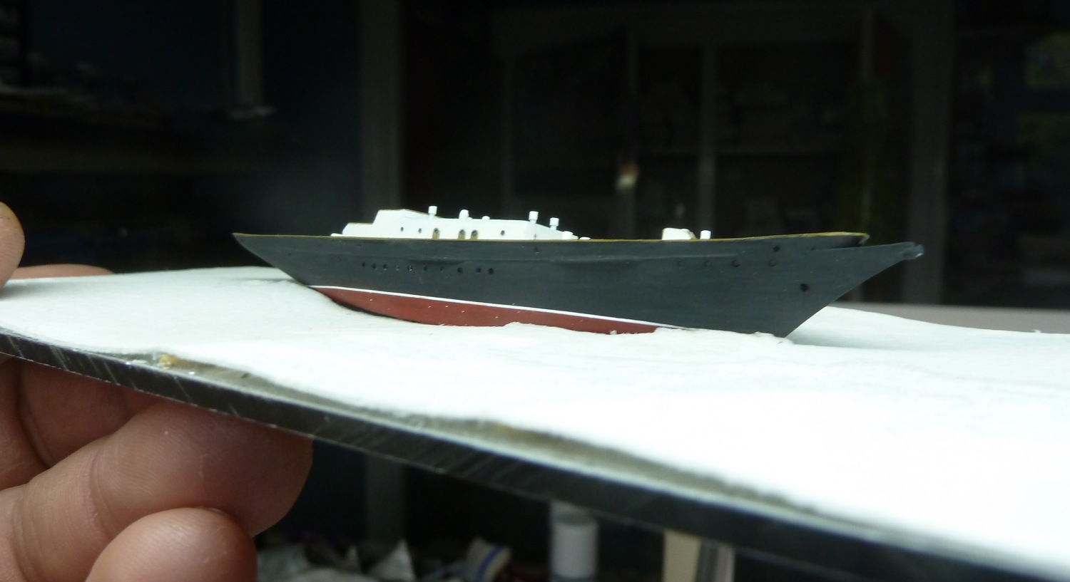

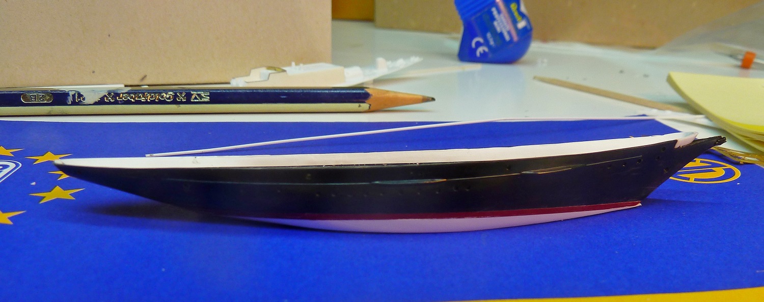

...the model had the hull and underwater area painted and decal strip boot-top installed;
and the hull was installed into its paper and cocktail stick sea base
( as described here in detail ==> link ==> viewtopic.php?f=4&t=37223
I plan to depict her on a close reach with all plain fore-and-aft canvas set-- so she will have heel and be moving at quite a clip !

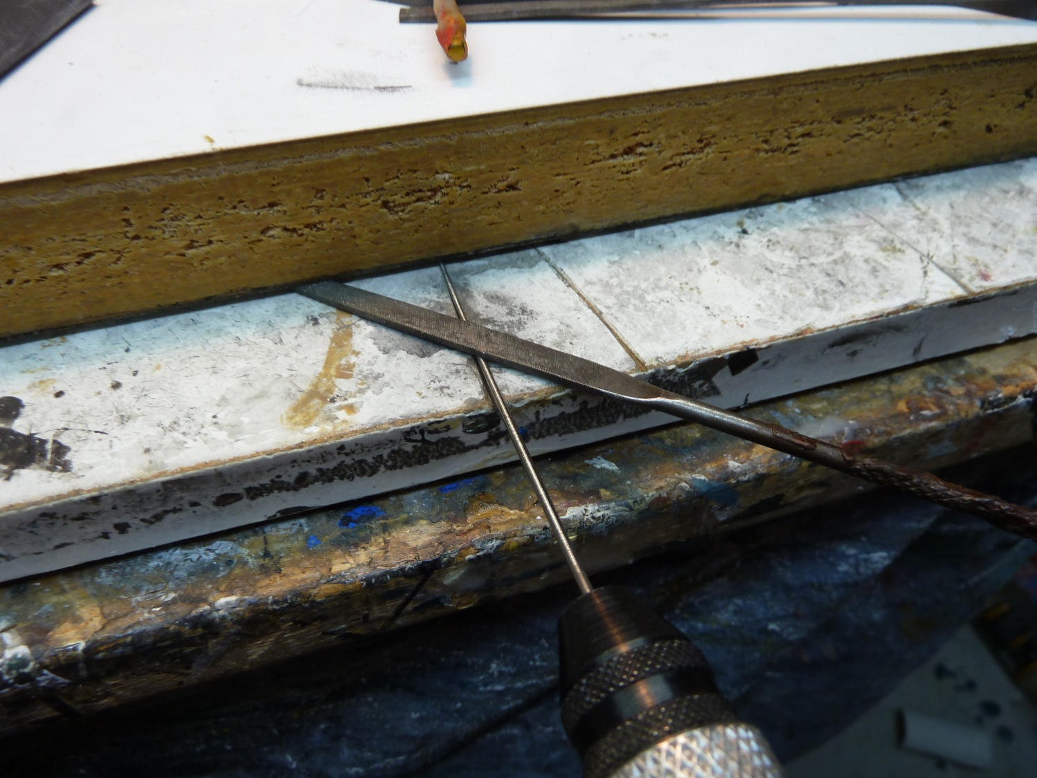

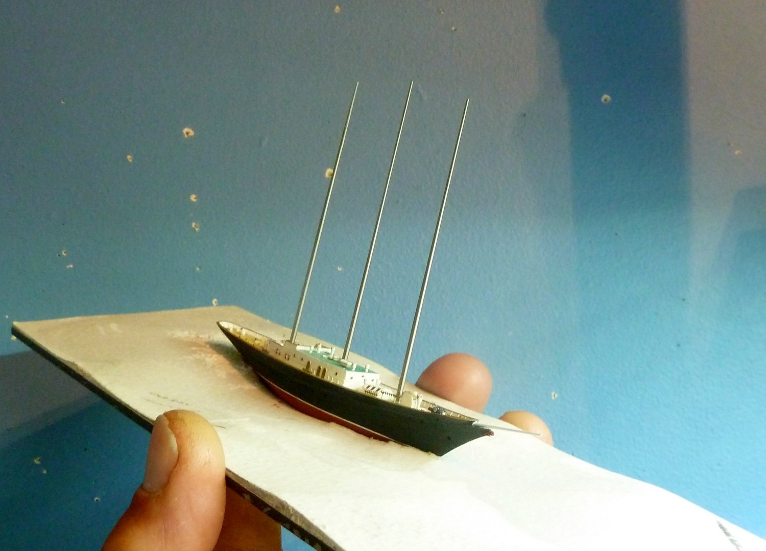

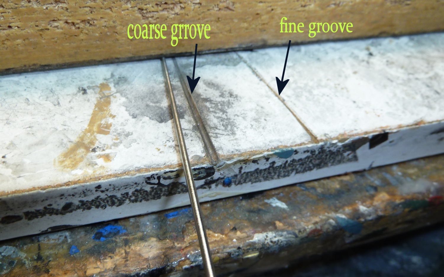

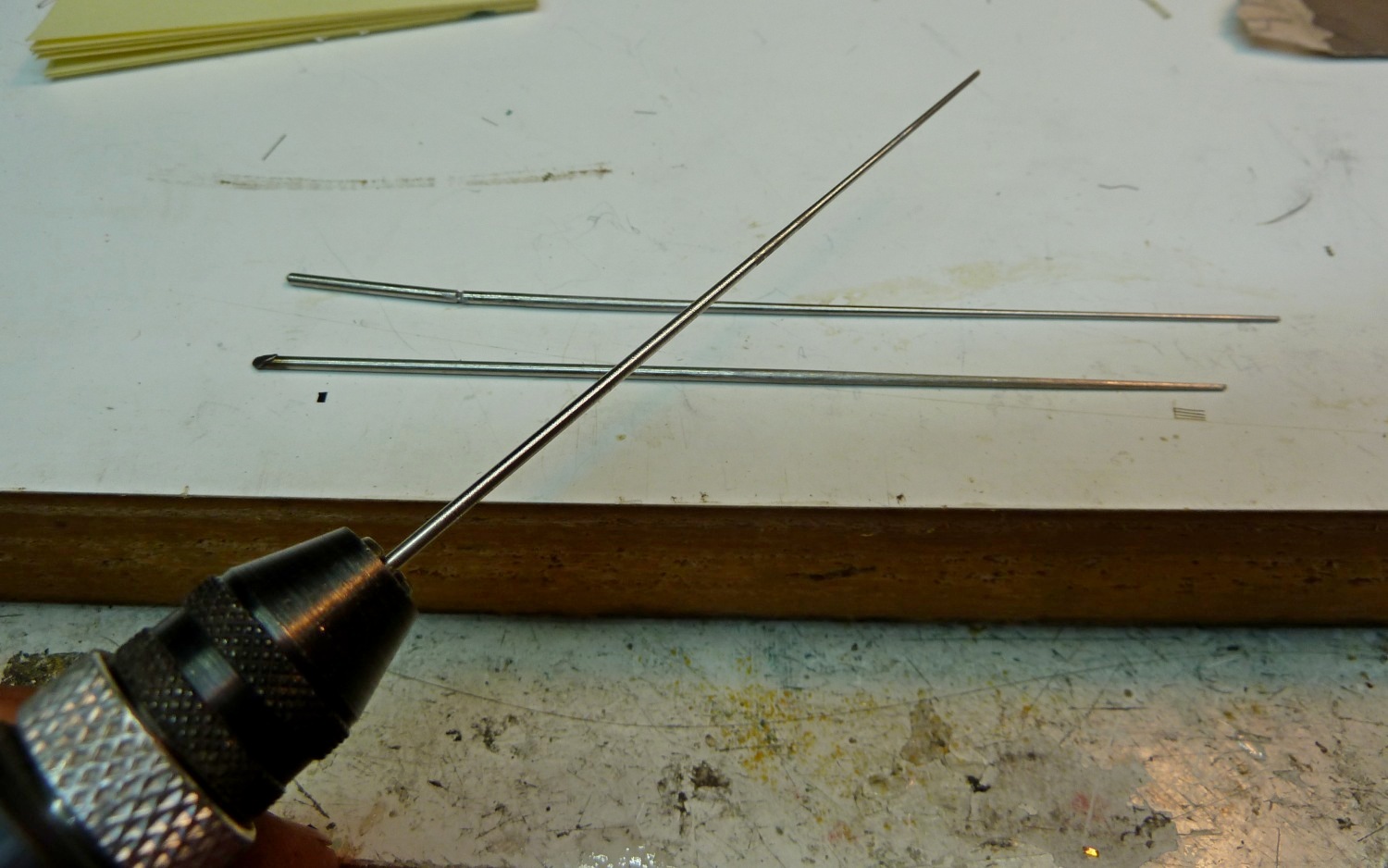

my method of making tapered masts
-take some stainless steel welding rod, insert into chuck of mini drill
and locate in a tapered groove on the workbench ==> ( this prevents oscillation and possible centrifugal force spinning it out sideways,
, distorting the work-piece as well as being potentially rather dangerous!!!
Note that (these days ...-' nuff said!)
I have another shelf piece located above ,-to further inhibit the possibility of it flying out!
I spin at moderate speed and using a flat file grind away until a satisfactory shape has been achieved
maintaining slight compressional pressuer on the masts and the file--using the file flat on the grooved bench
in this instance--lacking an ' accurate ' plan ( The Billings plan is helpful, but alas does not match photos everywhere)
I am judging by photos relative sizes and what looks 'right'

Stainless steel being springy is more forgiving than brass--which can whip out at the slightest provocation!!
it does not take very long--and in this instance where we have very long tapered masts--as opposed to traditional
sailing ship masts where 3 or more sections are joined in a stepped stagger; - both wood and metal-
- there is no real alternative apart from making them yourself--as all commercially available tapered metal masts are much too short.
These masts being anodised aluminium the sliver colour works well too!- no paint, no tarnish !

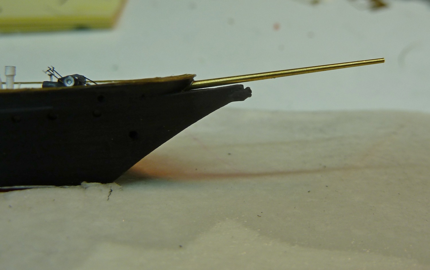

The bowsprit was surprisingly chunky spar on the real thing--I used half a large 1/350 spar from Master models-
-with the tip removed.
It is a tiny bit under scale--but by the time it has had two coats of white paint it should be spot on.
Very important was to maintain a small bit of daylight underneath it
( I would have assumed they would have rested it on / strapped it to the bow for more support, but seems not! )

I started making all the swan-neck vents needed, these were made of copper wire
These were installed where appropriate using photos rather than the plans

The life raft canisters were made of styrene rod--with ends belled using white glue, the bulwark braces all around the inside faces were made of white stretched-sprue attached with varnish
The anchor winch was fully scratchbuilt using cut-down 1/700 handrail to make the cable drum brakes

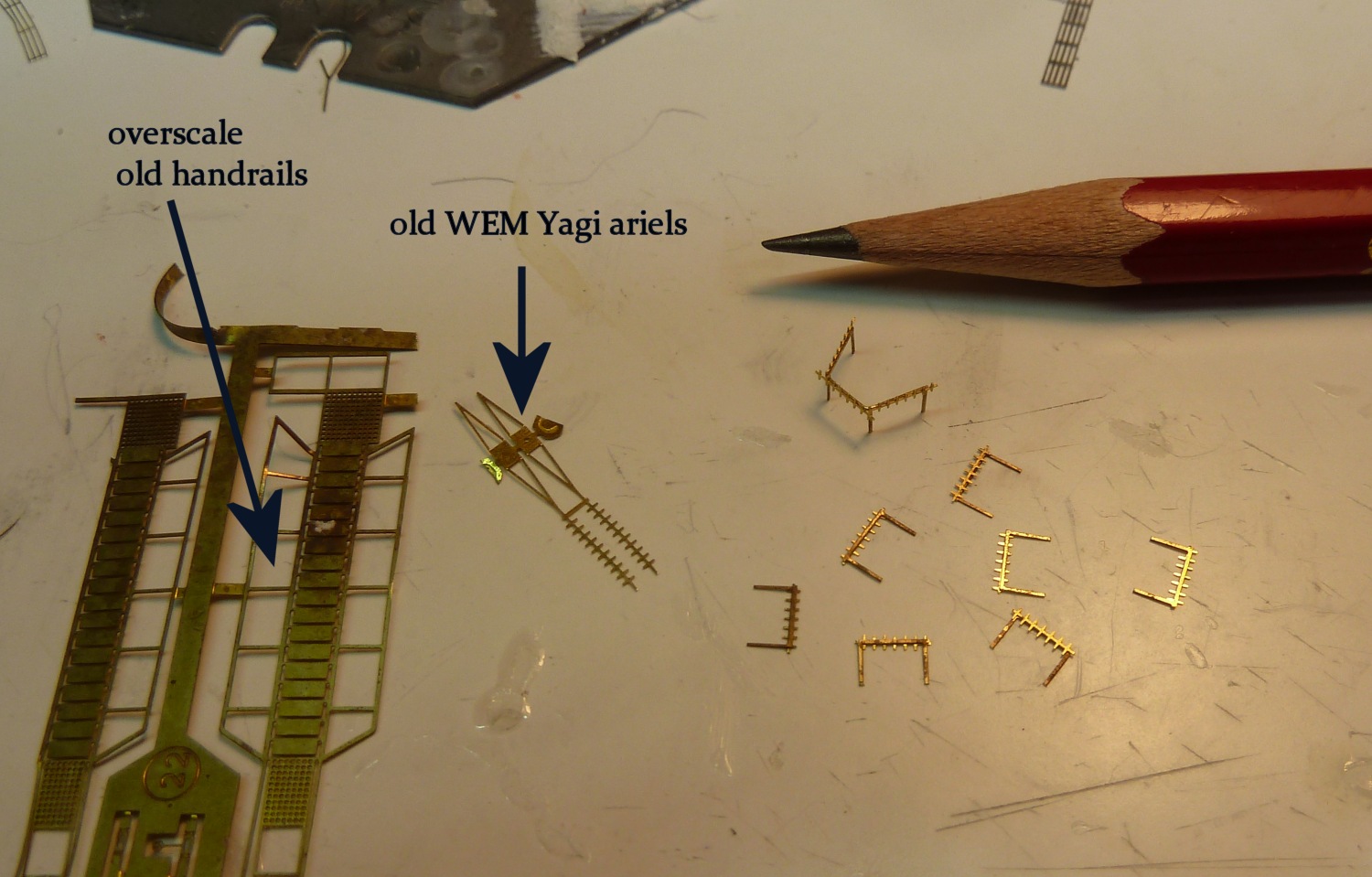

Making the belaying pin rails-for securing much of the running rigging
-to replace the vastly overscale plastic items was a game of trial and error,
of how to achieve a crisp repeatable effect without losing the will to live !
The final solution was simple ( ish ...) !
using old 1/350 handrail of correct spacing ( L'Arsenal liberty ship) and some elderly PE WEM Yagi ariels...

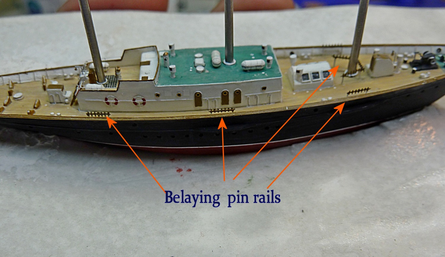

The previously made belaying pin rails were painted and installed;

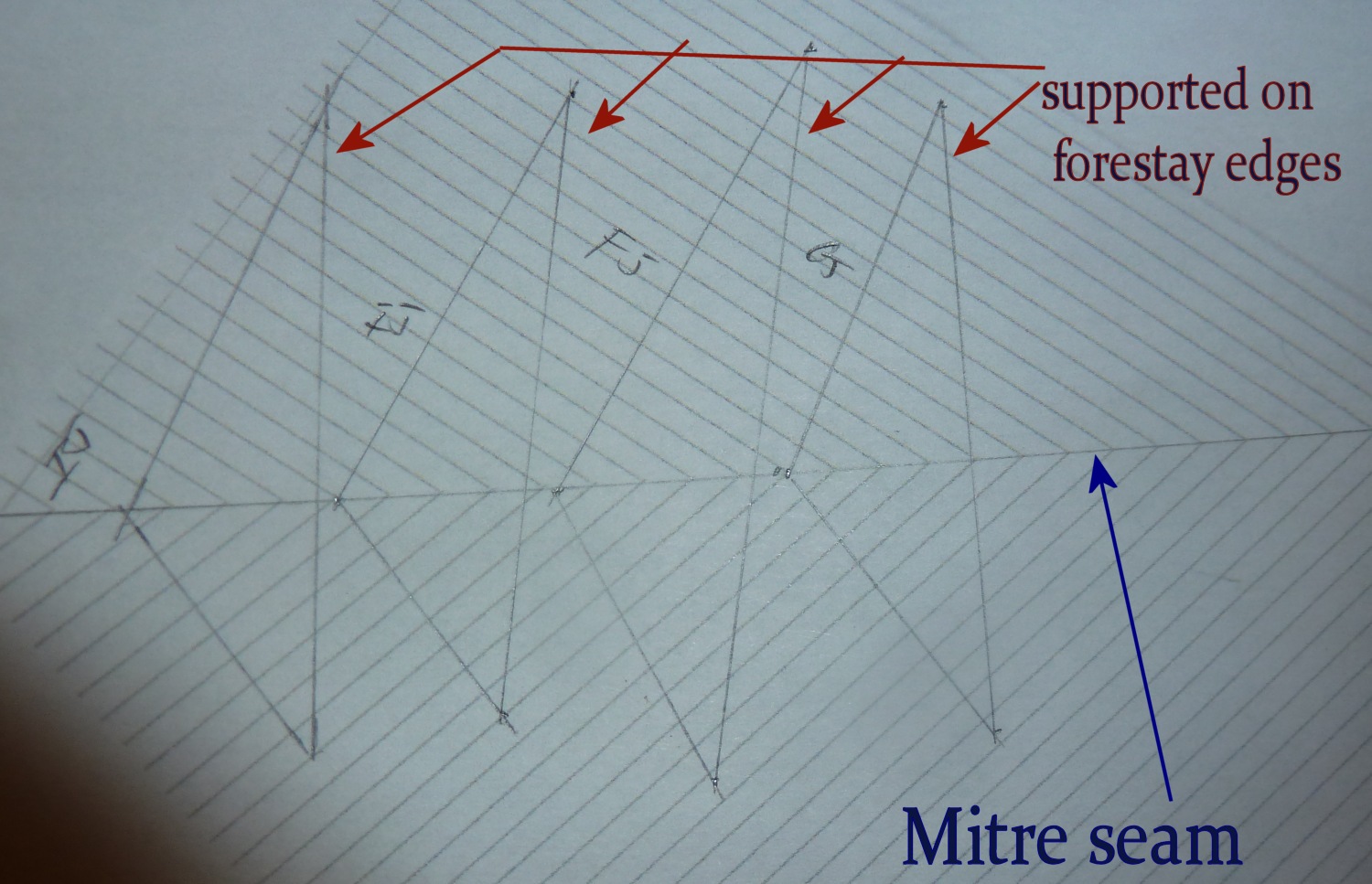

I used a 'ruled line paper ' file saved of f the internet
-and then resized it so that the correct number of lines would correspond to
the ( in real life) 36" wide sailcloth panel seam lines of the sails ,
==> I double-checked the number of panels per sail from this useful back-lit photo

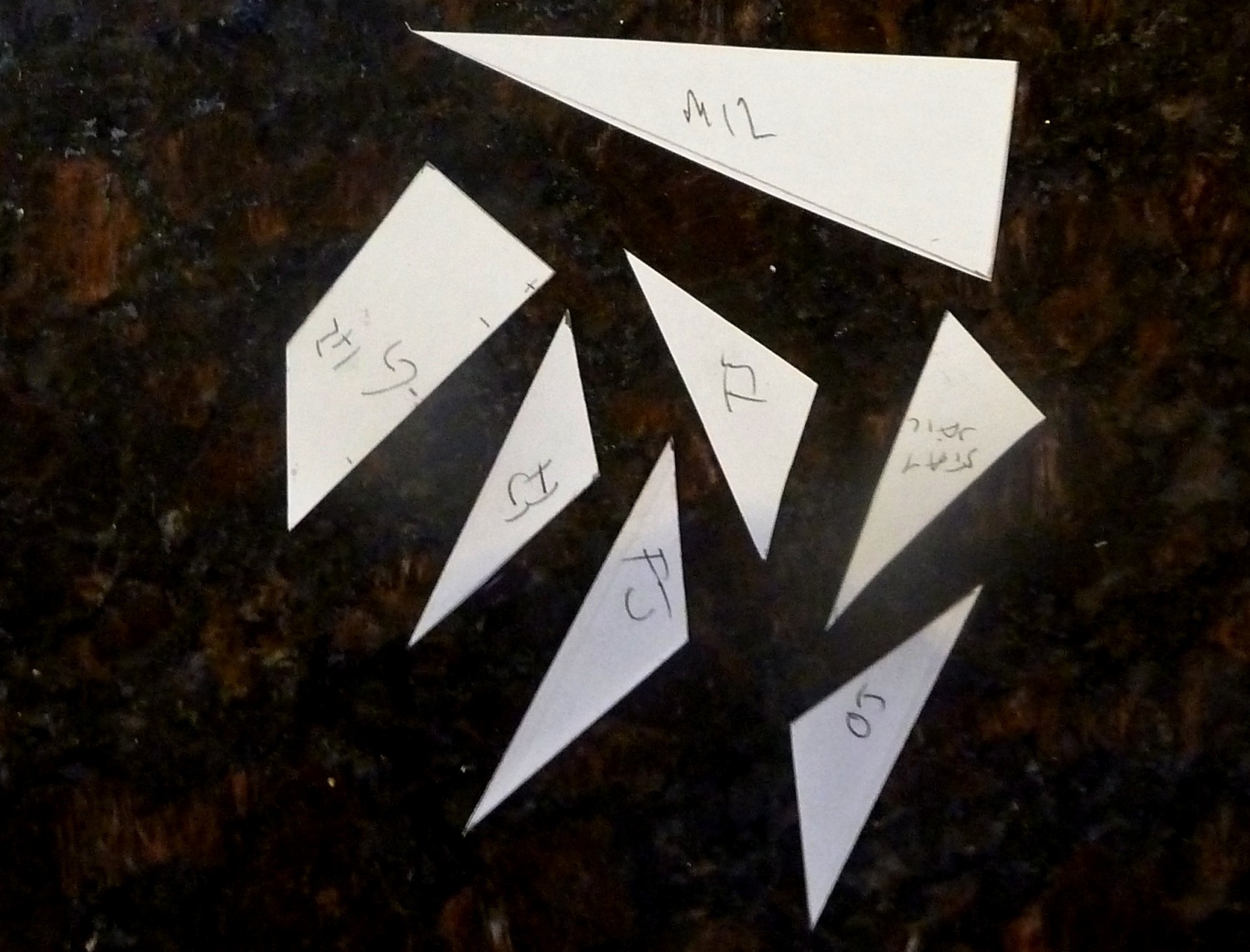

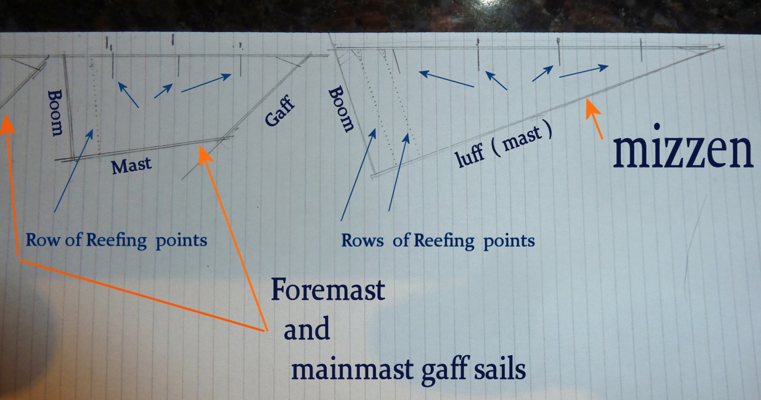

Firstly I made a ' scale size drawing ' of the sails and sail-plan--and compared the outline to a scaled side-on photo

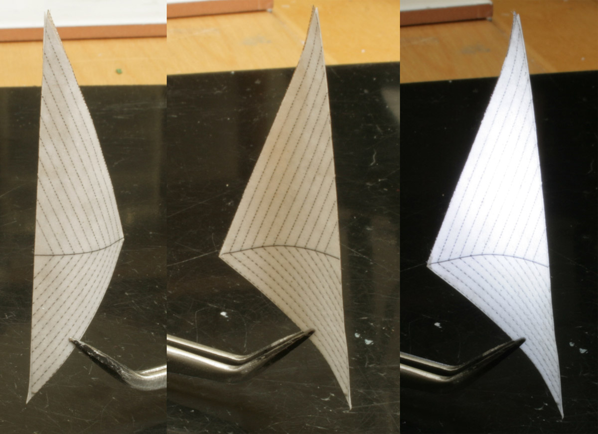

I then made templates in paper and offered these up to the the model
The panel lines on almost all Traditional fore-and-aft rigged ) sails
are square @ 90 degrees to the leech ( aft unsupported edge )
-- in order that the yarns are stable and thereby the non-spar supported edges allows the least amount of stretch.
The head-sails and the topsails - being triangular, with the seams square to the leech
would have the potential problem of the cloth weave being diagonal to the edge(* the flexible direction in woven fabric)
and therby a very very stretchy 'foot' edge which would flutter and not hold the shape.
Before the advent of laminate fabrics and the load-directional cuts of modern (racing ) sails,
Sailmakers used to counter this potential problem when building triangular sails
by introducing a 'mitre' seam
-=> so that both the foot and the leech would have the panels laying square to the edges, thereby minimising stretch.
The (relatively modern- 1960's ) sail-plan of Sir Winston Churchill means that virtually all the sails have the panles to the mitre seam at a a near identical angle of incidence .
I made the mitre-cut panel paper blanks the 'non -digital' hard way; =-> by cutting 2 x pieces of lined paper, gluing them edge to edge, scanning and then printing the result.
The REALLY hard and very frustrating part of this process was trying to get my printer to print the image with the panel lines AND the mitre cut lines to be exactly concentric above each other ...on BOTH sides of the paper !!!!
Much frustration and un-printable language issued forth .... and an inordinate amount of paper was used to get 2 x usable sheets with it all the lines lying correctly.
I am sure a skilled digital operator could achieve this easily--alas not me... :Mad_6:

making the very tiny ships bell fwd and aft was easy by comparison!

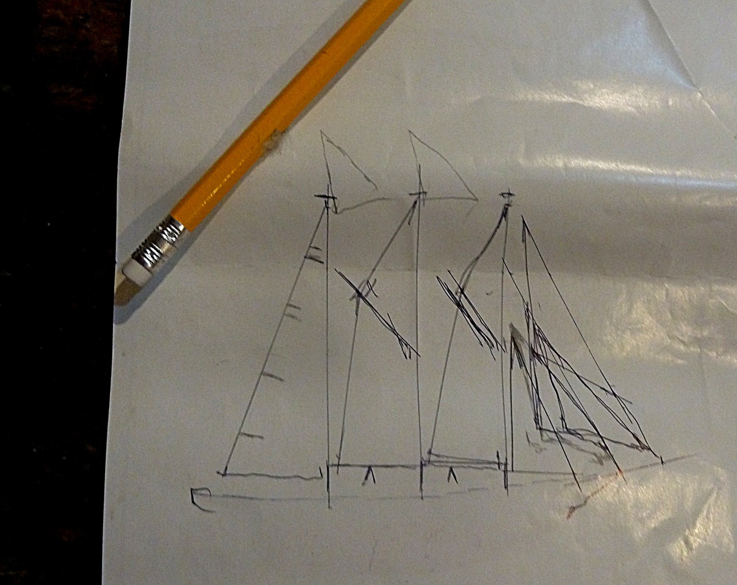

The problem with the sails got me a thinking....
This is only a suggestion as I have never tried it (but the temptation now exists), how about printing the pattern on white decal sheet as a mirrored pair and then using some kind of foil or other v. thin sheet of appropriate material as a base for the decals? Lining the lines up would be easy (well easier than trying to do double sided printing to line up exactly) but I wonder if it would then be too thick and/or too flimsy to implement?
[Sound of current work being scraped to one side of the workbench to enable the pursuit of whimsical experimentation]
OK, so it's rough as hell but took less than an hour from nothing whatsoever to those pictures (and no bad language). The overall height is about 2" (I used the 'A' sail from the kit as a guide). Nothing dried properly, nothing is cut exact or anything; and I didn't bother checking to see if the lines were going the right way..... Since I didn't have any white laser decal paper I used clear sheet and white paper soaked in CA as the base. The third image is with a LED torch shining from behind (if you couldn't already guess).
With more time I would paint and weather the paper before applying the decal, or get white laser paper, or use white inkjet paper, or, or, or - still have plenty of ideas about how to develop this further.
If interested, please PM me. Or just carry on doing the stunning job you are already doing. :thumbs_up_1:
