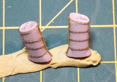

Funnels
First of all I addressed the extended funnel hoods typical for late Kamikazes. There are optional parts A18 in the Pit-Road kit intended for this modification, but the added height would not be enough to match the photos, so I glued plastic sheets on top of funnels and filed/sanded them down to the required shape. After hollowing the funnels I added the internal division from thin plastic sheet.
I added the ladders to the port front of the funnels and hesitated about the stepping wires. I have never before used PE for these on IJN ships and I have not intended doing it this time as I they are usually quite overscale. But quite a large proportion of the mold-on wires became casualty of sanding funnel sides to fit so I decided to give it a try this time and I think it ended up acceptable. I will add the top horizontal wire only after airbrushing both colours to allow for a masking tape.

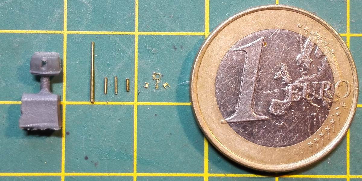

It was mentioned several times in the CASF thread that the default Pit-Road 12cm gun mounts were oversize and incorrectly shaped. So even before I decided to go for the complex Rainbow set I bought the Five Star 1/700 IJN 3rd Year Type 12cm/42 Gun (Type G Shield). These are more detailed than those by Rainbow, and also more precise, but also far more complicated to assemble – each gun mount consists of 9 parts incl. a deck mounting!

All three options are however incorrect in one aspect: they depict the gun shield as if it had a bottom while in fact it was a very simply shaped partial splinter shield only. I solved this by carefully (remembering the bridge disaster!) milling out the exposed bottom parts as well as making the shield sides thinner. I also sanded down the back and bottom sides of the shield slightly according to the Asanagi broadside photo.

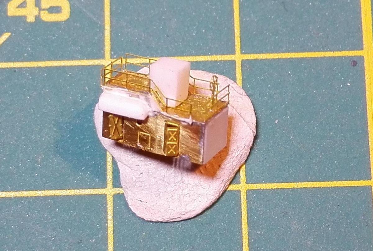

Searchlight deckhouse/RDF platform (continued)
No new direct evidence has surfaced until now so, based on discussions with Dan K and VAN I decided to go on with adapting the Rainbow deckhouse to appear in the way of what can be seen on photos of Yunagi and Asanagi. I cut the fore part of the PE to create the lower platform lever and added the RDF “box”. Mutsuki-class photos and plans show the aft steering was moved forward to the lower level so I did the same. I also added vents under the searchlight platform as seen on the Yunagi and Asanagi photos.

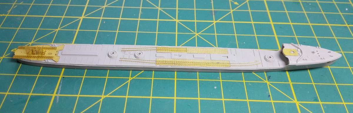

Hull & deck
For the matter of completeness, I should mention one issue here that I did not address. While browsing VAN´s blog in the meantime I noticed this image. I got in touch with VAN and he showed me the Pit-Road hull was unfortunately incorrect in its profile as sides of the hull should be vertical (instead of inclined inwards at waterline) starting from approx. #1 funnel as far as the stern, the difference being up to 0.6mm (!) per side at the widest spot. After thinking about correcting it for some time I decided to leave it as it was. It would be quite a big deal to make it right and it would definitely be dangerous to some of the detail I already installed on the deck while (I hope) the fault is not outright noticeable. Hope this can be forgiven to me ;)

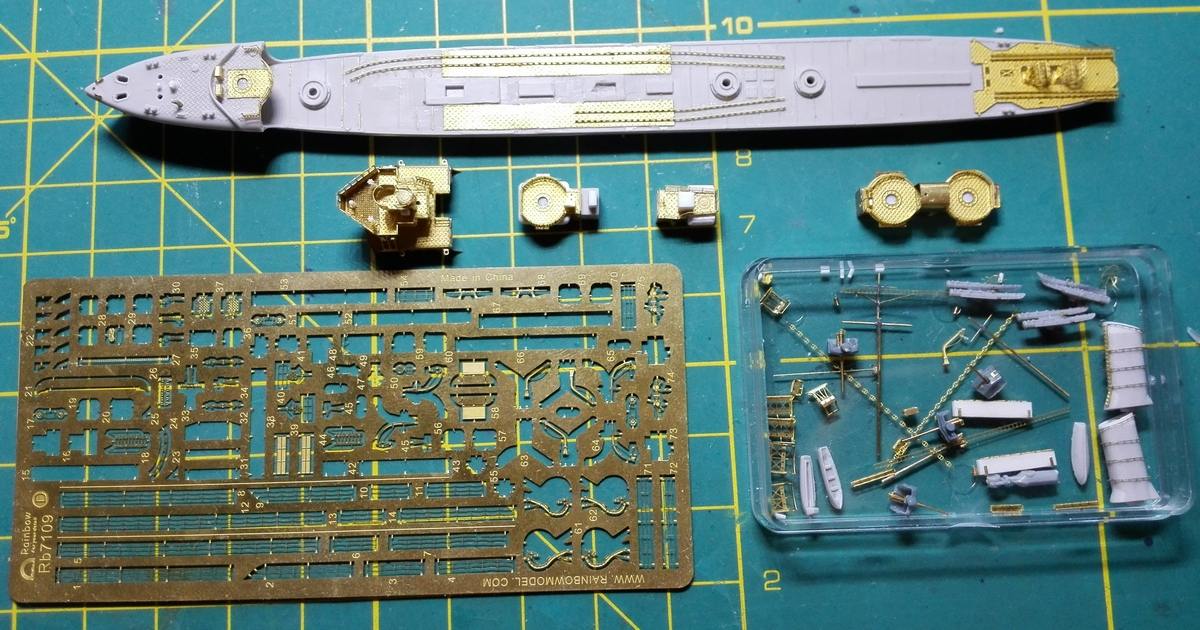

Now to the progress on the hull I made in the meantime. Most importantly, I finished the torpedo reload rails modified for a late-type Kamikaze. The Rainbow Mutsuki set provided only about 160mm of rails but approx. 180mm were needed so I ordered an extra PE sheet of Rainbow IJN Deck Rails. I also used it for the mine-laying rails aft and I added depth-change equipment from the upgrade set.

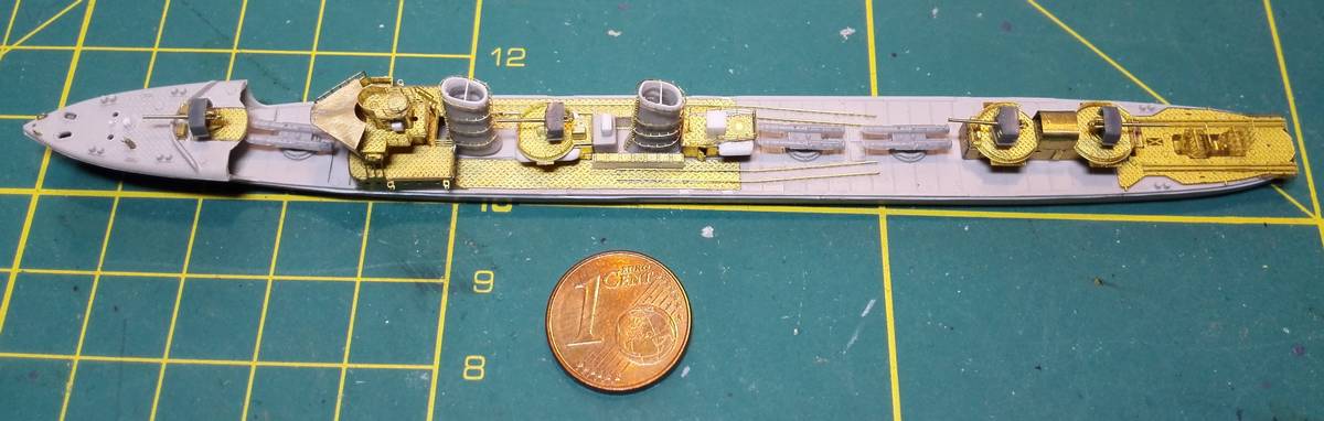

I´ve been very busy at work since my last post here, but now I am back at the workbench starting again on the numerous tiny details on my build list. Before I´ve got more to show I tried to dry-fit what I´ve got already, hope you like it :)

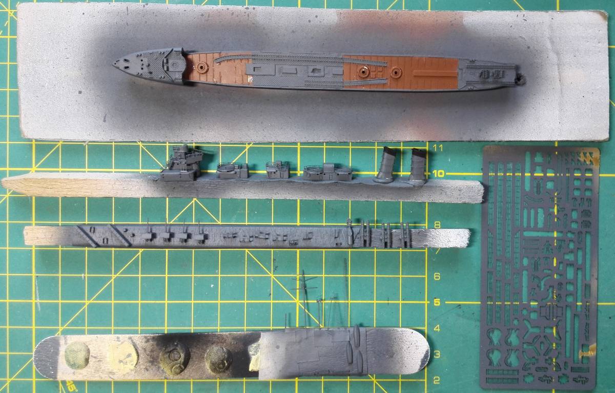

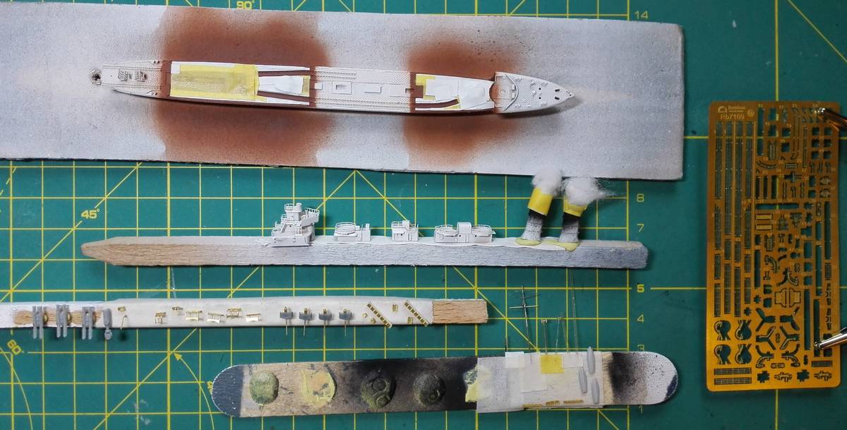

Finally I made some visible progress - finished preparation of most parts for painting by yesterday, so today I started with spraying base paint and the first two colours (linoleum on deck and black on funnels). Hope to make some progress next week, too. Next comes Sasebo Grey.

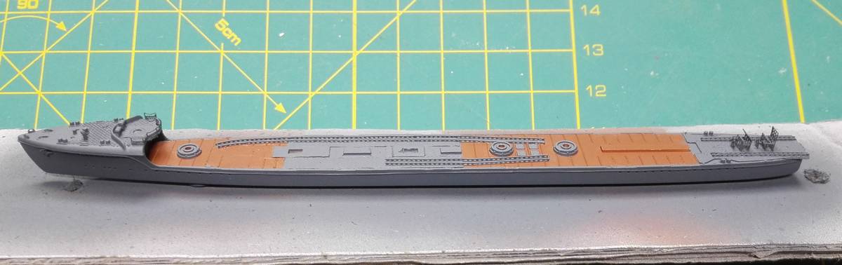

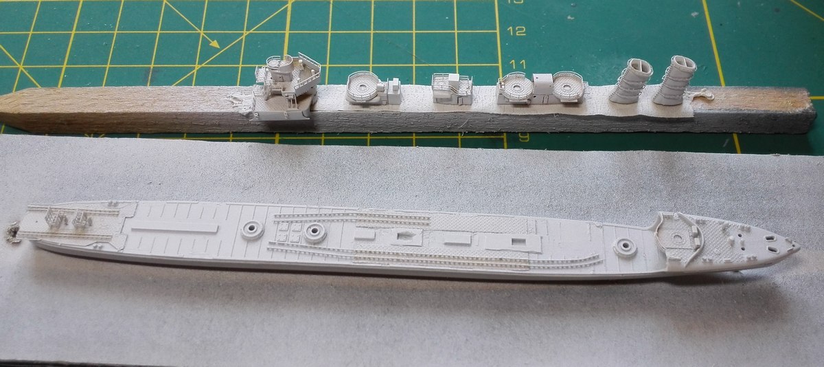

I think I made quite a good progress in just one day today :)
Prepared for spraying:
Sprayed Sasebo Grey:
Did basic retouching after removing the masking:
And attached the major superstructure components to the deck:
Now I just happen to think that I made a mistake - the area between torpedo reload track should have been linoleum colour, too. Will get it correct perhaps tomorrow.
