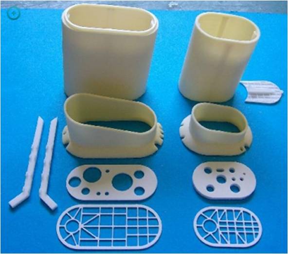

File comment: Funnels as delivered. Resin/composite

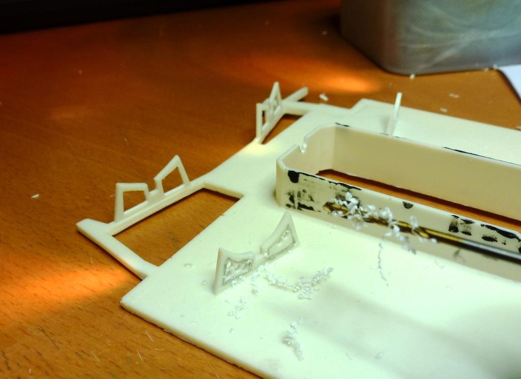

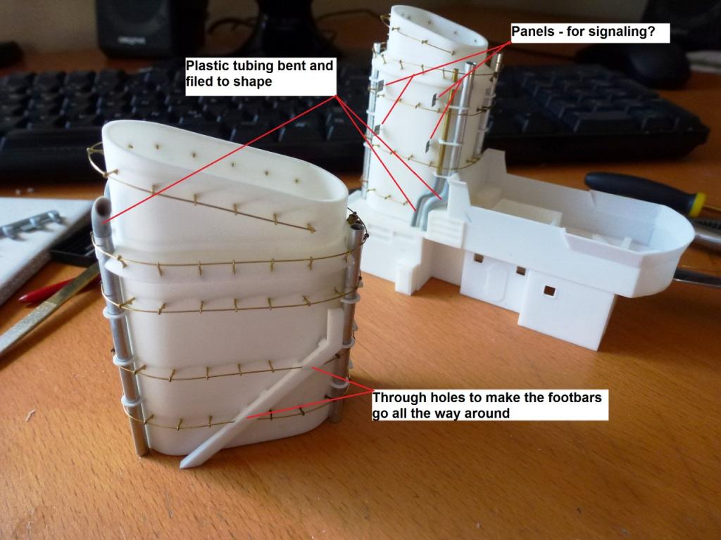

Well, let’s start with something nice: The funnels!
Made from 2K-material, they are easy to work on. Precision drilling is needed to fix the supports for the foot-bars. Support are made from 2D brass. The rails are made from .3mm brass thread making them 3cm thick compared to scale. No too far off, I think.
Bending the thread around corners is difficult. You may soften the tension in the thread by carefully heating it.
The tubes around the funnels are included in the set in different thicknesses. But all of them are strait – which is wrong! I carefully bent sprue / stretched sprue to match and glued them to the straight tubes.
The number of tubes and thickness are, buy the way, different from individual ships in the 1934A-class and need to be studied on photos of the specific ship you are building.
You may also notice the windows in the superstructure: The thickness of the part is 2mm, and the openings itself is not open - only depressed into the material. So the openings need to be carefully drilled / filed down to appropriate sice from the inside. Windows are made at a later stage.
Colour for the finished funnels are: DKM 50 Hellgrau from Lifecolor, the screens are painted in a mix of silver / grey to look like worn aluminium.

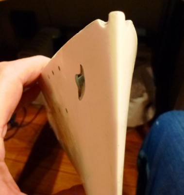

The hull: Made from fiberglass, it requires a lot of work compared to a plastic hull. The position of all portholes are marked onto the hull and needs to be drilled out. Plugs of aluminium is included in the set for this, but as their diameter are 3mm inside, they are best discarded! Why – because a couple of years ago, I “inspected” one of the wrecks still in place in Narvik area – namely the Z2 Georg Thiele. And as you can see from my hand, the dimension in 20 cm – not 30 cm which is more the double area (Revell made the portholes on their latest Zerstörer in 1:350 to something close to 50 cm!!!).
I bought alu tubes with internal diameter 2mm, cut into pieces and glued them to the hull with 2K glue. The rest is lot and lot of sanding to make everything level.
As glass is decided to use 2mm plastic rods cut into pieces and push them in place (after painting…).

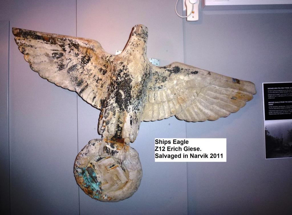

Some say… that the eagle emblems of the ships of the Kriegsmarine was removed when the war started. Well: Yes! – and No!
As can be seen in this photo from the Red Cross Museum in Narvik, at least the destroyers carried their eagles on the bridge fronts in April 1940!

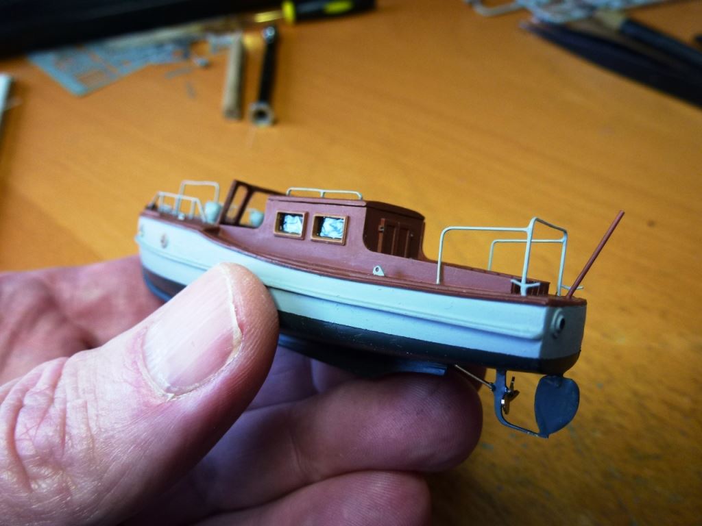

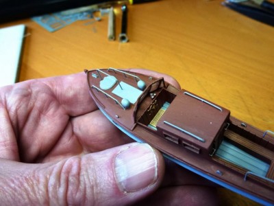

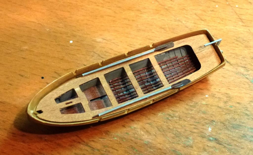

Then to something more nice: Ships boats. Included in the kit was to similar large boats - which is wrong. Teere should be two, but normally of different different types.
So one needed much modification. Except there should be two different types. So modification needed!These sub-kits are easilly worked. Goes togethet well and consist of cast-resin hulls, some metal, some plastic and some wooden parts.
The windows and portholes were made from clear plastic cut to shape and glued in with wkite glue.

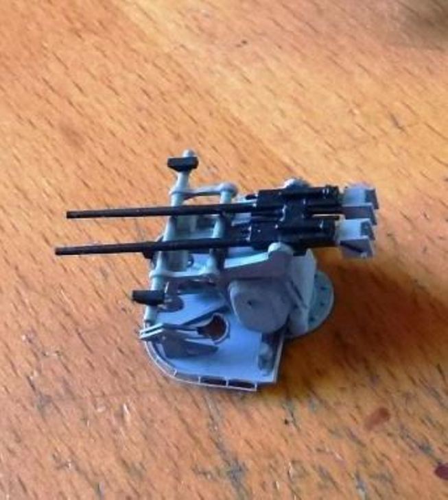

The main guns that were included in the kit were quite basic with little detail. So when more advanced guns were offered during the build process, the basic ones were skipped.
The more advanced kit included brass shields, barrels and smaller parts, plastic as well as resin parts. Shields had to be bent, soldered and filed to shape, but I think the result was worth it!
Turrets top were painted yellow as ordered by German Naval Staff for April 9th (repainted in red April 10th).
37mm AA guns were quite accurate in shape, but lacked detail. Lots of smaller parts such as loading mechanism, sights, wheels and support were made from scratch. All in all some 60+ parts for each gun!
Ammo was not included, so I decided to depict some of this from own production: Blue shell: AP, yellow: HE, green: ILL. Brass case with white top: Std charge. Long poles: Cleaning rod and loading rod.

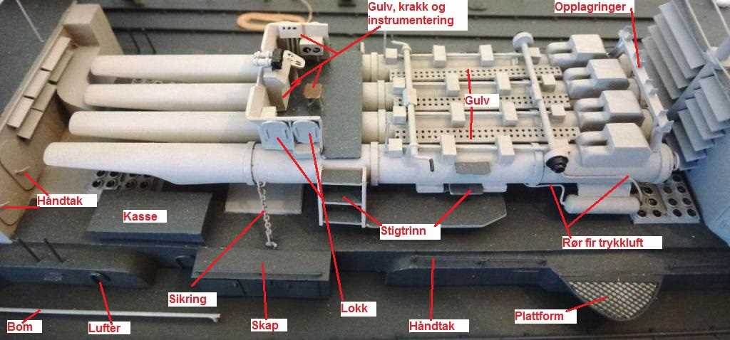

Torpedo handling system: This was not included in the kit, so I had to build my own. Luckily I managed to find a few good pictures in the internet showing how the loading/unloading took place.
The torpedo is made from a solid piece of sprue and shaped by knife, sanding and plasticards.
The rest of the mechanism is made from styrene plastic, plasticard, sprue and smaller part from the parts bin, brass tubing and PE-frames cut and bent to shape.
Opening in the rear of the tubes drilled out, while all detail «installation»and instrumentation on top of the tubes were made from scratch/photo.
File comment: Norwegian text - I guess you get the picture anyhow!
File comment: Aft tubes. Everythig marked by text are items bulit from scratch. The tubes are stapped to the deck by 42 links pr inch chain

Boats cranes
These had, in the kit, supports attaching them to the superstructure close to the top. I have not been able to spot any such supports in any original photo, so I cut them off. El. Motor at the bottom rear of the cranes were also not included, but easily made from the parts bin
Brass pieces for the lifting mechanism were beautifully shaped and only needed paint!
All supports for the boats made from styrene sheet, pear wood and wire mesh.
