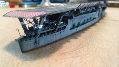

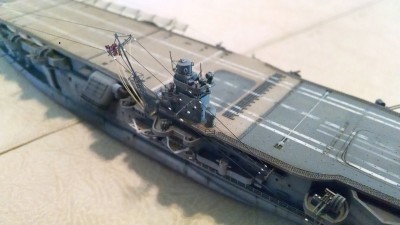

This is only the 2nd 1/700 ship I've ever built. This one is the old tool Hasegawa IJN Kaga. While this kit is wildly inaccurate in a few key areas, at this point, my focus for now was getting the ship in somewhat decent shape; this isn't even close to the Fujimi offering, but it's still a pretty cool model.
I still have one searchlight to add, but on the whole, it's pretty much done. I'll be moving onto the squadrons in the next couple of months in-between other builds.
Also, my apologies in advance for the lack-luster photos...old camera syndrome.
A few notables:
  1. first time I've ever scratchbuilt an entire island, but man, was that necessary! The kit supplied island wasn't even close.
  2. PE came from a variety of sources: Tom's, Hasegawa and some left over GMM parts from another build
  3. all the guns from the kit were trashed; they're pretty useless. Replaced with Pitroad's W series set
  4. the Hasegawa kit had raised outlines all over the flight deck; those were sanded off, re-masked, and airbrushed
  5. added tie-downs to the flight deck. Over 1400 tie downs!
  6. arresting cables are pieces of very fine wire (afterall, I sanded down the deck to remove all those pesky raised outlines!)
  7. tried a new method of dealing w/ the deck planking. Base colors were airbrushed; then I replicated the planking with a mechanical pencil with a very sharp tip; this allowed me to cut through the color coats to reveal the gray base underneath. Deck was sealed and a thin sludge wash of oils were used for additional weathering and pin-washing. When dry, it was hit with dullcoat and weathered a bit more with pastels. Works for me!
  8. rigging courtesy of Jim Bauman's method (thanks Jim for providing your tutorial; worked exceptionally well!)
Anyway, enjoy the photos!

PostPosted: Fri Jan 10, 2020 12:18 pm
Posts: 8845
Very nicely done! That's a lot of work. Did you drill out the tie-downs? If yes, OMG.
PostPosted: Fri Jan 10, 2020 12:28 pm
Joined: Thu May 15, 2014 4:22 pm
Posts: 21
Thanks Dan!
Tie downs: Oh GOD NO!
Briefly: what I did was scan the entire flight deck and assembled the scans in Illustrator. Its a graphic design application (I do a lot of design work in my 'real life') and with it, I was able to put a pattern of "dots" all along the scanned image. Helped to keep things evenly spaced and aligned.
That in turn was printed out and then I taped the printed pattern on top of the flight deck. From there, I chucked a needle in a pin vise and "punched" the needle through the pattern to create the tie downs. With the oil wash I applied to the deck, it helped to further enhance the illusion.
