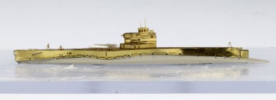

Let´s carry on. As expected, designing a flat PE overlay to match a quite complex (and a bit uneven) resin hull was not an easy task, despite all the prior measurements and later adjustments to the hull that I made. The height of the resin hull was too high when compared to drawings and photos, also the symmetry of the hull was slightly off as it happens sometimes with resin, so some sanding was needed. In the end, after waiting one month for the PE to be produced, it turned out my first attempt failed to match the hull lines properly leaving too wide a gap in between.
Also my first version of the conning tower proved to come out too tall and the limber holes ( :wave_1: ) came out so small they´d likely disappear after airbrushing.
So another attempt was needed. I added many tiny detail parts like a (fancied) inside of the bridge, anchor, periscopes, ladders, horns and both versions of antennae struts (pre-war and early 1943). The production had to wait until I finished revisions of all the other parts on the A4 brass sheet for my other projects (like the prototype of PE for Bagley and Benham class destroyers with Kraken Hobbies ;) ). That waiting period brinhgs us into mid-June, so almost recent.

My second attempt on the PE came out definitely more usable. The seam on the port side is just as I imagined it, starboard came out a bit worse. The remaining gap between the resin and the PE would not be a great deal to fill in with putty but that would quite certainly end up with losing the PE detail that I aimed for. So I decided this had to do for the moment, let´s see how it will turn out.
The downside was that the whole brass sheet was overetched by the producer (complaint accepted),but most parts were usable although some were quite fragile. The one missing part (the smaller periscope tower on top of the conning tower) was lost due to my own mistake in the design, but I will be able to use the one from my first attempt. Photos show only the main parts in place.
