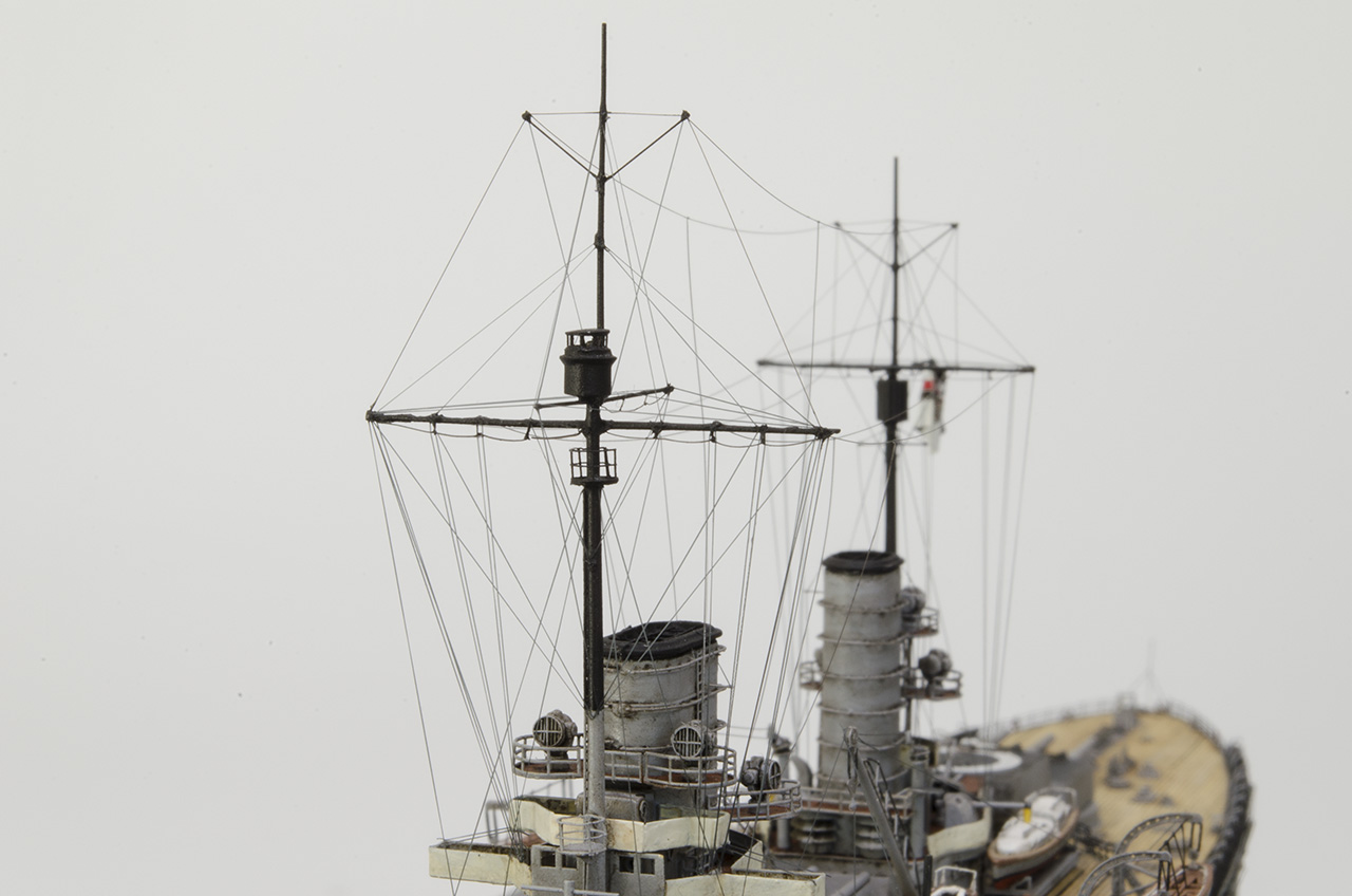

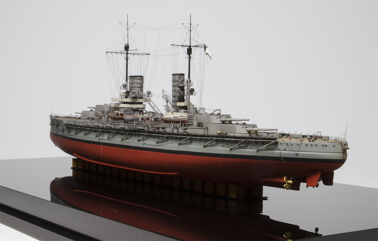

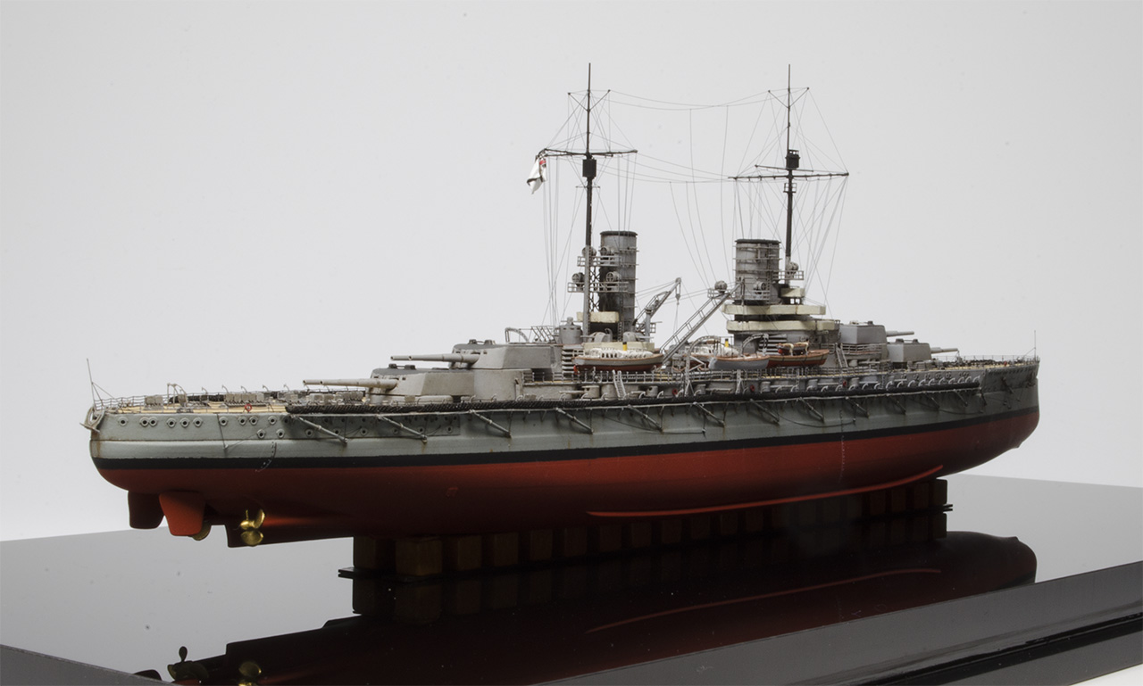

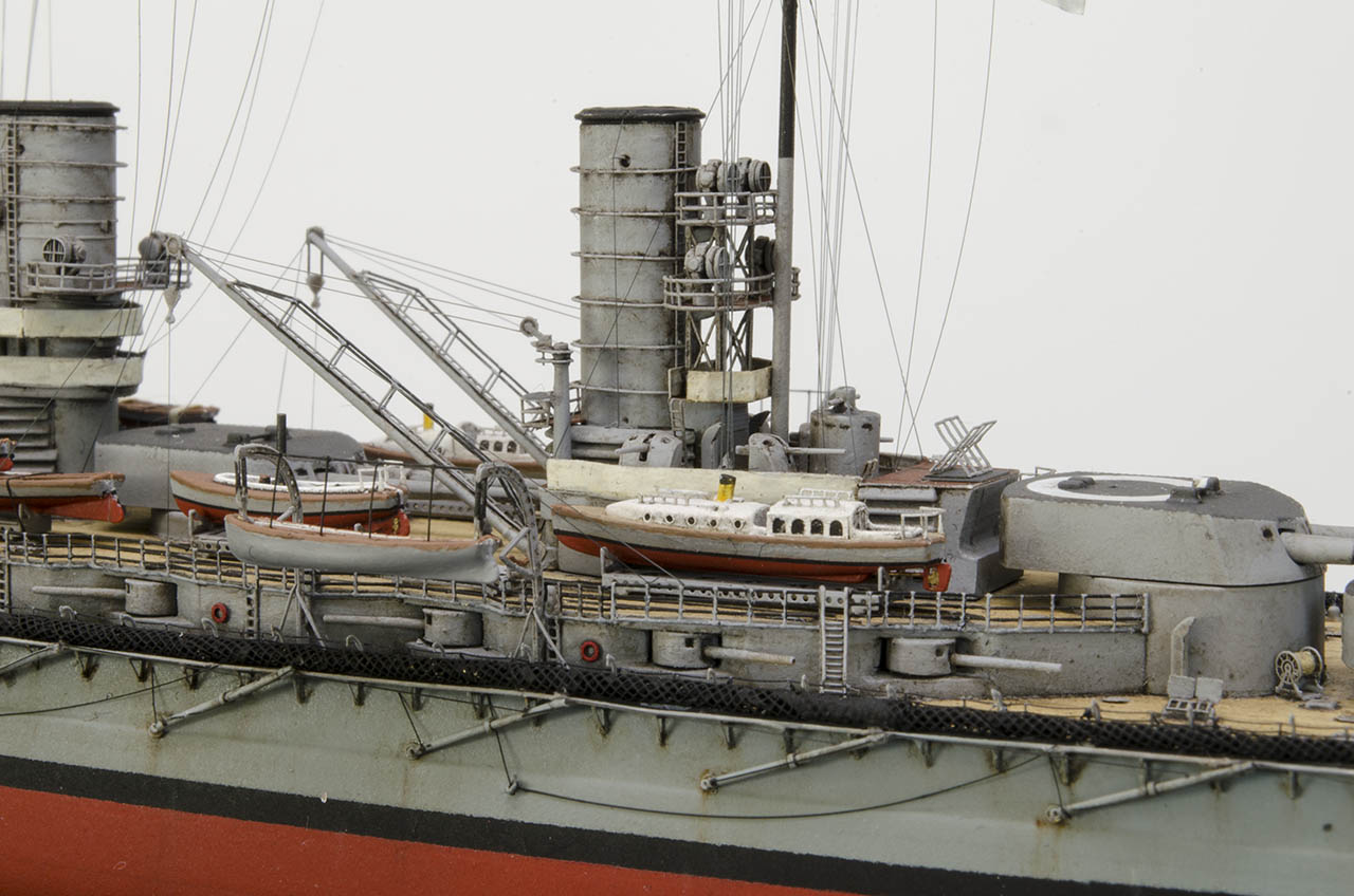

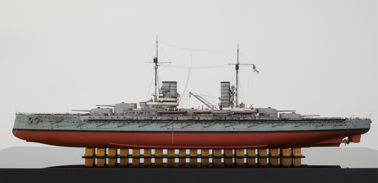

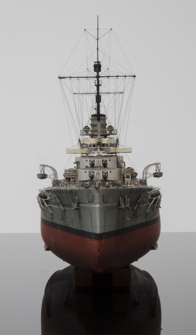

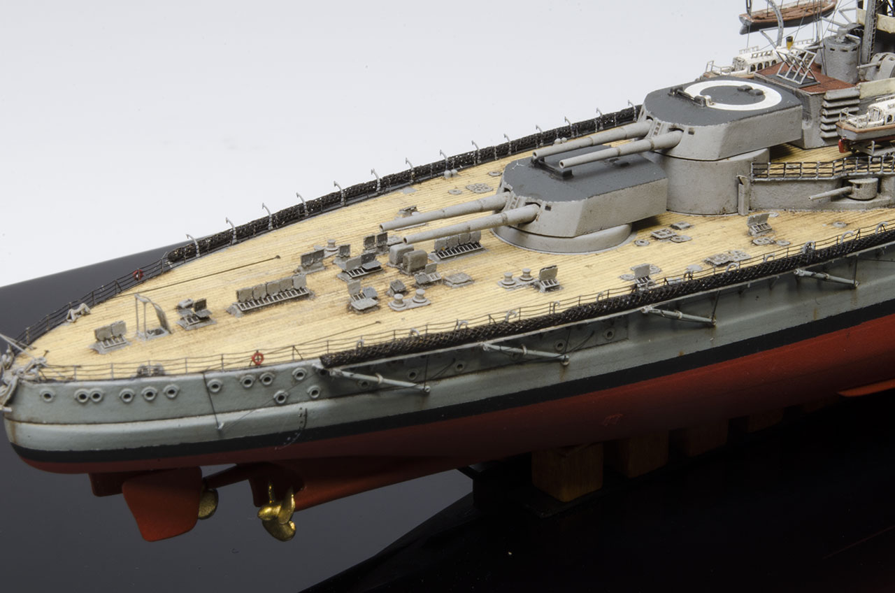

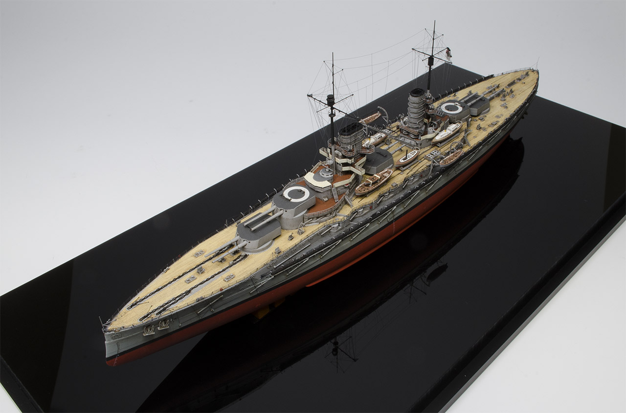

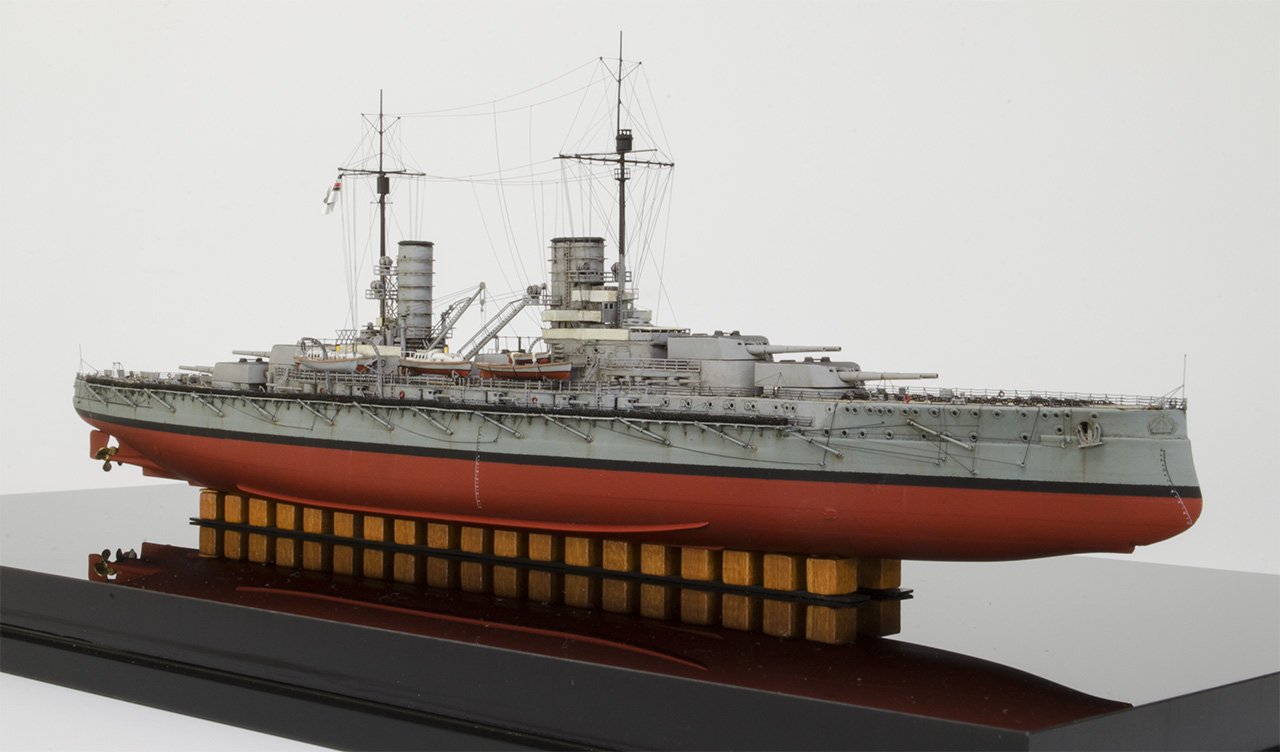

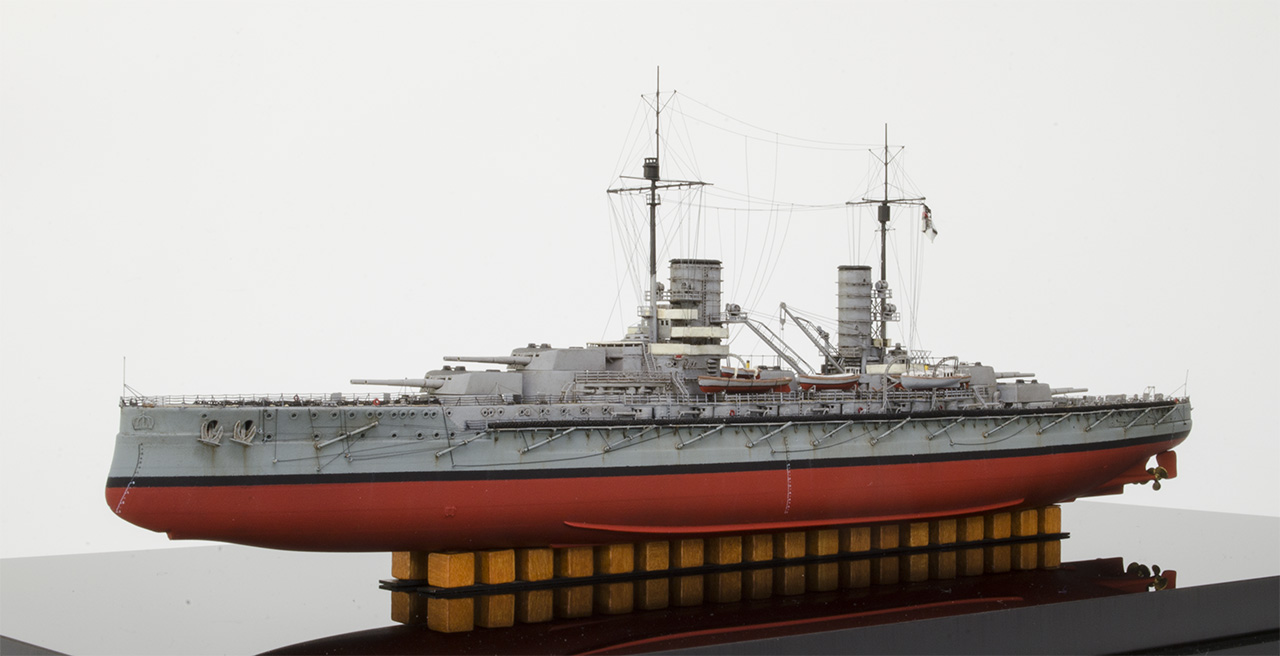

Hello everyone!
Long time no post, its been a bit busy around here. I would like to show you some pictures of my latest model. It took me a lot of time and it is not fully correct for the time depicted but what can you do. I got lazy and I did not take good pictures of the progress.
It is the SMS K�nig around the battle of Jutland. The kit is the ICM kit with the Flyhawk upgrade kit for it. The scale is 1/700. Some parts were 3D printed, for example the 15cm gun casemates and the torpedo net booms. I chose to 3D print them because I needed so many to look the same. It was painted using acrylic paints. The masts are made out of brass rods. The rigging is a mix of stretched sprue, metal wire from Modelkasten and elastic thread from Uschi vdR. As reference I used plans from Koop and Schmolke and some copies of the B. Scholz plans I found online. I also found some nice photographs online. The model also has some custom made photo-etch parts, like the torpedo net davits, bow crown, and hatches. The torpedo net is rolled up photo-etched grid, i think it looks OK. It was a very long process but I learned a lot about the ships of this time, and new techniques.
Comments and critique are very welcome!

A beauty! Love the rolled-up PE grid for the nets - do you have a link to which specific product you used?

Hello Timmy C, thank you for the comment! The one I used is this: https://www.scalemates.com/kits/flyhawk ... ng--306796Timmy C wrote:A beauty! Love the rolled-up PE grid for the nets - do you have a link to which specific product you used?
What I did to not use so much of it, is that I rolled it up over a polystyrene rod core in sections. The rod was 0,70mm thick I think, from Evergreen. Then it was just painted black.

Very nicely done. That's a handsome model of a good looking ship!

VERY impressive!

Very nice work.

Very nice and great idea on the rolled up torpedo nets!

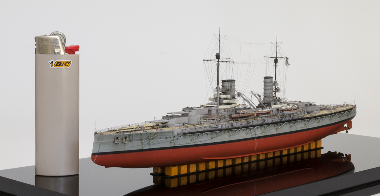

Here is another picture with a lighter as i have seen many people do. The perspective makes the model look a bit smaller than what it really is.

Excellent work with extraordinary detail; keep up the good work!

Really impressive! I have seen it with my own eyes, the K�nig model is very detailed.

Wow, after a long silence you surprise us with this Erick!
That is a fantastic model! There is not only a lot of detail for 1/700, it is also done very sharply so it feels very much in scale. I like the colours a lot too.
I think, if you would have written it is 1/350, everyone would have believed you!

@maxim, thank you! it needed some repairs in the rigging since the last meeting.
