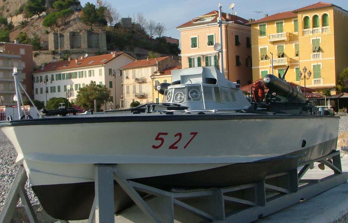

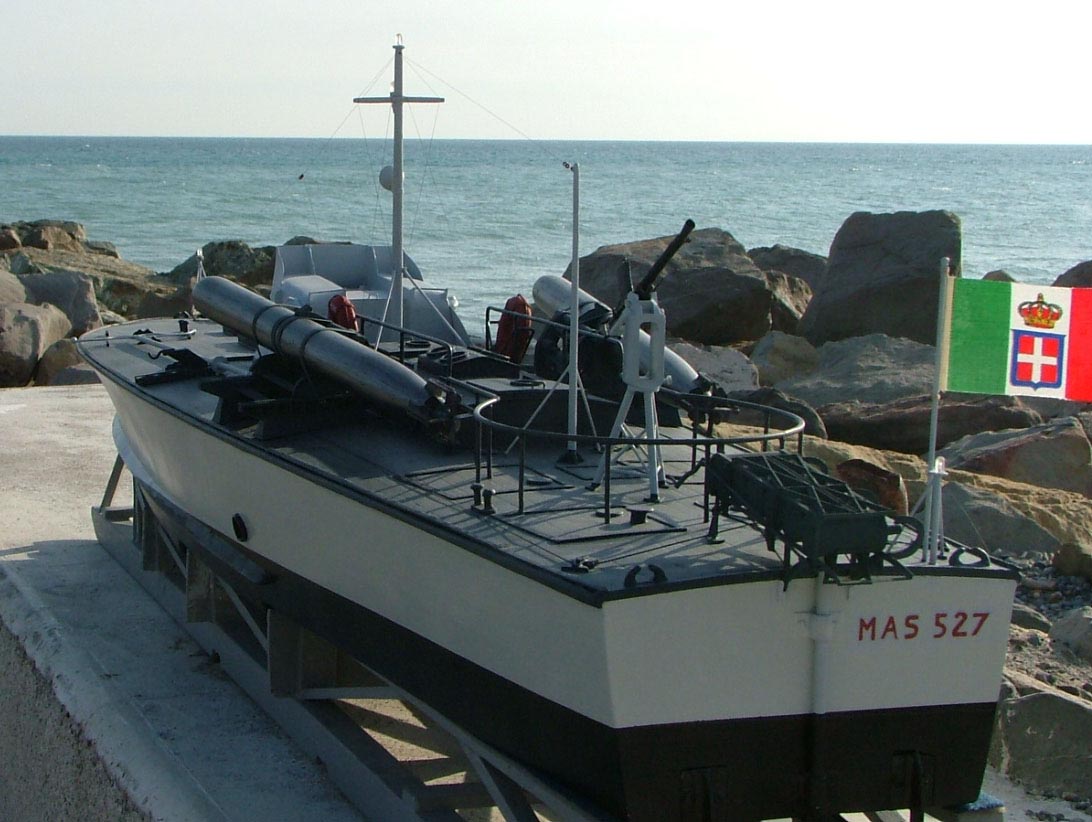

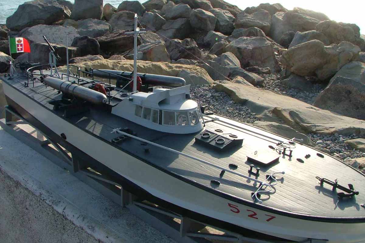

As my firs post in this forum I would like to show you some photos of my first scratchbuild model, the MAS 527
You know... as I'm still young i LOVE everything that's (or may I say "that was"?) fast and noisy... no wonder if I chose to build a 42-knots MAS instead of a battlewagon :big_grin:
The hull and deck are fiberglass-molded, originally it was intended to be an RC model, then I resigned to keep it on my floor (it's far too big to sit on my shelf, being almost 90 cm long).
Nearly everything else is made of plasticard; the air intakes over the bridge had to be vacuum-formed. Torpedoes are resin-molded.
I'll submit some more photos as soon as I'll have reduced them to proper size... meanwhile, I hope you'll enjoy my work. Questions and comments are welcome.

I would like to suggest something that could make it even better: find some flag that fall naturally, instead of having a "boarded one"

Thank you everybody, for your welcome and comments
The flag in fact was one of the few commercial items I used:it is made of a thin fabric, and usually it looks good, but on that day when I took those shots a very strong wind was blowing. That's why the flag looks a bit rigid:I swear that when it's indoor it acts quite naturally :wink_3.gif

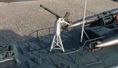

A closer wiew of the Breda '31 HMG

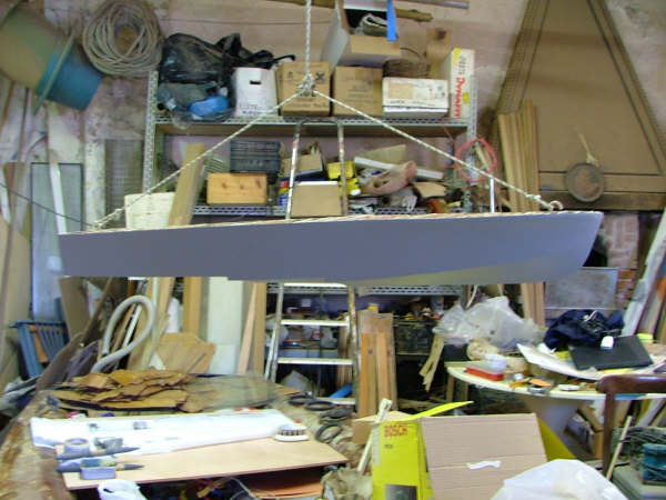

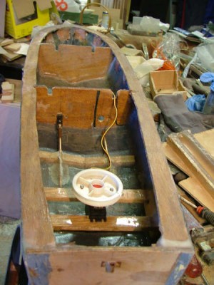

The more interesting point about the building process is, to my opinion, the fiberglass molding: I would like to discuss about this with you all, because I still have mixed opinions about it.
What I'm still asking myself is: finally, was it worth all that work? Could it be a useful modelling technique for large scale RC models?
It was not an idea of me, however: it was my father, used to work on real boats, that suggested me to use the molding, offering me the materials. Even if I'm sure that most of you already know the process, I'll shortly resume it.
First of all, a traditional wooden hull has to be built: this will be used as the plug for the mold. As the mold itself will be almost impossible to correct when finished, the plug must be without any defect. Then, it must be covered with several layers of a release agent, that can be a special wax or PVA (polyvinyl alcohol), but I had many troubles with PVA and I definitely prefer to use the wax.
Gelcoat, a very durable resin, can then be applied, followed by layers of fiberglass and resin (4 or more). Finally, the plug has to be separated from the mold.
Then, to get the fiberglass hull, apply wax to the mold, then fiberglass and resin; Gelcoat is not necessary for the hull, as it will have to be painted anyway.
It's not really difficult: the problems are that the process is time-consuming, resin must be manipulated with caution, and those materials may not be easy to find.
The wooden hull that served as the plug for the mold

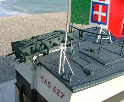

I am now trying to put together a semi-kit of the battleship Giulio Cesare, and I will start a new post about it as soon as I will have enough photos.
For now, I submit a detailed wiew of the depht charge rack (built with Evergreen beams, depht charges are sections of a plastic tube) and one of the few photos I found of my work in progress, where the fiberglass hull can be seen; the mold for the torpedoes is barely visible at the right, between my gloves and a screwdriver :smallsmile: .
