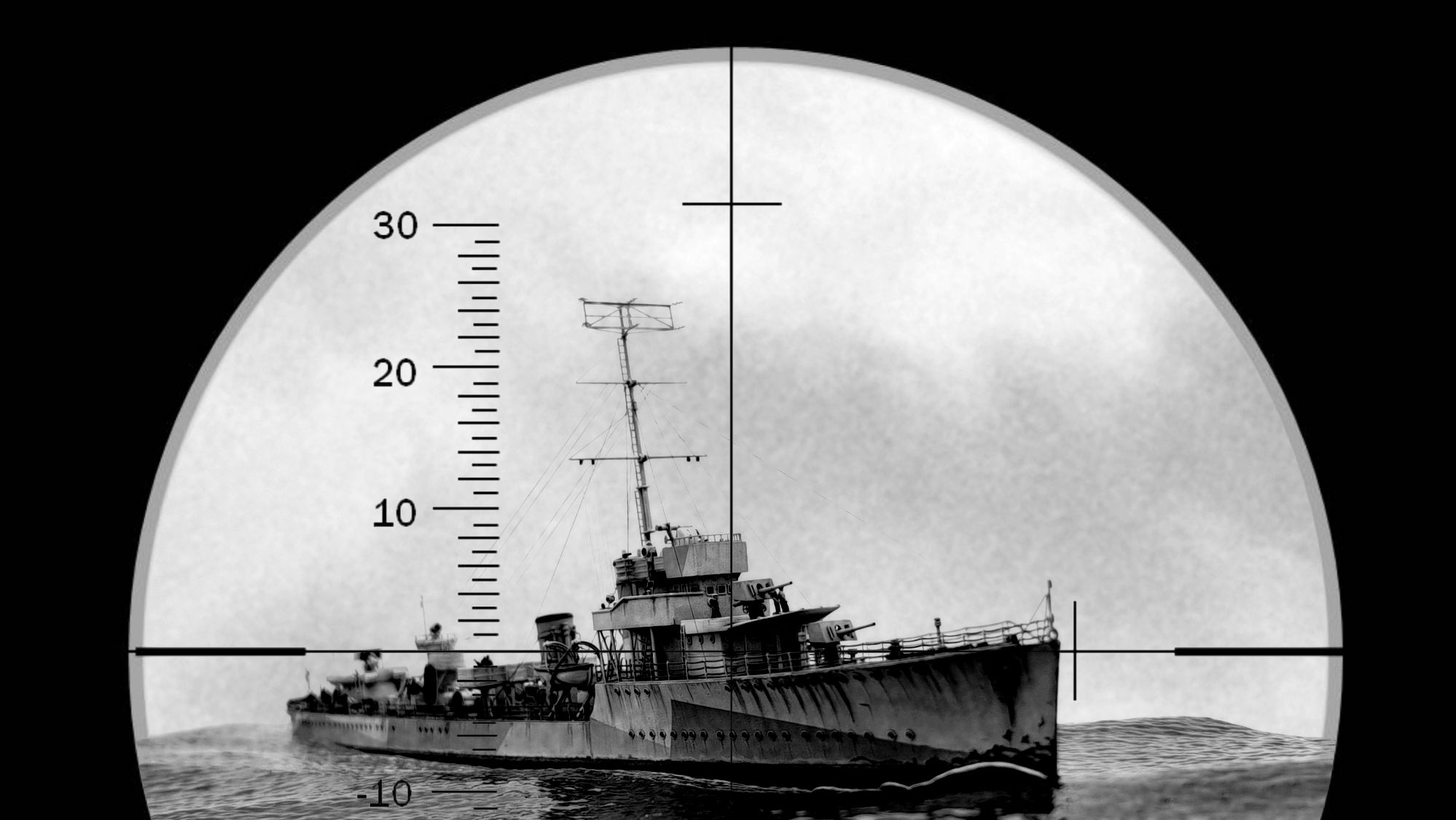

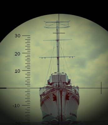

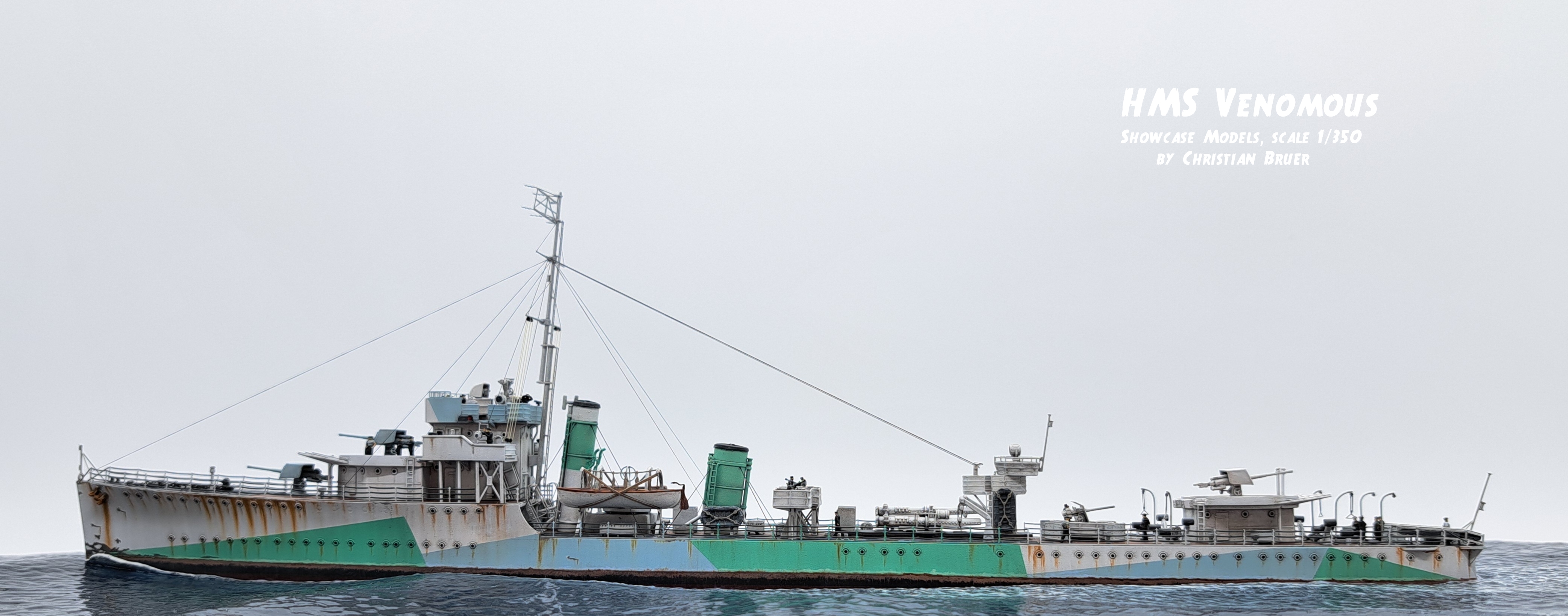

After I have been off from ship modelling for a while but I came back to some of my started models and finished the V&W class HMS Venomous in her 1941 outfit lately. As a basic for my model I used the excellent Showcase Models HMS / HMAS Vendetta. To build the modified V&W class destroyer HMS Venomous in her 1941 outfit a few modifications are needed. One main topic was to extend the forecastle and bridge, as well as extended bridge wings. The arrangement of the ships main artillery, AA guns, torpedo tubes and depth charge throwers was also modified. The aft 4” gun was removed to extend the depth charge rails, as was the aft torpedo tube to make place for a 3” HA gun. The mast was made of brass rod and yardarms from MASTER and a Typ 286 radar on the mast top from a generic radar set, I guess it was White Ensign Models. There were a lot of smaller modifications and add ons to increase the depth of details, some scratch build and some out of generic PE sets.
HMS Venomous is shown in her 1941 outfit wearing a Western Approaches scheme of white and pale green and blue. The paintwork was done using Vallejo acrylics. For all weathering effects I used artist oils.

Regardless of a start of this project back in 2017 and a unbelievable evolution in 3D printing aftermarket parts I am really happy with the final result and the modifications I have done.
