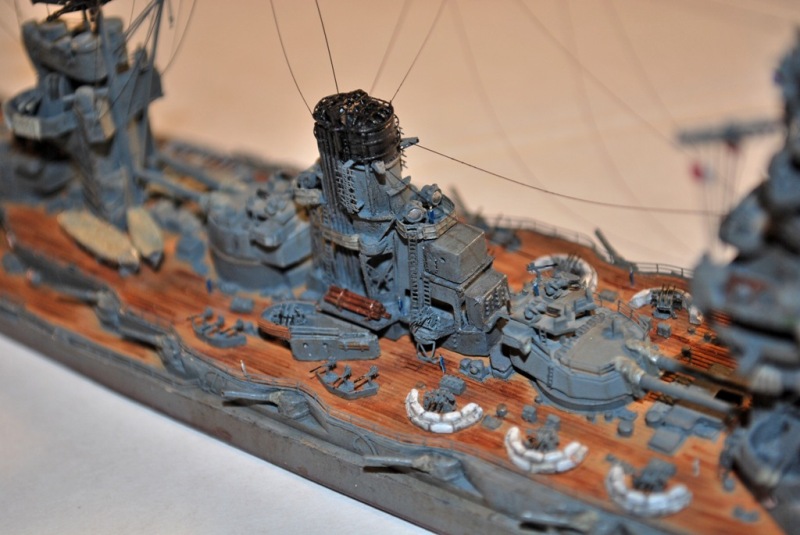

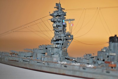

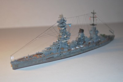

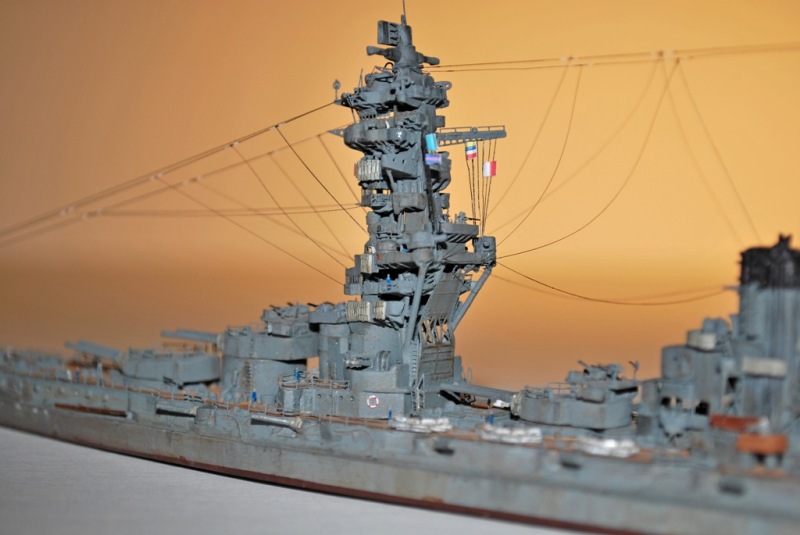

I finished my Yamashiro using this super P.E set and i was very pleased with it.

Outstanding job on the Yamashiro, Jose.
I only wish someone would release a 1/350 Fuso or Yamashiro. A battleship with 6 turrets must be built.

Beautiful job Jose! :woo_hoo:

Thanks for sharing Jose, its really superb.
I hope one day I finish mine...

Thank you fellows.
Serhan the biggest headache i had was when i started assembling the pagoda mast, my advice is take your time on this one :big_grin: the entire P.E set looked pretty sturdy to me but i also dealt with very delicate pieces.

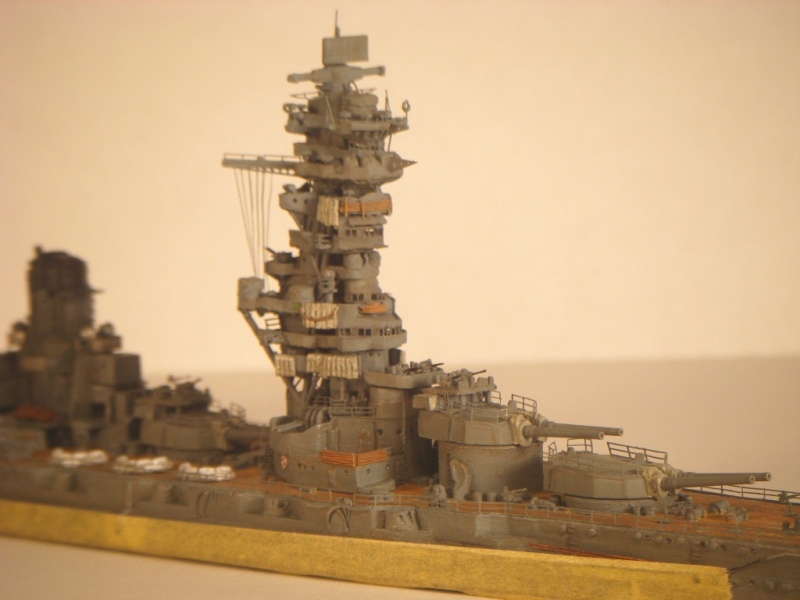

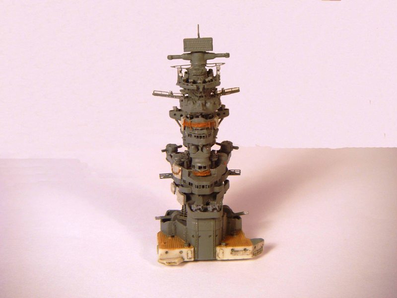

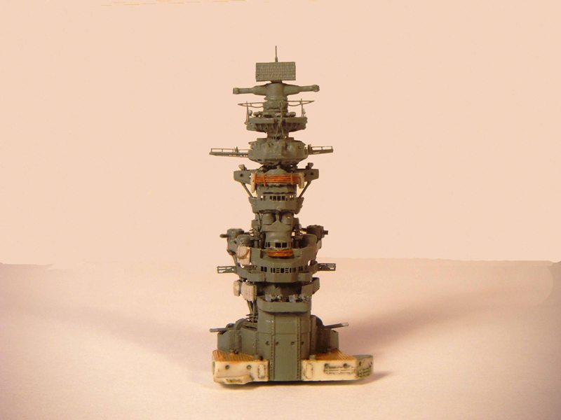

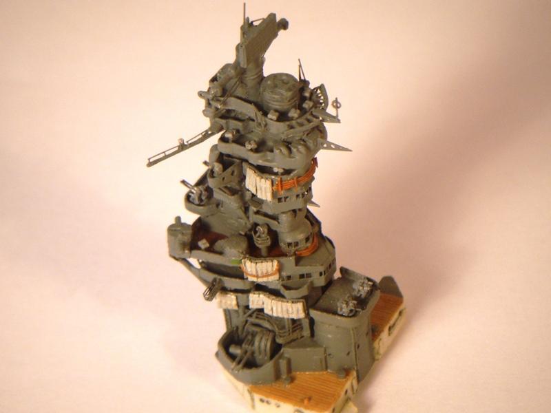

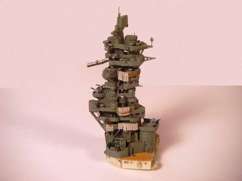

I got to finish a few things on the pagoda yesterday, i can say it's been a long way... i had to take the whole thing apart and then get rid off the old paint. The trickiest thing of all was adding Flyhawk's p.e i had to do some extra filling since this p.e set was never designed for the Hi-Mold kits but all came out better than i hoped for, sometimes you got to take some risks and just go for it.

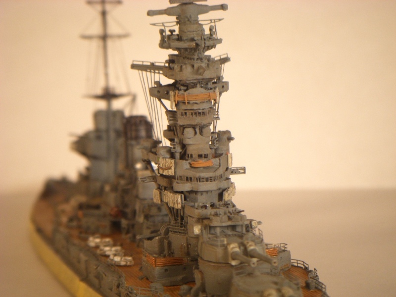

1 more

Hi Jose,
looks very good so far :thumbs_up_1: I like the extra ropes and mattresses.
cheers
Gilbert :thumbs_up_1:

Hello Jose,
Many thanks for posting - great work, and superb photos (and pretty useful ones!) Kind regards - Alex :smallsmile:

Re: Calling all IJN Fuso & Yamashiro fans
Post by Allan McBeath »
how did you do the matresses? Ill have to do the same on my Yamashiro 1944

Silent one, regarding your question i used a 0.5 mm styrene rod then i cut it in pieces no bigger than �4 millimeters�. After this i always try to glue them in 2 or 3 pairs, its simple to work with them all together instead of doing one at a time and with my ruler holding the pairs down i shape them with an X blade. i trim both ends with the blade, you don�t want to have sharpen stakes to kill vampires with :big_grin: blunt ends would be just fine. hth

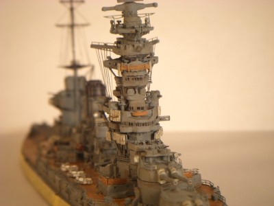

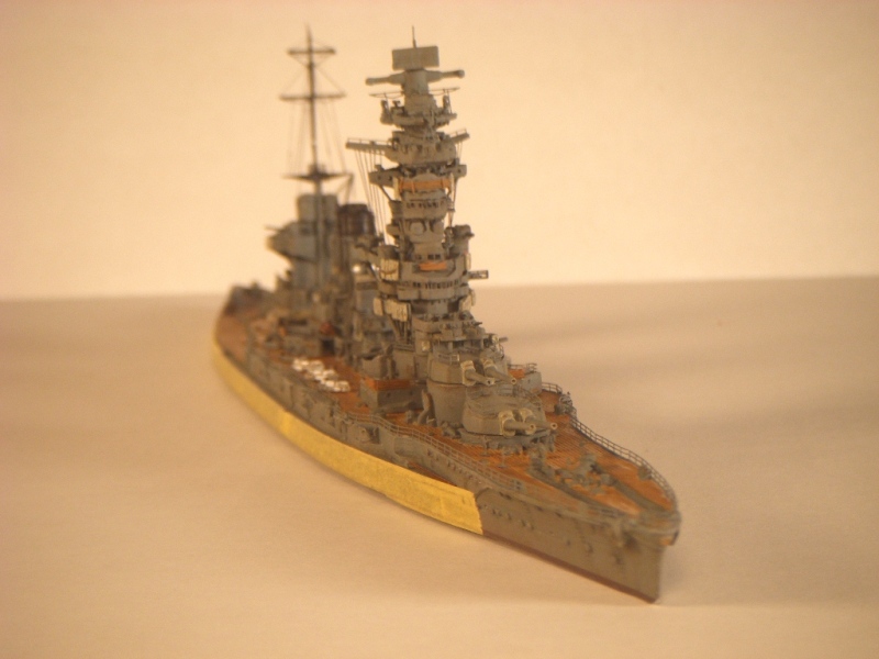

I give you a heads up Chuck it's my old Tone from Minekaze. can't wait to start on her i recently bought Flyhawk's Takao super set which i intend to use on her.

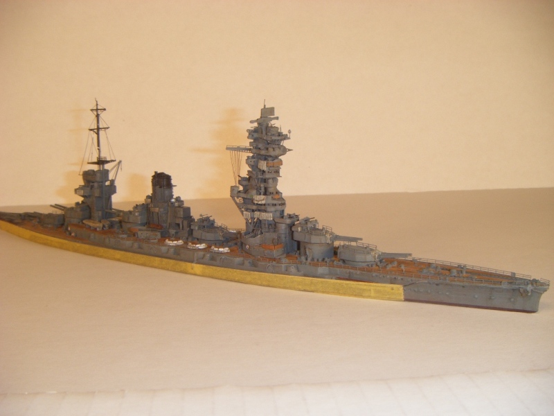

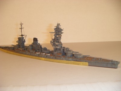

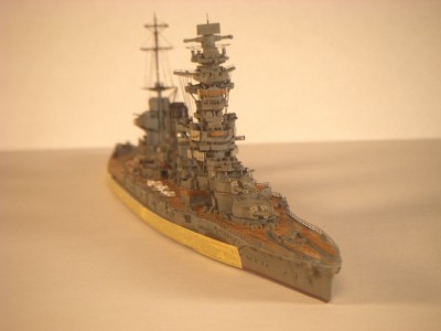

It�s been quite a challenge so far i really tried to finish her before the end of the year but i couldn�t, i�ve been working on her for the last 3 days nonstop maybe if I had cut off some corners like details.. nah i doubt it though i came short on Niko's 25 mm AA i bought and i�m also running out of railing. I didn�t want to post anymore pics until she was done oh well. I got tired of smearing and redoing the boot topping that�s why you are seeing yellow tape on the hull, good thing about this is that you always learn new tricks down the way too bad you got to hit the ground a couple of times before getting there :big_grin:

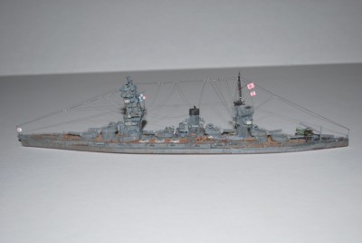

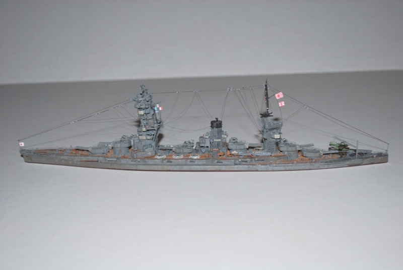

She is done!!! It did take me longer than i had anticipated though, i could say I�m done all i got to do now is place her next to Yamashiro and voila but after working constantly on her for 10 hours during the weekend my mind is exhausted i�ll get back to her in a week, enjoy the shots.

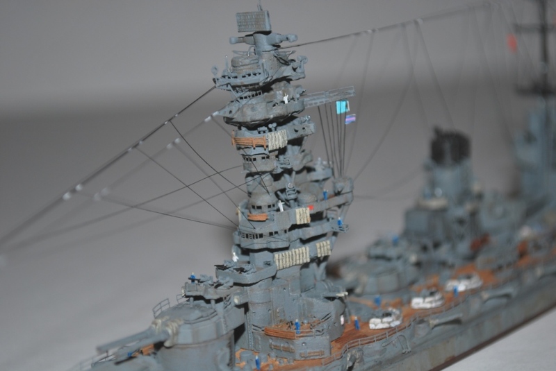

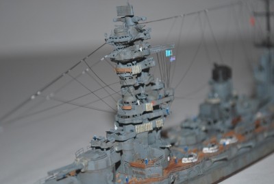

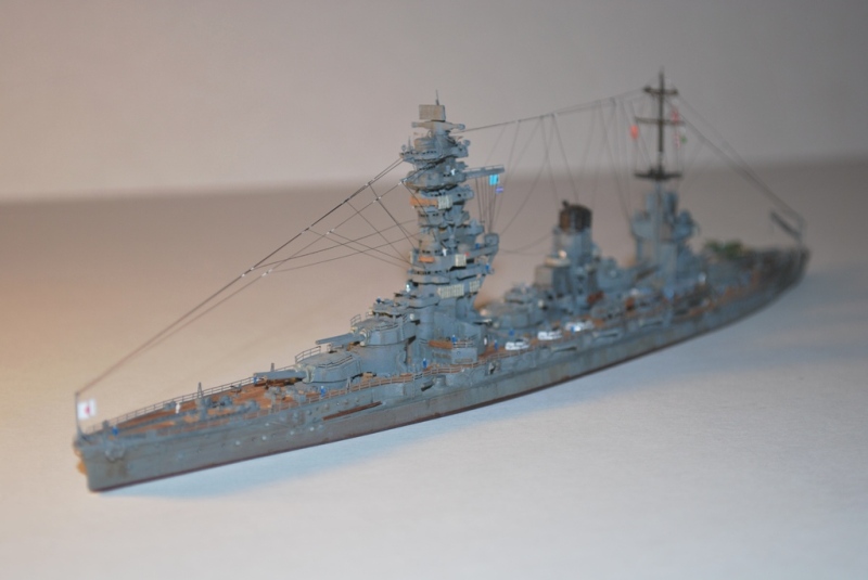

3 more

WOW Jose, very impressive job :thumbs_up_1:
I bet your rigging, a very complete and realistic one by the way, was a nightmare to make :big_grin:
Bravo Zulu from another Fuso "nuts"
