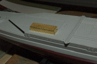

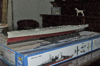

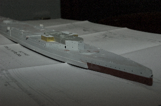

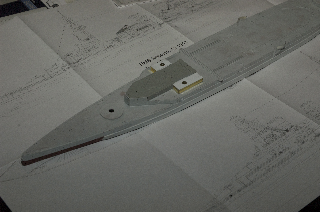

Hi all,
This is my first ship model in over 20 year and the first plastic model in more than 15 so any help would be appreciated.
I'm attempting to make an accurate version of Repulse as she was sunk in 1941. This is based on photos, underwater video, the plans from the 1936 refit and additional original plans of the 1939 deck houses (thanks to John Roberts!)
I plan to make use of the WEM PE set and also the GM Hood set (when it eventually turns up!
As has been discussed elsewhere, while the Trumpeter kit is fantastic in many respects, it is also wrong in several areas and seems to be a mixture components from 1936 to 1941. And while it has very fine detail on such things as hatches etc, other areas such as the hull plating are completely absent..... but more later. The first thing I've attempted is to add the butt straps. These are visible on many of the close up photos. I've chosen to use domestic aluminium foil as I wont be able to sand them back once in place without loosing the "eye brows" on the scuttles. I've also removed the 3"HA gun shield (the Trumpeter version is as per 1936) and replaced it with 2 thou brass. The next thing was to add the inboard struts to the A brackets of the prop shaft support. How they could leave a big item like this off is beyond me! The deck houses came up for attention next. These were altered for the Royal tour that never happened and were subsequently turned into cabins. Today the scuttle have rusted out and fallen in and one can look into these cabins and still see the remains of beds and the bath in the bath room.
I removed the raised section on the forecastle deck and tried out the WEM PE deck house. Unfortunately it's not correct. It only has 6 scuttles (the original had two extra for the bathroom) , has hatches at either end and does not have wood decking on the roof. The correct port deckhouse house is not supplied in either kit. Here's the original plans: So I've remade both houses out of 3 thou brass. I'm awaiting the hatches on the GM Pe fret to add hatches and widows on the port house and the "eye" brows for the scuttles on the starboard house. Hand rails are made form stretched sprue. The armoured step that the model has at the rear is also not visible on any photo or plan that I have.... So I've removed it: Finally.... for the moment, I've started to attempt to simulate the hull plating by using spray filler and masking. The hull plating on Repulse is quite subtle compare to say Hood. I've not tried this technique before...... hope it all works out! Anyway... that's where it's at at the moment.... more to follow.
Any advice much appreciated.
Andrew

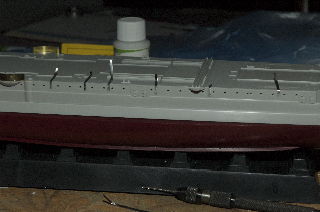

Very impressive thus far... looking forward to seeing the continuing progress of your build!
As for the hull plating simulation, I have used Gunze's "Mr.Surfacer 500" in a current build. The difficuly is to know when to stop. Too little and it may disappear under a coat of paint, too much and it will not look right!
Anthony
Anthony

Hi Andrew, I'm glad to see your re-build of the rear gunhouse, To me the replacement sets are not accurate, I look foward to your progress. J CRAY

secondary PE (upper) star
top star (scratch)
rigging (8/0 for shrounds... will use Caenis for aerials)
ladders
Still to be added,
Searchlights
rail to searchlight tubs
chimney for admiral's kitchen (NB starboard side only, not on both sides as shown in Polish plans and Kagero 3D book)
Vickers quad mounts X2 (any suggestions of where to get some!!!)
DF aerial (PE)
* the original starfish platform plugs into the top of the mast at the level of the bottom of the supports. The PE one has the mast at the level of the platform which effectively shorten then mast by about 2-3mm. I didn't pick this up till it was too late but others may want to extend the mast to get the correct height
I managed to break the top mast when I "unrigged" it .... the 8/0 was too heavy for aerials. This has now been remade with brass rod tapered.
The Bridge is also coming along:
Instruments are from the IJN set of Veteran Models. The bases of the IJN Rangefinders were used and the arms of the Trumpeter ones added to get the correct length. The instruments should be two Evershed bearring indicators and the Torpedo director. I felt that these were as close as I was going to get. I cannot find a photo of a RN Evershed despite all my books on Gunnery!
A compass has been added to the roof of the platting house as per the plans.
The upper platforms are still in "dry fit" only.
The next major task will be adding the degaussing cable and painting the hull now that the paint has turned up. The degaussing cable is a work in the dark!
Andrew

Well the GM Hood Pe set arrived while I was away and it's well worth the wait.
Square windows (do these need rain gutters??) and hatches added to the rear deck house, easy eye brows etc. and lots more to add else where
I've mocked up a degaussing cable from 0.3mm brass wire / rod. Would be interested in people's opinion of size etc before I glue anything in place:
- Sylvain Auger
- Posts: 323
- Location: Qu�bec, Canada
Re: 1:350 HMS Repulse 1941
You're Repulse looks awesome Andrew
To my untrained eyes, your degaussing cable looks just fine. Not too big and not too small but in this area I'm really no expert. When I built my Repulse I backdated the model to a 1938 configuration in order to avoid the cable altogether
Sylvain
