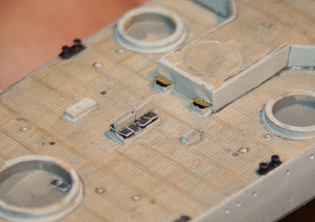

After an exploratory coat of paint on the decks I decided to open the aft officers accommodation hatches as seen in almost every on-deck photo of Rurik.
I removed the nicely rendered tops of the skylight castings and depicted the grilles over the windows below--often seen half open - with some fine relief etched doors cut into squares, the open lids being strips of PE and doors as appropriate to the size of the skylight.

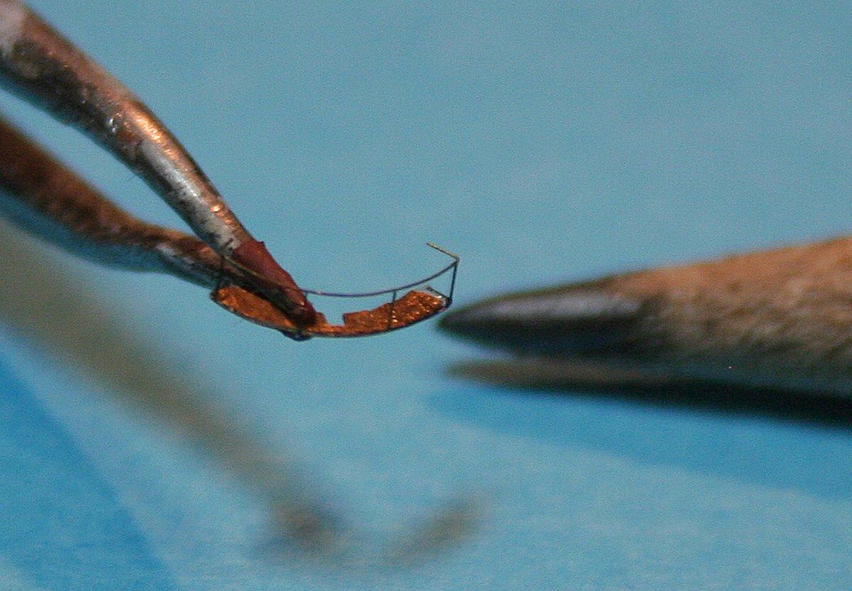

I added the (just about visible!) rim strake around the aft conning tower made of stretched sprue

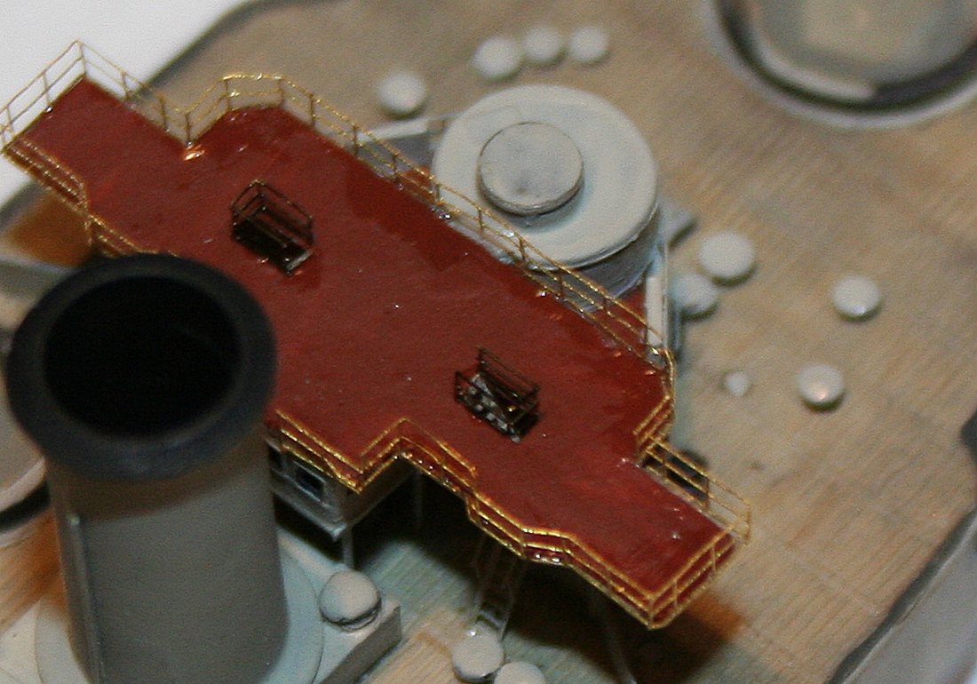

The fwd superstructure and conning tower had a beading strake on the ral ship--I have added this using copper wire
The deck will be pared with a blade down nearer to the level of the strake

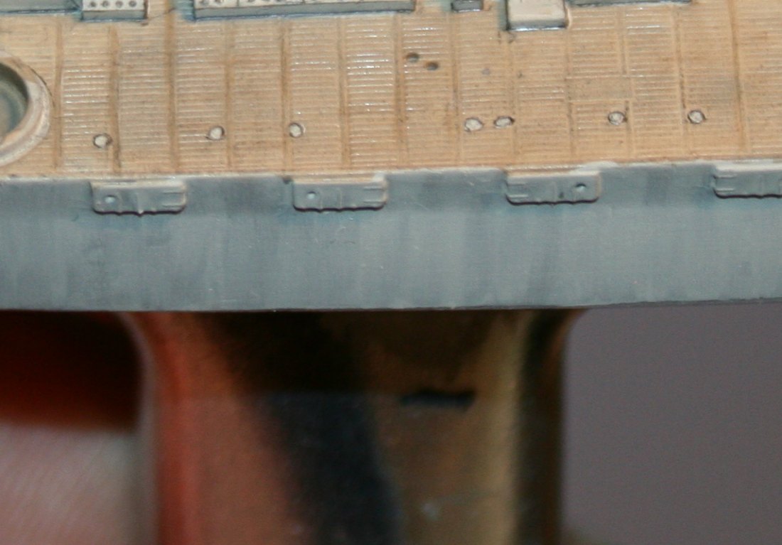

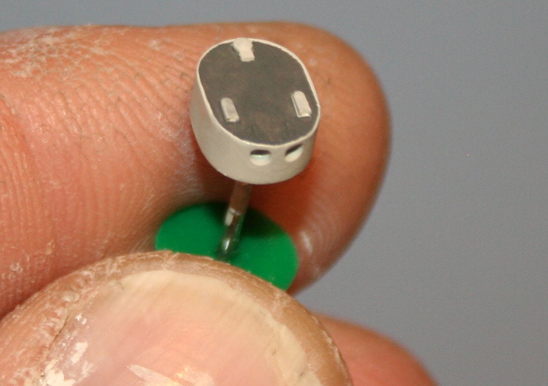

The numerous mushroom vents of all sizes all around the deck were supplied as small castings.
The smaller ones were fine--but I preferred the large and medium size to have a thinner top flange- the slight doming and rounding was done later with a drop of thinned white glue- not perfect-- but give the impression of the edges being rounder...
I substituted the resin items with my favourite items--model railway tubular rivets
I have a decent selection of railway items that give a multitude of nautical uses...

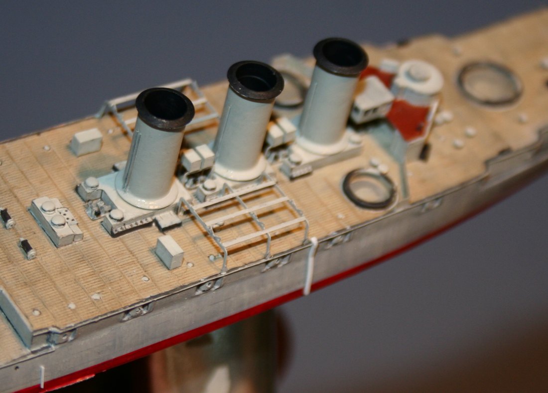

The PE supplied boat racks midships are rather good-I toyed with adding more depth--but photos suggest them to be about right dimensionally- the small triangular reinforcing gussets also being on the PE fret.
Note that the aft funnel only did carry twin steam pipes-whilst the remainder carry single pipes only

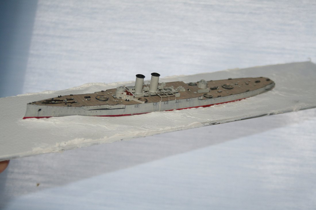

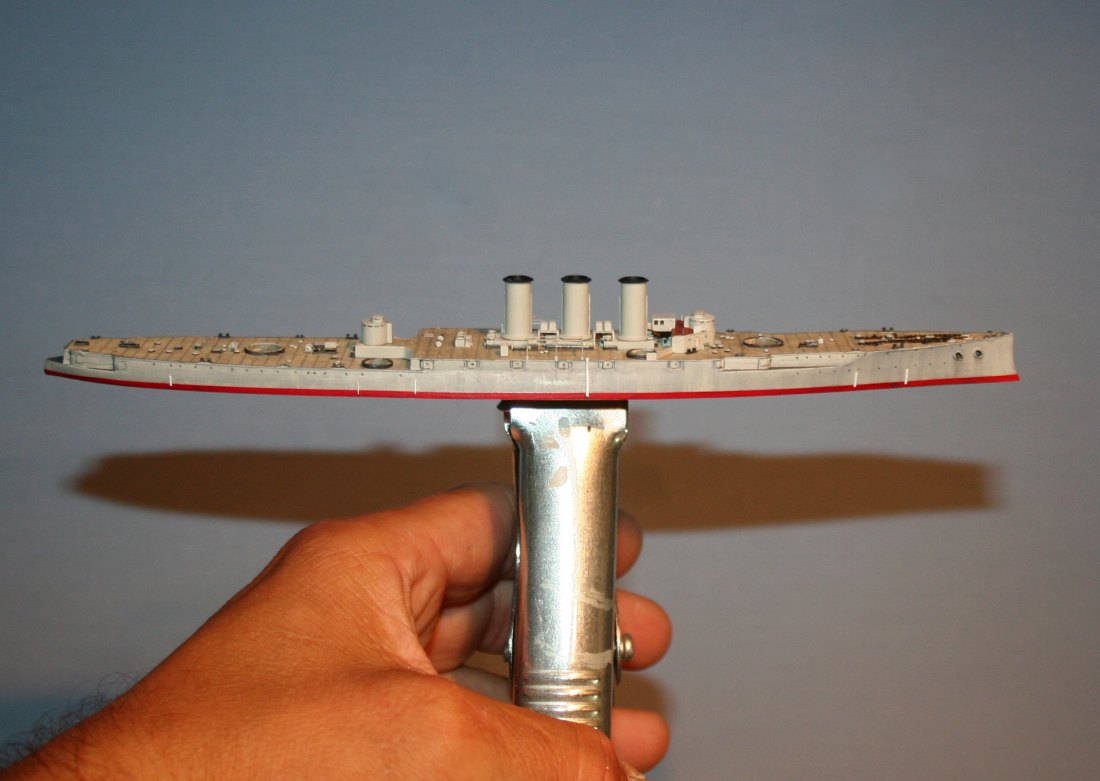

The ship is now mounted on her sea-base-...phew-- much safer and easier to handle-- no more involuntary removal of details...
( My open hatches on the aft deck are all.. err .... currently in' storage' -- ( big clumsy thumb removed them all !! )
The model is screwed to the usual stainless steel plate with countersunk holes using No6 self-tapping screws into 3mm drilled holes...
virtually all the photos I have show Rurik cruising at slow speed in calm waters.
most handsome indeed...
I however wanted the ship to show here dashing lines to best effect- as she was capable of 21 knots she should be seen powering along with a bone in her teeth.... :thumbs_up_1:
My usual method of water construction--watercolour paper over cocktail sticks, paper sealed with CA

Studiers of the build will notice that the stylish three funnelled cruiser is currently only wearing two funnels...
( dislodged the aft stack with the drill after mounting...( doh! )
glue will sort....

I endeavoured to remove these resin bulwarks and then tried to thin the deck to near scale--
and I failed dismally!!! .
A new bridge deck was made- of paper. I used the resin version as a template- with no alteration other than
merely cutting the stairway apertures a bit narrower.
I made the deck using the template as a half pattern-
ie - the paper was folded in half, cutting through two layers of paper simultaneously guaranteed symmetry.
The centre crease was flattened with smooth faced jewellers pliers.
I made a small ball of double-sided tape and tacked the underside of the deck on; thereby not having to touch the surface of the deck for the purpose of glue application.
The paper was stabilised using CA runny glue spread on rapidly using a cocktail stick--and allowed to set.
Then I removed the deck and stuck it on the ball of sticky tape the other way up and repeated the application of CA.
Thereafter I fine-tuned the 'flatness' using my fingers.
Once mounted and with rails attached to the edges it will be perfectly strong and stable
The contrast in near-scale deck thickness can be seen here:
More progress soon!
JIM B :wave_1:

The build continues now into the minutia...
The Bridge structure is a fiddly affair--lots of small struts ...
The bridge decks railings had to be 'cut-and-shut' of many small pieces to get the stanchions in the correct places.
using WEM superfine rails here( it really is!)
The fwd funnel platform was supplied as a PE piece--neatly done actually!
I added some single bar rail around the outside perimeter so as to keep it thin.
The upper pilot house was supplied as a resin casting.
I had completed it ready to install complete with the canvas railings, merely the 'canvas ' paint was drying...
when it inexplicably 'pinged' out of my tweezers into a hidden dusty recess of the modelroom... :mad_1: :mad_2: :Mad_5: :Mad_5:
After about an hour of searching in the vicinity of where I thought I heard it land...--and having discovered all sorts of long forgotten treasure ...
I resigned myself to scratching a new one-- and I may as well make the windows see thru...-- not because I had any thoughts per se -- I was quite happy with the cast item to which I had laboriously fitted window frames...
This was a bit tedious--as the windows have thick divisions between them.
using some 1/350 ladder ( WEM Koenig ) I added the windows individually to the T-shaped styrene box bottom; and cut a matching roof of paper.
Once the paper deck was fitted I then in-filled the window dividers with white glue.
The upper deck had a small extension deck added -this is supported by two slim pillars ahead of the pilot house.
After painting and adding all the upper rails - again cutting and shutting in very small pieces...
and adding the canvas of white glue -0 canvas it all looked pretty ok
Alas I have shot these photos in poor light and with a flash-too close...
I shall endeavour to take some better photos in daylight with the macro lens shortly.
In real life it looks crisper with less flash reflections!
