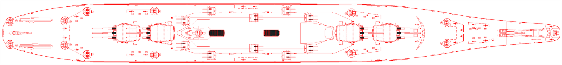

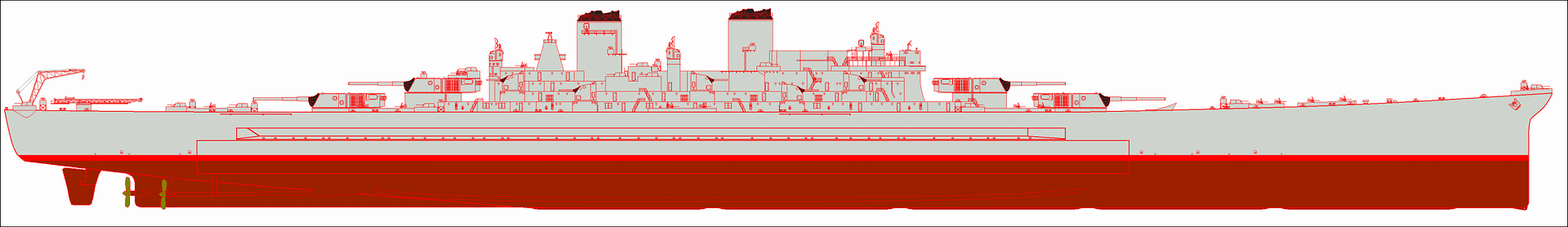

I am most likely doing full hull, I haven't done a single water line ship to date. I re-drew the drawing with the bottom hull, when all is said and done I will have the top view, starboard side full hull with camouflage pattern and port side water line with camouflage pattern. The deck will have a pattern as well. This will help when I go to build/paint my actual model. I'll end up printing out a simple line drawing with no color, than the colorized version.
- ArizonaBB39
- Posts: 1321
- Location: Tempe, Arizona
I've done some more modifications and I removed the single 20mm guns removed some of the dual 20mm guns and moved others around. Now it looks more like dual mounts were placed on existing single mounts and where the dual mount didn't replace the single mount the whole mount was just removed, but the gun tubs/splinter shielding wasn't changed any. I hope that made sense, you'll be able to see what I mean at a later date.

Abe! I like the design very much. I wish I had your skill and imagination.
One of my favorite Montana designs is BB-65 Scheme 4, the single-funnel
variant which looks like a Super South Dakota:
Regarding your AA fit, the only advice I could offer you is to carefully
consider the placement of the Oerlikons with respect to muzzle blast from
nearby Bofors and 5-inch mounts.
Having been in the Army for 20 years, I can assure you from personal
experience that muzzle blast (concussion + flash) poses a serious threat
to people nearby. The designers of real warships took this into
consideration.
Look closely at how an Iowa class ship's Oerlikons are positioned from
the point of view of muzzle blast from the Bofors and 5-inch mounts and
you will see that the spacing suggests the effects of muzzle blast were
considered. The spacing does not provide perfect protection to the
Oerlikon crews but you will see good space and even shielding between
guns to give those crews some protection.

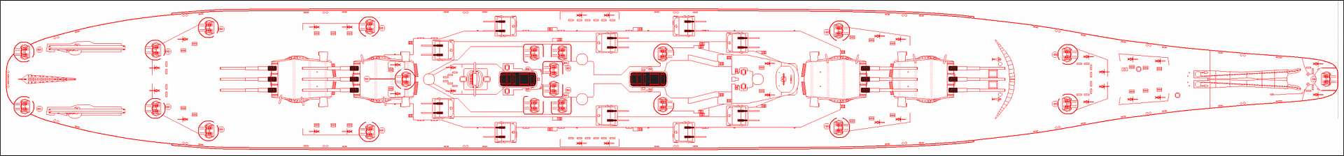

- ArizonaBB39
- Posts: 1321
Thanks for the kind words guys.
EJM, there will most likely be more than 20-25 40mm mounts on the ship. I've removed all the single 20mm guns and they have been replaced with dual mounts, or the mount area left empty completely.
Steve, thanks for the advice! I went back and looked at what I have so far, and it looks like all of my 20mm crews would be safe
Drawing updated pic:
New bow, all 20mm guns are dual mounts. All of the 5"/54 mounts are in place, so far no new 40mm mounts. Funnels and armored conning tower in place.

wr
As arranged the AA mounts just aft of 'Y' turret would not last more than FIVE minutes, neither would those positioned port and starboard abreast 'X' turret. Pull the latter in tight against the bulkhead, same for those forward by 'A and B' turrets.

ArizonaBB39 wrote:Thanks for the kind words guys.
Steve, thanks for the advice! I went back and looked at what I have so far, and it looks like all of my 20mm crews would be safe![]()

As I mentioned earlier that is all I have at the moment, work has become slow because I can only work on it during the weekends, I have school and my job during the week that keep me from my computer at home.wr wrote:.
May we see the rest of the layout?
Thanks for the advice, I'll take all of the things you guys have been suggesting into consideration when I finalize the drawing and start construction on my model.

wr, Just wondering as to your reasoning that the AA mounts wouldn't "last more than 5 minutes'. Aside from having some 40mm's mixed in with the 20mm, this is a very similar arrangement to what's on the Iowas, and those lasted considerably more than 5 minutes.wr wrote:As arranged the AA mounts just aft of 'Y' turret would not last more than FIVE minutes, neither would those positioned port and starboard abreast 'X' turret. Pull the latter in tight against the bulkhead, same for those forward by 'A and B' turrets.

Not too bad, Abram.
Just one small suggestion though: Perhaps add 2 (One on each side.) more 40mm emplacements on the Second deck level on either side of the bridge area. This area IMO, needs a bit more protection.

Ok, here is the comparison drawing, now you can get an idea of the sheer size of this behemoth:
USS Montana, USS Missouri comparison Starboard side
USS Montana, USS Missouri comparison Top plan

One feature puzzles me about all the plans for Montana, the number of 5" guns. The Midway was completed with 18 single 5"-54, I would think that a 1944 Montana would have at least 12 twins and maybe even 14. The ship certainly had the space and displacement to handle this load and the 5" gun was loved by the USN at this time.
