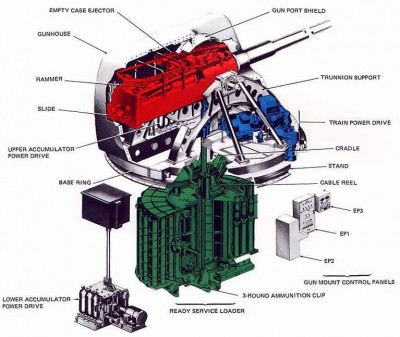

One might suggest the Advanced Gun System (ASG) instead of the Mk71. When one examines the capabilities and level of development one discovers that AGS is a terribly large gun system that provides inferior fire for ship roles, both in NSFS and NSuW. However, since the Mk71 8" gun is simply an expansion of the Mk45 5" gun, delivering 75% more ordnance than a 155mm (AGS round) and 250% of a 5inch round, incorporating the 8inch gun would only require a larger base ring than the Mk45 5", a slightly larger magazine, and it would deliver a far superior precision guided round onto either ship or shore targets. The large amount of surplus volume inside the hull, 600 8inch rounds forward and 475 8inch rounds aft, would provide this ship with an anti-ship and NSFS capability unheard of since the WWII designed heavy cruiser USS Newport News!

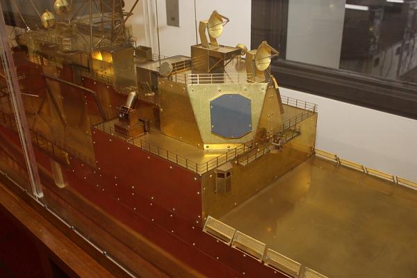

Because the Ticonderoga-class was literally an Aegis adaptation of the Spruance-class destroyer, and the Arleigh Burke-class DDG was "the great compromise ship", the expanded Virginia-class CGN with 128 VLS tubes, 2 8" guns, facilities for 2 HH-60 helicopters, SQQ-89(v)15 sonar, 8-32 Harpoon missiles, thicker armor protection, and nuclear power, actually steps into a true "cruiser"-like capability. The rest of the ship literally falls into place with little R&D costs.

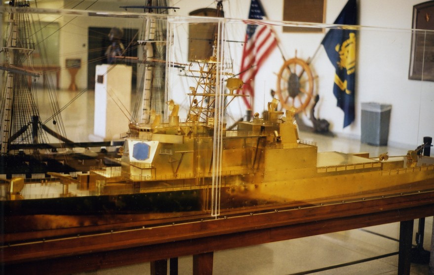

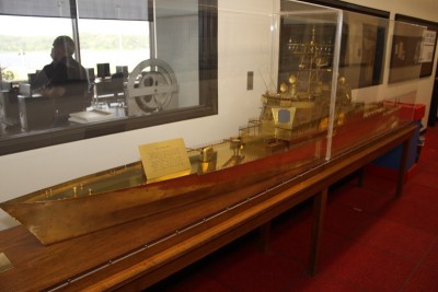

Where is that brass model?

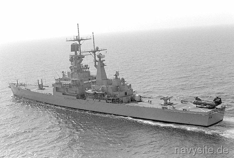

so how about some designs.. since CGN-38 has been scrapped (just the main deck and hull are left from I understand).. Are you purposing using a Spruance/Tycho hull for the base line?... Or stretching a FLTII Burke out for greater stability and upgrades...
On a side note.. NAVYDAVE.. the only 1/350 kit is resin.. 1/700 has plastic and resin version of CGN-38.. have you given thoughts to what will be the starting point..
The trouble is the budgetcuters and polticians want everthing but don't want to spend a dime.. They control money tighter then my ex-wife does.. and that is tight...

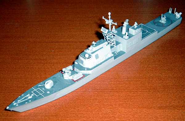

Here is a photo from the earlier 80's doing some research they remove the elevator that was built upon commission and repleace it with extra space for engineering to use for training.. I think these was a lot of wasted space on this platform.. lots of potential for upgrades.. she was a put down before her time... what a shame...

Oh, and the brass model is in the Rickover building at the Naval Academy.

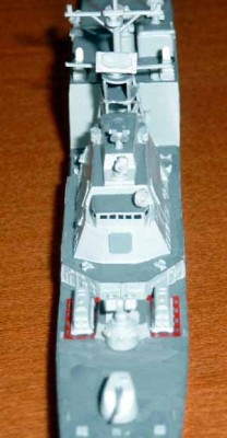

As someone suggestion a build was done base on the prototype drawings... here they are..
My suggestions would be lose the ABL and the Mast.. replace Mk-26 with the VLS with version that the as NAVYDAVE suggested at minimum if not then what the CG-47 are getting in current yard periods.. Upgrade the Main GUN to MK-71 and use a burke style mast.. Again UAV and helos embarkation are a must.. finally consider adding RAMS, BUSHMASTERS..

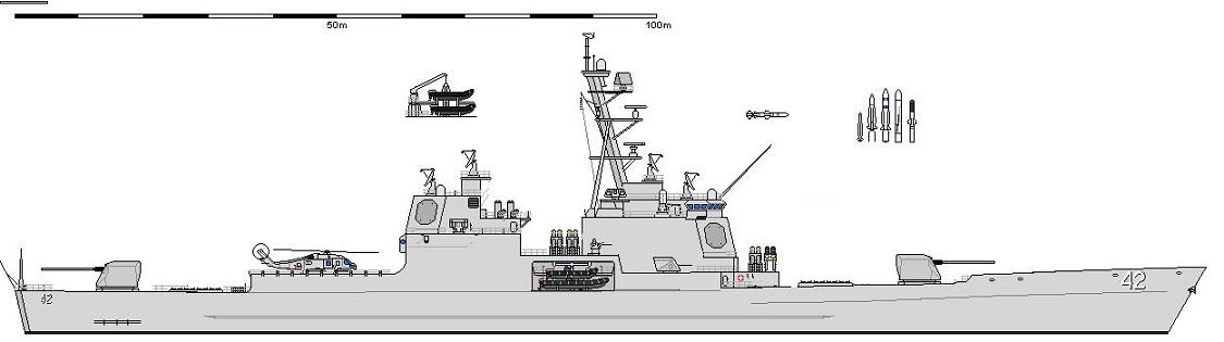

Yes, before I made this post I made a ship bucket drawing:
I will continue to revise this arrangement taking into account internal volume. Striking the balance of internal volume to afford the largest 8" magazines is the next concern. In addition to the 5" magazine I would like to find out what replaced the below-deck helicopter hanger. That will determine how large the aft 8" magazine can actually be. An advantage this hull offers is the very great amount if depth of hull for those penetrating weapon systems, especially in the stern where machinery usually consumes a lot of space, here the stern was designed for an entire below-deck hanger, and that offers a lot of internal volume free of critical machinery like rudder controls.
I will continue refining the smaller details such as structure angle and other RCS concerns.
Keep the observations and suggestions coming.

David,
I know I harp on this theme but I really think that the helo landing area in your drawing is way undersized. Using the scale in the drawing, the landing area looks to be about 60-65 ft (fore/aft length). By comparison, the Perry FFG, which has the smallest SH-60 Seahawk family landing area that I'm aware of, has a landing area of about 83 ft. Recall that the original short-hull Perrys were not (are not) rated for SH-60 operations and that the Navy lengthened them to safely accomodate Seahawks. That suggests that the Navy believes that the shortest, safe operating length is about 80 ft. I know that given a pressing need a good helo pilot can probably land inside a much smaller area but no pilot is going to want to do that on a regular basis.
Also, there is a chance that the aft Mk71 gun is a problem as far as height relative to the landing surface. Again, recall that the stepped down area at the stern of the Perry's landing area was the result of the capstan sticking slightly above the landing area surface. Now, in your drawing, the gun is further aft so it might not be considered a problem.
I'm not a helo expert, by any means, and I'm only drawing conclusions from the examples that are out there. You should try to contact a helo guy and get the real story on landing areas. In the meantime, though, remember that the Perrys had to be lengthened to be able to operate SH-60s. It seems unlikely that a 60-65 ft area would be acceptable on a new build.
Bob
