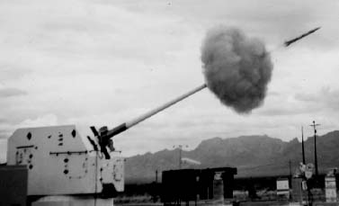

Well, a few concepts in the 80's that could be used to increase NSFS effect with the guns, would be to modify the shells to supply a Base Bleed effect, which would stabilize the rounds in flight, reducing aerodynamic drag as well as improving flight range.
That's just the first step, the second would be to fully re-design the rifling for Extended-Range Full Bore design, which could be adapted from the infamous GC-45 howitzer and its ilk. From there, one could adapt Base Bleed or Rocket Assist munitions, and the Full Bore would allow not only more propellant by removing the driving bands, it would have given the ability to use higher-power propellants which would have simply blown the driving bands off.
I would go so far as to yank the old 5"/38's, and refit with at least the Mk42, for some levels of commonality in the fleet - it's just somewhat foolish to keep those guns unless absolutely direly necessary.

That's just the first step, the second would be to fully re-design the rifling for Extended-Range Full Bore design which could be adapted from the infamous GC-45 howitzer and its ilk. From there, one could adapt Base Bleed or Rocket Assist munitions, and the Full Bore would allow not only more propellant by removing the driving bands, it would have given the ability to use higher-power propellants which would have simply blown the driving bands off.
Well, that's interesting. I thought the barrels could not reasonably take more pressure than what they already have. Because these are loose-liner barrels, the liners could be removed and replaced in the barrels without constructing more barrels, but what about the barrel strength with these higher-pressure propellant charges you're talking about?

Well, Dave, let's start first with the guns and their barrels, and hearken to the teachings of our Artillery Lord and Master, Gerald Bull, through demonstration, namely in the construction of Project Babylon - that massive gun in itself was to have a replacable internal liner in the gun, so as to retain consistent integrity of the barrel in itself. Babylon was begun After the GC-45 and other such projects, but he did work on designs for larger artillery such as Al Fao, or another version, which was some 210mm in bore. I am not entirely sure how the guns compare up against the loose-linered 203's that these classes used, but one could easily look up weapons such as the AS-90, Archer and PzH-2000, which all use Full Bore design to them, started by the GC-45. The yield of the propellants could be adjusted to compensate if there would be a case of drastically accellerated barrel wear (consider he went from grade 7 up to grade 11 propellants when he started fully testing the design, so ostensibly there's a threshold we can play within). I would imagine the liners might be redesigned to form a tighter fit against the barrel walls in this situation, but they would still retain some higher power efficacy able to expand their power and their range through the modernization.

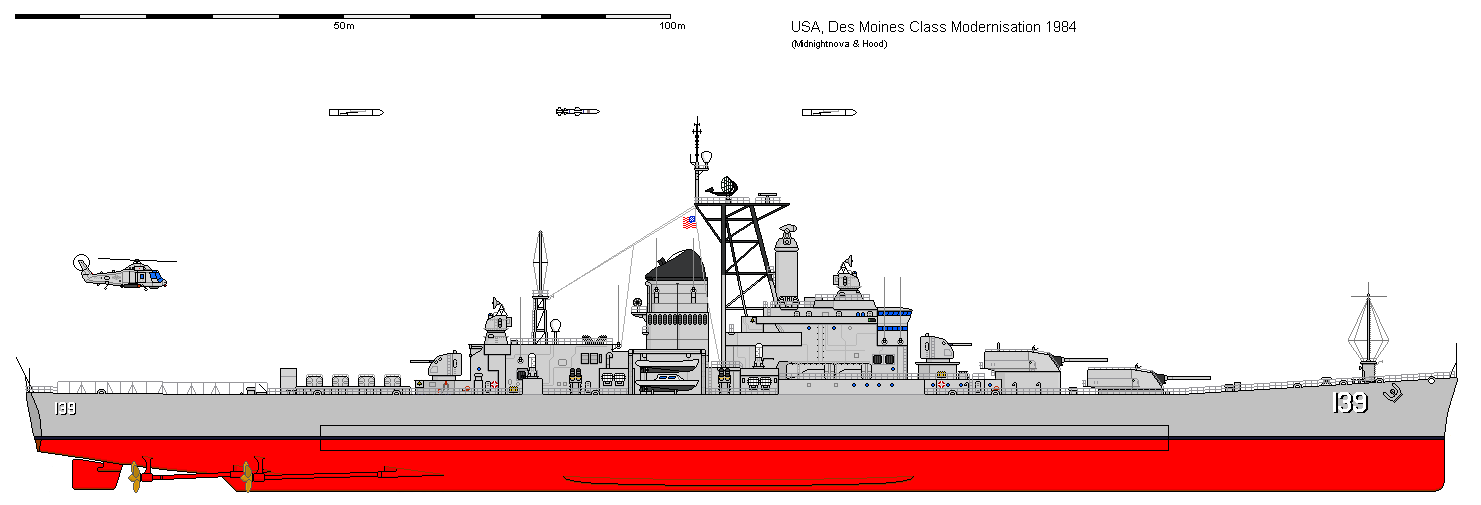

http://i29.photobucket.com/albums/c275/hangar/Shipbucket%20profiles/USACADesMoines2AU.png
He claims it was actually based off what he could find of the upgrade proposal, so I'm not entirely sure what he had on hand for that modernization.

Seems I found a solution to the leaky helo hangar problem. Apparently the Northhampton had the first ever weather proof below decks helo hangar in the stern. She was an Oregon City class CA (Baltimore hull, same as Boston) that they re-built into a command cruiser by raising the hull and main deck up one full deck, giving them more internal space and as a by-product, weather proofing the hangar! I guess raising it up by only one deck got it high enough above the water line to keep it dry.
Question though, would raising the hull up a full deck for either of our conversions cause any inherent stability problems? We're packing a lot of top weight onto our cruisers although a lot of it will be on he main deck. Would the superstructure/masts/directors need to lowered any? Should the hull be raised up with the turrets one deck and then leave everything else where it is? I don't know but I think it would be a very easy solution and would allow for more internal room for magazines, fuel, supplies, etc... not to mention sufficient maintenance room for the embarked helos.
Just a thought I had. Anyone think its feasible or otherwise?
Drawing Board:
Slipway:

I don't think it would risk the stability a lot as it would indeed "push" the ship lower in the water anyway. The high superstructure is probably the biggest problem in terms of stability, no?
Marco

This is an interesting concept. The Des Moines could see up to 2,000 tons at the O4 level before she got unstable. Especially seeing how the stern is at the weather deck, building the aft deck up it seems might not be a problem.
Finalizing the Des Moines design that involved full utilization of the elevator was going to be addressed by NAVSEA if a study was funded. It think all of our suggestions would have been fully investigated. I could only have hoped that I could have hung out as part of the team if it had gone official.
What rediculous fun that would have been.
Here's something I saw a long time ago and is still very interesting to me. The Mk16 5"/54 caliber mount from which they fired (Semi-Active Laser Guided) SALG rounds. They look pretty neat, and I would consider them a remote possibility for use on the 1980s Boston and Canberra on the basis: In the era of the 1980s, we know they could have been constructed, but the question is, would they have been if SALG rounds would have been pursued?
The guided rounds and any extra range is what I think we/I need to focus on when addressing our NSFS issue. Even if the battleships, NSFS experts, came back we would have to field laser guided rounds immediately.
So, an open question, to the knowledge of you gentlemen, how many special 5" rounds with which did we experiment on a serious level? I know of the recent ERGM, the dead-eye which is what the Mk16 is firing, the RAP round for the Mk12 5"/38s. Anything else?
File comment: Sex with fins
