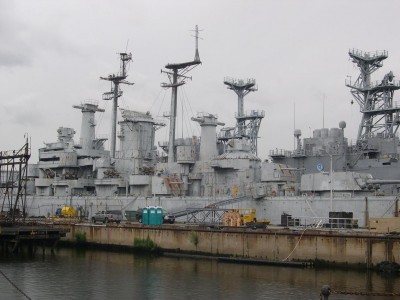

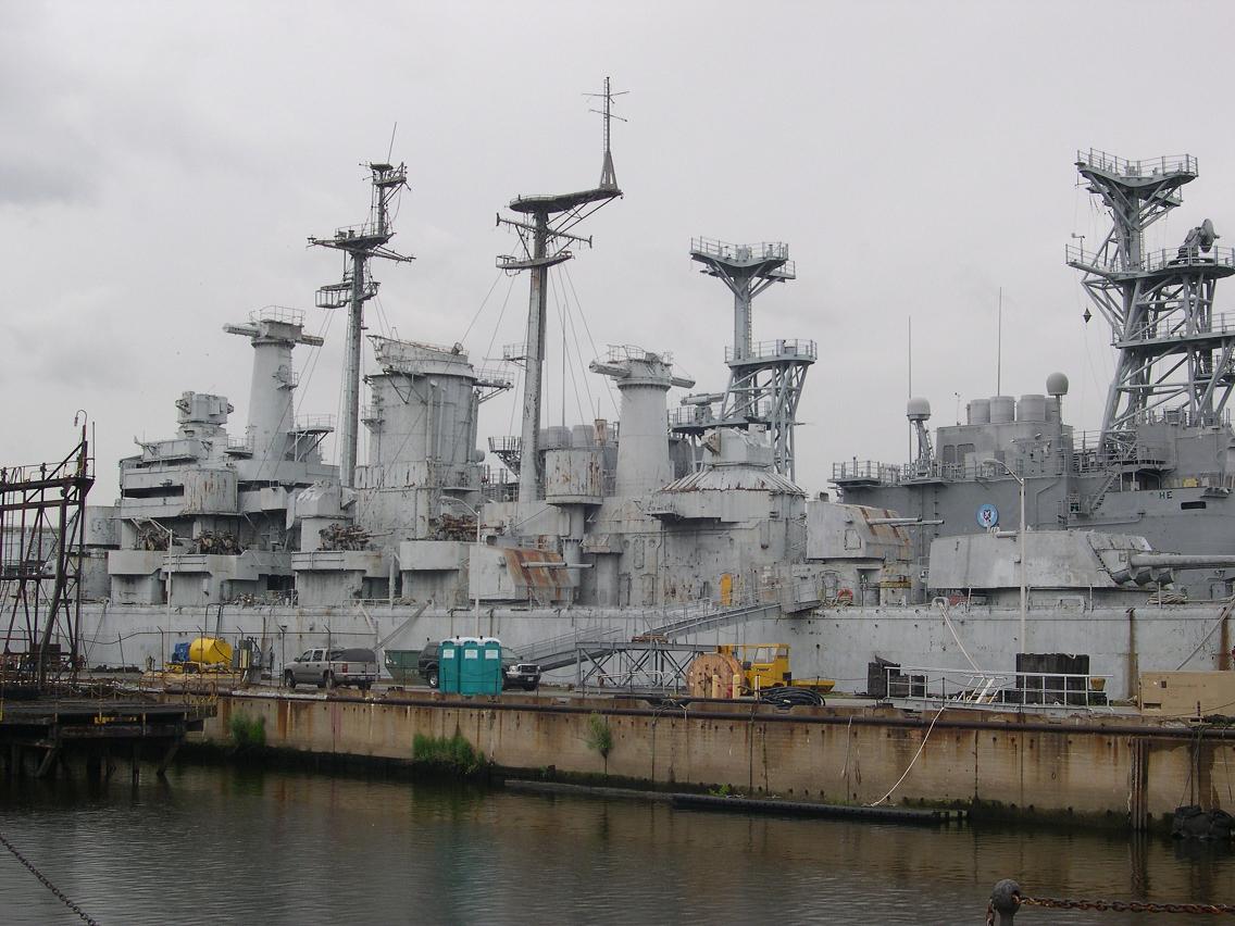

PostPosted: Fri Dec 10, 2010 6:44 am
Posts: 3127
Here is a pretty good Comparison of ship size and mast size and type. Here we have Des Moines in the foreground and a Spruance behind her. This certainly illustrates how the mast/masts could be arranged on board.
While the original masts look pretty stout they don't offer a lot of diversity or room for expansion. I liked how NAVSEA drew up the mast on the original reactivation project, but I want some originality. The forward mast unfortunately cannot be like that of the Iowas in that the legs straddle the stack, because there is an expansion joint just aft of the mast. An idea is to just reverse it to where the legs go forward. Following that I would replace the original vertical pole and construct an entirely new mast instead of trying to incorporate the original one.
So, if you're still listening, Seasick, which is good for replacement of the secondary radar? I am thinking of the secondary radar being able to track air and surface targets and be able to illuminate for the ESSMs.

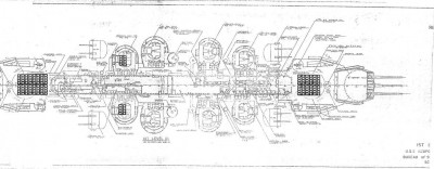

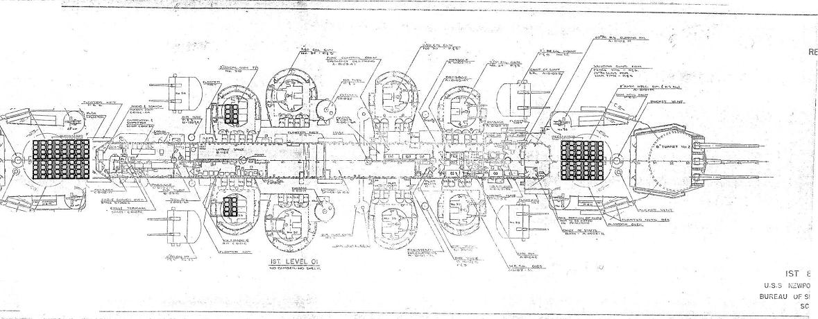

PostPosted: Fri Dec 10, 2010 11:14 am
Posts: 3127
Just in case someone forgot, this is what sex on steel looks like:
A concern with the VLS forward is that you have to worry about the tubes being a certain distance away from the bridge windows and a certain distance away from the back of the gun turret to provide enough internal volume to walk between the cells and the outermost bulkhead. There is enough room maintaining distance between the back of Turret 3 and the super structure. With this the forward VLS arrangement accommodates 48-cells, whereas there is the possibility that the aft can accommodate a full 64-cells. This enables the ship to take an entire 112 TLAMs into theater with 16-cells, or 32 ESSMs for self defense.
There will be additional structure added to the 01 Level aft structure at the base of the VLS similar to that forward. The extra internal volume would be used for UAV storage and workshop on the starboard side and a fantastic gym on the port side.
