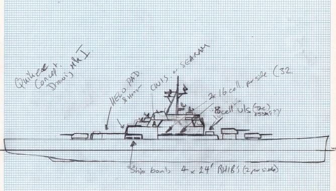

Okies here is my early concept drawing for my future 1/72 build this will be all I draw for now until my broken wrist is fully healed!! Its 2 difficult/painful 2 draw with this lump of a cast on my arm..
Please offer constructive ideas on placement of secondary weapons/sensors, etc.
Bridge design is loosely based on the Concept art Dave posted of the AEGIS conversion proposed for CGN-9 USS Long Beach.
My initial design has 32 strike length VLS per side(64 total) with a 16cell tac length VLS in place of the twin 5"turret[with ESSM's], possibly have a 5"mk45 62cal either side fwd of the VLS.
Still need 2 fit some 'poons in......
Cheers Bruce :cool_1: :cool_1:
Question: how much room/deck space is there either side of the aft turret?? What sized chopper could be squeezed past if the midships hanger is at deck level??

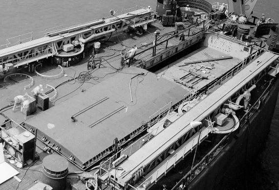

Also a huge issue is the hatch and maneuvering the helos around on the flight deck while the birds are on deck. See? It does not look too conducive to moving helos around.
This is how I have planned to make the sliding hatch usable on any below-deck hanger CL, CA, or CB, and if I were to do a new-build battleship it would also incorporate this design.
To do it justice, I am going to have to make a drawing of this, but I have a way to make it to where the reliable, water-tight, sliding hatch can still be used instead of resorting to the Virginia-class CGN design where the elevator elevates all the way. I will try to generally describe it. A flat cover would have to be fabricated over the top of the hatch so a helo could roll across it and so the elevated helicopter landing pad raised to be flush/level with each other. Like on the Iowas, the helo landing pad would have to be elevated anyway for AFFF plumbing to be installed underneath it. The top of the hatch and the raised deck would be flush and provide for a landing area that would accommodate a sliding hatch. This enables the hangar to be closed with the elevator down, and it would keep water out of the hangar.
