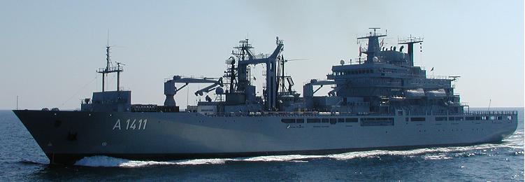

I stand by my original statement:
Quote:
...LPDs no longer have the large cranes needed to make them effective tenders for small craft. How can we support littoral/special warfare without large active heave compensated cranes in the fleet?
Commercial industry adopted articulated boom cranes with active heave compensation long ago to deal with heavy, dynamic loads at sea and do them with safety. The U.S. Navy needs 120-150 ton cranes of that design as a minimum if it wants the capability to transport and support small craft in littoral and amphibious operations.
LSD-41s (60-ton crane) are 30-years old, LSD 49s (30-ton crane) are being SLEPed, and LPD-17s have a wimpy 11-ton crane (at least it is a more modern articulated boom design).
Ergo, the newest LSDs/LPDs are cannot lift a combat loaded LCM-8 (57.8-tons light load - unladen), an M-1 Abrams tank (70-tons), or a Mark V SOC (57-tons light load). The LSD-41s are going away soon, and their 60-ton kingpost cranes are 1) marginal for dynamic at sea loads, and 2) cannot lift a ladden LCM-8 (!). LPD-17 has a whimpy 11 ton crane that cannot even lift a LAV/Stryker, a HEMTT/LVS, or even an MRAP, let alone a LCM-8!
All of these ships have to foul part/all of their flight deck to carry any boats. This is unacceptable given the emphasis an ESG places on vertical envelopment. It also makes them less than suitable for use as tenders for small craft, although they have deployed with large amounts of cargo on their flight decks for short duration relief operations (e.g. Hati). The assumption is that all operations will be vertical envelopments, supported by LCACs/LCUs.
A modern strike/fast attack craft able to operate for extended periods (days week+) in coastal/litoral waters, and to have sensors necessary to carry ASCMs is going be on the order of 35-meters or longer and displace at least 100-tons. This size vessel probably cannot be carried in a well deck, and even if it can, a major repair of a single strike craft may stop well deck operations - also unacceptable. With the LHD America giving up her well deck, and the explosion in sea lift required to support things like MRAPs, the Navy is going to have a difficult time lifting a USMC MEU.
This is why the Navy desperately needs to fit 120-150 ton (or larger) articulated boom cranes with active heave compensation to new construction amphibs. An LPD/LSD with a large crane could tranship cargo from merchant hulls to small craft to support amphibious operations, disaster relief operations, and/or support a flotilla of strike craft.
The Navy needs a modern AKA/LKA type ship that can support MEUs and serve as a tender for strike craft. A good starting point is the German Type 702 Berlin class replenishment ships, but with more subtantial cranes. Note how the Germans have taken the AOE (oiler, ammunition and supply ship) concept one step further to make her also a tender/repair ship, with hospital and cargo capabilities! And they armed them! :thumbs_up_1: What a wonderful thing to add to a carrier/expeditionary strike group. :smallsmile:

Busto963 wrote:
So, would you want this be included into a new LSD, one that replaces the current capabilities being lost by decommissioning ships and includes the heavy lift capability? Perhaps even put a gun like the AGS(L) up front so it can provide calls for fire instead of pulling in another ship? Keep in mind a naval gun like that does not consume very much internal space. Only abotu 15' would have to be added to the ship's length to provide an internal magazine with about 500 rounds of conventional ammunition.
The German replinishment ship Berlin is very interesting!

Absolutely.
The fleet is short of lift capacity, and that is based upon 2003, pre-Iraq war requirements. Since then, the Army and USMC have gone from HMMWV to MRAPs, and heavy trucks like HEMETT, LAVs, etc. have all been up armored, meaning that the actual sea lift capacity shortfall is actually far worse. Everyone assumes that all these heavy vehicles like MRAPS will all go back into storage. This is silly, IEDS are not going away, and will be a threat even in “peace keeping” missions. Ergo, our actual requirement is to carry vehicles that are often tons heavier than the unarmed base version, and our sea lift requirements are based upon unrealistic data. We are faced with the untenable options of deploying with less cargo (fewer vehicles, less ammunition/food/parts), or deploying with vehicles with less armor protection than we have established for current operations. This is totally unacceptable. I also find it ridiculous that current ships cannot pick up a combat loaded M-1 tank for transhipment from a MSC or commercial hull.
:Mad_5:
This shortfall will have to be made up using contracted merchant hulls, or MSC ships. Merchant hulls are generally reliant on container terminal cranes for offloading. Many MPS ships do not have cranes either (they also are not combat loaded, but that is another problem). In any event, when the shooting starts, you cannot have too many cranes to offload cargo.
Cranes also give the fleet an integral ability to re-arm to refit independent of ports.
Finally, large cranes let you transform a cargo ship into a tender for minesweeping, VBSS operations, antipiracy, support Special Operations, and of course, carry cargo and landing craft for amphibious operations. Think of a carrier, or amphib group that can bring Mobile Inshore Undersea Warfare Unit (MIUWU), or a fully equipped Sea Bee battalion + landing craft with it.
Look at what SOCOM is doing with the USS Ponce, and think how much more effective she would be if she could actually carry, deploy, repair, and recover an entire Special Boat Unit (with MK Vs or larger craft), or mine sweepers.
A 5” or 155mm gun might be quite useful, but I would install it with a mind to ASUW, not NGFS. The ship is after all primarily an oiler/ammunition ship, with dry and refrigerated stores capability. The only reason she should be within gun-howitzer range of shore is to transfer her cargo to troops ashore.
My thoughts are they should be armed with one or two 76mm or 57mm guns, a pair of SeaRAM, and a pair of Mk 38 25mm, or 35mm GDM008 millennium guns.
Now, you could take a “small” (10-25,000 ton) commercial hull that costs roughly $50-60 million, and turn it into a fire support ship. Commercial cargo hulls are getting faster, and commercial building standards often exceed those of their military cousins, so you are not automatically getting a cheaply built ship. If you can mount several large pedestal cranes on the hull, you can probably install gun mounts. Run with that one! :cool_2:
