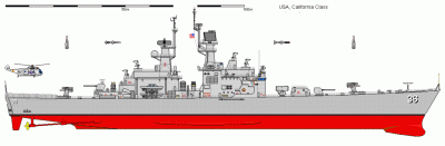

I am still new to this shipbucket program.. But found this their files..
So now am getting the picture.. good thing I left the surface navy for the medical community in the army... To much waste...
Since I have now have an idea of what to work with..
So let me summarize the suggestions to date..
Remove the forward weapons
Replace the the Forward MK-13 with a MK-71
ADD A VLS Deck and Harpoon deck.. ADD NUKLA and BUSHMASTER to area MIDSHIPS...
Then replace the AFT Structure with Hangar and VLS... Keep the aft 5" very similar to the TYCHO current config..
This Beast has a lot of potential...
If I can work out the bug with the drawing program... I will submit the rough drawings... It may end up being a cut & paste.
Thanks for great INPUT all

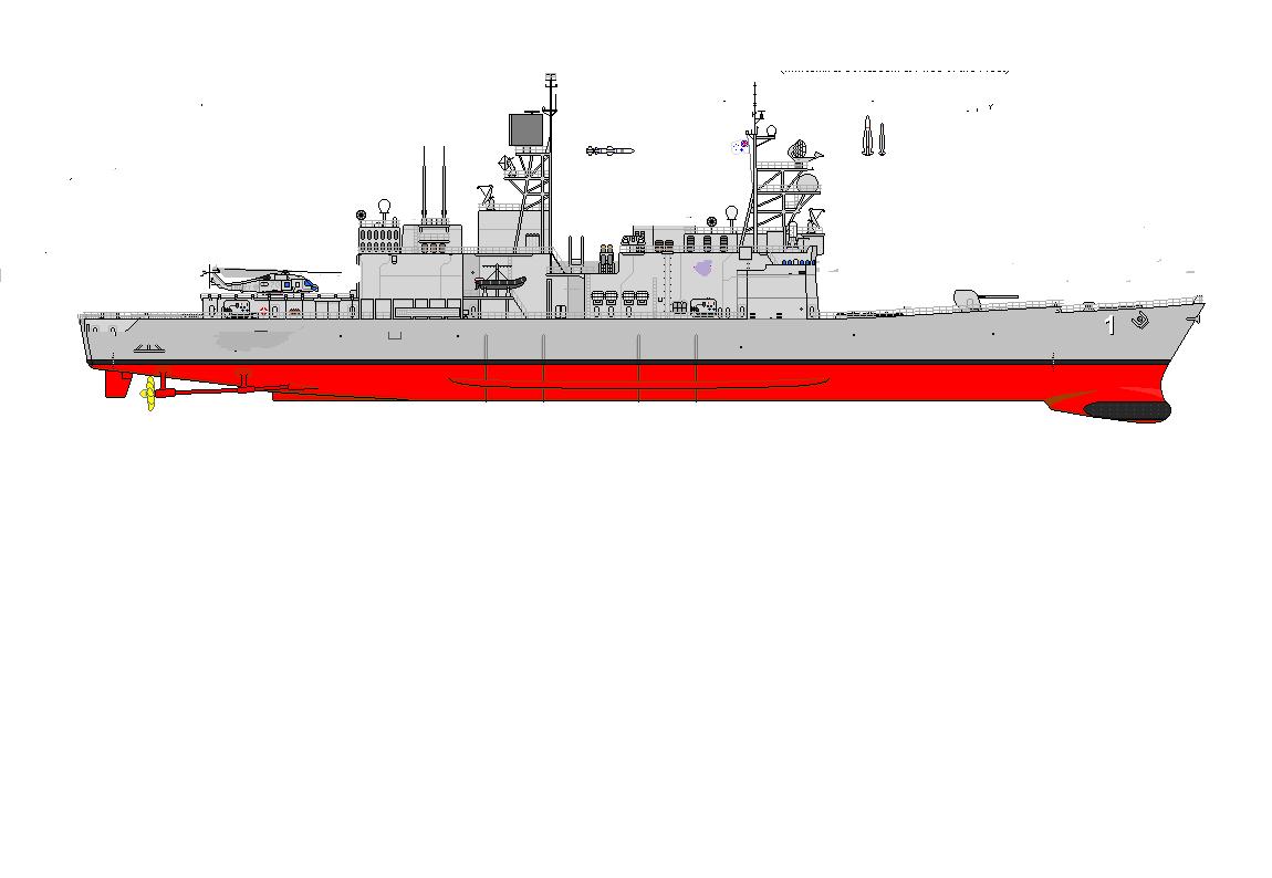

PostPosted: Tue Feb 15, 2011 10:09 pm
Joined: Sat Sep 05, 2009 8:18 pm
Posts: 182
as promised here is a rough sketch of my thoughts..
As you can see I borrowed a lot from a KIDD class DDG.. Why not use what works..
I left space aft of the flight deck.. several options could go their...
1. a large VLS module with a load equal to a burkes forward and rear cells combined..
2. Another 5" gun mount
3. Extend the Flight deck, for UAV's with a UAV housing....
But I left Space open above the O-3 level... Don't know what could go there,, maybe some more electronics... NUKLA Launchers
If the VLS option is the way to go on the stern.. Then I would replace the additional Harpoons in that space..
As I said I still a novice at this drawing thing...
One last thing is I plan on building this beast... I have the old Nichimo 1/200 DDA-164 takatsuki coming for the hull.. it measures out to be approx 76 cm which would be a little longer but more important the shape of the hull seems close enough for the cali.. as I said I have heart failure thinking of cutting up an ISW kit just to use the main deck and below..

 Post subject: Re: cgn-36 Upgrades..
PostPosted: Wed Feb 16, 2011 1:25 am
Posts: 1550
Location: Houston, Texas
The Kidd class had several uncomfortable compromises in its design. The large deck houses below the Kidd class AN/SPG-51 radars wouldn't be necessary if they hadn't just been literally stuck on to the design. If your going to rebuild the California's superstructure much of the heavy equipment could be located lower to reduce top weight. The mainmast on the Kidd class was a Spruance class mainmast strengthened to hold an AN/SPS-48C radar. The original design was for a AN/SPS-40 radar which is much lighter. The AN/SPS-48G on your California should be on top of a pyramid type mast. It should appear like the upper half of the mast on the later Nimitz class CVN for the AN/SPS-49 radars.
Seasick
PostPosted: Wed Feb 16, 2011 7:12 pm
Posts: 770
Location: Adelaide,SouthOZ
I would keep most of California's existing Superstructure if I was going to do a radical rebuild the reason being that unless a modification program (in real world) had an unlimited budget, a Superstructure rebuild wouldn't be high on the priority list. It would be Weapons, Sensors, propulsion, etc.
I would (For a radical rebuild) have fwd Mk71 in the 5"Mk45 position, Keep the Fwd Mk13 upgraded to SM2 BlockIV (if Possible), Fit a TAC length VLS in the ASROC reload house (so it doesn't stick into the reactor space) would the wt of the old ASROC reloads+magazine be equal to a VLS??loaded with VL ASROC, ESSM's, etc. And have 4 Harpoon mk141's (16 missiles) between Bridge and VLS housing.
Aft end I would cut back the superstructure and build in a Burke style hanger with Strike VLS (with SM6, and Tomahawks) between the Helo bays. Delete the aft Mk13 and move the aft mk71 to the mk13 position.
Mast's and such don't need changing as they are already designed 2 support heavy radar's.
Cheers Bruce
