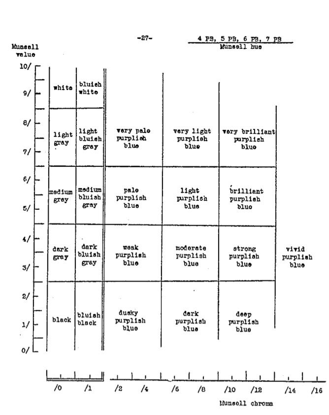

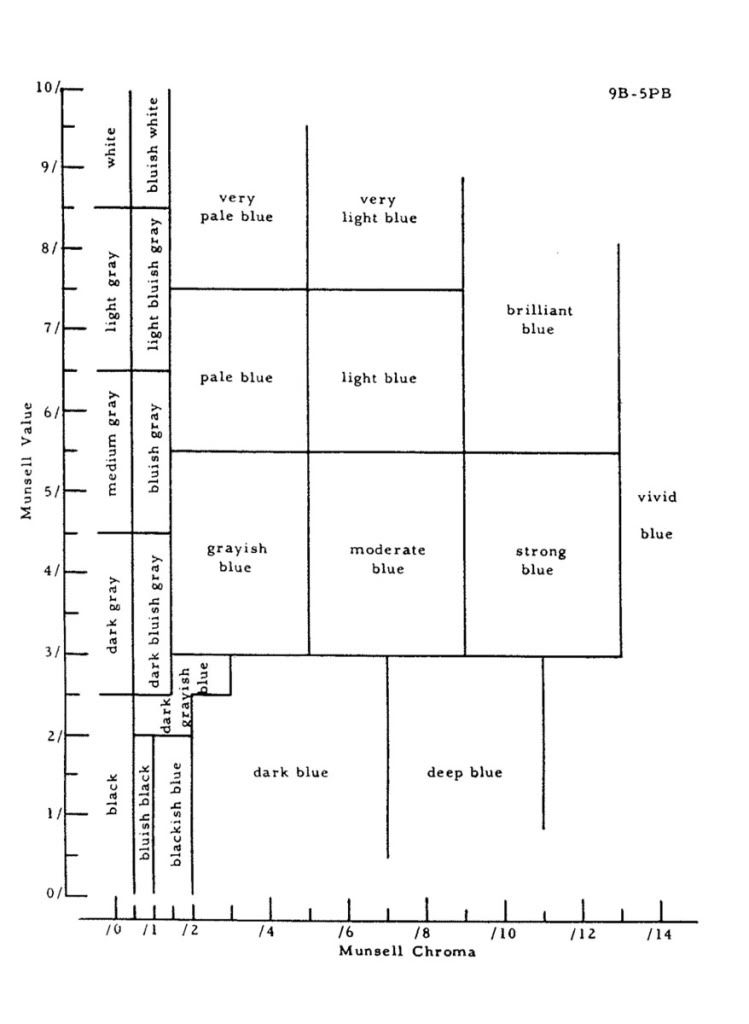

Here's a graphic some might be familiar with. Goes back to when the NBS was trying to use Munsell for naming colors.

Going back to old Munsell now, I found a chart dated 1939 & it was prepared by the NBS & published in Research Report 1239.* Recalling the chroma in the Munsell notation was /0.8, you can see it falls in the 'Dark Bluish Gray' box'. Not by a lot mind you...see that the range is from 0.5 to 1.5, so it's not the poster child for the dark bluish gray color, but there was probably just enough blue to know it's there.
I'm sure this was intentional, and it's the same kind of thing that causes a lot of arguments in the olive drab world too. By making these grayish colors borderline chromatic, the designers were creating a color the behaved differently under different lighting conditions, direct sun vs. overcast for example.
Just one more thing, the units of error for Munsell at this portion of the spectrum are Hue:1.25 , Value: 0.1 , Chroma: 0.15
So Value is the most sensitive attribute, followed by chroma, and hue much less so.
*the chart I posted yesterday corresponds to modern Munsellese
