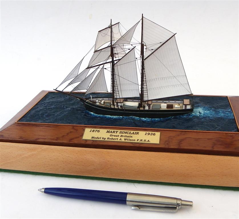

They make small, but very attractive models. Here is Mary Sinclair that I completed on Wednesday morning. Scale 20'=1" This is my 3rd polystyrene sea and I am finding it far superior to plasticine.
Bob
File comment: Mary Sinclair 20'=1"

Really beautiful once again Bob.
You're right; the sea is so much better than your previous plasticine seas, and I really admired them too.
I have tried this method of sea for my Glenmoor, but somehow it doesn't look 'real'.
Is there any way you can do a photo tutorial for the sea, or perhaps include it into your next instruction CD?

Thanks. I have replied via e-mail. I was actually started on the polystyrene seas here on Model Warships in the Hints & Tips section. The main change I made to the suggested methods was to shape the sea with a gas blowtorch with the air intake turned off so the flame was more like a candle flame. I am not planning another instructional CDs in the near future. Having done one for sail & one for steam/motor, there is nothing much more to add at the moment.
Incidentally, I only noticed the blue spot in the wake of Mary Sinclair after I took the above photograph. It has since been corrected with a bit of white paint!

Thanks, I never relly gave it a thought because my wife paints the seas! I see your point though and can therfore correct the matter on the next one. I suppose I have spent too long sailing in ships with propellers :smallsmile:

I just followed the technique described in the Hints & Tips section here. The only thing I did differently was forming the surface of the sea with a small gas torch. I turned the air intake off so the flame was like a candle flame. The polystyrene sank in very quickly even with just a light brushing of the flame.

Ah, OK. It the technique for sculpting styrofoam. I thought you used some polystyrene putty.
Actually, I used in principle the same technique for sculpting rocks on a model railway layout some 40+ years ago. The shapes were created using a soldering iron with a Teflon-coated styrofoam-cutting tip and whole covered in plaster afterwards.
Thinking about it: I just acquired from a Chinese source (48 € including shipping) an electrical hot-air soldering torch. The temperature can be controlled between about 70°C and 450°C, the airflow can be regulated and it has various nozzles from 3 mm to 10 mm diameter. Such a device should give much better control over the process than a blow-torch.

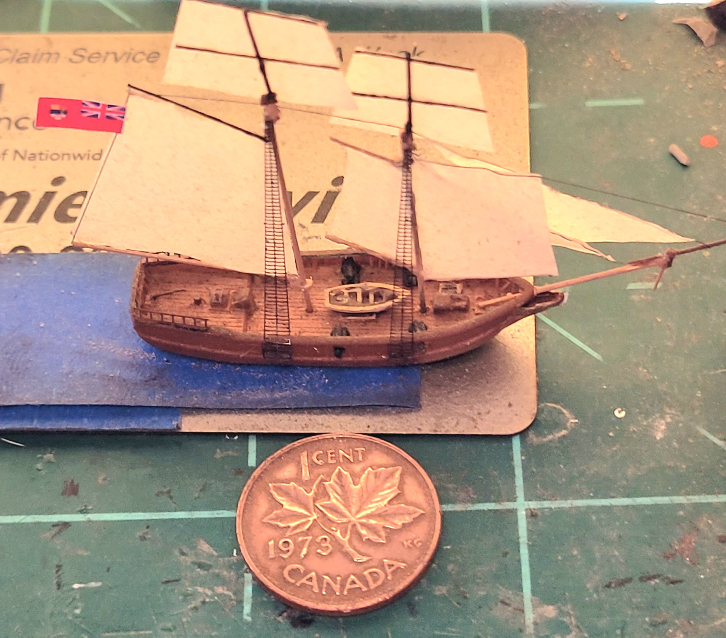

Barrett's Privateers 1/700 Antelope sloop, sporting her topsail. She's a fictitious ship, so no references apply. Do what you want! Her cannon are 9-pound 3D printed guns, rather than the "cracked 4-pounders that make an awful din" in the song. She is neither "scummy" nor "sickening". 10 gunports are molded into her hull. She carries 4 cannon for the box art photo. She's won several contest awards as a stand alone Sloop model.

War of 1812 1/700 Canadian topsail schooner Nancy.
Switching from invisible thread to Uschi .005 rigging line added to the scale authenticity of the model ship, I think.
See the little white figurehead of the owner's daughter, Nancy on the point of the bow? Nancy's guns are also inaccurate. She carried 6-pounders during the war. These are the 1/700 9-pound 3d printed cannon again, like the Antelope's.
P/E ratlines and guns will be included in the kit.
