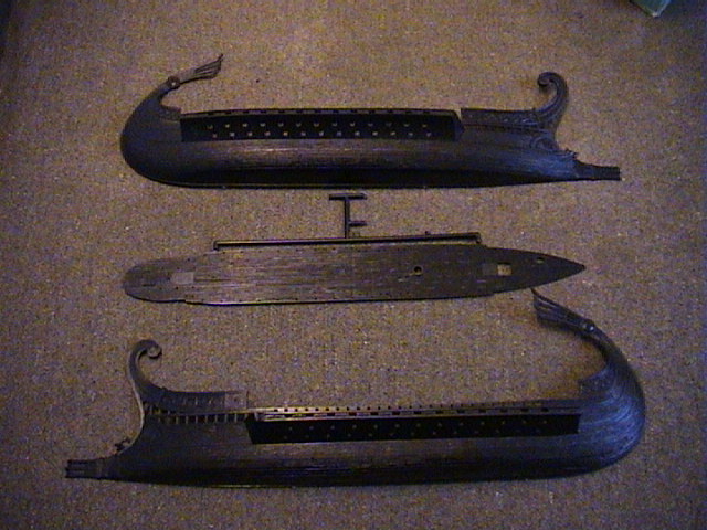

Heller Bireme Imperator 1/72
Below Heller's Bireme in a fairly old box (nice box top design). What is already obvious is that there is some issue with the hull.

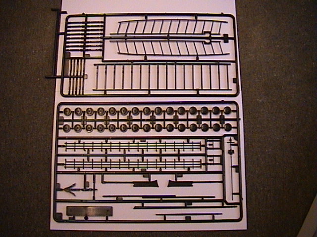

Which becomes more obvious here - the hull is too short, lacking a number of oars on each side. That makes it necessary to lengthen the hull a bit.

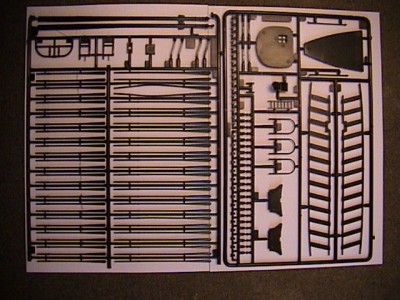

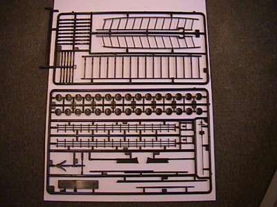

Smaller bits and pieces.
More smaller bits and pieces.

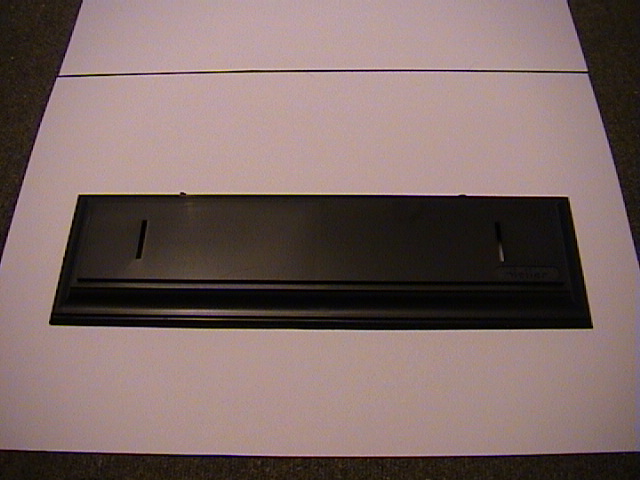

A largeish chunk of plastic that could turn into a nice stand.

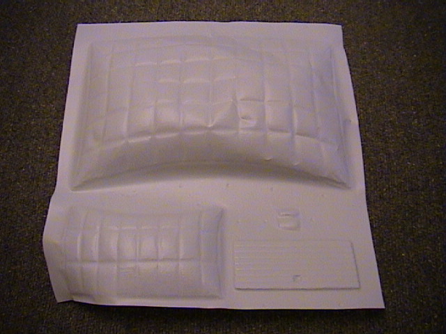

Vacuformed sails - certainly not to everybody's liking.

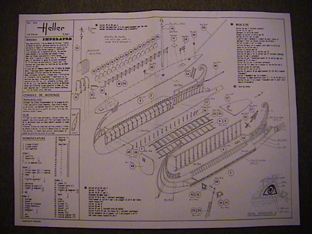

Instructions.
So what do we have here? As a kit it's a nice one, well-engineered and with good detail. But is it accurate?
In all honesty, that is very difficult to say. The box top claim is not exactly specific - probably a ship from Roman imperial times, which happened to span half a millenium. Unfortunately little is known with any precision about Roman ship types from that period. The kit's smaller details (bow decoration etc) are based on sarcophagi, reliefs and other iconographic evidence from the early empire; hull shape, oarage and other major construction elements however are largely unknown.
Personally I believe that it is possible to build a plausible, generic 1st c. AD bireme from the kit (if one does the hull lengthening bit that is).
