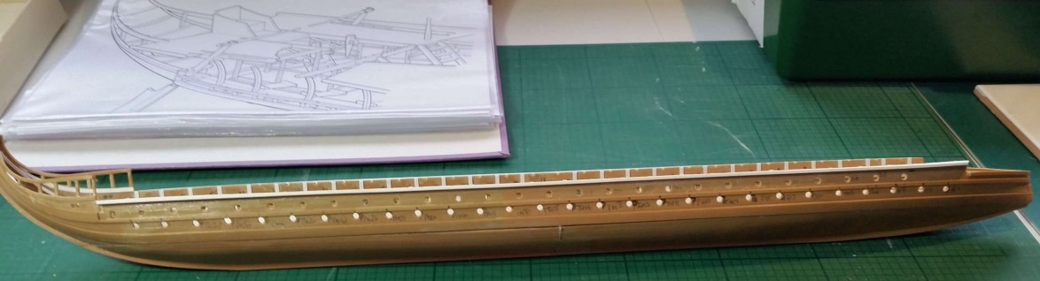

Apologies for bringing this thread back to life, let me know if I should go elsewhere, please. I am in the middle of creating a Greek Trireme using two Zvezda kits. As noted by previous posters the kit isn't accurate for what it is purported to be, so I did some research and extrapolation using Conway's The Age of the Galley, Welsh's Building the Trireme, Morrison's and Wilsons' Greek and Roman Oared Warships 399-30 B.C. and some information from the Trireme Trust website.
I came to 2 conclusions: 1) As kitted the Zvezda Greek Trireme would be well on its way to being a Trihemiola, and would only need a bit of work; 2) With some (a lot of) work, one could create the basis of a "proper" Trireme from the Zvezda Greek Trireme by using two hulls.
What I've done is create a 1/72 scale plan using the Coates outlines from the Trireme Trust website and various books, and then cut up two Zvezda hulls to give me the basic hull. I've attached some pictures ... let me know if anyone is interested and I'll add some more.
File comment: The plan (2 x A3) overlapped
File comment: Showing the kit, just cut, and then cut down, with the new Thalamian oar ports drilled
File comment: Showing where I've created some plank seams and wood texture where the kit didn't have it
File comment: Adding some framing detail
PostPosted: Tue Dec 27, 2016 9:51 pm
Joined: Fri Dec 18, 2015 11:33 pm
Posts: 122
Interested in how you'll splice those hull halves.

PostPosted: Wed Dec 28, 2016 6:17 am
Thanks for that link, hadn't seen those before. I'm still in a quandary whether to crew it or have it empty. I've already got six boxes of these ...http://www.plasticsoldierreview.com/review.aspx?id=288, although the Shapeways ones might be better (easier material to clean up), although I'd need to remove their ankle fetters, however I'd need 170 of them which would get expensive ...!
The hull has gone together well (superglued butt joints), but because of the way I cut the hull sections, the joins aren't all in the same place. I'll get some more pictures today.
