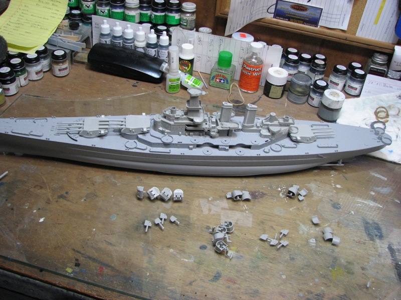

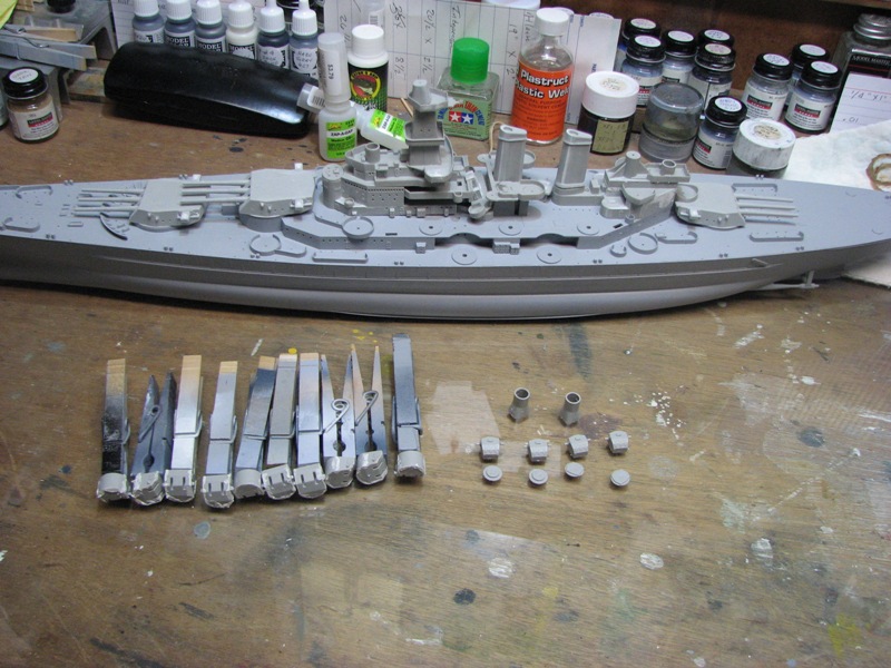

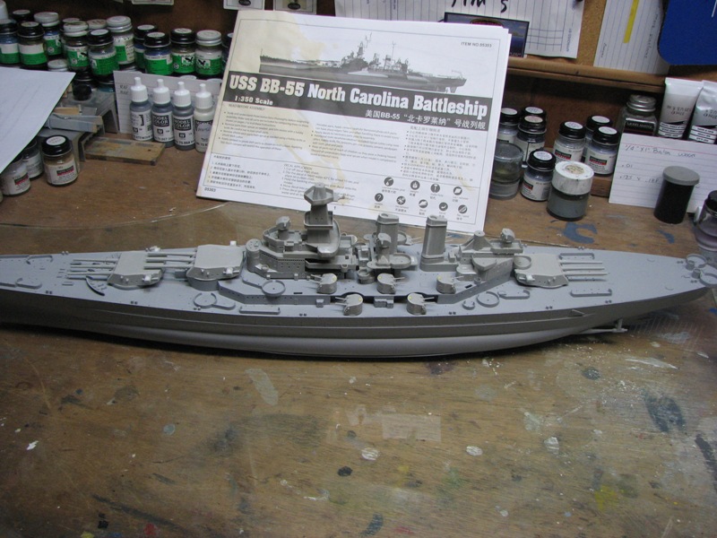

Last night I finished making the 5" guns and filling the cracks with putty. Tonight I hope to sand the putty smooth and then start on the 20mm guns.
All the while this building was taking place, I was thinking " man I sure wish the parts fit together better than they do".

File comment: After 5 hours of working on the "Show Boat" or should I say the "Putty Queen" this is how she looks.

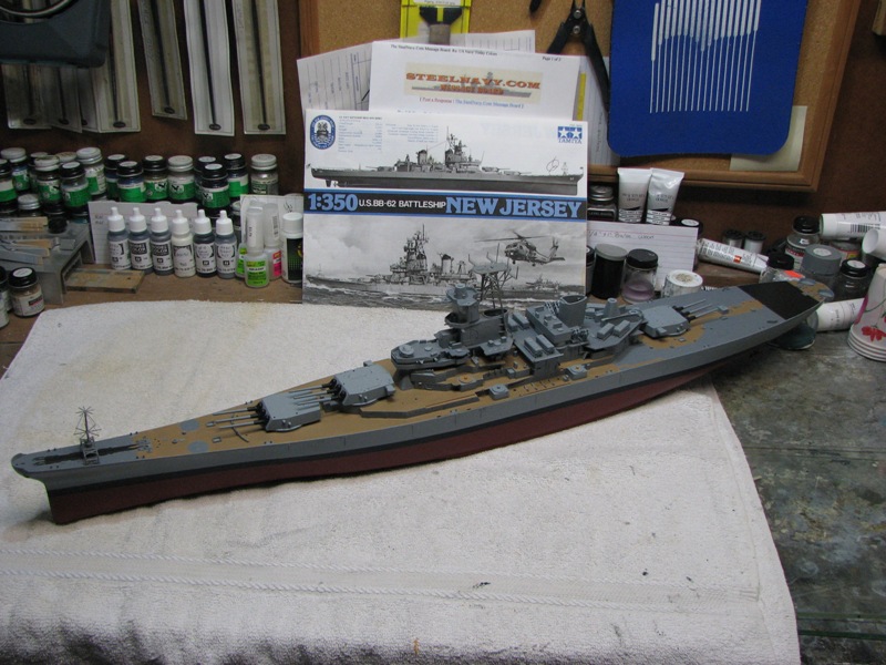

Unless someone says "no", while I', waiting for my GMM PE set for the North Carolina, I'm going to add another rescued ship from the "shelf of doom"to the GB. I bought this kit back in 2004 and worked on it in both 2004 and 2005 before putting it on the back shelf. I took it off the shelf this last week and brushed painted the decks, built the 5" guns, added the 16" barrels to the turrets and started working in the ships radars.
Tamiya's Moden New Jersey.
Group Builds are a great way for me to get rid (finish) models that I have lost intrest in.

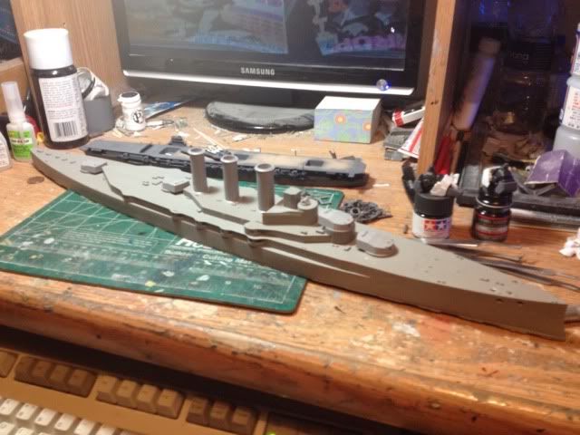

This gives me an excuse to start the combrig HMS Tiger
Mine is a waterline version. I'm attempting to finish this within the group build time frame, there are hardly any parts in the kit. I'm going to ignore the two main accuracy issues and just order a set of brass masts to ensure strong rigging and proper fitment. I have a few reference books that'll help superdetail. I don't like that railing wasn't included so I had to buy WEM rails, but everything else seems to be there.

Is it just the camera angle, or is HMS Tiger extra long compared to most battleships?
Dan.
PostPosted: Tue May 07, 2013 9:11 am
Posts: 1157
Dan.
It is pretty long, compared to it's contemporaries. the ship is 214.6m, the North Carolina class is 222m. They're very close in size

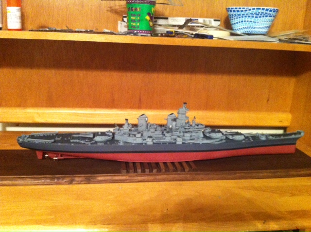

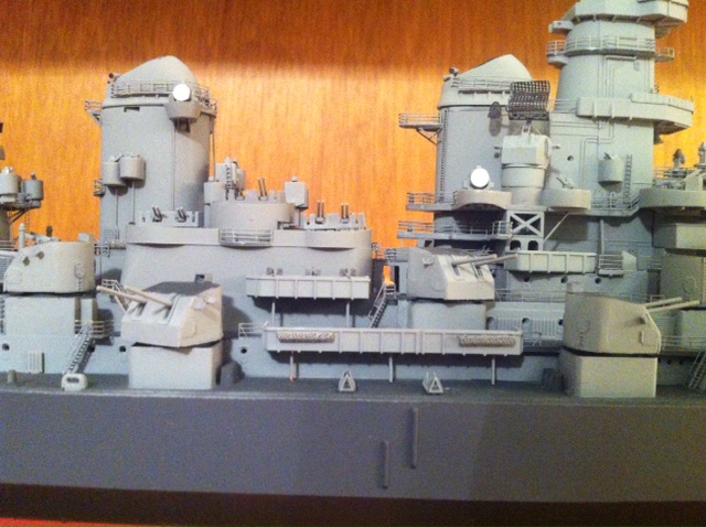

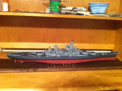

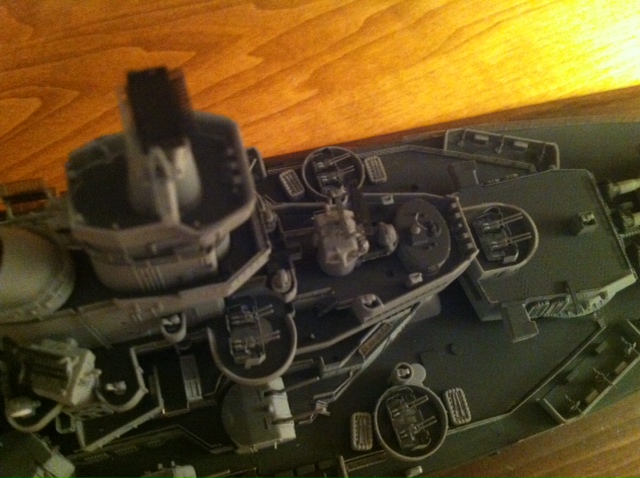

Here is my USS Missouri, it should be done soon. PE is from Eduard, paints are White Ensign

Your New Jersey is looking nice. What PE are you using? Any chance of a closer look at your bow antenna area? It looks nice.

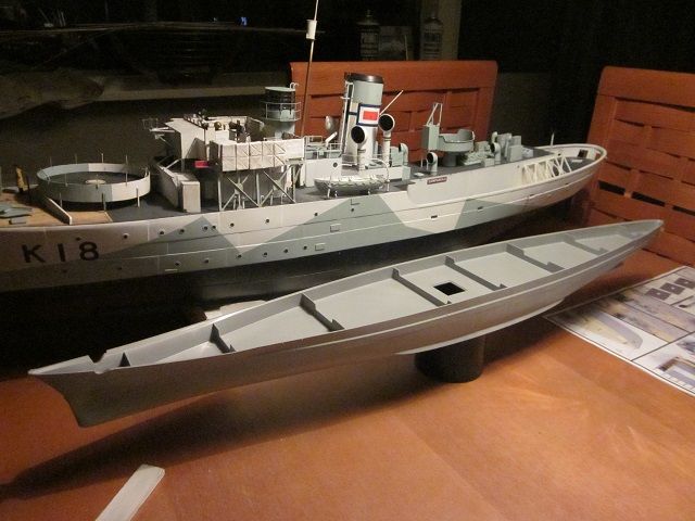

Behold my scale culture shock....
Oh my...
This gonna be tough for me :pout:

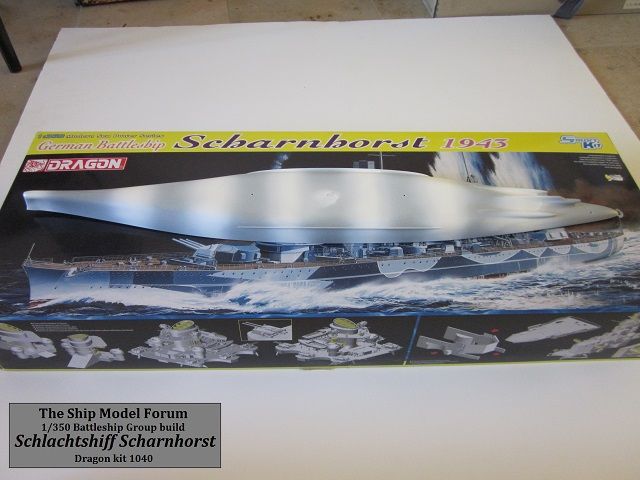

And so I started...

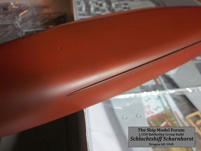

...and so I came to a squeaking halt when I noticed the lower hull has sink marks where the bulkheads are :lol_pound:
I'll try to fix that with a few layers of basecoat and sand the whole thing smooth when dry.
The lower and upper hull fit very nicely, but it's not perfect. The provided wedge is helpful, but it's not enough, so I made an extra bulkhead near the bow. Seems to do the job.

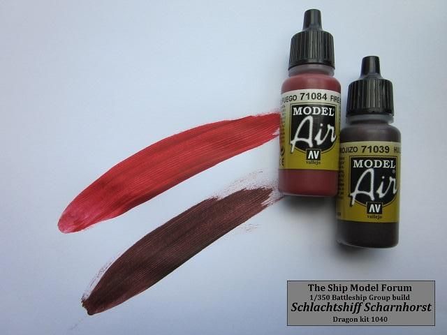

I'll use the Vallejo Air Hull Red, looks very brown I think, but I read the German hull red was more brown, so it's okey I hope.
Will highlight a bit with the Fire Red.
Okey, I'm off to sand the hull now.
Edit:
done...
I more or less expected a shake n bake kit, but...nope.
Another Edit:
Uhmm...let's call it "Cuban Cigar Brown" :big_grin:

I've been wanting to try that brand of paint but can only get it through mail order so I haven't done it yet. Is it premixed for air brushing? Is it enamel or acrylic?
Dan.
PostPosted: Thu May 09, 2013 9:51 am
Joined: Wed Apr 03, 2013 7:05 pm
Posts: 235
Location: Netherlands
Hi Dan,
All Vallejo paints are acrylics, the "Air" series is indeed ready to airbrush, but I still use some extra airbrush thinner.
The "normal" range is great to airbrush with also, just more thinner.
The downsides of acrylics...not as tough as enamel paint and it often needs several (thin) layers for a good result.
I still prefer acrylics, because I can airbrush indoors without my brains melting...not even smelly. Because of the size of the 1/72 scale Flower Class corvette I'm building...my shipyard is the dining table. My wife can watch tv a few metres away from me and she never complained about me airbrushing. Acrylics dry quickly, so I hardly ever watch paint dry. I clean my brushes with water, airbrush with an ultrasonic airbrush cleaner.
