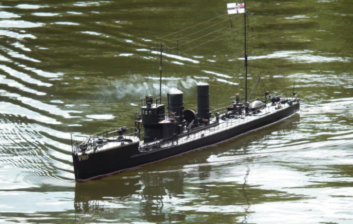

Re: 1/48 German Torpedo boat V105 (1914)
Sandy
Many thanks for taking and posting this great photo of HMS Velox at Glasgow. It was good to meet you eventually.
I would start a "1/48th HMS Velox Scratch build" topic, but the model is now three years old and my photographic record of the build was not very detailed. It would not be as interesting to look at/read as this V105 build and there would be huge gaps in the construction process which would just confuse people.
Your picture does not convey how windy it actually was. I saw the harbour jetty in the picture break free from it's moorings three times and turn into a big navigational hazard!

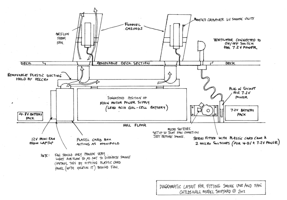

Hi all

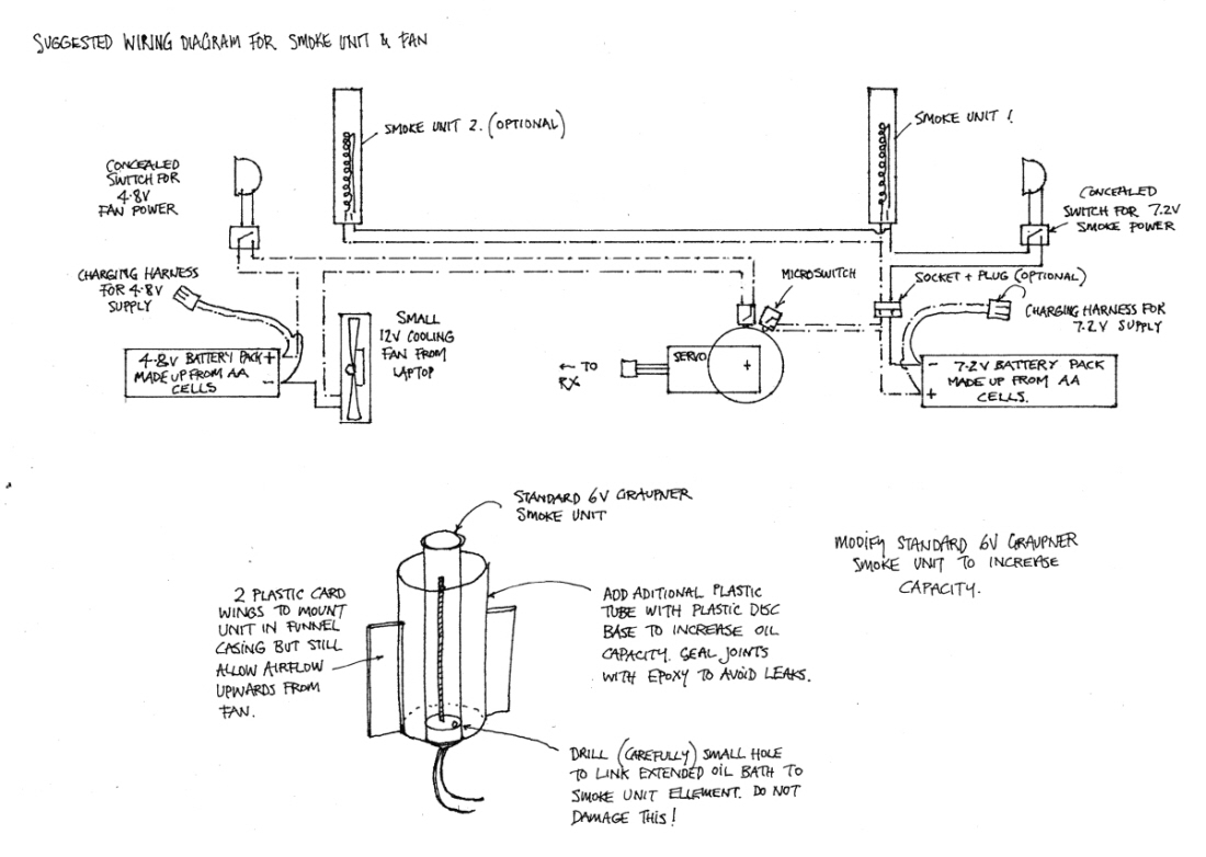

Although the majority of the deck detail and painting is completed at this stage I still had not completely finished installing the smoke units.
Getting the model to produce a reasonable amount of smoke on the water was all part of bringing the model to life. I had gained some experience in this area when building HMS Velox.
There is insufficient space or buoyancy in the model to install one of the water vapour units so I used the Graupner 6V smoke units, fitting one in each funnel casing.
A small fan is essential to very gently push the smoke out. I made my own fan unit initially but it was amazingly noisy so I replaced it with a 12V laptop cooling fan. This is powered by its own 4.8V supply, and the slight draft from the fan is ducted via 20mm plastic conduit to the funnel bases.
The 6V smoke units work well on 7.2V (producing more smoke) but this will probably invalidate any warranty and I cannot accept any responsibility if you go down this road and burn your model to the waterline! Always use the Graupner smoke oil as anything with a lower flashpoint is dangerous. Bench test everything thoroughly before installing it. Having said all this the smoke units, and there are three in HMS Velox, have been working faultlessly on 7.2V for several years.
Everyone who sees the model sail usually comments at some point on how effective the smoke is, and I have shown the installation diagrams for this equipment for those interested.

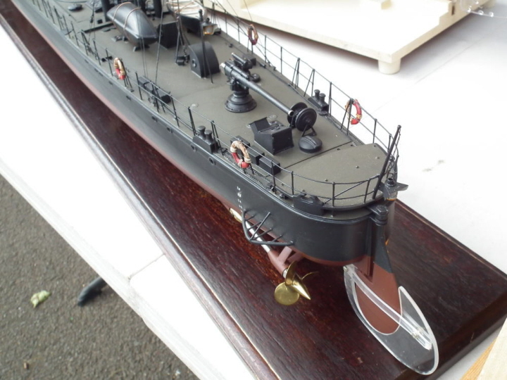

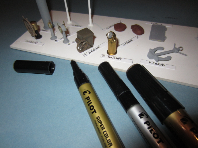

Hi all
Well this build is rapidly reaching its conclusion.

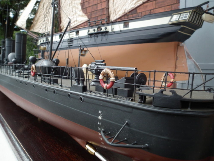

After the vessel ID number and the draft markings had been added (both self adhesive from BECC) the model was de-dusted and carefully sprayed with dilute polyurethane matt finish varnish. This pulls all the different paint finishes together and makes everything water resistant.
There is very little in the way of �Fancy bits� on these vessels, they were very functional, but I figured the crew would keep the compass binnacle polished, along with the telegraphs and possibly the searchlight bezel.
I have discovered these wonderful, spirit based, gold marker pens made by �Pilot�. They come in three nib sizes and I used one to give the brass colour to these fittings. The gold colour is bright and stays bright as long as you do not varnish over it. They are fantastic for adding gold lines to a model. The silver version is good too.
In my next and concluding post to this build I shall include some more pictures of the completed model both on and off the water.

- PICKETBOAT
- Posts: 474
- Joined: Wed Jul 21, 2010 2:44 am
- Location: Dumfries, Scotland
I forgot to say I also found if you depress the nib (on the larger nib pens) a few times it squirts out a little pool of bright gold. If you do this onto a non absorbent surface, it can then be brush applied to tiny components. Cellulose thinner can be used if the solvent content starts to evaporate off and the gold gets a bit sticky, and for cleaning the pen nibs.
The pens are not that expensive and if you don't like the end result they are quite good for signing Christmas cards!

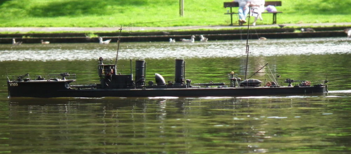

Hi all

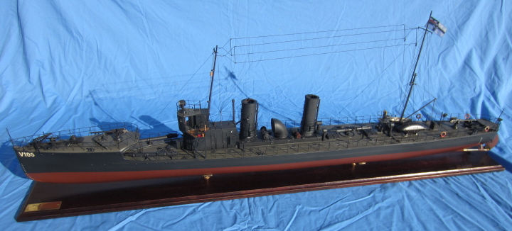

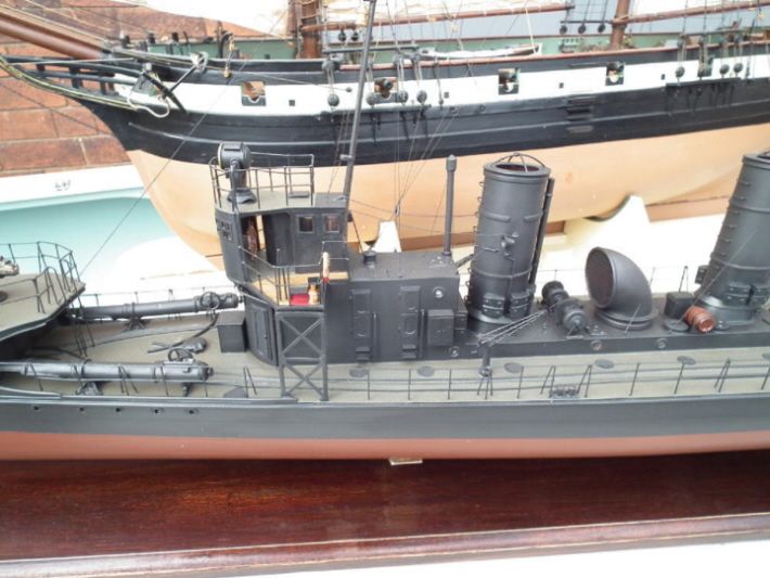

Well that just about completes this build. I have attached more pictures of the finished model together with some taken by �marine mole� at a GRMBC model boat event in Glasgow. Here the model was seen by many for the first time, and it was where some of the best "on the water" pictures were taken. Many thanks to "marine mole" for these.
From a model making point I have enjoyed this (my first) on line build a lot, and have appreciated the interest shown and encouraging comments from watchers. If anyone wants close up pictures of particular deck detail to help with their own V105 to V108 build (in what ever scale), please contact me and I will try and help. I would also like to thank the other contributors to this forum who helped such a lot with my initial research for the model.
The next scratch build, (1/48th scale Russian Kazarski class torpedo gun boat of 1890), is under way and I will start an on line build for this too, as soon as I have made a little headway and sorted out the pictures. I will probably start this when I have taken the first GRP hull out of the mould as the lead up to that point is an identical re run of the plug and mould construction for this model and as such I would be repeating myself.
Happy modelling out there.

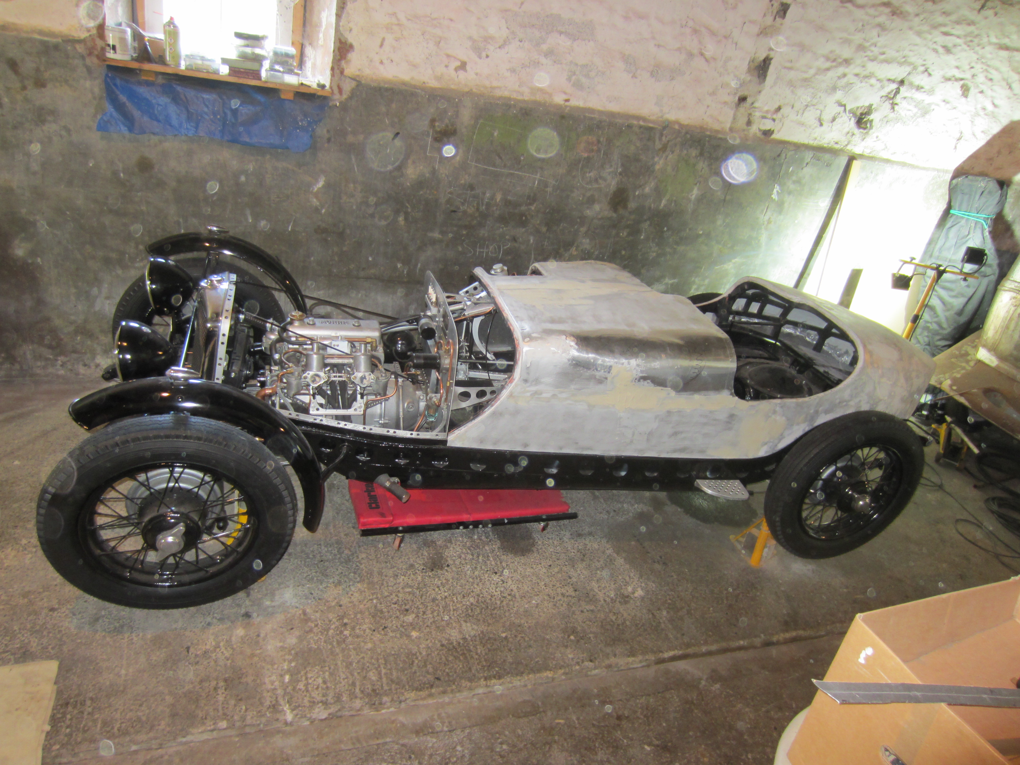

All the models designed and constructed by Chylds Hall Model Shipwright have now passed to Adam Slater at Mountfleet Models and all enquiries regarding models, hulls, plans and fittings should be directed to him.
Thanks to all the modellers on this forum who provided very helpful input during these model builds.
I had great fun building them but have now moved on to building 1930's cars at a scale of 1 to 1.
