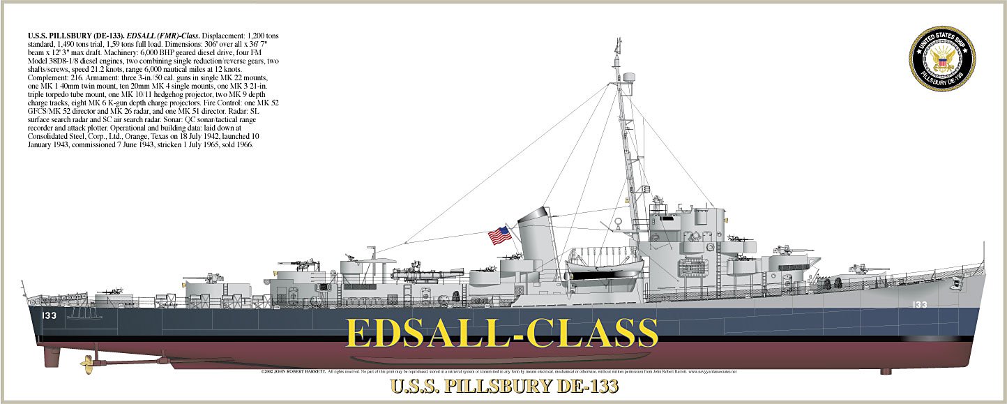

File comment: Nice profile drawing of the DE.

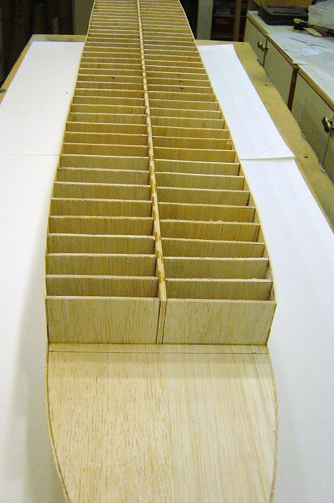

File comment: Forward section of the CVE from stb side. Note the large number of hull formers, 51 on each side. I did this in an effort to keep the shape more uniform. Seems to be working well. Forecastle deck is 1/8" balsa. Hull sheeting rough at this stage, will get much better with the second layer.

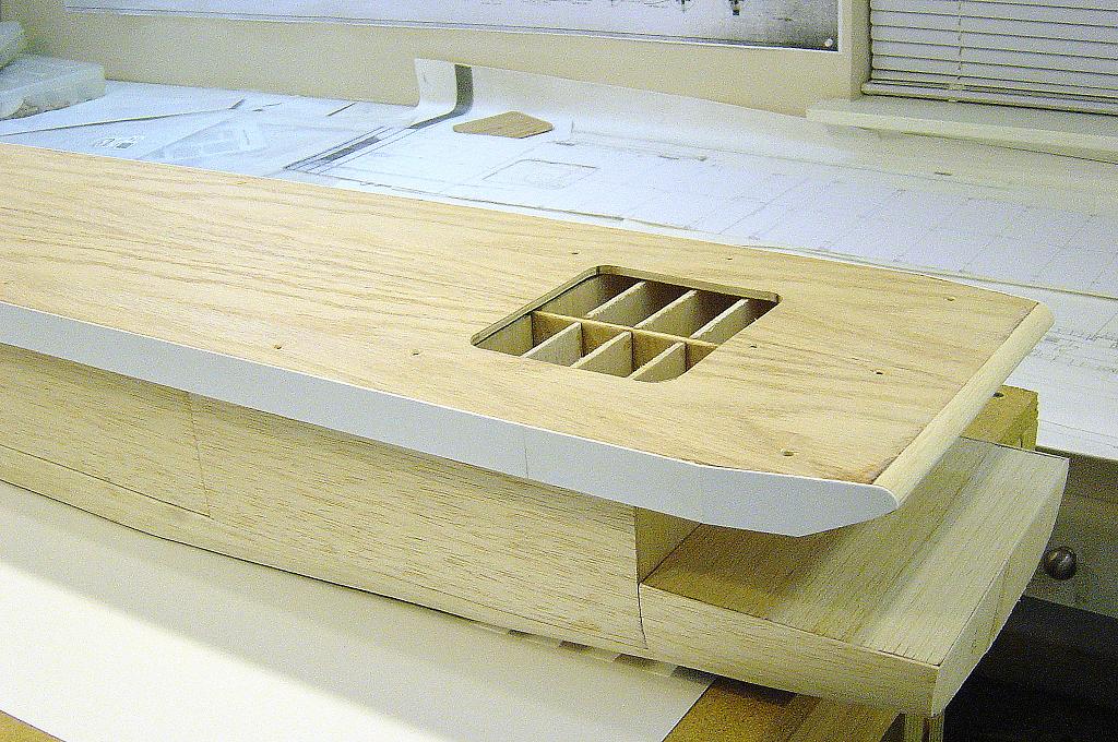

File comment: Portside view showing the flightdeck rough-in. Flightdeck is 3/16" plywood. Sides of gallery deck are .040 styrene, with 3/16' plywood behind to stiffen the structure. Note the elevator locations.

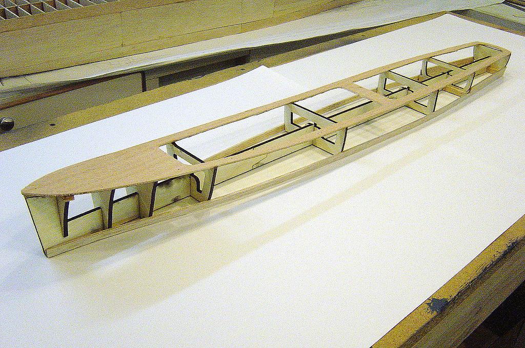

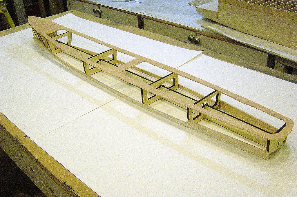

File comment: View of the framework for Pillsbury. In an effort to save some time, I decided to purchase a DE in semi kit form from BAD shipmodels. I regret that I did. I usually don't do any sort of reviews on other peoples "stuff". But I was rather dissapointed with this so called "kit". For the time it will take me to make things right, just with the hull, I should have built it myself. I will do the rest of the ship scratchbuilt, as the rest of the "kit" is junk. Just goes to show you, trust your OWN abilities. I will not make the mistake again. I will not say anymore on this.
File comment: Another view of the hull framework for the DE. About the only thing thats close to being correct. I'll fix it , in any event. Guess I'm getting too picky in my age......

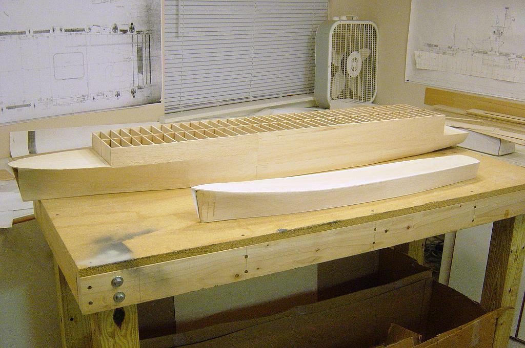

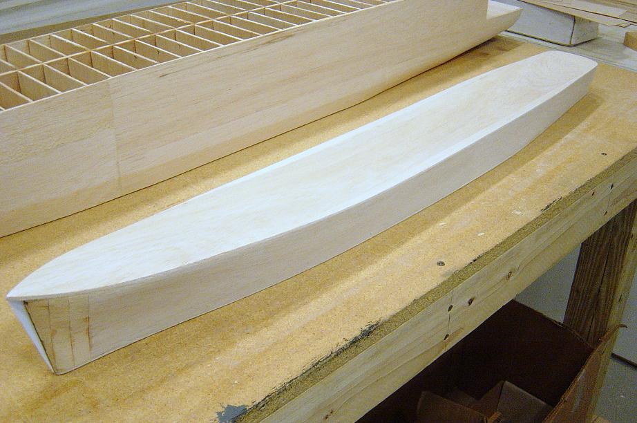

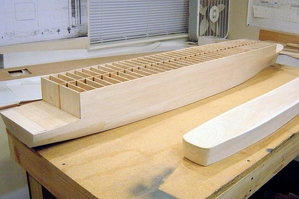

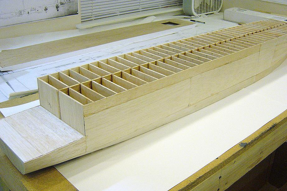

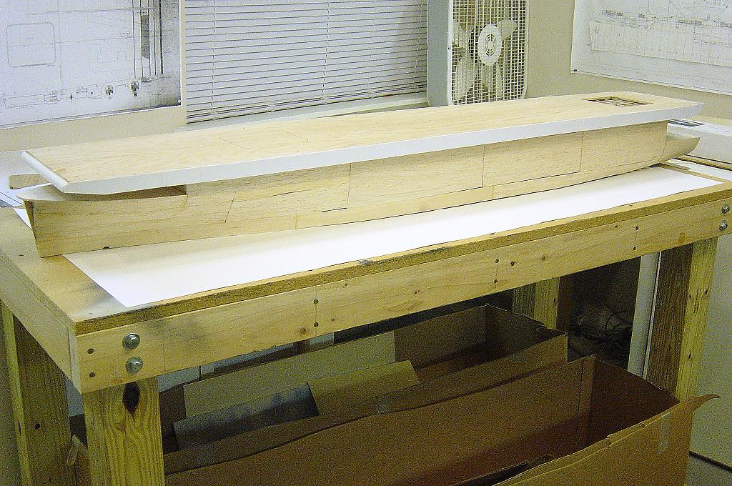

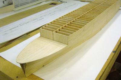

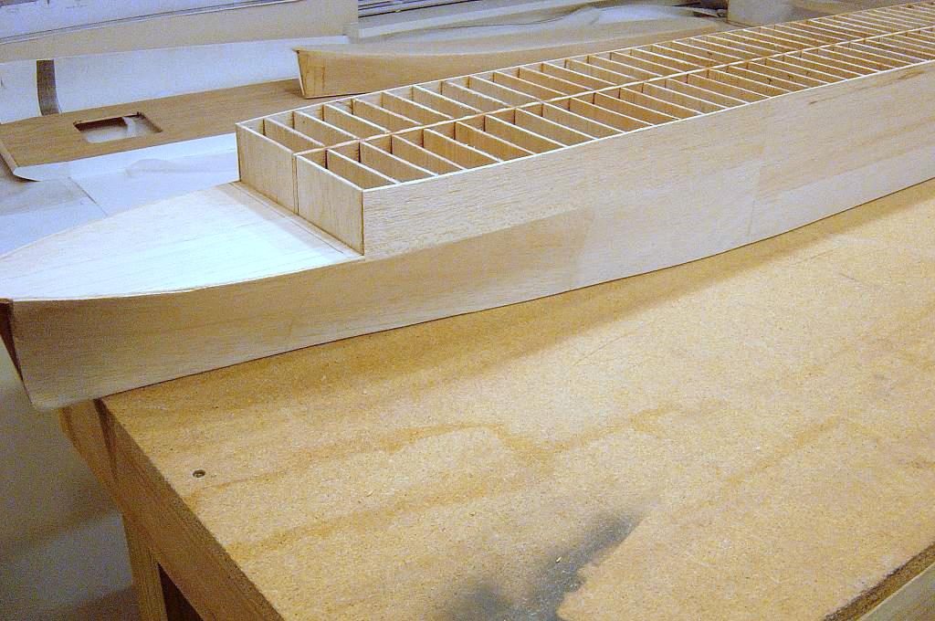

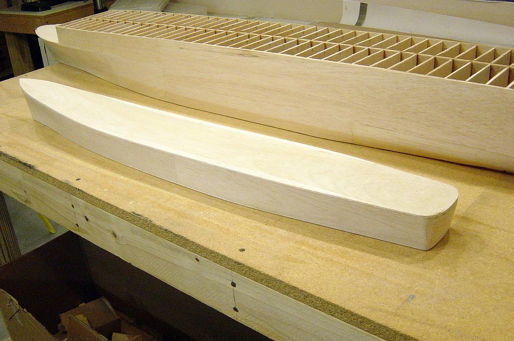

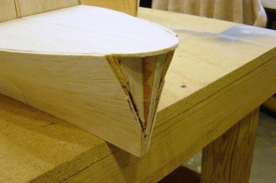

Hello again all :wave_1: Moving along on the project, I have now finished sheeting off the Carrier, and covered the DE framework. Lets take a look......
File comment: Portside bow view of the CVE. Note that the second layer of 1/16" sheeting really smooths things out. I'm able to make the joints alot tighter, too.

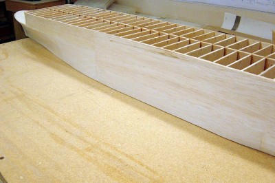

File comment: Portside stern view here. By using large sections of the sheeting, I can cover alot of area realativly quickly. Contact cement used here.

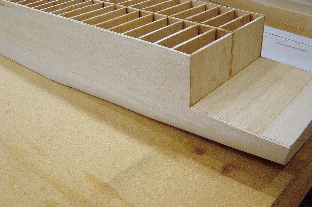

File comment: Midships, portside. Again note the tight joints between the sheets. This second layer also adds rigidity.

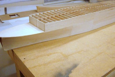

File comment: Port view of the DE. Covering this was a little different. Since the spacing on the hull sections was much greater than the CVE, I planked this first with 1/16" x 3/8" balsa strips. Then the second layer was added using the sheet goods. Deck is 1/8" hard balsa. Stern is rough shaped balsa block.
File comment: Portside fwd. of the DE-133. Note as I get closer to the very front of the bow, I reduce the sheeting size so the wood will bend easier without splitting.
File comment: Overall view portside of both hulls. The table is 25" wide. In the display when completed, the ships will be about 36" apart, center to center, to give more room for water effects.

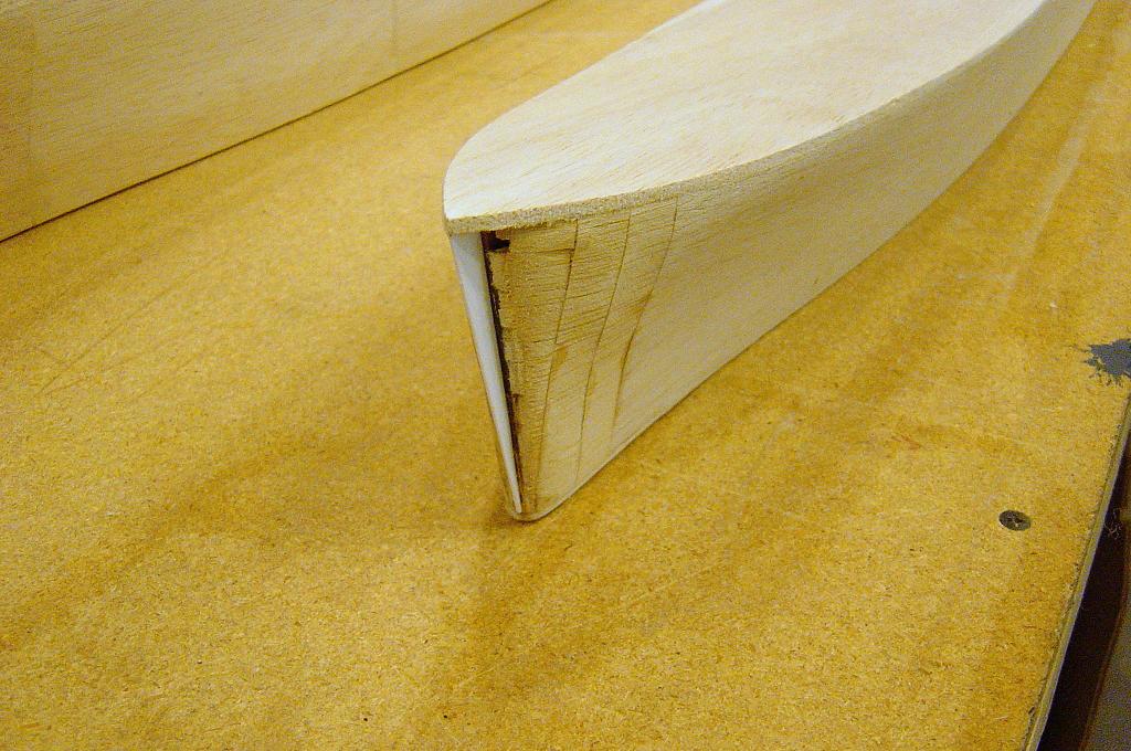

File comment: Bow view of the DE. Note the piece of .040 styrene added here for the bow stem. I'll form this area with autobody filler using the styrene as a guide to get that nice sharp bow. Once finished, this will all blend in and you would never know it was there.

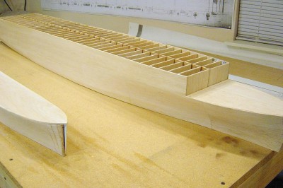

File comment: The CVE's bow is alot more blunt than the DE. That sharp edge does'nt start till just above the waterline. I'll use styrene here too for the stem, but the upper part of the bow is quite rounded, fat, if you will. Same procedure with the filler will be used.
File comment: Stb. side here. Again note that second layer of balsa sheet really smooths things out.
File comment: Another stb. side view.
File comment: Good study from stb. showing the size comparison of the two ships. The CVE is about 200 feet longer than the DE. About 2 feet in scale terms.
Next step will be to seal the wood with polyester resin, then sand,sand,sand. Stay tuned, more to come...I continue on.............. :wave_1: :thumbs_up_1:

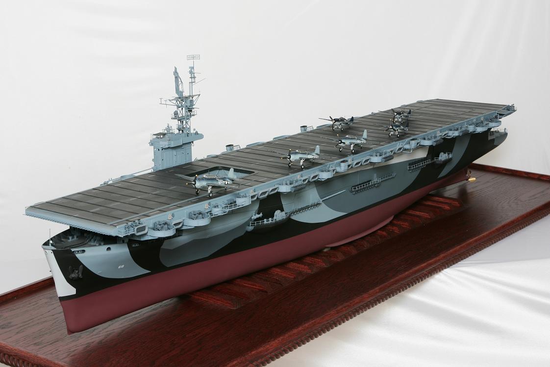

For those of you who are interested, heres a shot of the CVE USS Kalinin Bay in 1/96. Not waterline, but the same ship as this new one. Camo here is a bit different too. Both ships are Casablanca class CVE's.This is about how the new project will look when completed. I finished this replica some time ago and it is on permanant exhibit at the National Naval Air Museum, Pensacola, Fla. :smallsmile:
