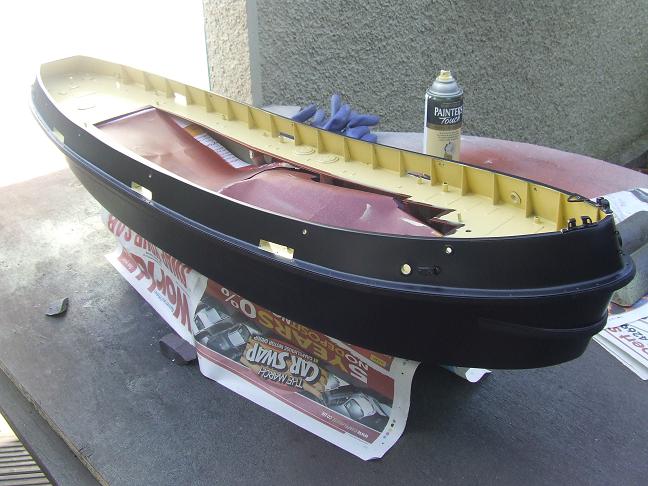

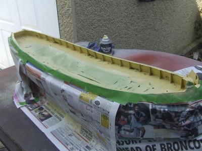

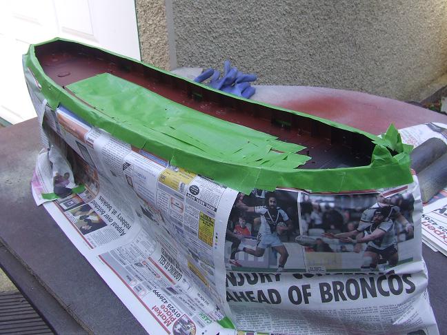

Time to paint the inside of the bulwarks so I masked off the top rail with low tack masking tape and the used newspaper to cover the rest of the outside of the hull. The paint was applied in thin coats allowing each to dry before applying the next to build up the depth of paint without any runs. Once dry the newspaper and masking tape was removed.
Tiny

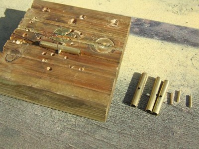

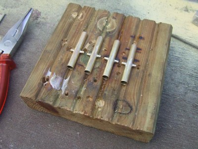

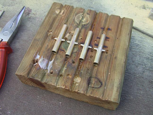

Time to do some work on the four bollards that sit alongside the bulwarks for mooring the ship to the quayside. They are quite simple to make from a brass tube with a hole drilled through about half way up and the cross bar soldered in place. The top is filled with solder and filed to shape.
Tiny

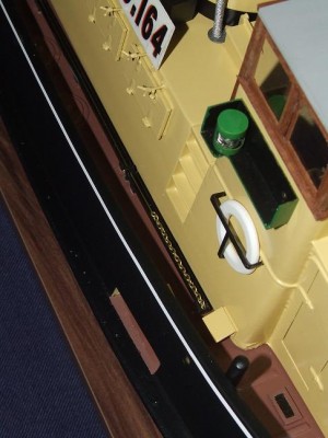

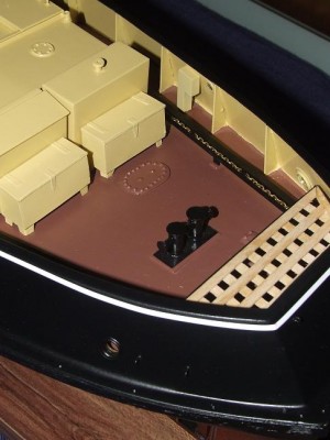

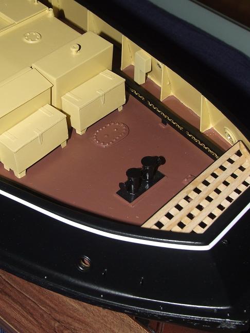

The tug as progressed with the painting of the deck, brick red and the application of the 2mm wide vinyl white stripe around the top of the bulwarks. For Easter I received a name plate to go on the display stand from my Mum & Dad.
Tiny

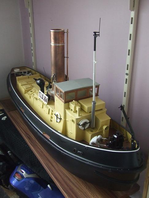

PostPosted: Mon May 14, 2012 10:51 am
Posts: 267

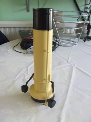

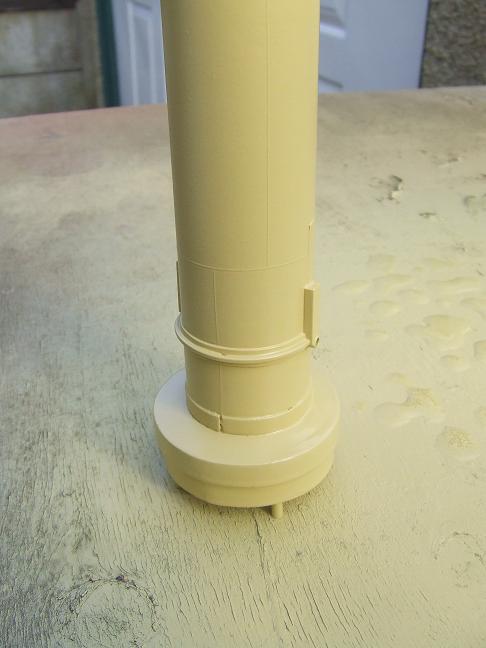

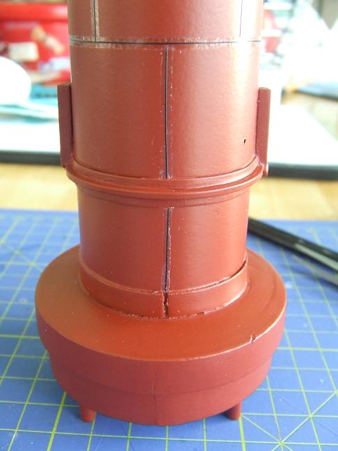

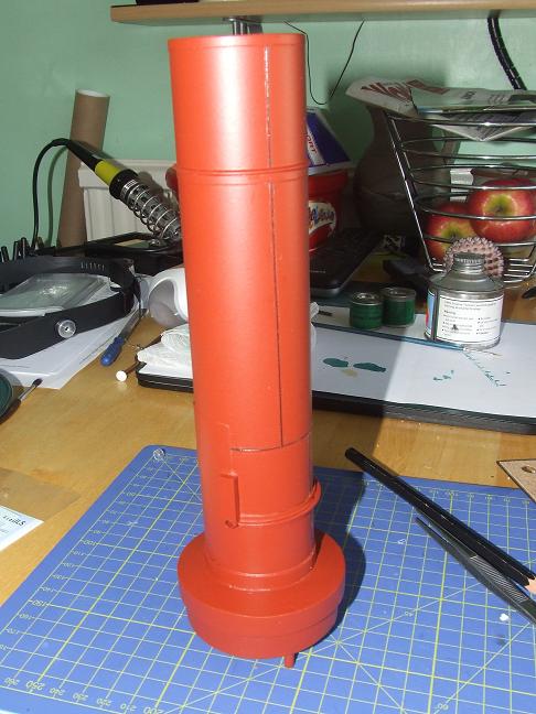

Funnel
The first stage was to spray under coat the funnel with red oxide paint and allow it to throughly dry. Next using Archers Finescale surface decals I applied the decals to simulate the welds on the funnel and left them to dry for a few days. A final coat of red oxide to seal the transfers before I applied the first coats of Navy yellow. Again I left this to dry for a few days to ensure the paint wouldn't lift when applying the masking tape for the top section of the funnel. Finally the top section was sprayed black and the counter balance weights added.
Regards
Tiny
File comment: Completed funnel
File comment: First coat of yellow paint
File comment: All welds added
File comment: Weld simulation decals added

PostPosted: Mon May 14, 2012 4:16 pm
Posts: 1173
sweet looking funnel,tiny.very nice.
PostPosted: Wed May 16, 2012 2:45 pm
Posts: 4131
Location: Liverpool
Tiny the method you applied for the weld lines on funnel makes all the difference , superb work .
Dave Wooley :thumbs_up_1: :thumbs_up_1: :thumbs_up_1: :thumbs_up_1:

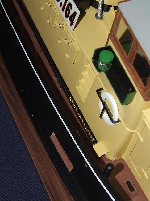

I have now completed the steering rod/chain channels that run down the side of the main superstructure and across the rear deck to the rudder quadrant under the grating. The superstructure has been given a final coat of paint too.

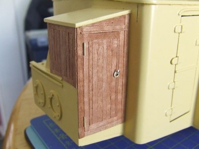

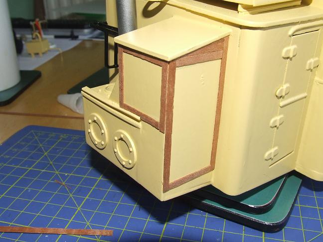

Planking the toilet block
Now that the final coat of paint as been applied it was now time to plank the toliet block starting with the outside frames. Using 3mm wide 0.7mm thick mahogany strips each piece is measured, cut and glued in place with superglue. Once the outside frames were complete I continued with each infill panel and door finishing off with the brass hinges and door latch.
Tiny

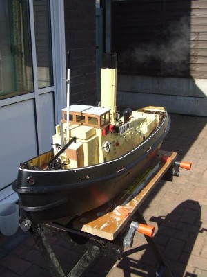

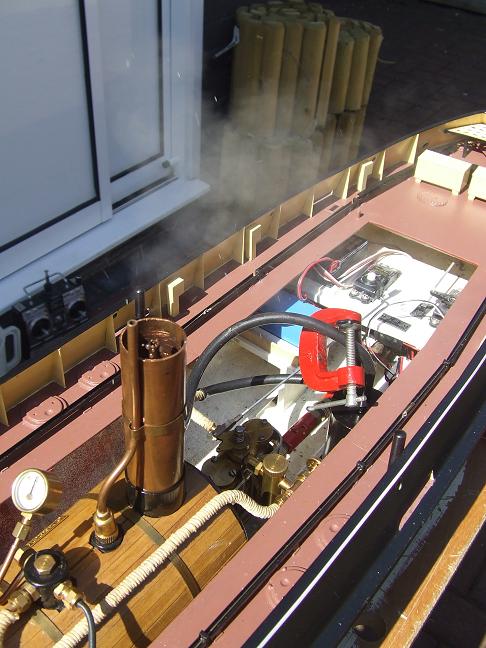

Today I connected everything together, filled the bolier with water, lit the burner and raised steam.
Tiny
