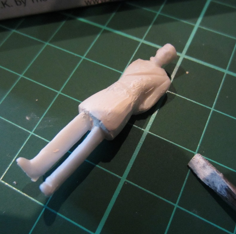

For this I used "Milliput" epoxy putty, fantastic stuff, but I'm not sure if it is readily available outside the UK. I use this in my "day job" restoring antiques and fine art so know how it works. The pictures show the "super fine white" but it is available in other colours. Mixing the two parts produced a sticky malleable clay like medium which can be worked and spread with tools and fingers. Adding a little water to the surface makes it possible to smooth it out. It cures slowly over about 6 hours to a density that can easily be carved with a craft knife. Left another 6 hours and it's rock hard and can be sanded.
I also re positioned the figures head and removed the modern collar and tie which will be replaced with a Victorian stiff collar.

File comment: Milliput epoxy putty is excellent for these fine modelling tasks.

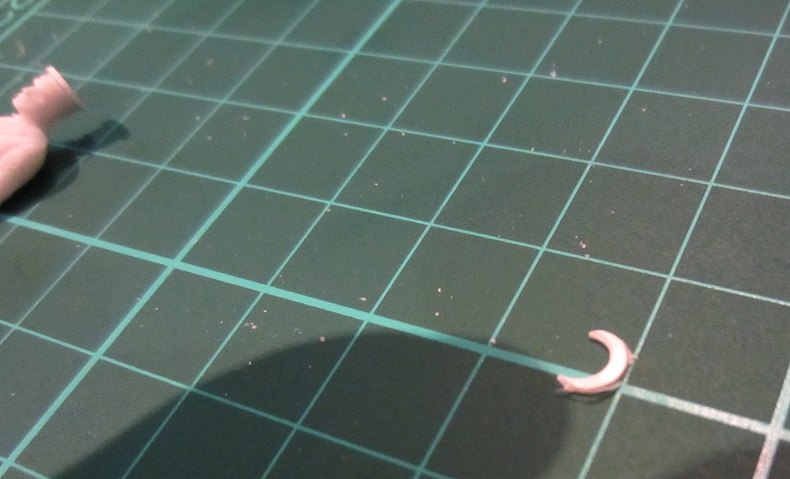

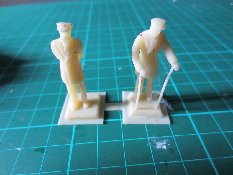

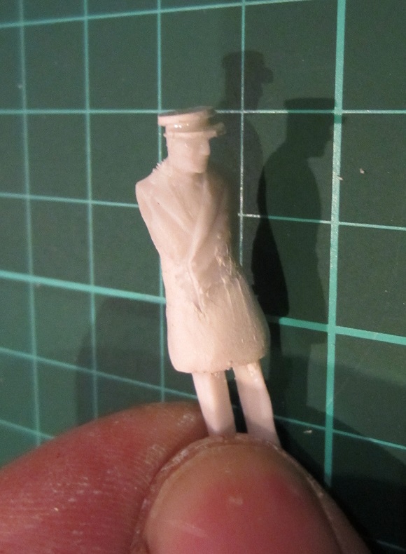

Hi all
Having previously removed the top of the figures head, I now needed to give him an officers hat. Using a hole punch I cut out a small disc of 1mm plastic card, followed by another disc slightly larger but the same thickness. The smaller disc was the same diameter as the figures head. These discs were glued, with solvent weld, to the top of the officers head, small disc first.
Punching out a hole, followed by another, larger but off set created a tiny crescent which was glued in place to create the peak of the hat. When the glue had set this hat was tidied up and gently sanded.
The epoxy putty was used to create the beard and mustache and also to make the trousers slightly more baggy. It's a little difficult to see the detail as everything is white but it will show up much better when the figure is primed.
File comment: Two plastic card discs were used to create the officers hat.
File comment: A hole punch was also used to create the a small crescent used for the peak of the hat.
File comment: When dry the hat was tidied up.

File comment: Epoxy putty was also used to make the trousers more baggy and to add a Victorian stiff collar.

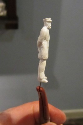

Hi all
I had decided to model two officers with different poses. The second was to be standing on the (open) bridge of another model, holding the stanchion rails. I therefore needed to re position both arms. Having removed the moulded in plastic arms I drilled a 3mm hole in the shoulders to ensure the new arms (formed from epoxy putty) had a strong key.
The epoxy putty was rolled between the fingers very roughly to shape, and pressed into the shoulder forcing it into the pre-drilled hole. The arm was bent and positioned. I then set it aside for about 6 hours. Gently pulling on the arm when the epoxy had set, removed it and then I was able to CA glue it back in place. This gave a much stronger bond than just the putty/plastic and keyed the new arm into the hole in the shoulder. You need a strong bond if you are going to carve the putty without pulling the arm off.
The tools used for shaping the figure were just a sharp scalpel, fine files, dental probes and a selection of wooden coffee stirring sticks with various grades of abrasive paper stuck on the end with CA. The latter are very handy little tools and leaving the sticks full length makes them easy to hold and use, and good for reaching into difficult spots.
File comment: The new arm was formed from epoxy putty. It is over size and will be subsequently carved to shape.
File comment: Some of the tools used for carving and shaping the figure.
File comment: The arm starts to take shape.

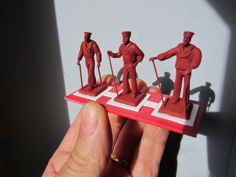

Another feature noticeable on the old photos of RN sailors was the lanyard around the sailors necks. I'm pretty sure they usually had a clasp knife on the end of these, and they were all tucked into their breast pocket. I modeled the lanyard using very fine lead wire. This is very useful stuff available from the fishing tackle shop and normally used for making fishing flies. It's easy to manipulate and sticks well with CA.
The figure at this stage is "getting there" but still needs some fine sanding before being sprayed with primer. This fills the remaining fine scratches, but I had to be careful as too many coats will fill up the detail and take away any crisp edges. As with other work I found the red coloured primer made it easier to see blemishes and errors.
You are probably asking why all the figures have walking sticks! No my models are not going to be crewed by aged sailors. I had previously decided to use these figures as masters to cast figures for some of my other models so the "walking sticks" are to allow air bubbles to escape from the silicon rubber moulds during the casting process. That's the plan anyway we shall have to see if it works in practice.
File comment: The lanyard around the sailors neck has been added using fine lead wire. The "walking stick" is to aid air escape when the figure is cast in resin.
File comment: The figure has been mounted on a plastic card base with sloping edges.
File comment: The figure has been sprayed with primer. This fills the fine surface scratches and gives a good surface to form a mould on. This figure will eventually hold a boat hook.

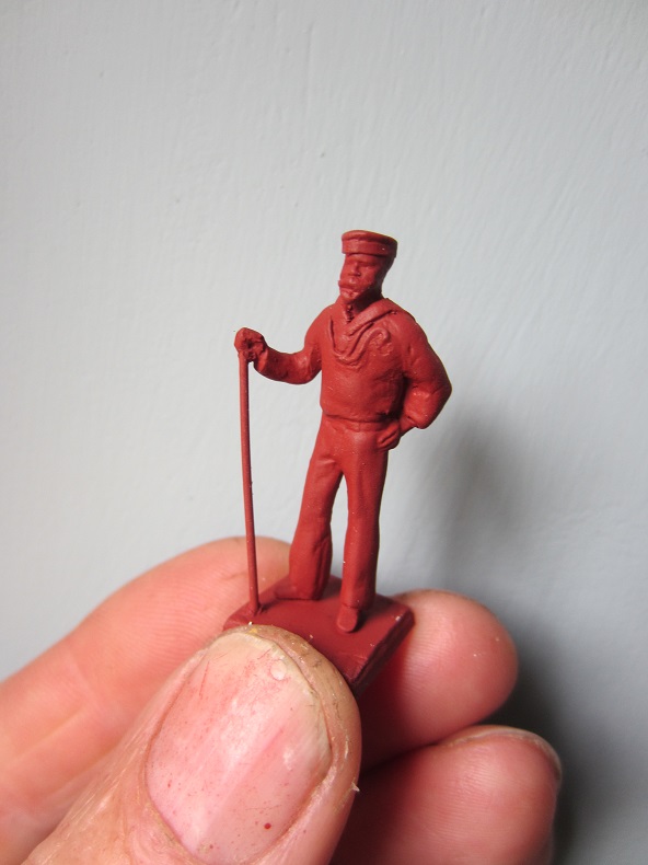

PostPosted: Wed Jun 04, 2014 2:35 pm
Joined: Wed Jul 21, 2010 2:44 am
Posts: 474
Location: Dumfries, Scotland

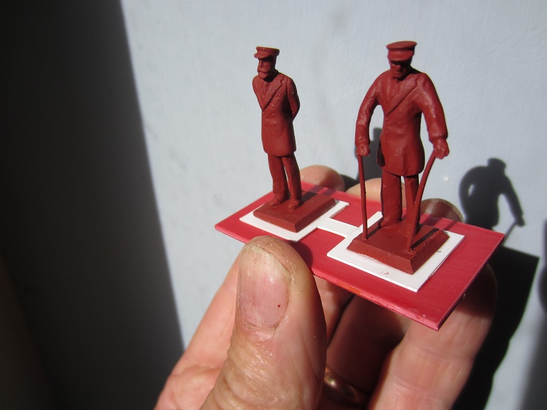

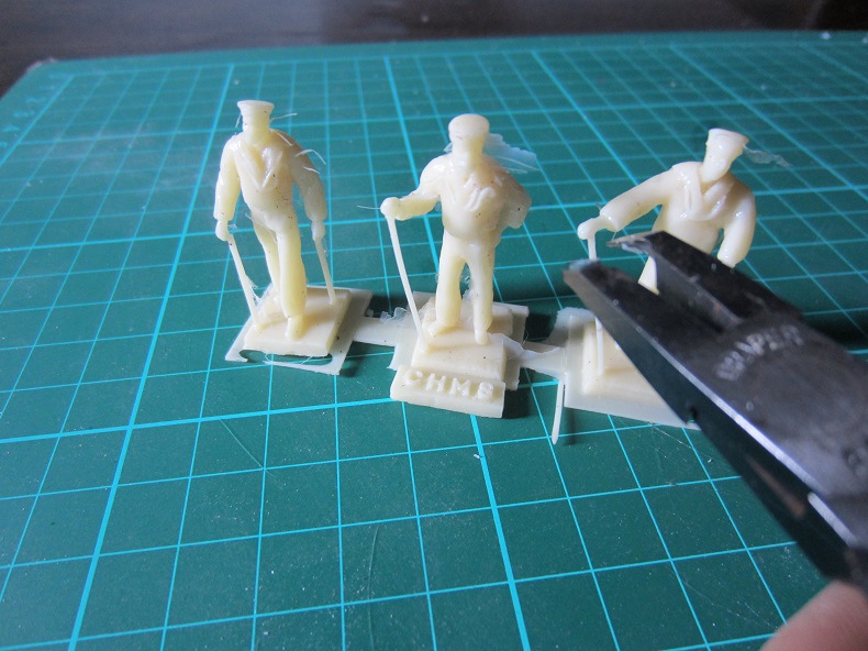

Hi all
The individual figures, on their bases, were then grouped on a larger plastic card base which will carry the walls for retaining the moulding silicon rubber.
File comment: The three sailors mounted as a group. This is how they will be encapsulated in the RTV rubber.
File comment: These are the two officer treated the same way.

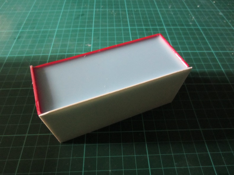

The next stage was to fill the plastic card box with RTV silicon rubber, carefully measured and catalysed in this case with slow (blue) catalyst. This had previously been de gassed in a vacuum chamber to 18 inches of mercury. The whole mould was then put into a pressure chamber and left overnight at 50 psi. The following day the walls of the mould were removed.
File comment: The RTV rubber was poured into the box.

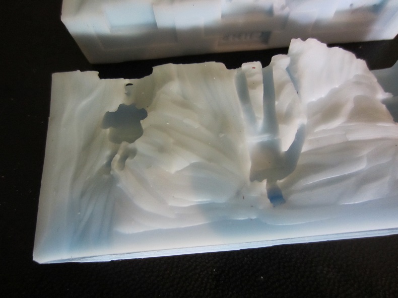

It was at this point I did a little calculation and figured I had spent about as much time working on the seven figures as I had making up pretty much all of the picket boat model !!!!!!!!
The next stage was to remove the figures (masters) from their entombment within the RTV silicon rubber. This is a little tricky and needs a sharp scalpel, a steady hand and a good light.
I started at one end and making an incision along the mid line, making repeated cuts, until I met approximately the side line of the figures, then continuing along to the next figure. Pulling the mould apart as I went along was a bit difficult (you sort of need three hands for this) but eventually I went all the way along and half the mould came away. The figures were still captivated by their out stretched arms and "walking sticks" so secondary incisions were made at 90 degrees until I came to the "walking sticks" . The figures were then carefully removed. The mould was checked and fitted back together and secured with three small rubber bands.
I was now ready for casting.
File comment: A sharp scalpel was used to split the rubber mould.

File comment: Holding the mould apart while cutting was difficult.
File comment: The mould was eventually cut in half.

File comment: Secondary cuts had been made into the mould to meet the out stretched arms and "walking sticks".
File comment: The two mould halves fitted very neatly back together and were secured with three rubber bands.

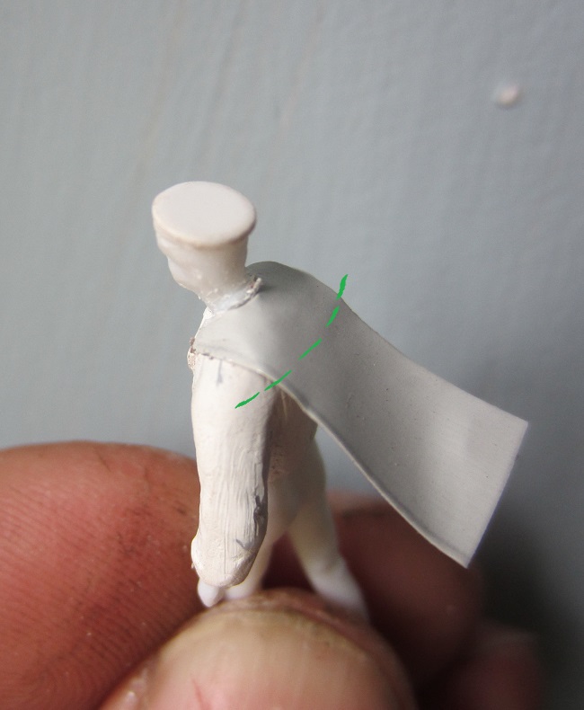

Hi all
Here you can see the secondary incisions into to RTV mould (at 90 degrees), which make it possible to extract the figures with out-stretched arms and "walking sticks". Next I pour resin.
File comment: The secondary incisions into the mould.

Well this is the moment of truth. You never really know how well these moulds work until you try them out.
I poured the resin and increased the pressure pot internal pressure to 50 psi.
Not bad results in the end. OK so it's not exactly "Games Workshop" quality but for home produced figures they are not too bad. There was a small amount of very thin, and thus easily removed, flash along the mould seam. The "walking sticks were very easily removed with small side cutters. These served their purpose very well and there was no loss of limbs.
Beards and chins are a slight problem with small air bubbles trapped under the figures chins on some de moulds. A fine incision in the RTV mould,vertically under the chin allowed the bubble out. The resulting "web" under the chin was easily removed on the de moulded figure.
File comment: The first figures out of the mould.
File comment: Some fine flash was left along the mould seam.
File comment: The "walking sticks" served their purpose.
File comment: The "walking sticks" were removed with small side cutter.
