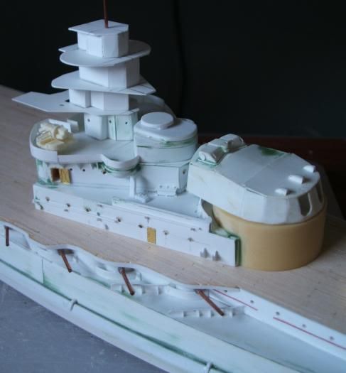

Back on the Barham!
I'm building the decks of the fore superstructure, at this stage I just need the main shape of the decks and relative offices, before to detail them I must trim all the sandwitch of decks.
Here the main parts:
I will use a copper tube of 1 mm of diameter to set all the centers of the structures, than I'll add some small pieces of plasticars to fix their positions.
Of curse the main mast is larger than the copper tube that I'm using to give some mechanic resistance to my structure, to simulate the main mast I will cover the brass tube with a styrene tube, this will give to the main mast the right diameter and second but not for importance will let me add details using plastic cement insted of CA glue.
The complete structure will be movable, this will allow to detail each deck separately, and to paint them without problems .... I hope :heh:

Small update, lets begin the fun detailing the superstructure decks, but first a look at fittings just arrived from the Admiralty in England :heh: ( ...uhm the DNC doesn't know how much it will cost the final fitting of HMS Barham, but better leave the things this way :eyebrows: )
I glued the "B tower deck with the conning tower deck, I noticed that the quality of my previous works wasn't so good, I needed a lot of putty and sanding, but the overall look goes for me.
Here a pair of photos with the details and a dry fit test with WEM quad pom pom.
