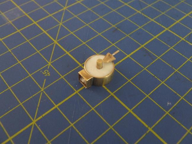

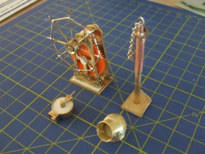

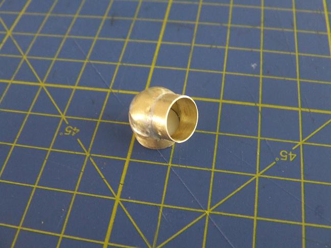

More Wheel house fittings

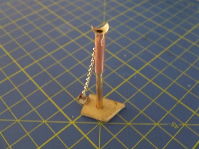

The compass housing, top of the telegraph and voice pipe to engine room.
All made from various bits of brass, copper and plastic sheet.
Tiny

File comment: Telegraph
File comment: Voice pipe
File comment: All the items together

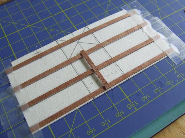

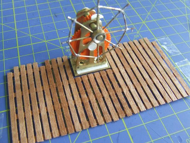

Wheelhouse floor grating.

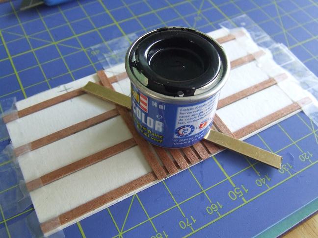

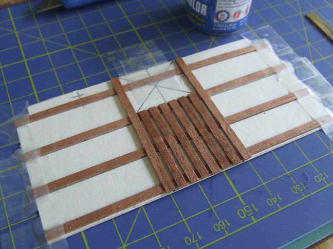

First I measured the size of the floor, marked this onto a piece of card and then secured it to the cutting mate with clear tape. I then marked the position of the ships wheel and placed the four support planks onto the card. Starting from the centre working outwards I glued each individual plank in place using white PVA glue. I used a piece of 1mm thick brass to space each of the 3mm wide planks.
Tiny

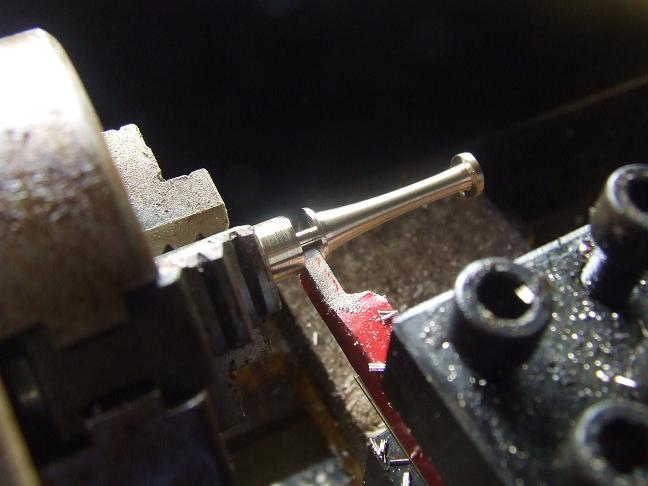

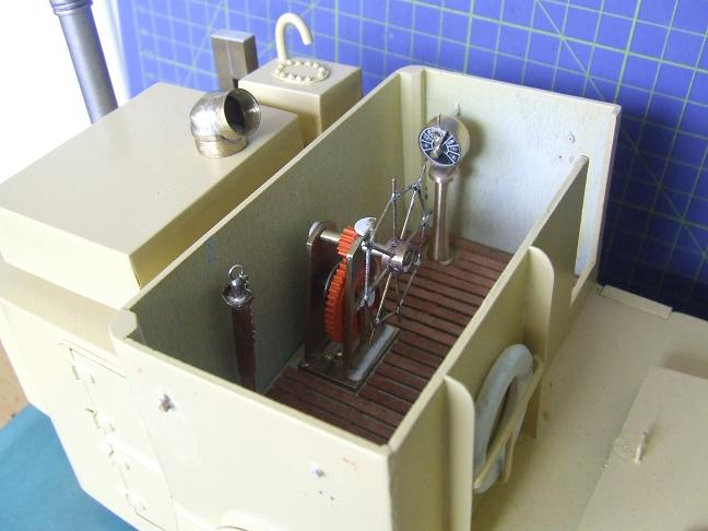

Wheelhouse Telegraph

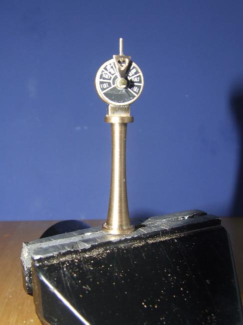

To complete the telegraph I turned a pedestal with a taper from 10mm brass on my lathe. I produced the dial detail on my PC using microsoft publisher with the black face and white markings only measuring 11mm in diameter. I printed it on plain white paper on the draft setting, cut it out and glued it in place with 'Pritt Stick' paper glue.
Tiny

File comment: Fittings in position in wheelhouse

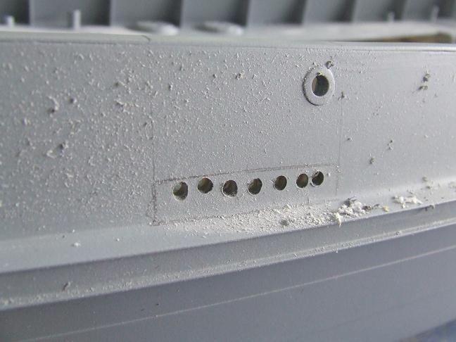

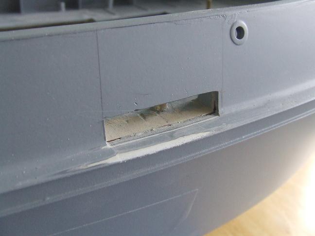

Time to finish off the hull ready for painting so I have to tacke the six wash ports. First I marked out the positions, then drilled some holes to allow me to file to shape.
Tiny

File comment: One down 5 more to go

Well I have done 2 now so only 4 to go.
Tiny

All wash ports are now complete.
Tiny

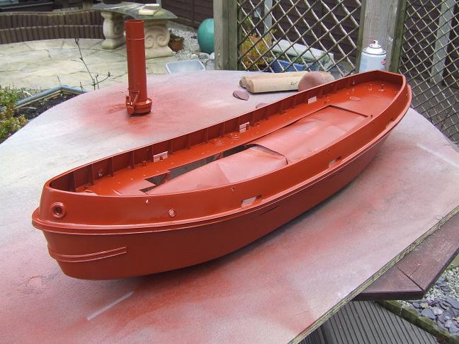

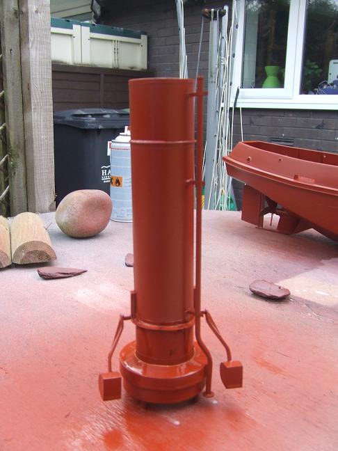

Time for another coat of paint after filling all the minor blemishes on the deck and hull. I also gave the funnel its first coat too,
Tiny

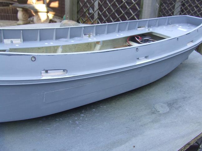

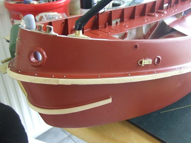

The next stage was to fit the wooden rubbing strips around the hull. I cut each section into 6 inch (150mm) lengths and glued them in place. I roughed up the edges to simulate the wear and tear they would get during the tugs working life. Next I drilled and pinned along the top edge to simulated the holding pins. These can be seen in the second photo.
Tiny
