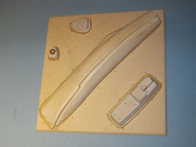

The huge advantage of basing this model on a series of vacuum formings is that, having manufactured a mould to "form over", the finished hull is light weight, 100% waterproof, easy to glue together and there in no internal strengthening to get in the way of fittings and RC gear. Yes I did have to invest some time in manufacturing the mould, but not much more than building a one off wooden hull. My vac forming machine is not large and the picket boat hull length just about fitted when placed diagonally, leaving space around the hull which could accommodate other fittings and deck detail. The two vac formed sheets of 1.5mm polystyrene are approx 300mm square.
The pictures show the two moulds (port and starboard). They are designed onto a base of 10mm medium density fibre board (MDF), with the main hull halves made from lime wood and all the other components manufactured from a type of "pattern makers" carving resin called "Conform". All components were stuck together with super glue. If you look close you can see the base board is covered with 2mm holes to ensure no air is trapped when the vacuum pump is turned on.
I could have just formed the hull halves on their own, but as there was space I tried to cram in as much as possible and therefore not waste the plastic around the edge.
Arranging the fittings was problematic as if they are too close together, the larger items can create "webbing" in the plastic. This creates webs like a bats wing and ruins the finished product.
I included a motor mount in the vac formings as it is strong and light weight. I designed this motor mount to carry a standard sized servo motor. In practice I fitted an even smaller motor which was more suitable and still fitted onto the mount, but more of this later.

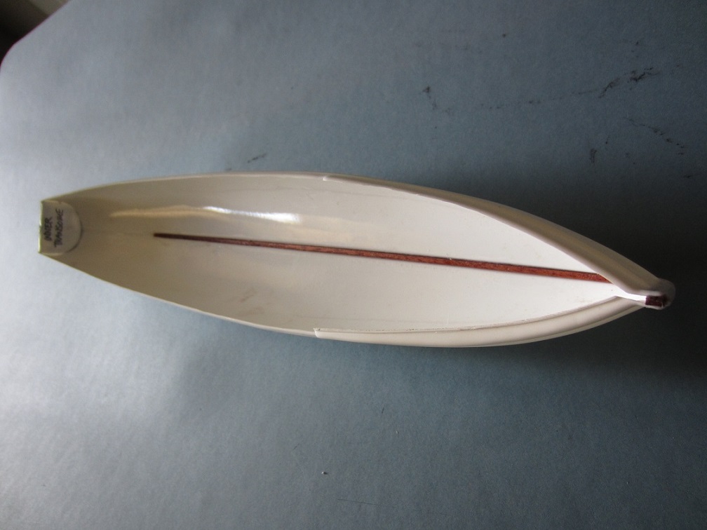

Hi all

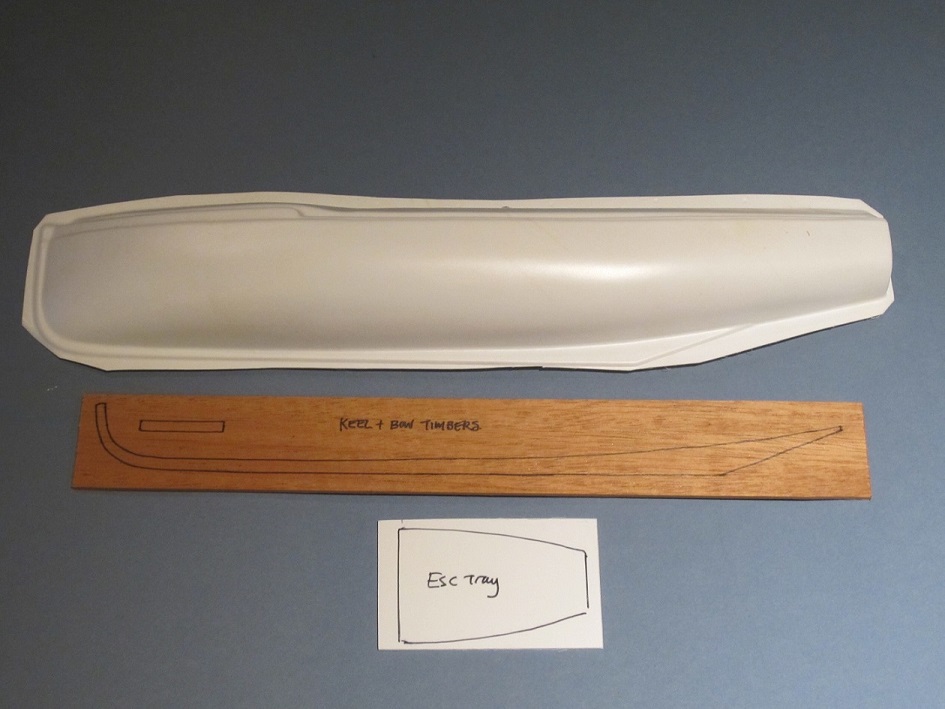

Next I used a sharp scalpel to carefully score around the hull halves and remove the waste plastic. I had previously marked out the shape of the keel and bow reinforcing timbers onto some 2mm thick mahogany. These I cut out with a fine fret saw.
The inside of the hull mouldings, where the keel and bow timbers fit, was rubbed down with fine grade abrasive paper. This ensures that the CA glue keys well to the plastic and also speeds up the setting time. These timbers add greatly to the rigidity of the hull.
The timbers were glued into one hull half and left to set before the two hull halves were assembled.
File comment: Hull half, keel and bow reinforcing timbers and ESC/receiver tray.
File comment: Keel and bow timbers glued in place.

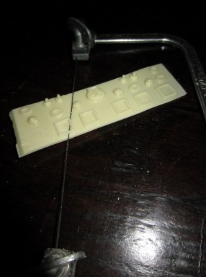

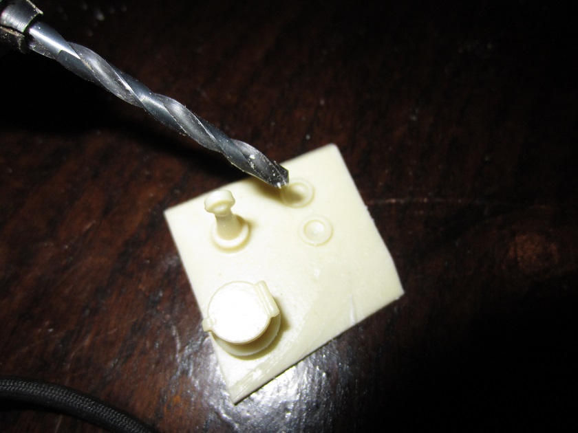

The silicon rubber mould turned out well and I was then able to cast all the fittings in one go. When the casting had been made, the fittings are still attached to what I refer to as “the casting base”. This is in fact the reservoir of liquid resin which is forced down into the mould and replaces any trapped air bubbles. When the resin sets, the 2 to 3mm thick base acts as a carrier for all the parts until I was ready to use them.
Removing the parts from the casting base was straight forward.
First I used a sharp drill of the appropriate size; to drill out any holes that were needed like the port holes. It’s so much easier to do this while these tiny parts are still held in place by the casting base.
I then used a craft knife to score the base, between clusters of components, and then carefully snapped the base into more sensible sized chunks.
Having previously tried different techniques for removing the components from the casting base, I finally perfected this very simple technique.
I found that a very fine fret (or piercing) saw blade cut through the resin easily, and with a little care the blade followed the flat surface of the casing base. A flat backed razor saw worked OK, but had a tendency to wander up or down and was more difficult to steer if the blade went off track. I also found the brass spine on the saw got in the way.
The other plus with the fret saw blade was that the cut was so fine that material loss (the kerf) was very small.
With the larger fittings, like the rudder, I also discovered that it was easier if the saw blade circled the fitting, cutting inward from all sides towards the centre, until the fitting fell away.
Each component was then rubbed gently along some fine abrasive to dress the cut surface. Sticking a piece of abrasive paper to a chunk of stout heavy board is a great idea.

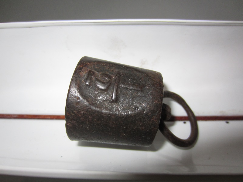

At this point I had no idea of how much the hull displaced and what weight it might carry in the form of RC gear, motor, batteries and ballast. Maths not being my strong suite, I worked this out by floating the bare hull in the sink and adding known weights. It was surprising to see that it needed 8 ounces to take it down to water line. I will leave you to work out the metric equivalent.
I should point out at this point, although I designed this from the outset as a “wet” model, there is nothing to stop me building a second as a static or even waterline model.
The eight ounces of weight kept a reasonable free board, as the hull shape indicated that the model (and one assumes the prototype vessel) would bounce across the waves, rather than plough through them.
One of the pictures attached to this post is detail from a contemporary (1900) painting by Charles Dixon and shows a twin funnel picket boat, minus gun, bouncing across a choppy sea, within Portsmouth harbour. This is an interesting colour reference source too.

File comment: Victorian kitchen scale weights come in useful for checking ballast loads.

File comment: Hull seam reinforcing strip.
