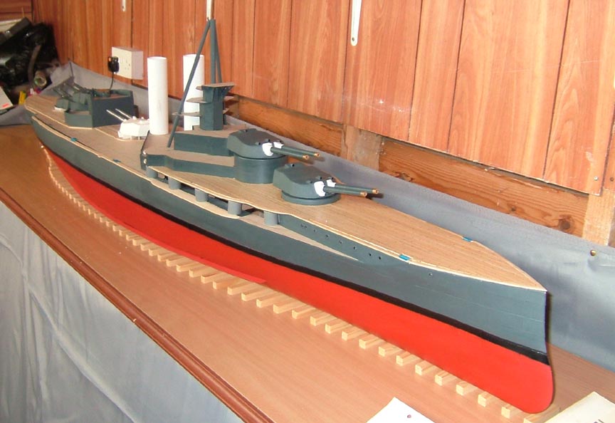

Just sorting out some photos and came across pictures ofAH at one of the l Ship Modelling Society seminars.
The guy next to Ron in the second picture is the Master at diorama work Edger Hodges
The guy talking about his tug in the first picture is Phill Scales the Master of camouflage work there is non better in the UK. Also the young guy to the left of the pic is AH junior a Silver medal winner at the London Model Engineering Exhibition an superb model maker in his own right and a chip off the old block.

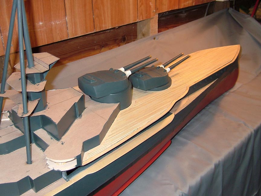

A short lesson tonight, we continue planking the deck.
All sections cut and ready to be glued in to place.
All glued down with PVA white glue.

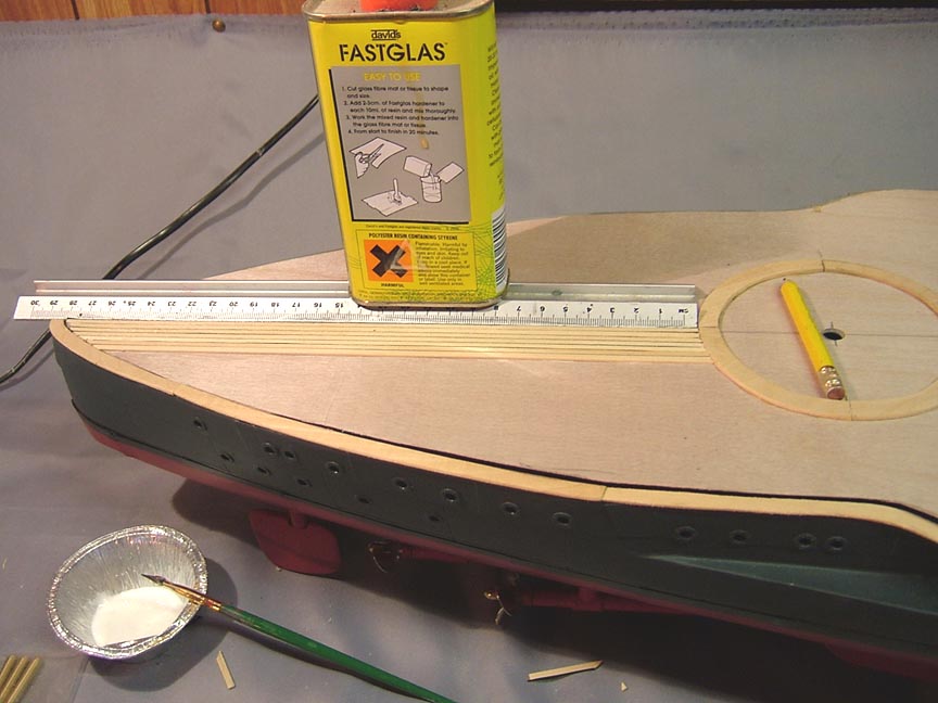

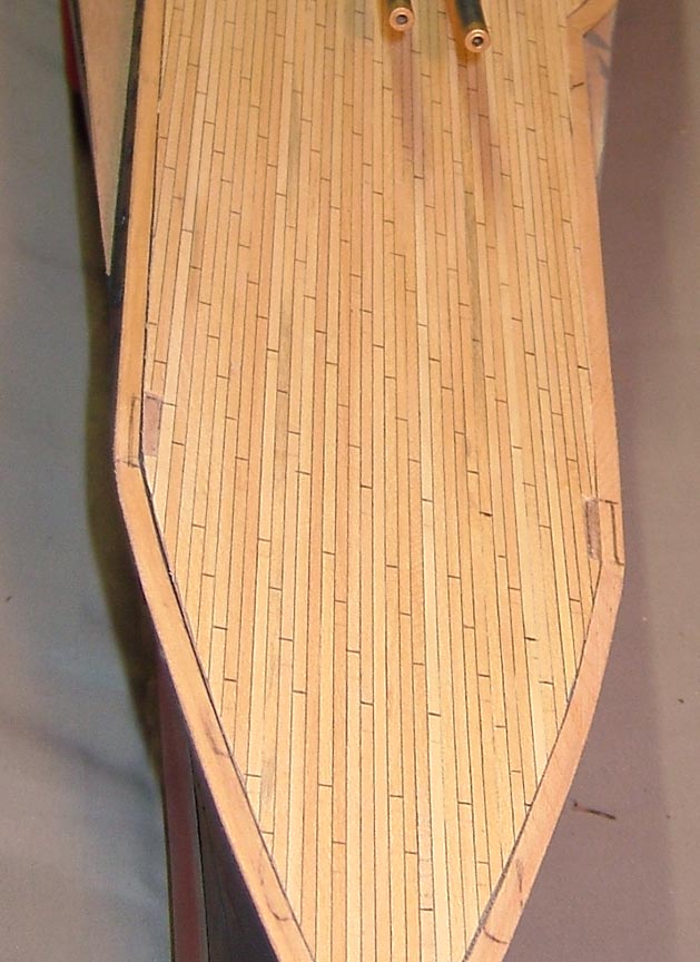

The first part of the deck sanded to a finish and marked out. I have made all the planks a standard 20 ft in length, each plank is staggered a quarter each time.

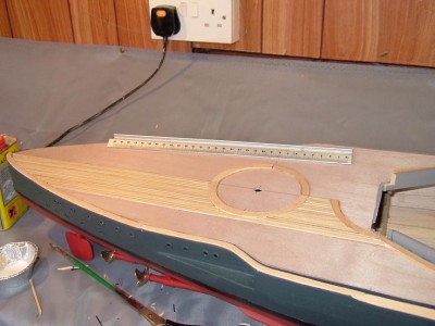

An overall view of the deck, some more marking off to do.
A bow shot, notice the gap at the side, that's because of the camber of the deck underneath, this will be held down by the bollard fittings

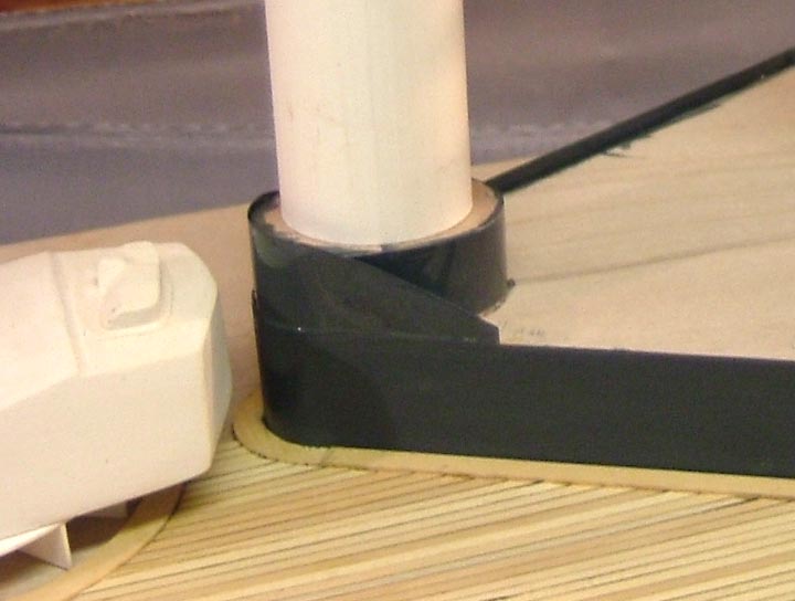

Not an aerial rigger by any chance? My dad is trying to trace his pals from the bomb tests on Christmas Island.
But on topic, how have you marked the break in the planks? The tip about insulating tape is great, much easier than the other methods I have read up, like applying yarn between the planks as you lay them.
As for the tropics, he he, been there, our mess was right over the diesels, we used to buy sacks of ice and spread them on the deck of the mess to try and keep cool. Need that lantern swinging emoticon again.
Hi , Crash Amblance
I had a friend who was at those tests, he was in the navy, he showed me pictures of the bomb just after they had gone off, he was very small and his job was to clean out the air intakes afterwards, but he had his camera there also :lol_3: :lol_3: court martial offence.
The joins are marked with a pencil, a lot easier that way, and quicker, :woo_hoo: :woo_hoo:

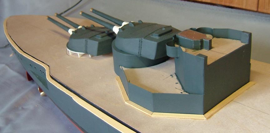

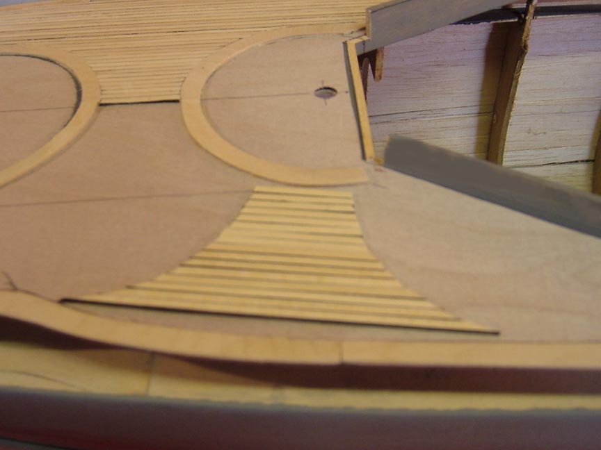

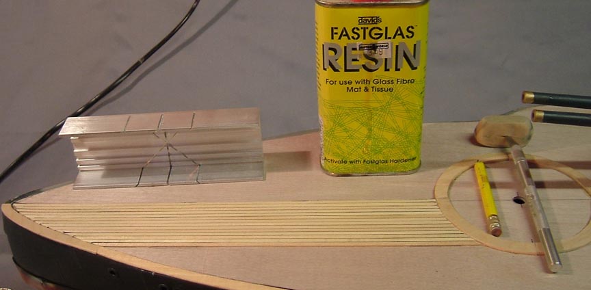

Hi Guys, still planking the deck, but a few other things besides.
Looking like a space ship the deck sanded, marked out and treated.
Back in position.

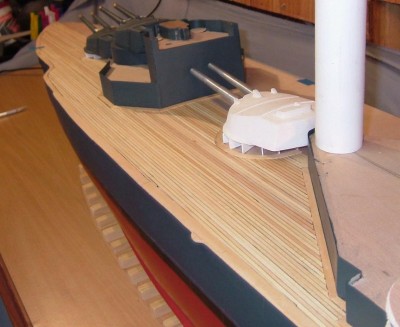

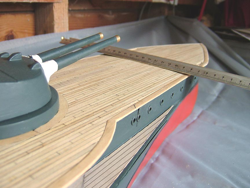

You can see the camber on the bow

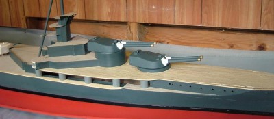

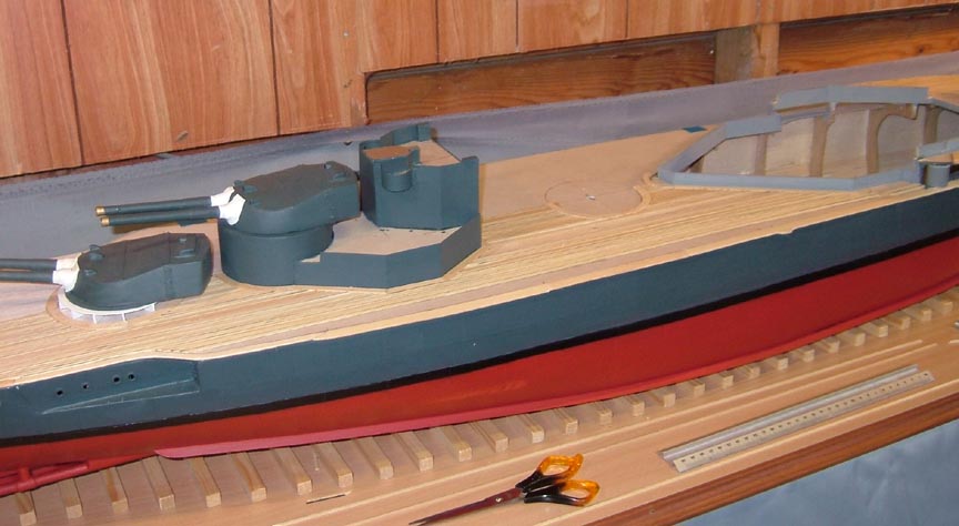

I have cut the casement gun protections and placed them in position, these were cut from plastic water piping.

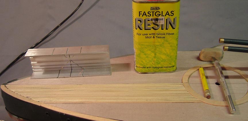

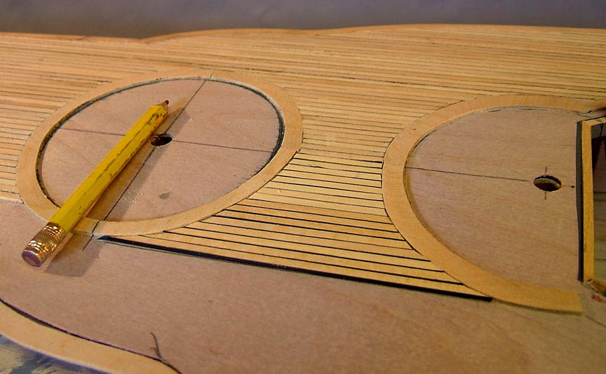

When you are cutting the margin planks, cut them larger and let them overlap, you can mark a better angle on the corners.
You can see the angles, the long section over the centre of the deck has been slightly bent to allow for the deck camber.

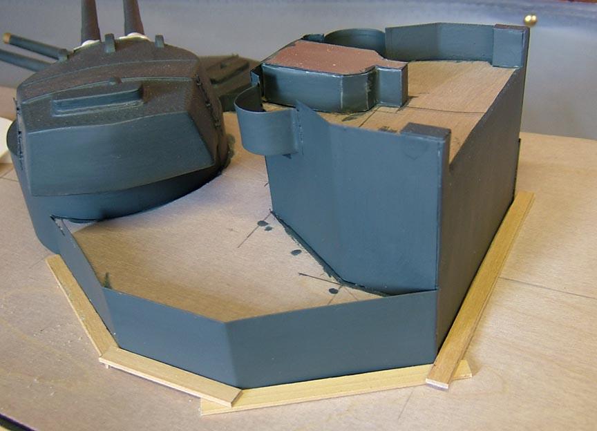

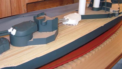

We start again on the stern, straight edge on centre line, margin done round #5 turret, timber cut and glued. A little tip, when you have all those pies, cakes and cookies save the little tins they come in, handy for putting glue or paint in, or washing out brushes.
When you have planked a section, have some weights handy to put on top to hold it down for a while.

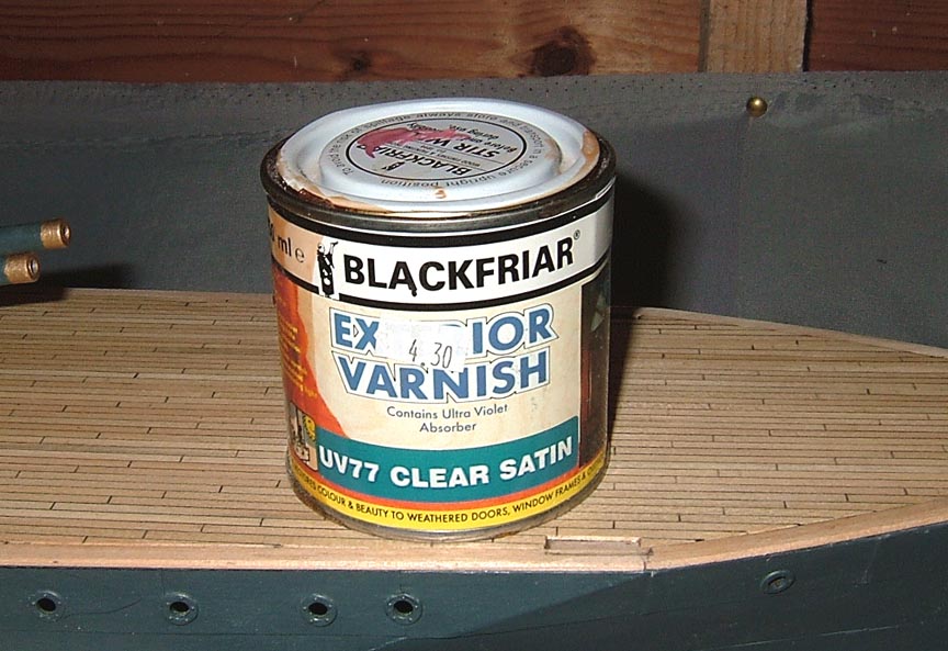

This is the finish I am using to treat the decks, seems to work for me.
enjoy, ARH :wave_1: :wave_1: :thumbs_up_1:

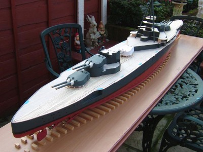

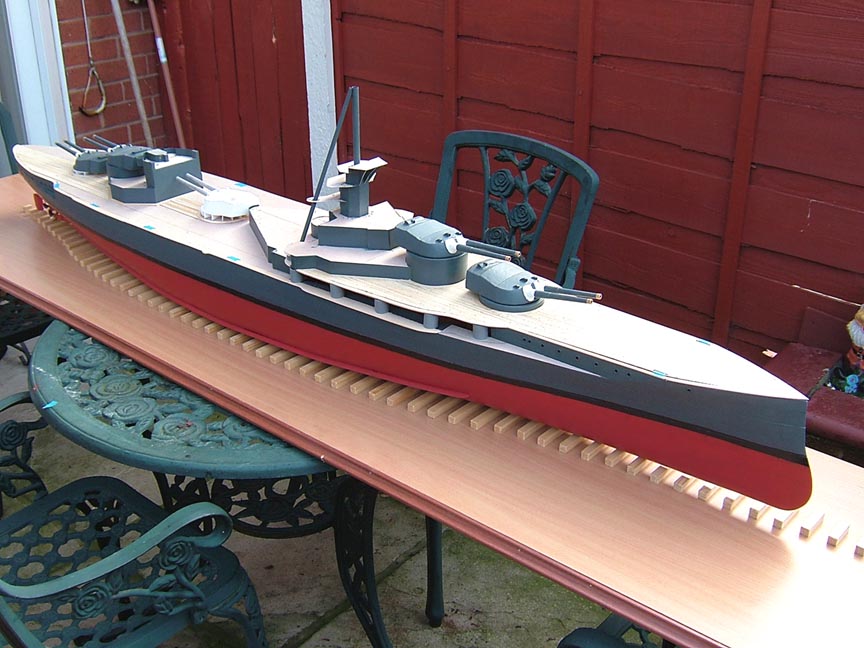

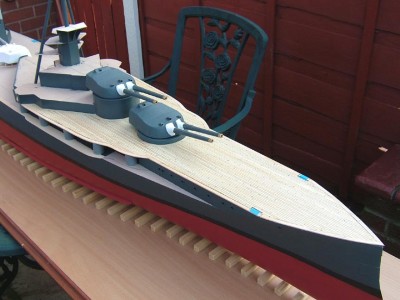

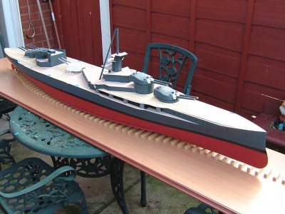

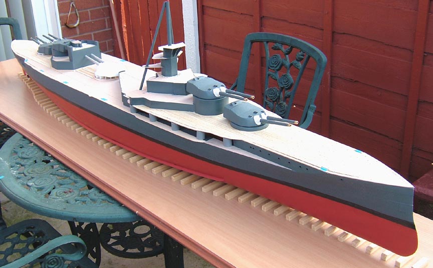

The ship yard was open today, some gnomes turned up, I think Jim B must have sent some of his.
We are still doing the the planking.
We have borrowed the NC dry dock and took some photo's outside, a little to sunny. The photos are all 12 inch to try to keep the text on the page and the down load time quicker, so it effects the quality, I hope you don't mind.
Notice the difference in length, 150ft scale wise but 30 years on.

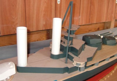

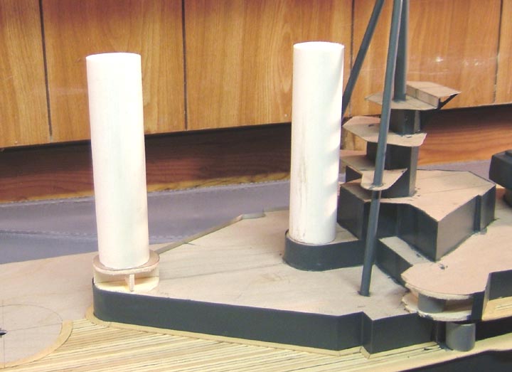

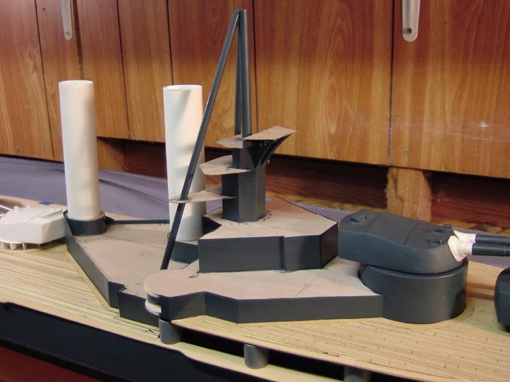

Back in the shed, still on the dry dock, I managed to find some thin plastic round tube, this will be the base for the smoke stacks.
Beginning to get its final shapes, with the stacks in place it does not look to empty amidships.

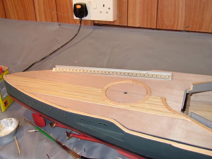

I continue planking the decks, notice the 1ft ruler, this gives you a rough idea of the scale of the ship.

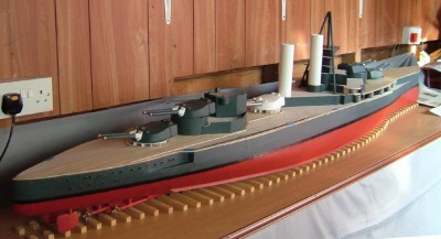

Overall view of the build so far, the rear stack has to be raised on a small platform to come level with the front stack.

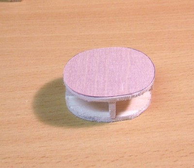

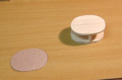

Just a small update,
All parts cut out of balsa,
Cross section put together and placed in position.
Top and bottom fitted together.
1/64 thick ply glued on top.
Part in place under the stack.

A very short one to night.
The balsa base was covered with litho plate, this was pinned and wrapped around and then glued, the tapered section was glued in position with the base, if you look closely you can see the opposite side of the superstructure has had its litho plate glued on.
The section was painted
Now both stacks are the same height, a third coat of paint to the superstructure.
enjoy, ARH :wave_1: :thumbs_up_1:
