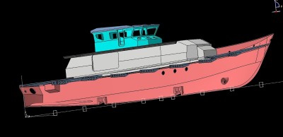

How's the CAD coming along? Pretty well! I'm nearly done with the major structures, and am adding all the little stuff... like hanging ornaments on a Christmas tree. But even that needs to be done, as the design work on some detail often points to the need for mounting features on the main structure.
Note that I have no intention of creating a photo-realistic rendering... that's a job in itself. So my images here will be pretty basic, just showing those components that I plan to print (or will investigate for printing). But all items visible here are designed with feasible geometries for printing, finishing, and assembly.
File comment: Half-hull image showing interior details for the pedestal mounts.
File comment: Detail work to-date.
File comment: Hero's can carry two 8m Zodiac H753s, powered by twin 200hp Evinrudes. The crane has a special head to engage a grab structure in the boats (not shown yet)

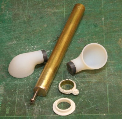

If you haven't seen them before, here are the 3D-printed cowl ventilators I did for a 1:32 Foundation Franklin:
http://www.rcgroups.com/forums/showthre ... st15413788
I also make them available through Shapeways... linked from:
http://matthewsmodelmarine.wordpress.co ... del-ships/
File comment: 3D printed cowl vents
File comment: Hybrid construction

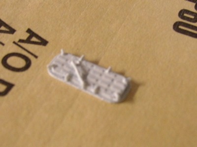

Richard- The material matters not at all! If you made it, it's scratch built. If you bought someone else's bits, it's not.
The door models look great, but don't expect too much from 3D printing. First, fine details may not be printable... anything under 0.5mm is dubious, especially long skinny structures.
Next, the parts WILL have rough surfaces that require sanding. If the details keep you from sanding the parts, then forget about it!
"Just because it can be drawn, doesn't mean it can be printed!"

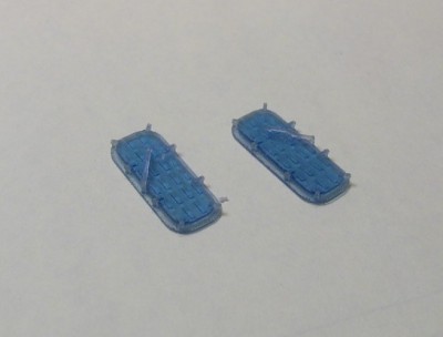

Yes, another thread where actual 3D printing experiences can be documented would be great. But until then, see my post on printing window glazing, where you can see what typical surface finishes look like for a 1:72 scale part:
http://www.rcgroups.com/forums/showthre ... st23504201
Now, this particular material is not the finest for detail, but was the only clear stuff available at Shapeways. Their "frosted ultra detail" does better for detail, but still requires cleaning (it's covered in a waxy/greasy slime), and still some more sanding.
In this case, the very rough clear blanks were sanded and polished to near optical quality... but again, if you can't sand the surface for the included details, than all hope is lost.

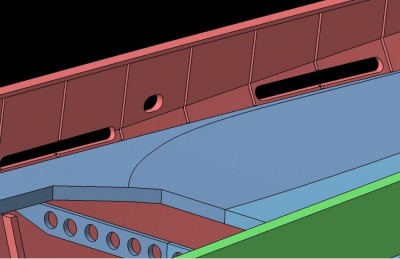

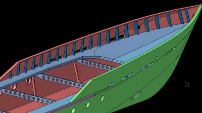

Here's the sort of thing you can do with a good CAD program. I designed the forward bulwark stanchions 0.5mm into the wall of the bulwark/hull. Then the stanchions are Boolean subtracted from the hull, leaving perfect little locating grooves.
File comment: Each stanchion is designed 0.5mm into the 1mm thick bulwark.
File comment: All the stanchions...
File comment: Stanchion subtracted from the hull, leaving precise locator grooves

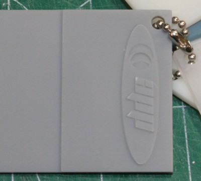

OK, I'm getting ever more hopeful about fine detail parts. I haven't heard back from Nelson, maybe his source isn't publicly available. But I did contact another modeler, TBowman at RC Groups, who has been getting some incredible parts for his large RC scale-sail HMS Scorpion:
http://www.rcgroups.com/forums/showpost ... tcount=128
Those parts come from APP (American Precision Prototypes), and are off of a true SLA machine. Quick reminder, there are several types of 3D Printing commonly available (and others, not so common):
SLA: Stereolithography... a laser is steered around on the surface of a pool of liquid polymer, curing the stuff as it goes. Provides the finest parts.
Inkjet/Polyjet: Just like an inkjet head, but either a photopolymer or a support wax are applied in layers by a printhead. Each completed layer is hardened by exposure to UV light. My experience- depending on the machine and material, can be as bad as FDM (below), or pretty fine (Shapeway's "Frosted Ultra Detail").
SLS: Selective Laser Sintering: A laser is steered around on a box of fine plastic powder (often nylon). Reasonable resolution, gritty porous surface. Often the lowest cost for big parts, needs sanding and filling.
FDM: Fused Deposition Modeling. Squirts out strips of molten plastic, like building parts with a hot glue gun. The worst for resolution, might be ok for 1:6 scale wicker chairs.
So I got a sample set from APP of a bunch of their materials, some photos below. I wish they had printed round or angled parts... surfaces square to the machine tend to come out the best, but the real test for the "jaggies" is a rounded surface.
Nevertheless, the Acurra Xtreme SLA material that TBowman used looks fantastic... really, no visible strata, virtually like an injection molded part. This has promise.
