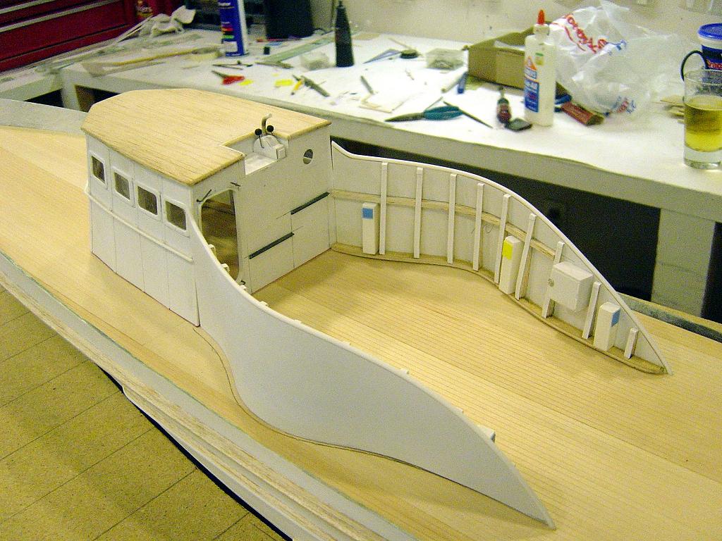

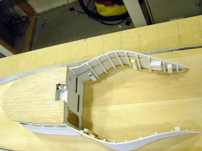

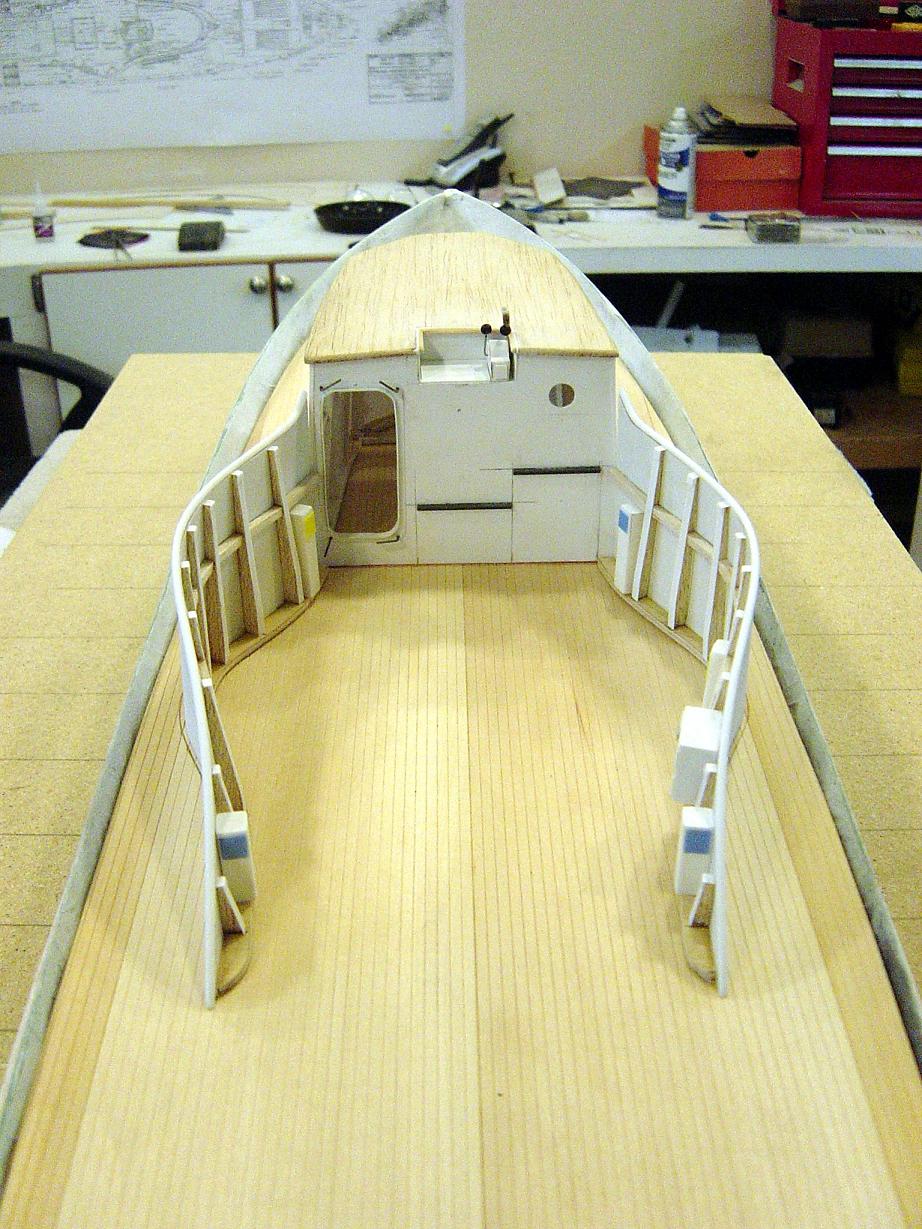

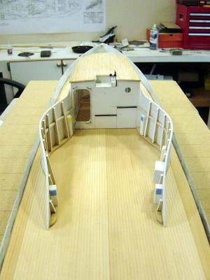

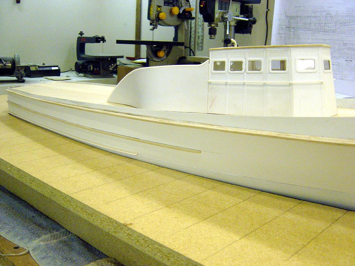

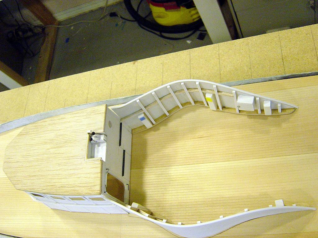

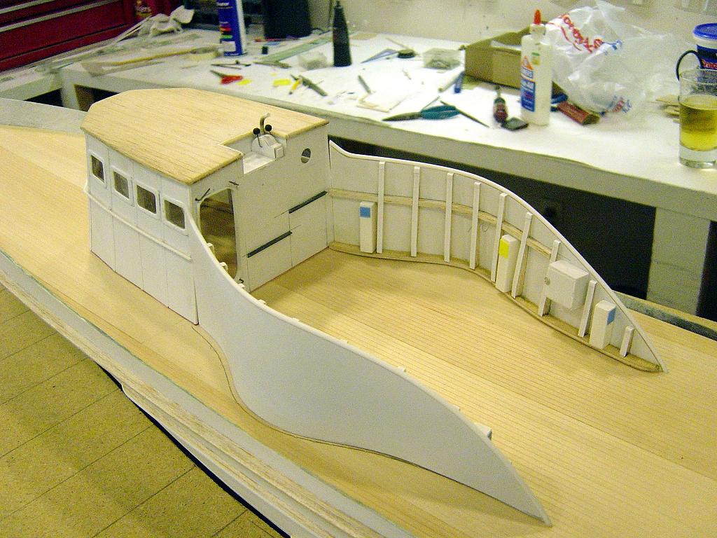

File comment: View of the spray shields from port side. First order of business was to form the base of the shield. This was fabricated from 1/8" aircraft plywood using a pattern I made directly from the plans to get the correct shape. The shields are an odd structure. Lots of compound curves. Once the bases were completed, I formed the actual shields from 1/32 veener. This piece was then sandwiched between a layer of .015 styrene on the outside, and .010 styrene on the inside. The shield was then attached to the base, angling in slightly to conform with the pilothouse. Next, the horizonal braces were made with 1/16" balsa and the capped with 1/8" x .010 styrene. I then added the cross bracing which is 1/8" balsa stick. Next, a cap was added on the top edge of the shield using 1/16" styrene rod. Lastly, I added the vents and other items using balsa wrapped with styrene. Small colored squares on vents are vac formed louvers I made.
File comment: I have added the deck planking which is 1/32" scribed basswod. This was overlaid on the previously fabricated 1/16' balsa deck, using hi-strength contact cement. Note the spray shields.

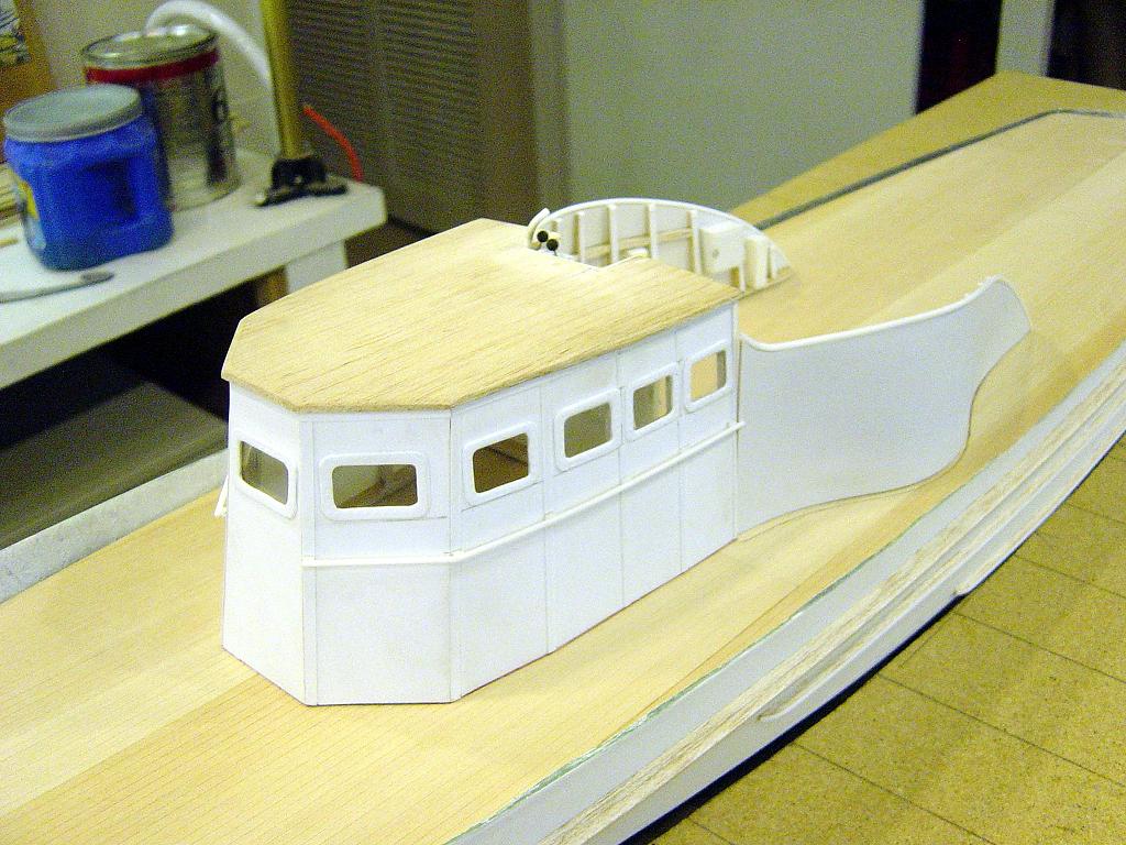

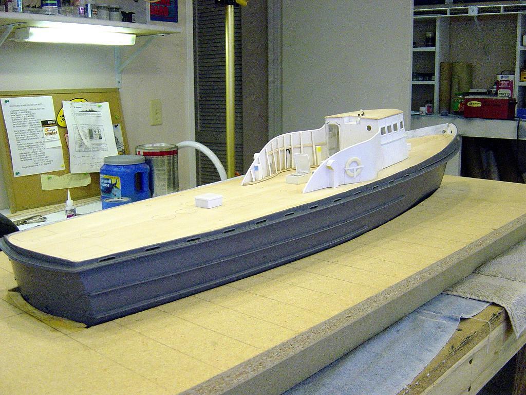

File comment: Overhead view here. Pilothouse, shields and deck are all dry fit for now. Small box you see on the right is signal gun compartment.

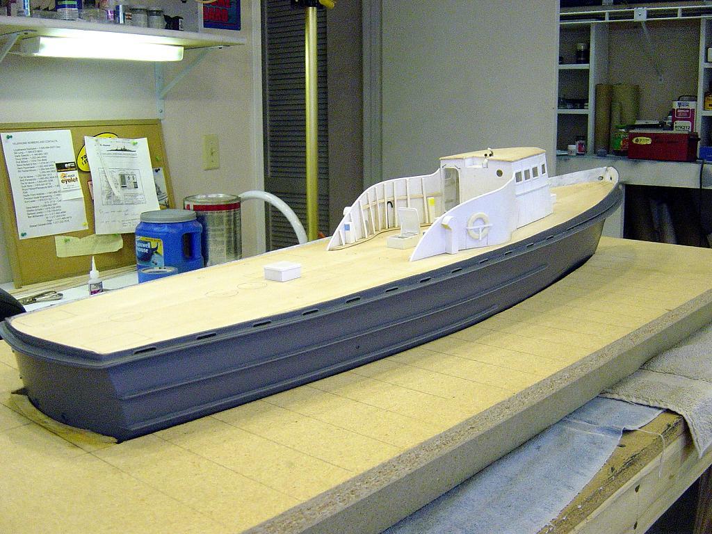

File comment: View from portside.
File comment: View from stb. Note rub rails or guards nearing completion.

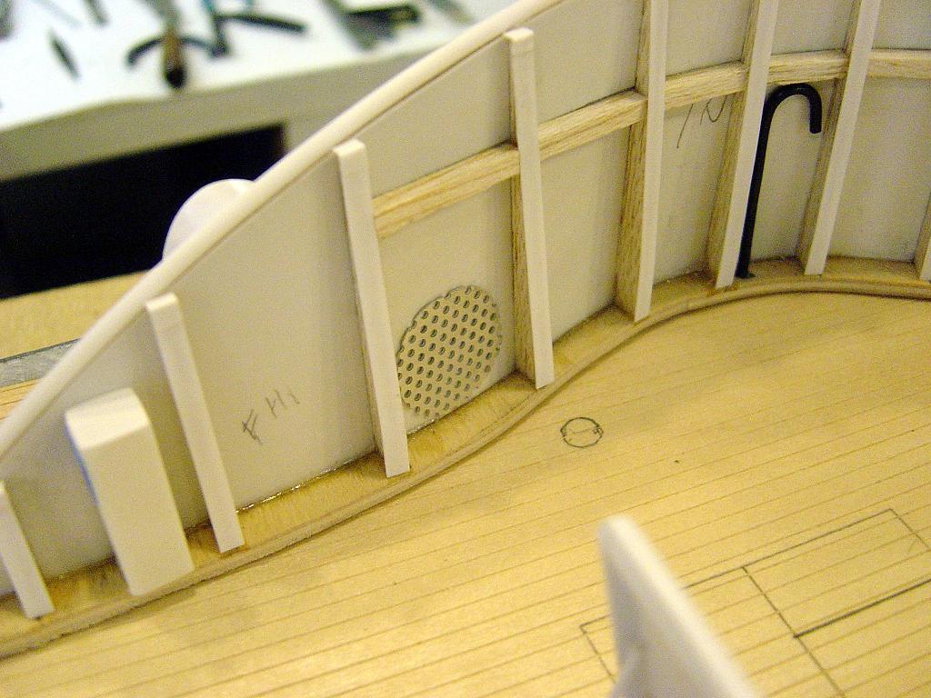

File comment: Here more details added. Scuttle grating made from perforated aluminum. Gooseneck vent for officers toilet made from wire. There are three scuttles on the deck, 2 aft and 1 fwd. During hot weather, the scuttle plate was removed and the grating put in its place to help circulate fresh air through the boat.

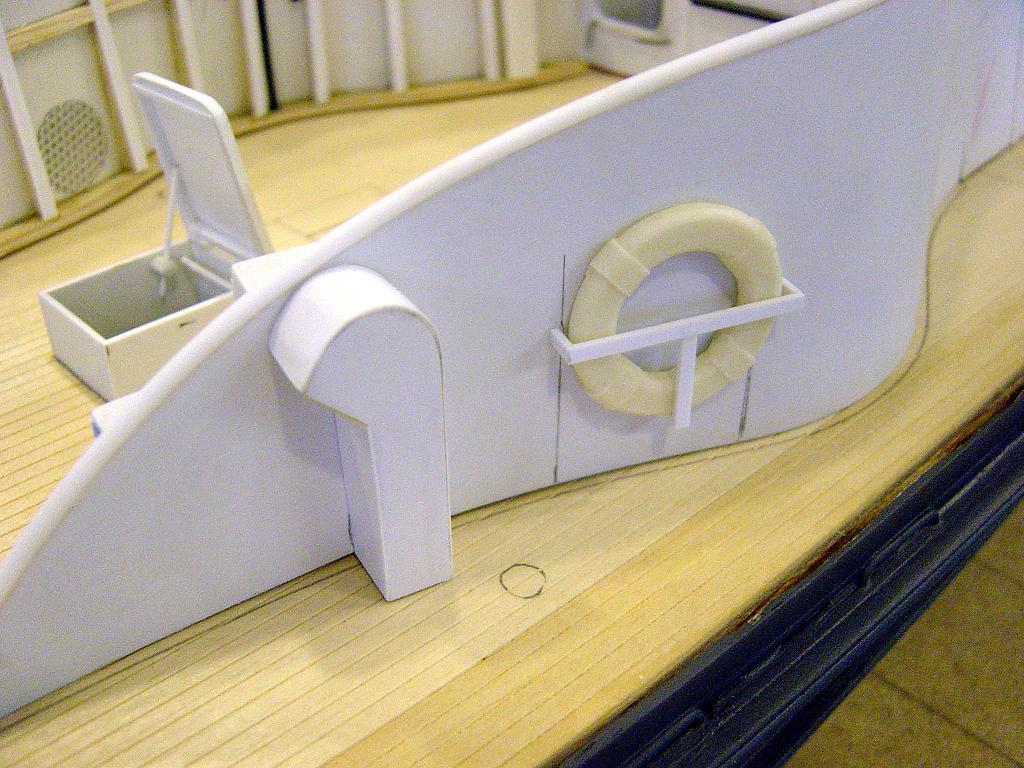

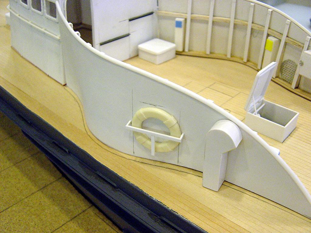

File comment: More details added here. Life preserver is cast resin. The holder is styrene strip. Vent you see is engine room blower exhaust, made from balsa block and again wrapped with thin styrene. They had to run the exhaust blowers for engine room for at least 10 minutes, except in emergency situations. Note the forward engine room hatch, open.

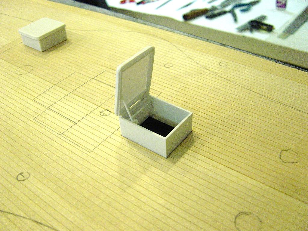

File comment: Close up of the fwd. engine room hatch. Made again from styrene. The lid was vacformed, then support added inside.

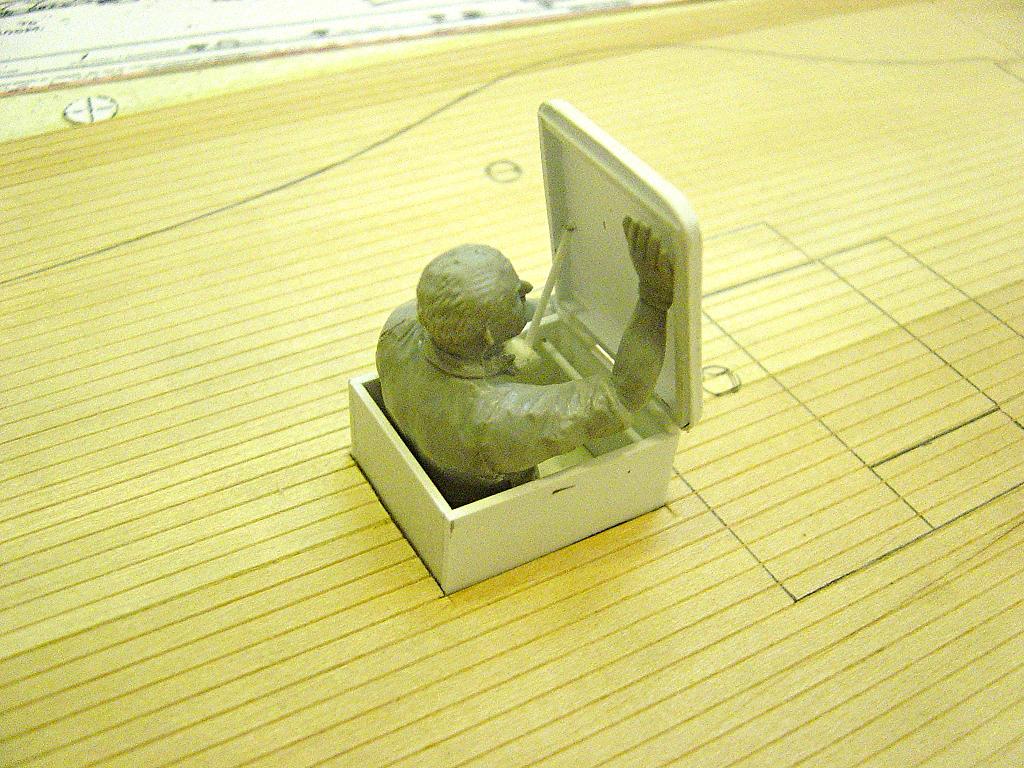

File comment: The boat will be waterline with figures. Heres our engineer coming out of engine room. Modified racing car pit crew figure.

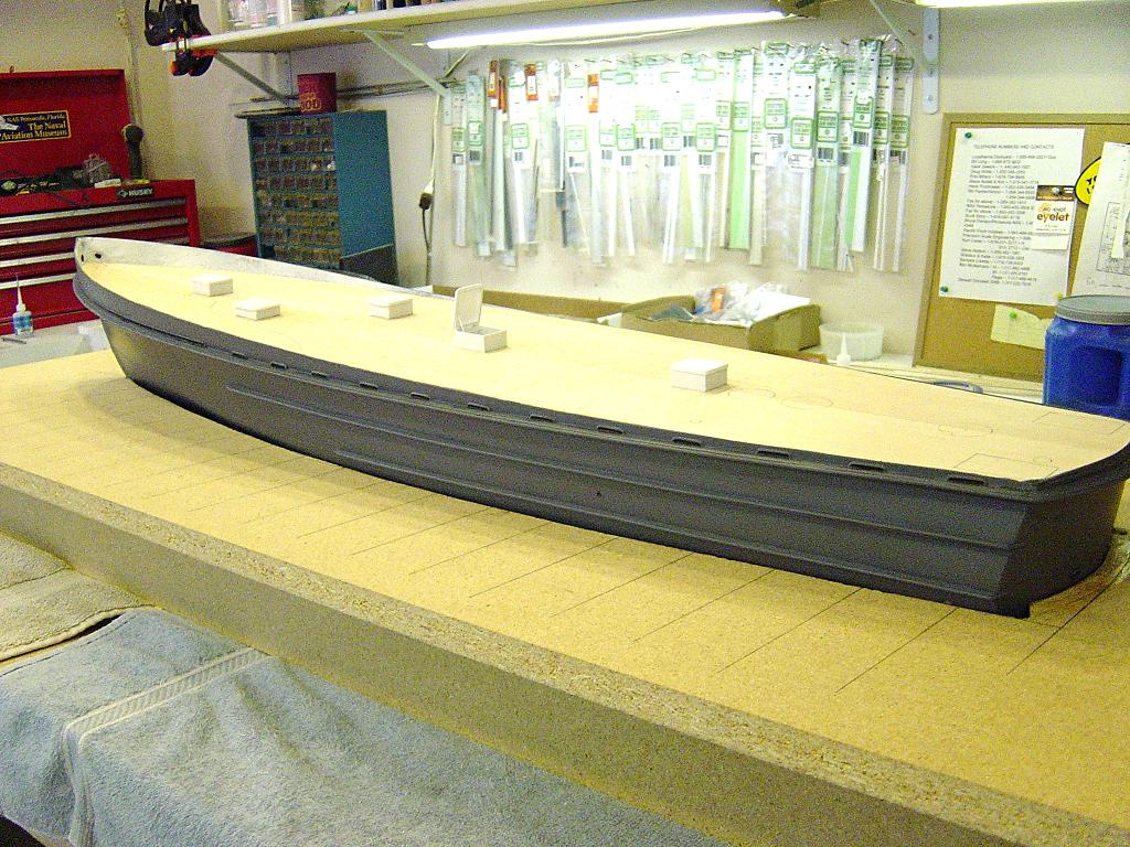

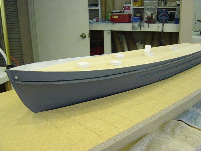

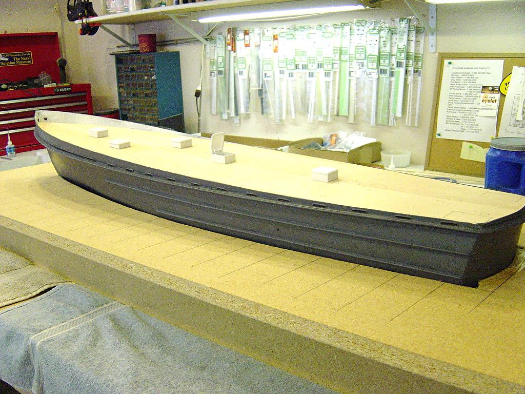

File comment: All rub rails now completed and I have added the scupper openings and anchor hawses. Hull has been sanded and primed. All deck hatches installed.

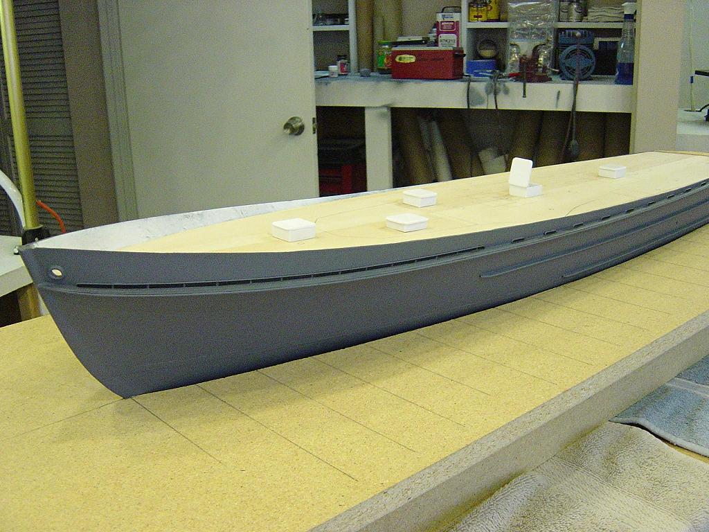

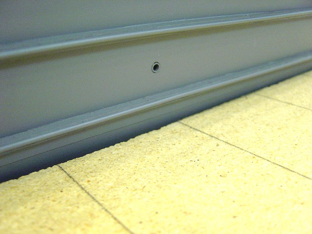

File comment: Another view here from port. Small hole in side of hull is generator discharge, both sides.

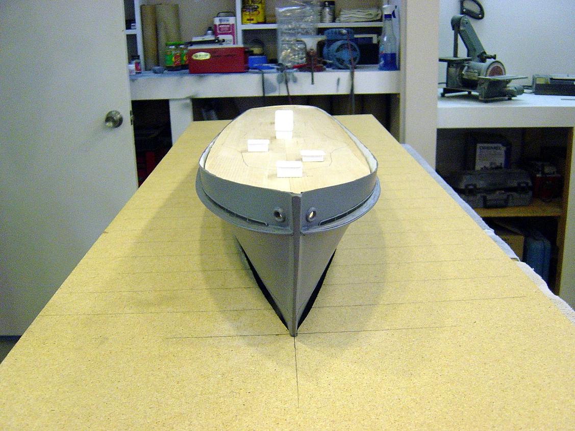

File comment: Bow-on view. Anchor hawses are vacformed.

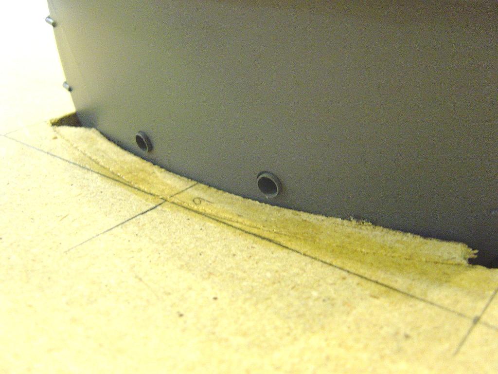

File comment: Generator discharge outlet. Small gas engines drove generators. 1/8" alum.tube used here.

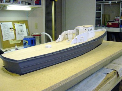

File comment: Overall view from stb. of progress so far.
Well, there you have it......another update. Starting to look like a patrol boat. 1/24 scale is big compared to 1/96. A learning curve for me. Not much room for error.....Stay tuned.....More to come.....I continue on.......... :wave_1: :thumbs_up_1:

you have been busy Bill, as always top notch workmanship :thumbs_up_1:
Love the curved spray shields :woo_hoo:

I like those sinous curves of the spray shields.

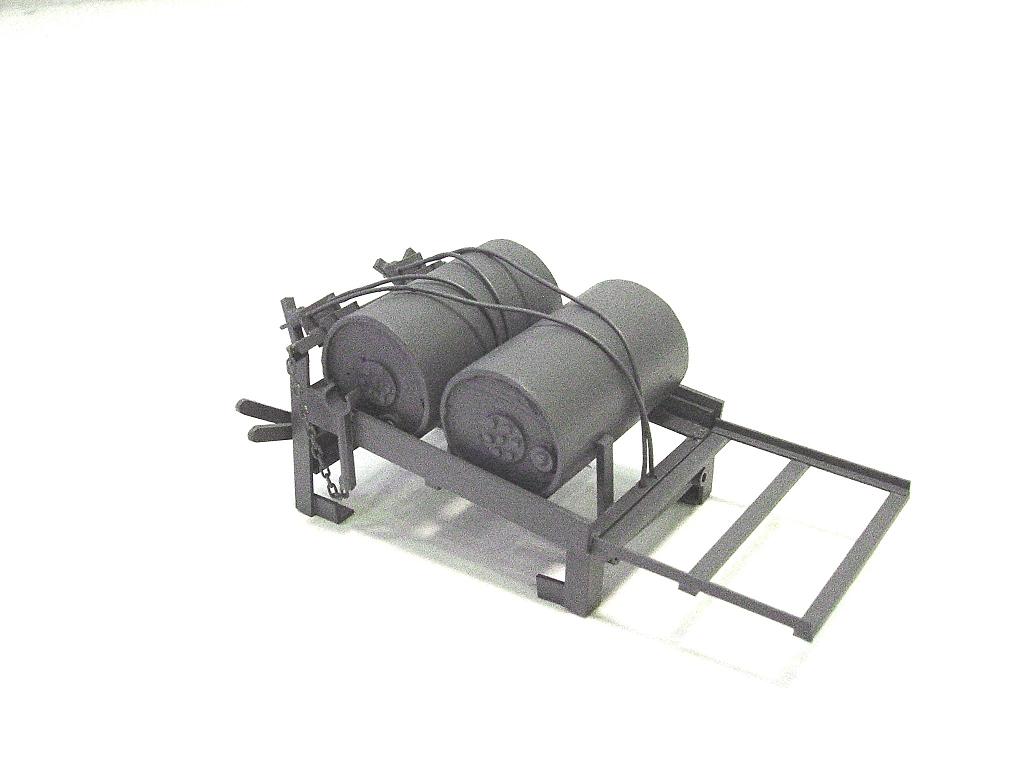

Hello again all! :wave_1: Work continues on the 83. Now that the pilothouse and shields are fabricated for the most part, I decided to move on to some of the weapons carried aboard. Namely, the depth charges and racks and the 7.2" rocket projectors, commonly known as "mousetraps". More work has been done on the pilothouse as well as the rest of the boat, so lets take a look..............

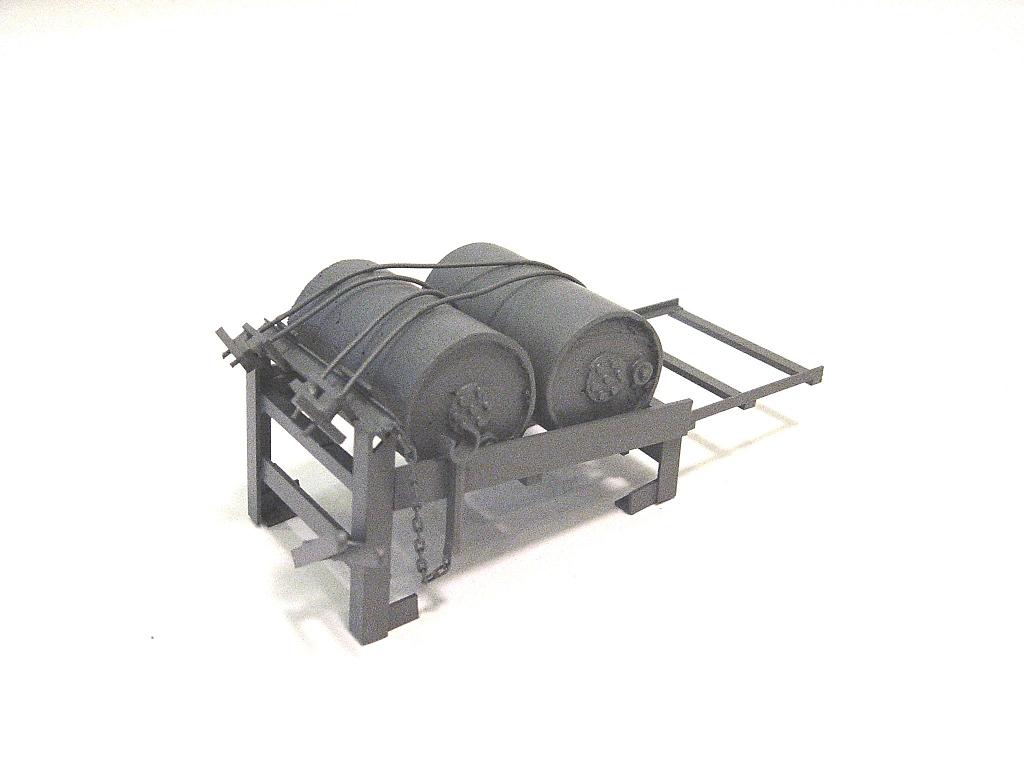

File comment: Here is one of four depth charge assemblies. There is one port and one stb. about midships, and two aft. These were fabricated from various sizes of strip and angle styrene, utilizing photos and drawings as a guide. The charges are cast resin from "Macs Mouldings" of the UK. Cable stays are thin steel wire. There are 53 parts to each assembly. This is one of the aft racks.
File comment: Another view here. Note the wrench hanging from small chain. This was used to set the detonation depth for the charges. Also note the extension to the right of the main rack. These folded up during normal operations, and were lowered for an attack run so charges would clear the hull.

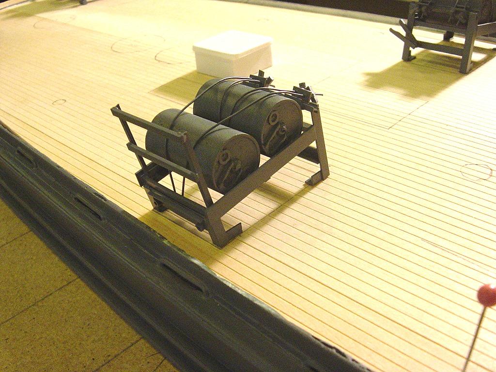

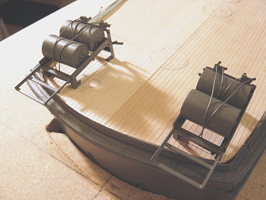

File comment: The aft racks in their relative position. Again note the extensions.
File comment: Rack on stb. side. It will be closer to the bulwark at final installation. Note the extension now in the up position.

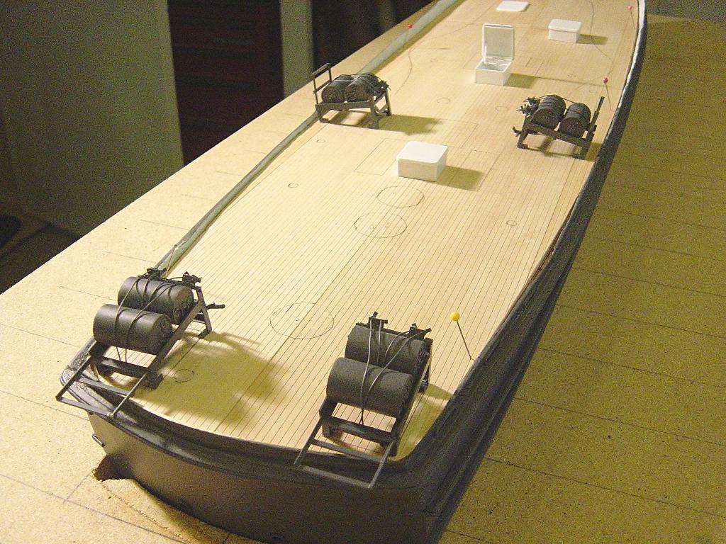

File comment: An overall view of the depth charge arrangement, again in their relative positions. All four racks are basically the same, except for the position of the extensions. Note the slight deck camber.

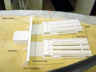

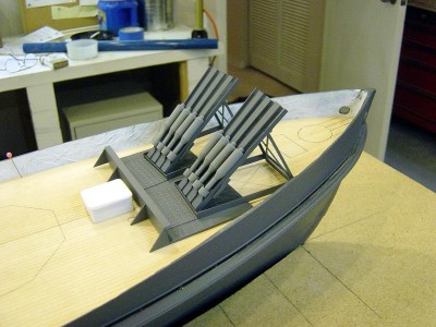

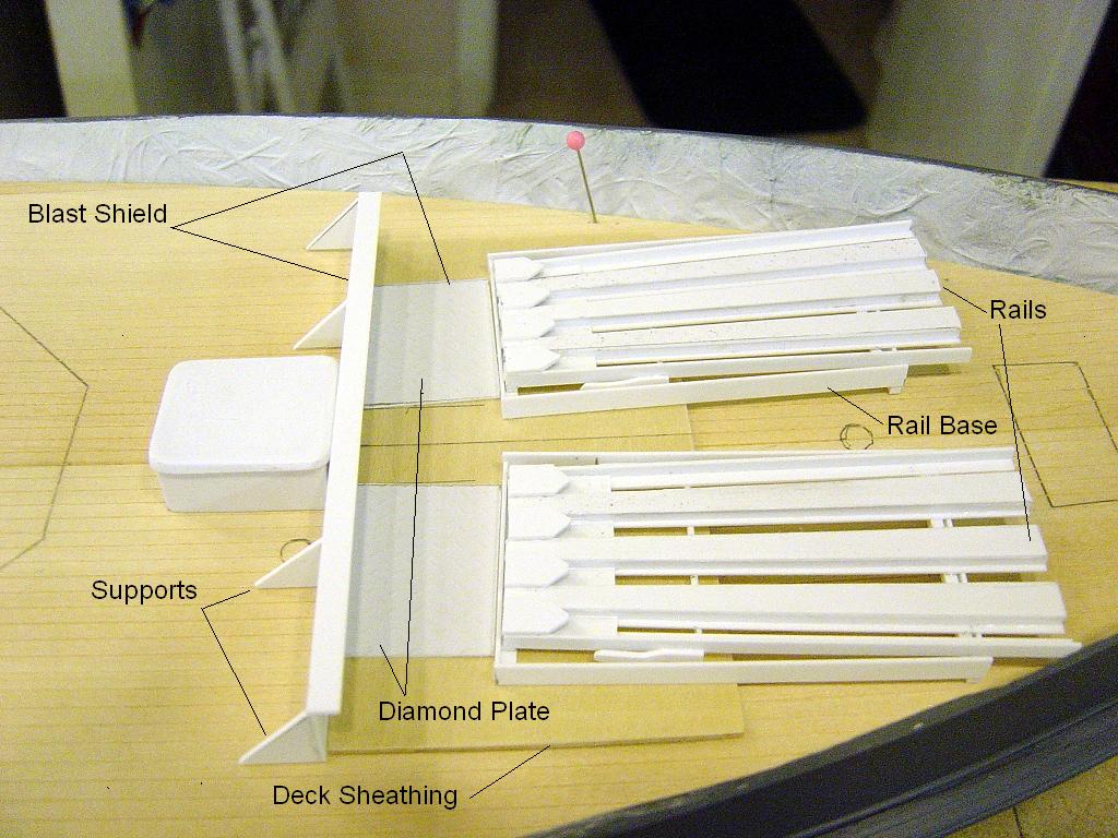

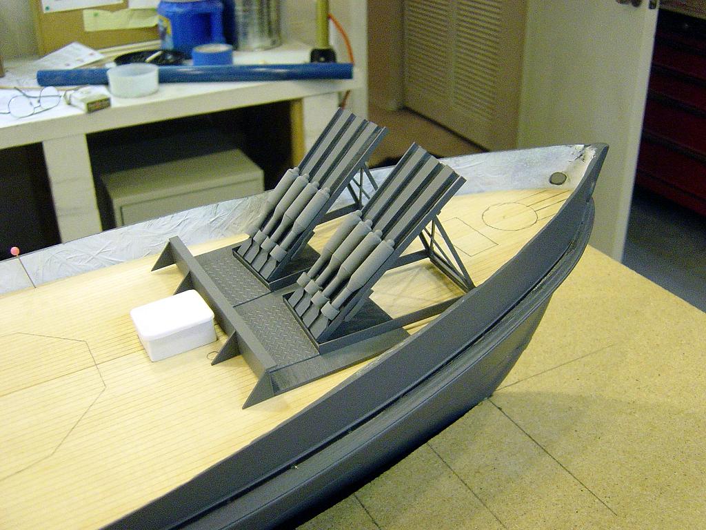

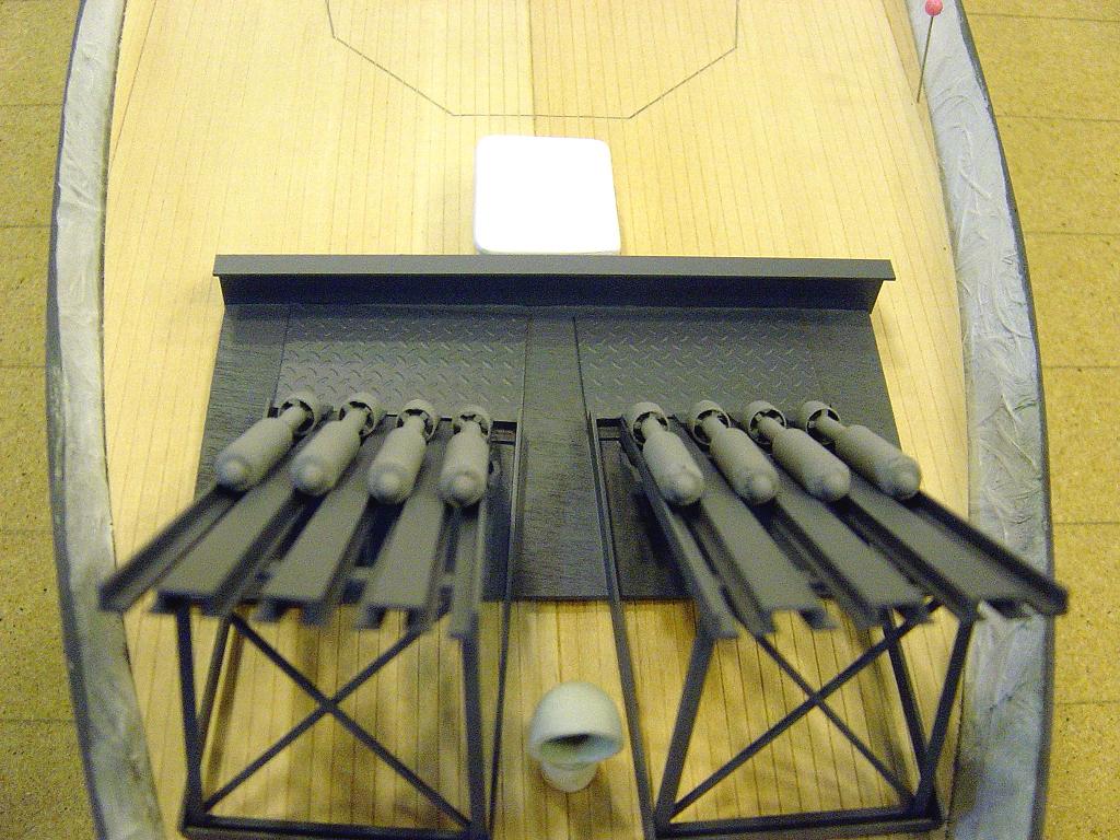

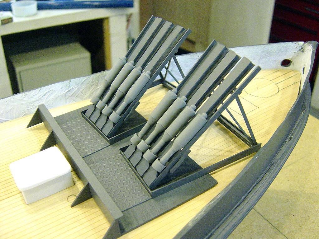

File comment: A shot of the 7.2 rocket projectors. Let me give a brief rundown on these........At the beginning of WW2, the standard anti-submarine weapon was the depth charge. One useful development for this type of weapon were called "projectors" - devices which could throw a pattern of depth charges ahead of the attacking ship, thereby avoiding the time lapse between the detection of a submarine at some distance and the actual attack.The US Navy's standard projector was the "Hedgehog" from 1942 onwards. This was reasonably effective, but the large recoil prevented its use on smaller craft, I.E., patrol boats. The solution was a rocket propelled depth charge. Enter the Mousetrap. this was a standard hedgehog charge fitted to a 2.25" solid propellant rocket motor. The name "mousetrap" was derived from the launcher, which was simply four steel rails mounted at a fixed angle, about 2 degrees, to the ships deck. The rails were raised or lowered manually. On small craft this system was used until the end of WW2. Range was about 300 yards. Photo shows assemblies pretty much finished. A bit more fine tuning on the rockets themselves.

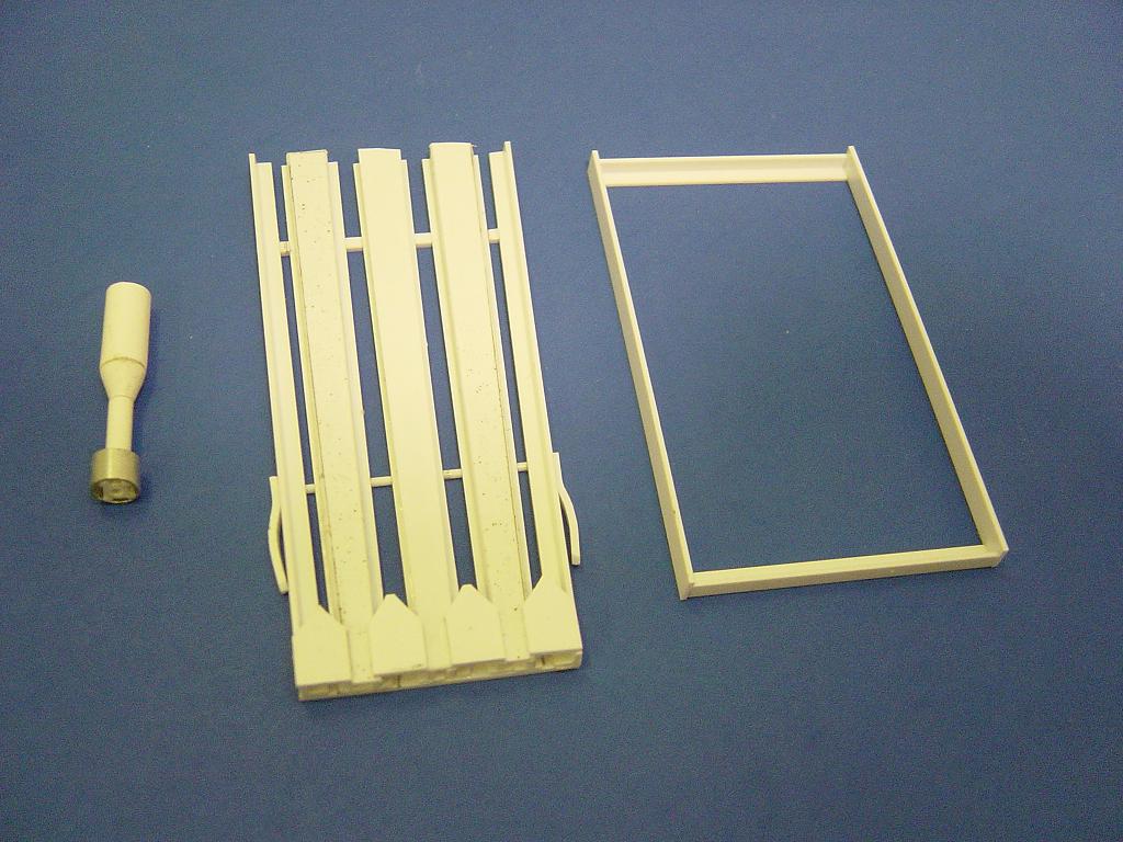

File comment: Heres the three main parts to the assembly. On the left the rocket ,not completed. Middle shows the rails and to the right is the rail frame. All styrene used here.
File comment: Heres a breakdown of the further assembly. Note the rails in their lowered position.
File comment: Another look at the completed unit.

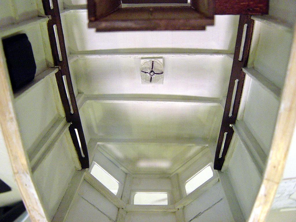

File comment: More details added to the inside of the pilothouse. I have added grabrails made from 1/16" balsa, and the cabin light which was vac-formed from the head of a upholstry tack. Black box to the left is a heater.

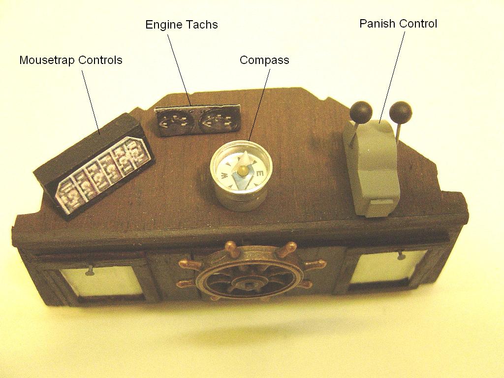

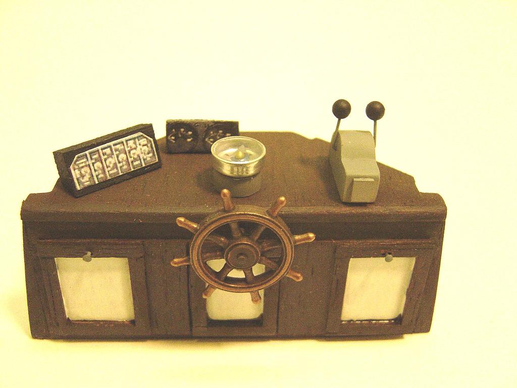

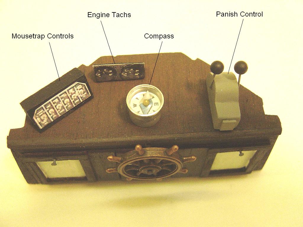

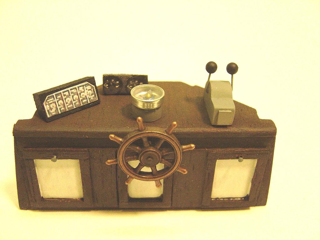

File comment: The 'bridge" inside the P/H. Cabinet is balsa. Wheel is a brass casting. The guages and controls are made from aircraft inst. panel photos I reduced in size to fit. Compass is real! Knobs on doors are just sewing pins.
File comment: Heres a breakdown of things.

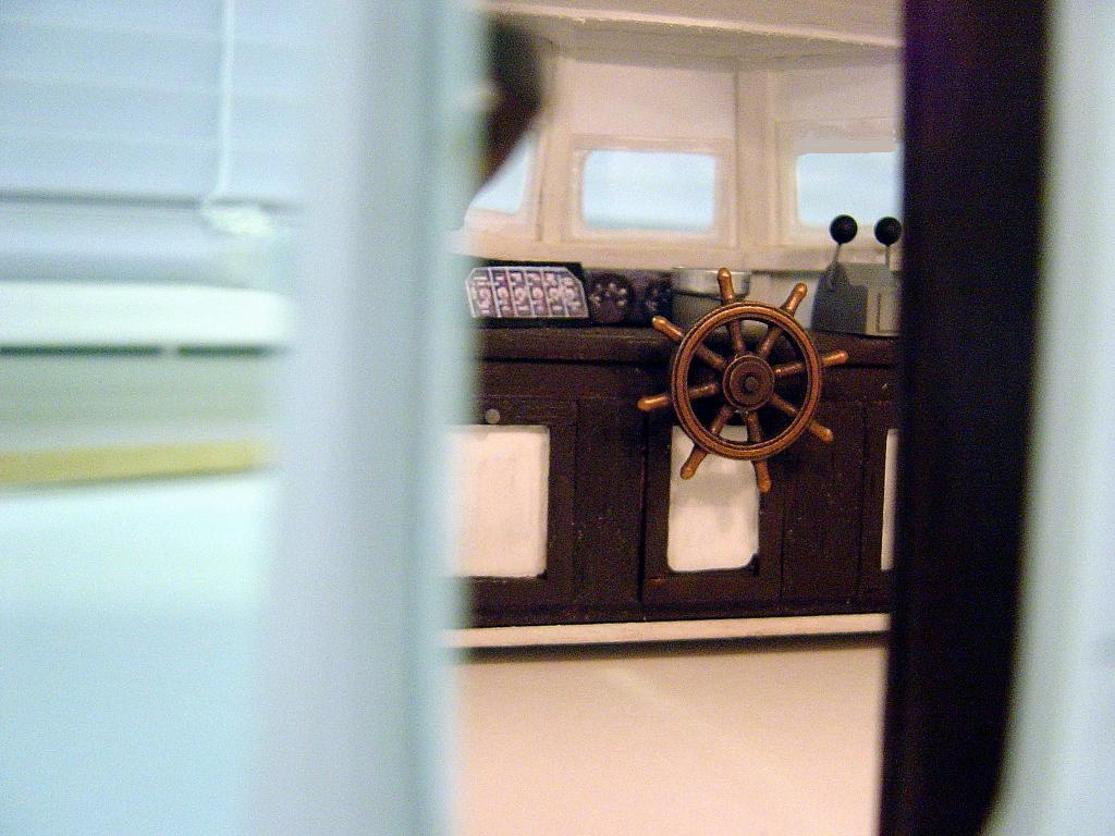

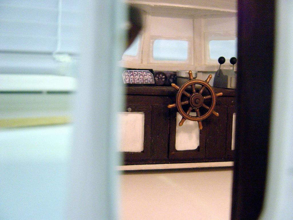

File comment: Inside bridge now mounted. This view is looking through w/t door on P/H. I have added lights to the inside to see things better when replica is displayed.

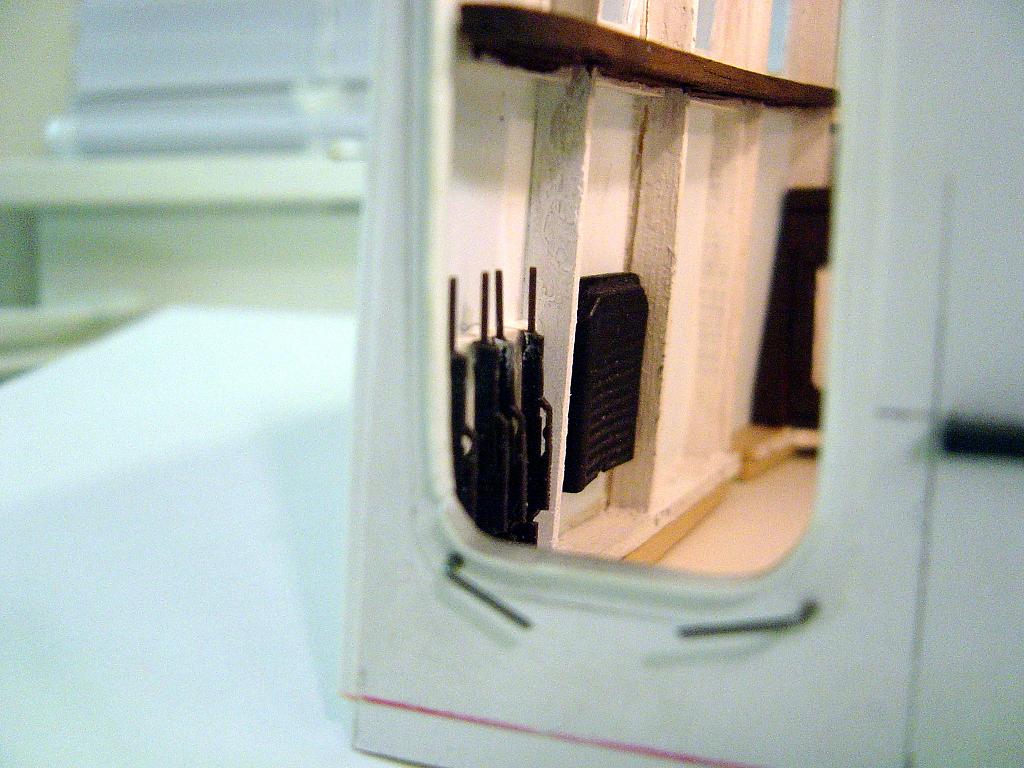

File comment: Machine gun rack added next to heater.

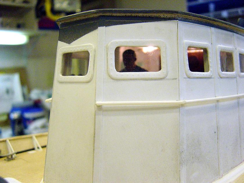

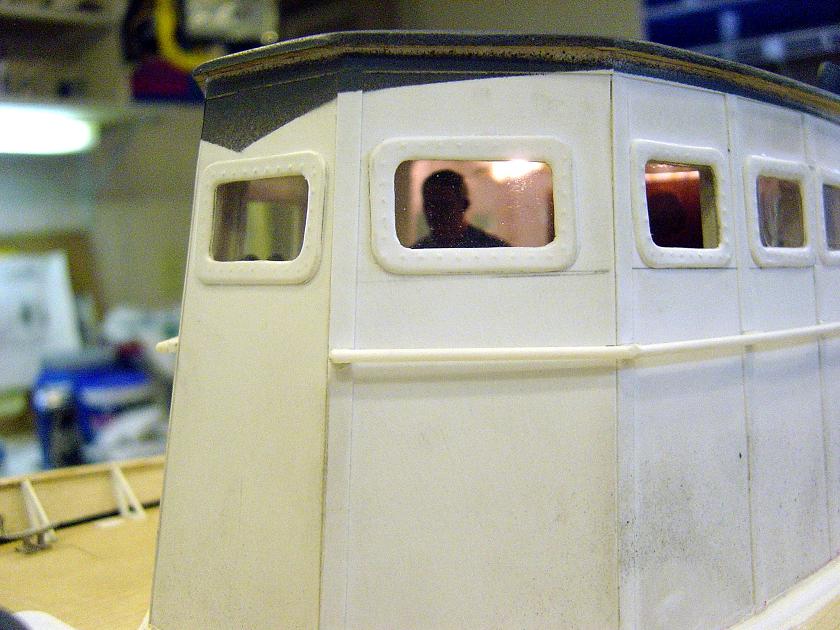

File comment: Crewman now inside P/H.

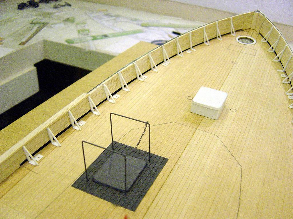

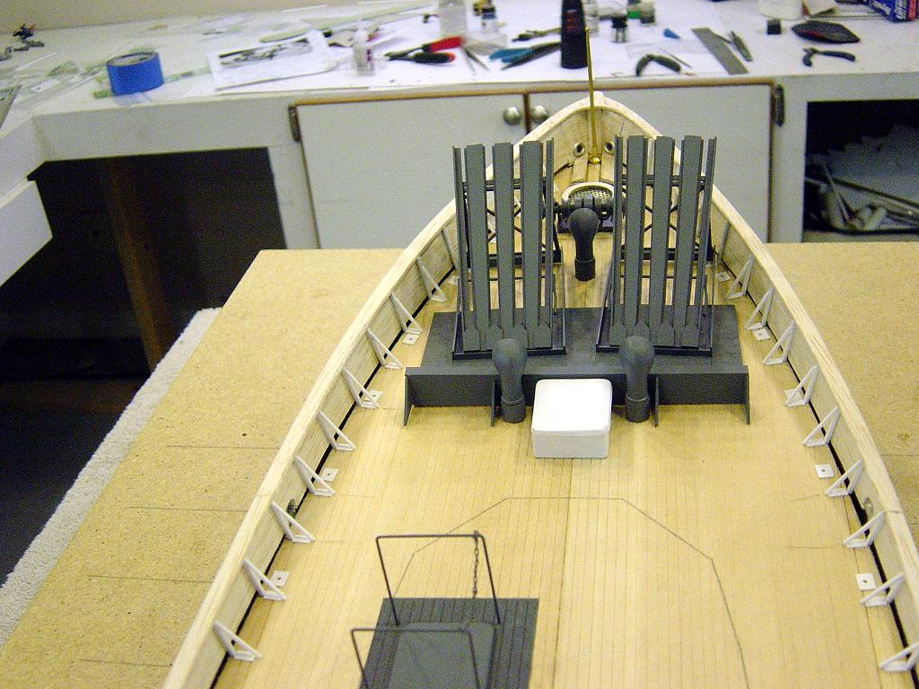

File comment: All bulwark supports now installed as well as the bulwark cap. Here you can see the relative positon of the mousetraps. I have also added the winch, some vents and other details.

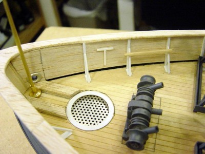

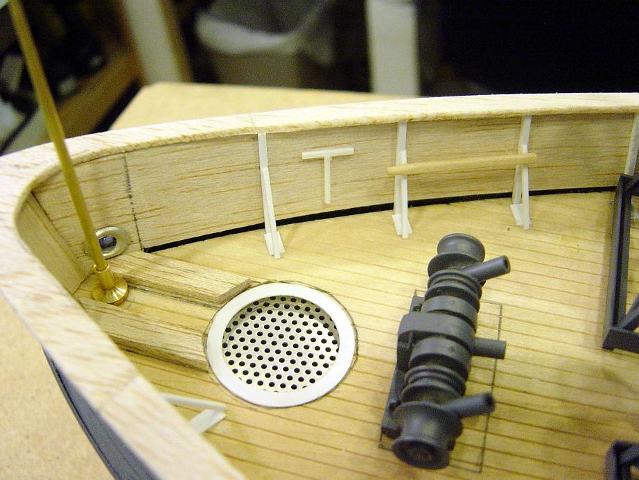

File comment: A close up here of the bow area. Small T is a scuttle plate wrench, to the right of that is the winch handle, they were manually operated. Also added hawse lips and skid plates for anchor lines. Forward jackstaff is turned brass. Scuttle grating is perforated aluminum.
Well, thats it for this update! Things are moving along. Stay tuned......More to come....I continue on........... :wave_1: :thumbs_up_1:
File comment: One more view. A little more detail yet to be added, but you get the idea.

Bill The quality of your workmanship is simply stunning . I very much like the way you have built up the rocket projectors .
