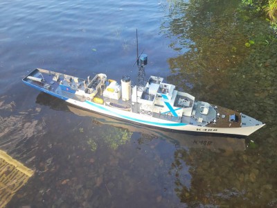

Here she is on the lake this evening doing a ballast check.
362501608_6580558132023107_6520100662192716029_n.jpg [ 251.21 KiB | Viewed 594 times ]
All that's left is a flag and the name plate!
363793395_1425121855001702_8303165598163513109_n.jpg [ 154.73 KiB | Viewed 594 times ]
363319420_591692779805749_9203411171839391157_n.jpg [ 223.33 KiB | Viewed 594 times ]
