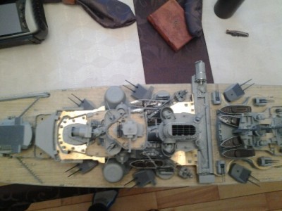

Got some detailing done on the front deck

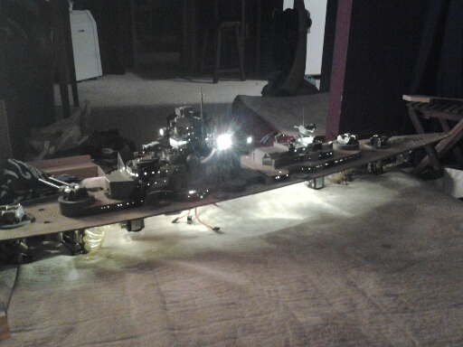

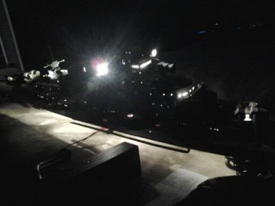

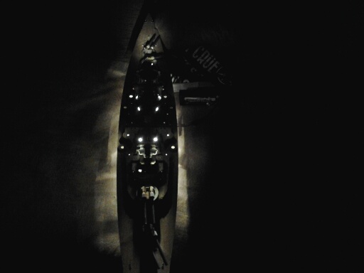

couple of pics of the led lighting, all search lights work and the little port holes all illuminate

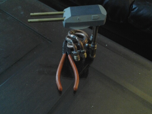

hears a picture of the main guns before they were installed, the coiled magazine is visible

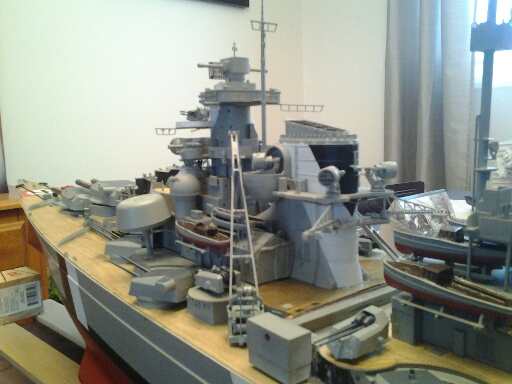

The attachment 20160103_145347_resized.jpg is no longer available
detailing pretty much done, the weird globs on either side of the forward superstructure is the 2 antenna for the for and aft range finder cams
