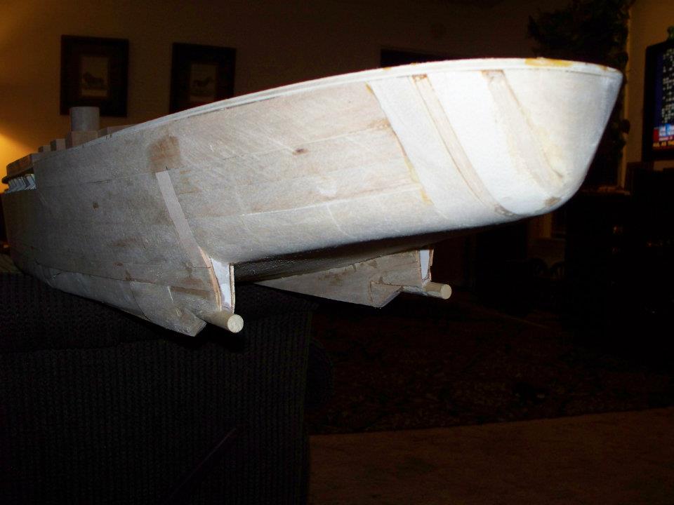

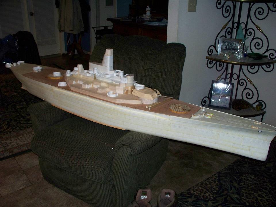

Sort of a jump now in the hull construction. I have covered the framing with two layers of 1/8 balsa sheet. bow and stern are shaped with solid balsa block. I used body filler for final shaping.

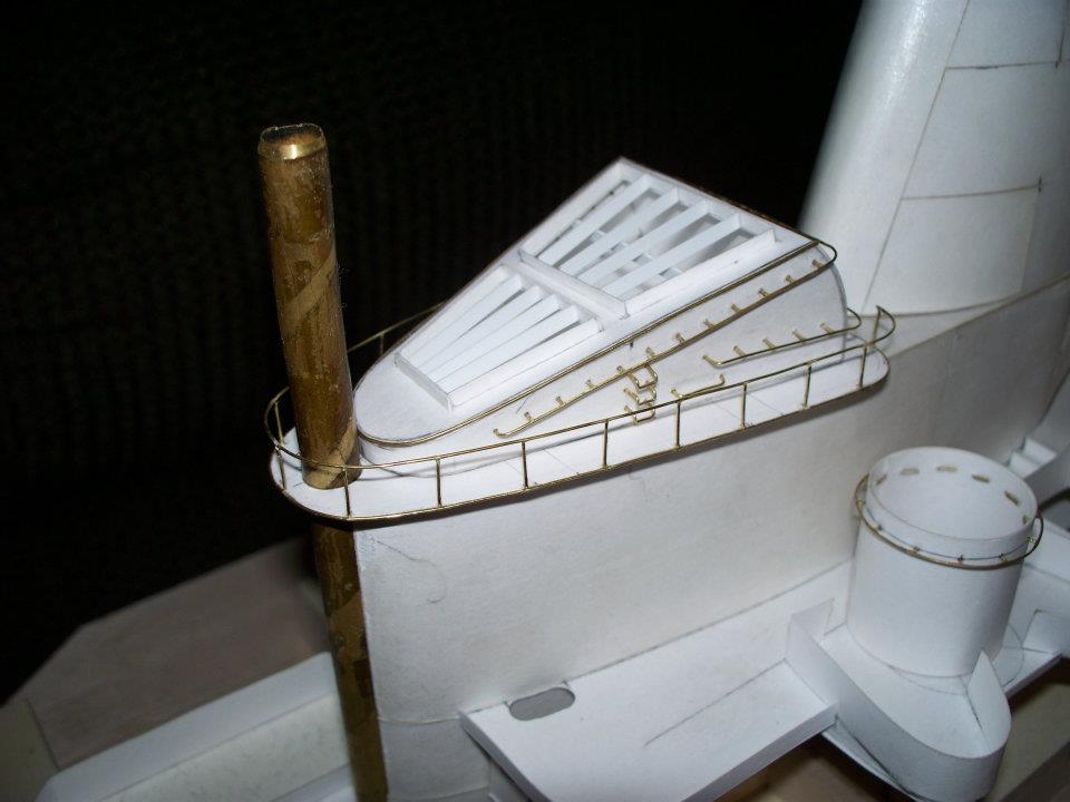

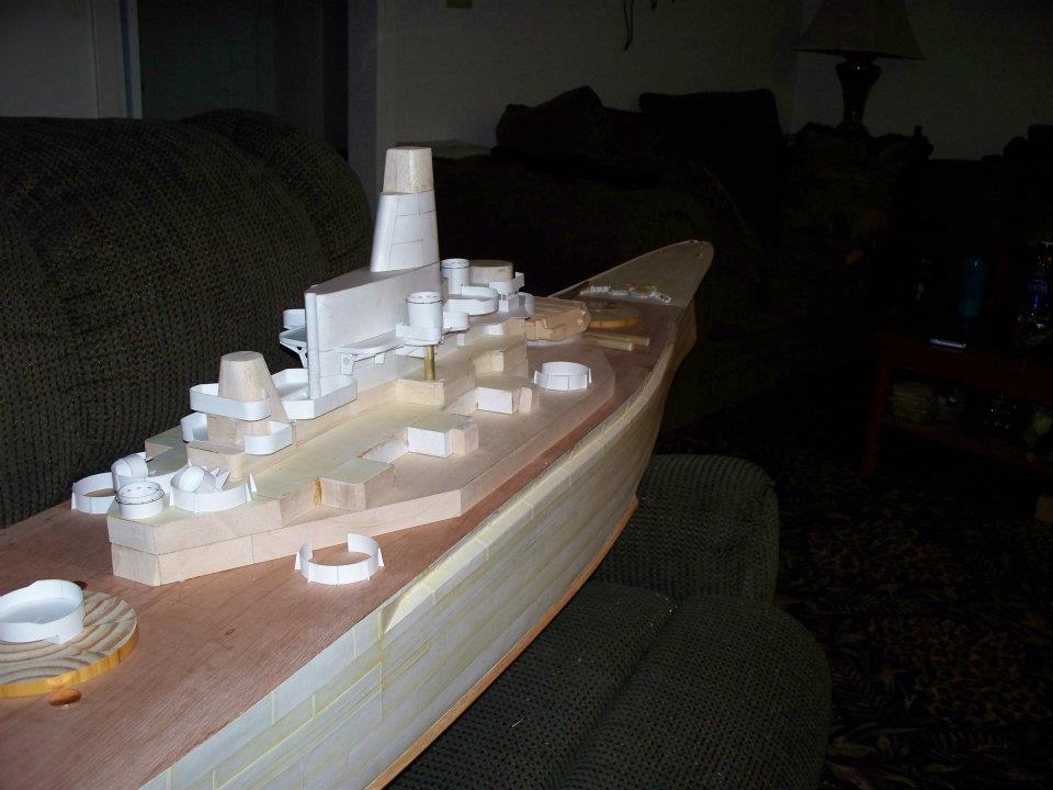

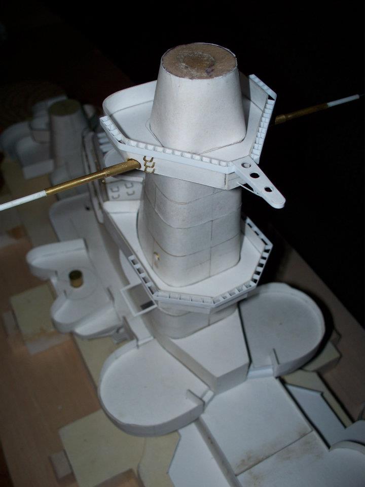

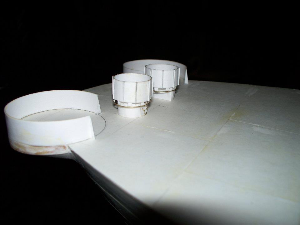

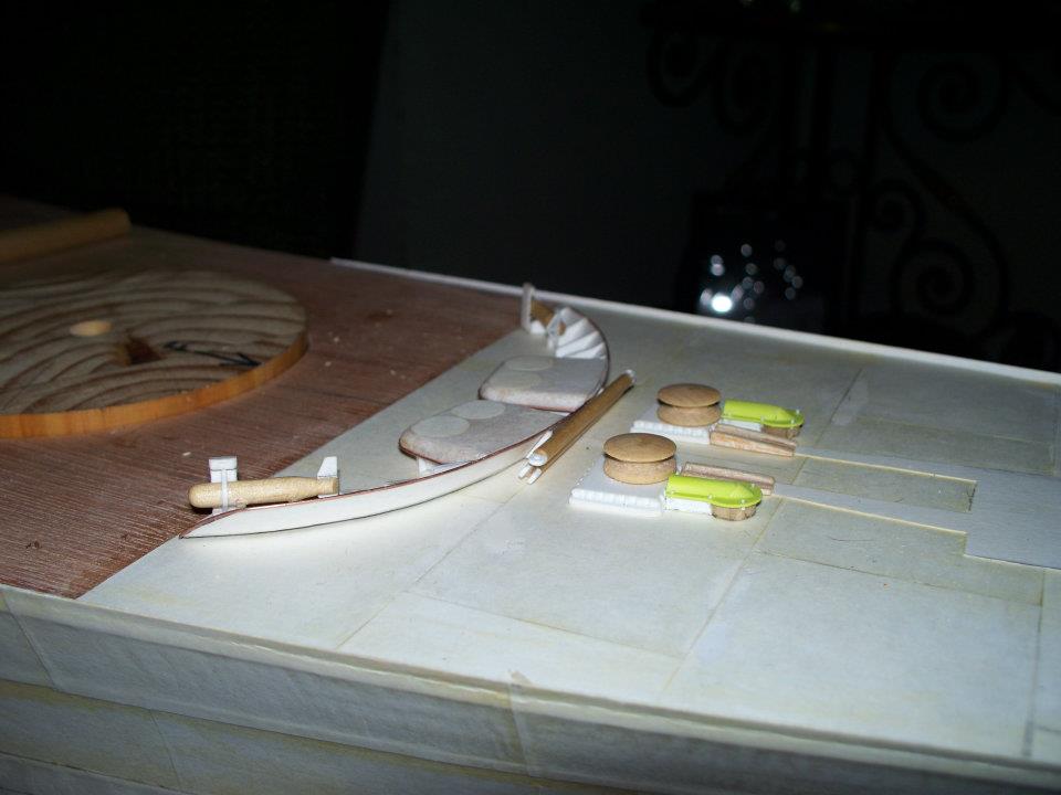

Now on to some early superstructure construction. I used 1 inch thick balsa planks for the dack levels. Again used card stock for plating and fabrication.

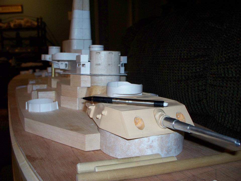

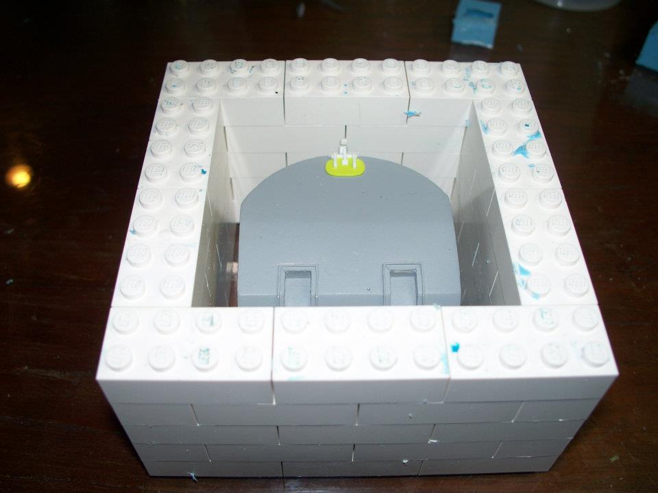

The 5 inch guns. I made a master and cast these myself from resin. The barrels are from B&D barrels. Ladder rungs were made from staples.
File comment: The master

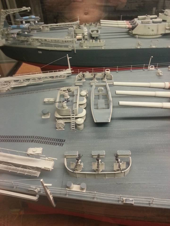

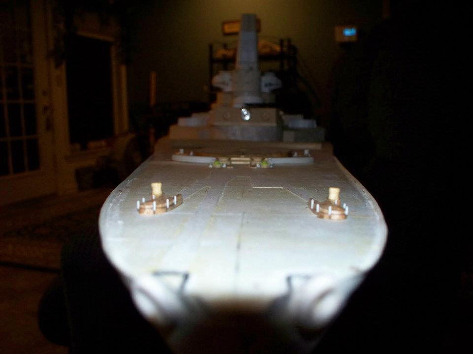

Some main deck detailing and painting.

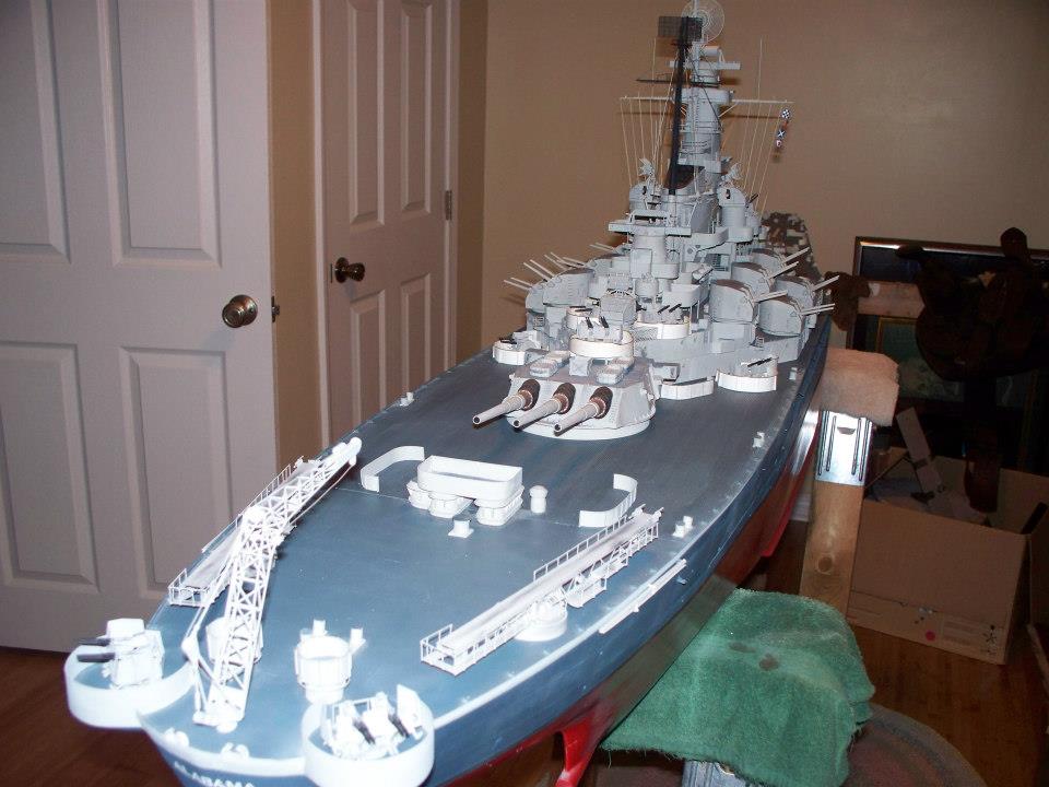

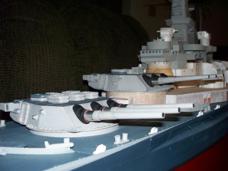

The main guns. Like the 5 inch turrets I made a master and cast these myself, Each one took 16 ounces of resin to cast.

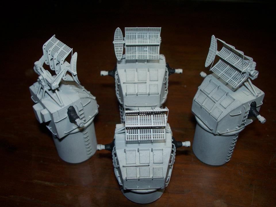

The MK 37 directors. I made these myself as well. The radars are JR Haynes.

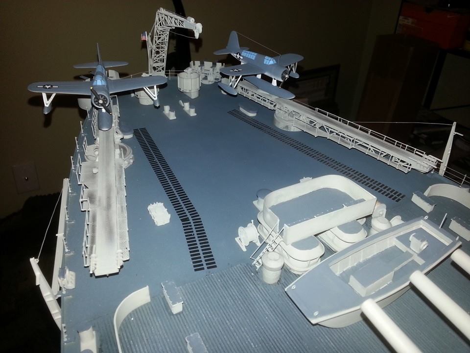

Now just some oddball small items.
File comment: Aircraft crane made from soldered brass wire.

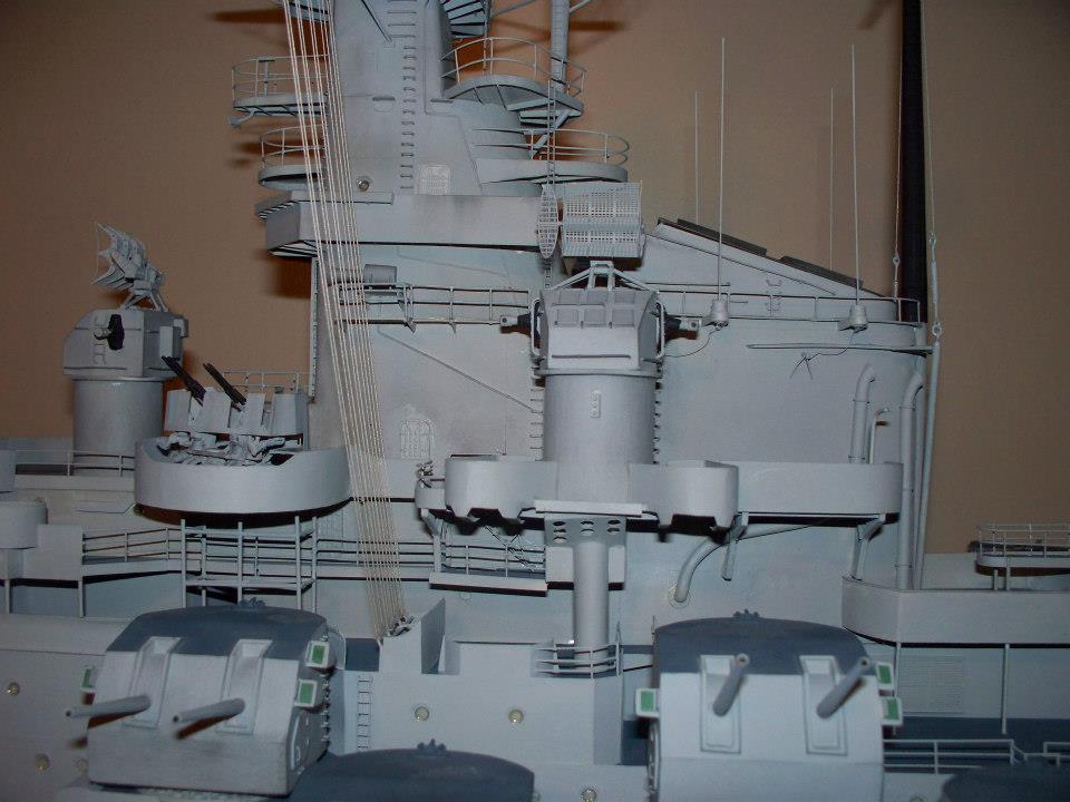

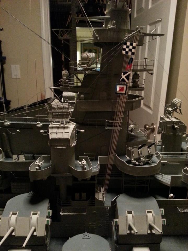

Moving back to the superstructure construction and detailing now.

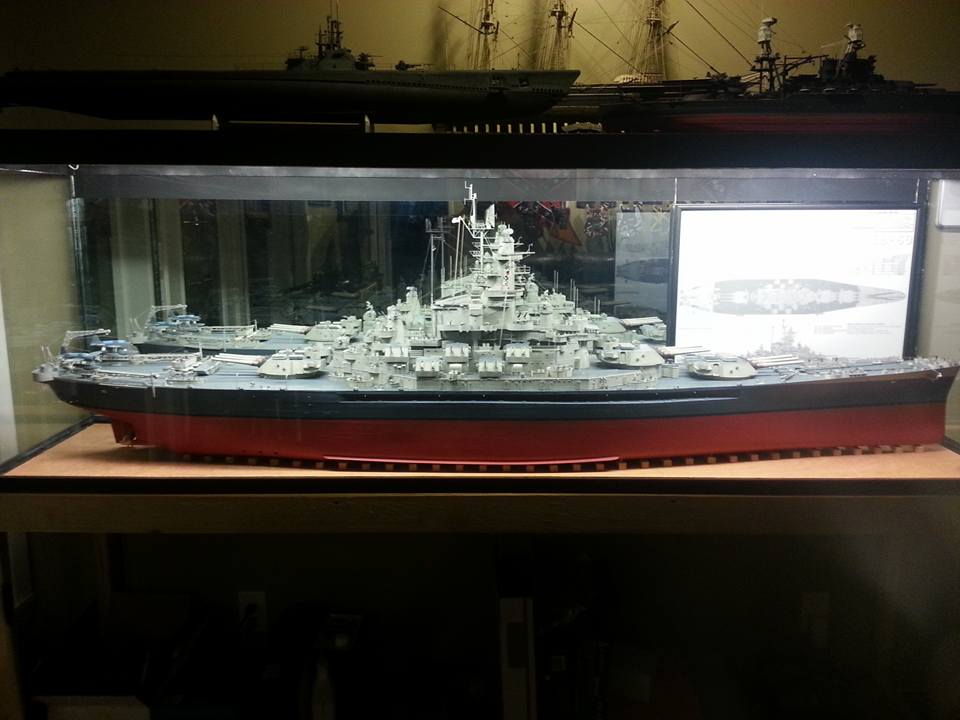

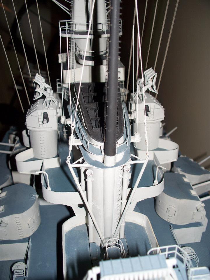

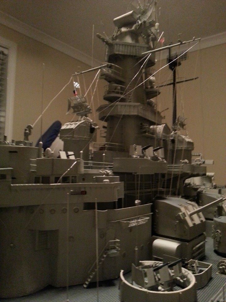

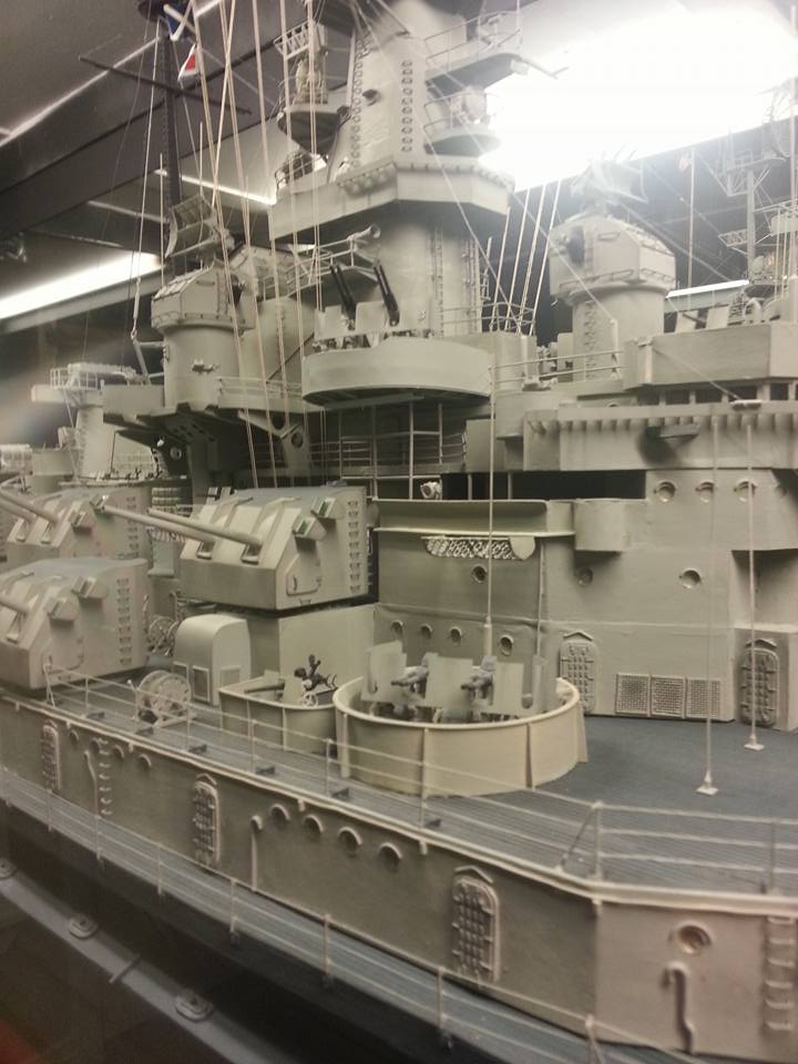

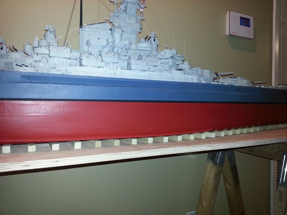

The rest of these pictures will be the completed model and building the stand

A few more

Under glass finally

Last pictures
