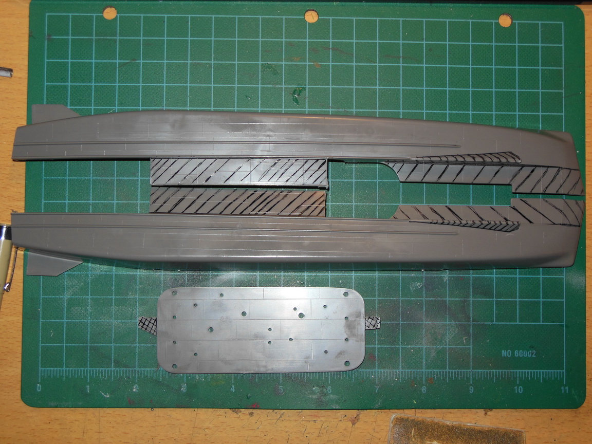

File comment: The hull halves marked for parts to be removed
File comment: The hull with the deckhouse and ramp extensions removed

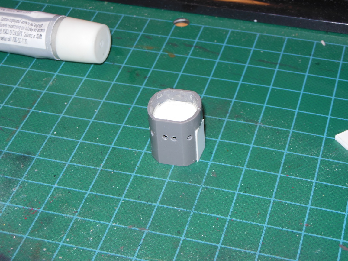

File comment: The bridge... The kit had a flat top but the flying bridge floor was lower than the edge of the top of the conning tower...

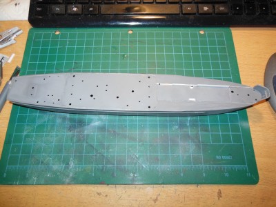

File comment: The hull with the decks, deck house roof and fordeck installed as a base for the styrene deck to come...

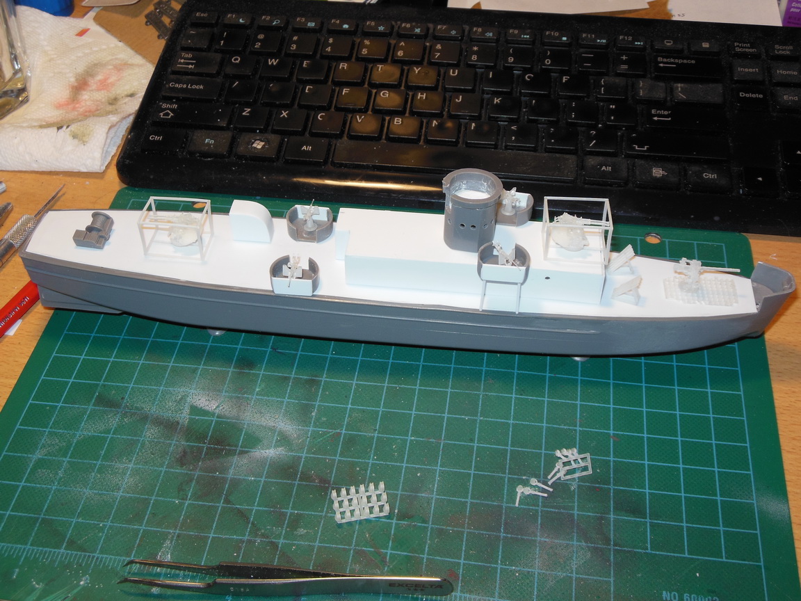

File comment: Test lay out once I started getting in the guns and fittings from Shapeways

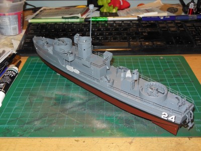

File comment: Paint and decals applied...
