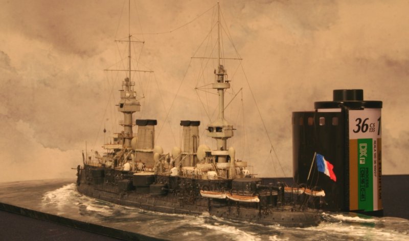

you can have a look here at my tiny model
http://www.modelwarships.com/reviews/sh ... eview.html
I also have a few images of a fine Cerebrus model built by David Abbott-
further assorted images can be found in E Pinningers build thread -linked above.
