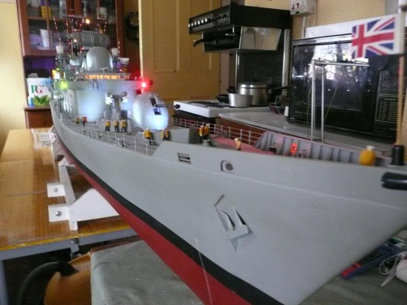

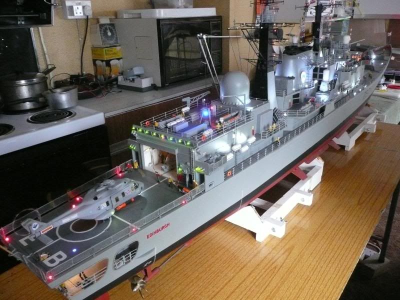

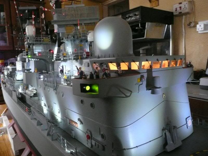

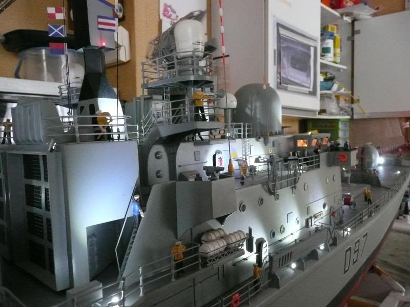

Hi all i am a newbie an this is my first build post on this forum an its HMS EDINURGH scratchbuild in 1/64 semi scale an i have used a bit of moddelers licence on the lighting as this is a working model but i hope you will like it just a few pics to start

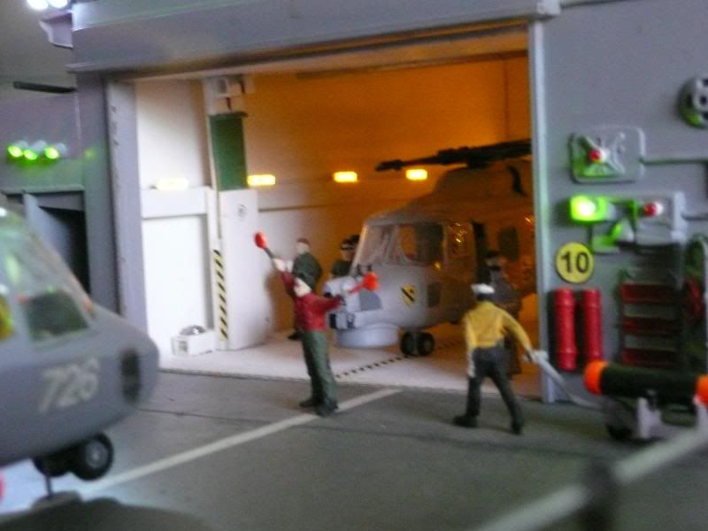

helideck
hanger bay
chris

:big_eyes: :big_eyes: :big_eyes:
Holy crap that is awesome!!!! More pictures please and step on it!

HI Cliffy B yes i will post more of the edinburgh floodlit pics an thank you for your comments an i will post the scrathbuild of edinburgh if anyone would like to see it

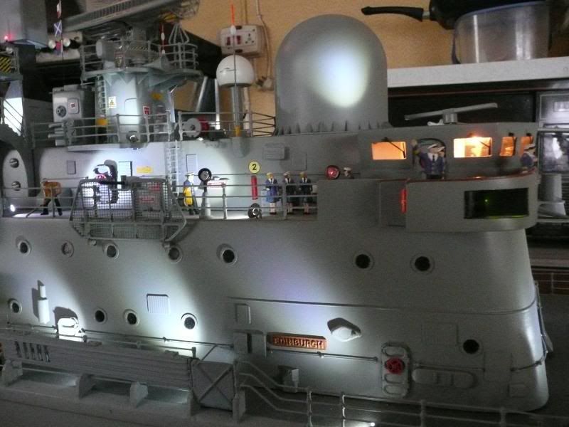

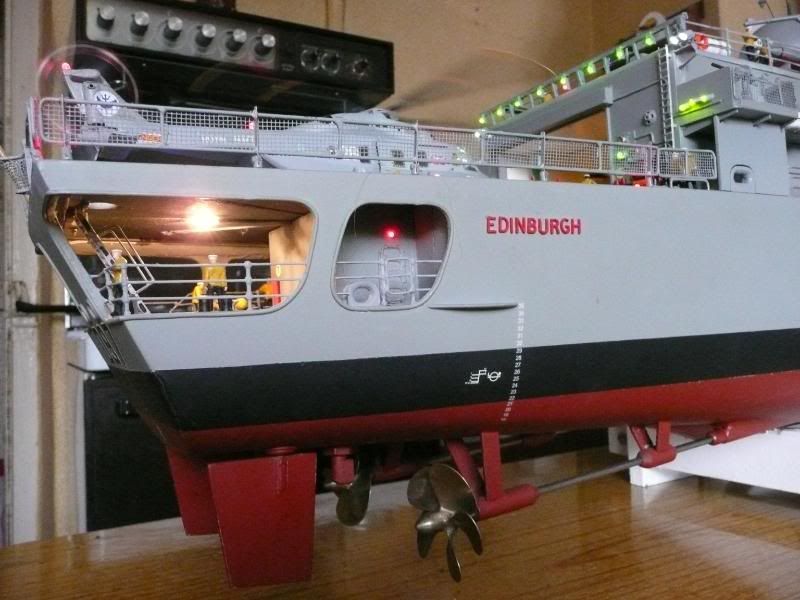

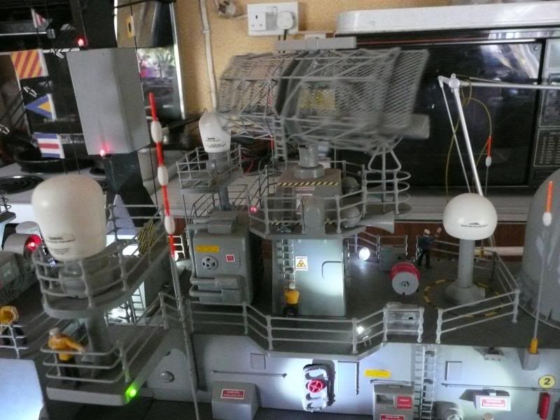

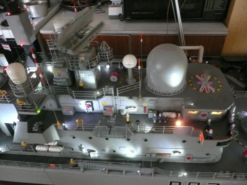

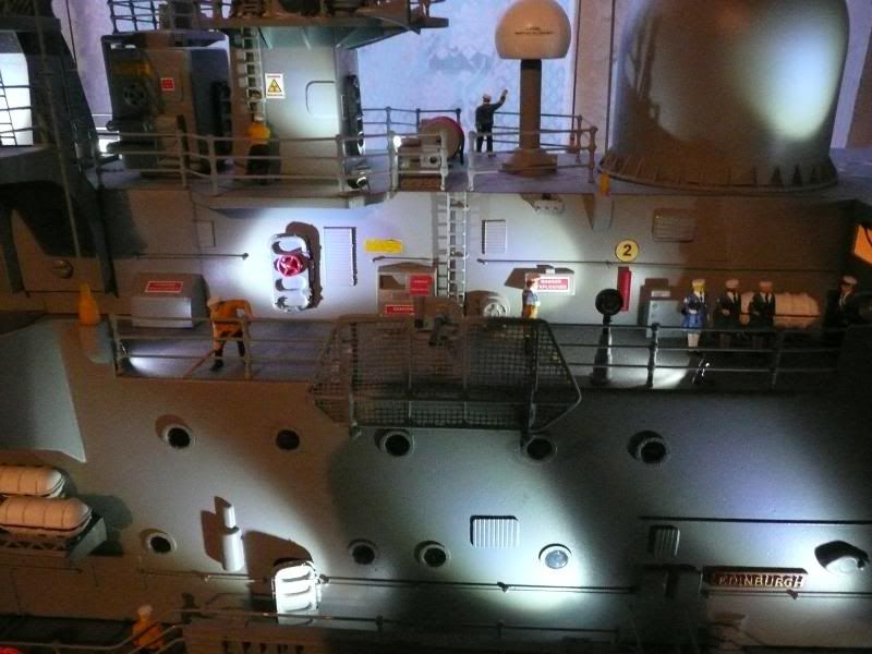

more pics of her floodlit

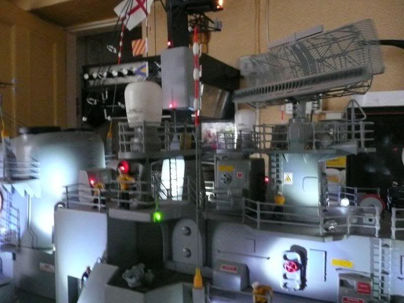

main radar

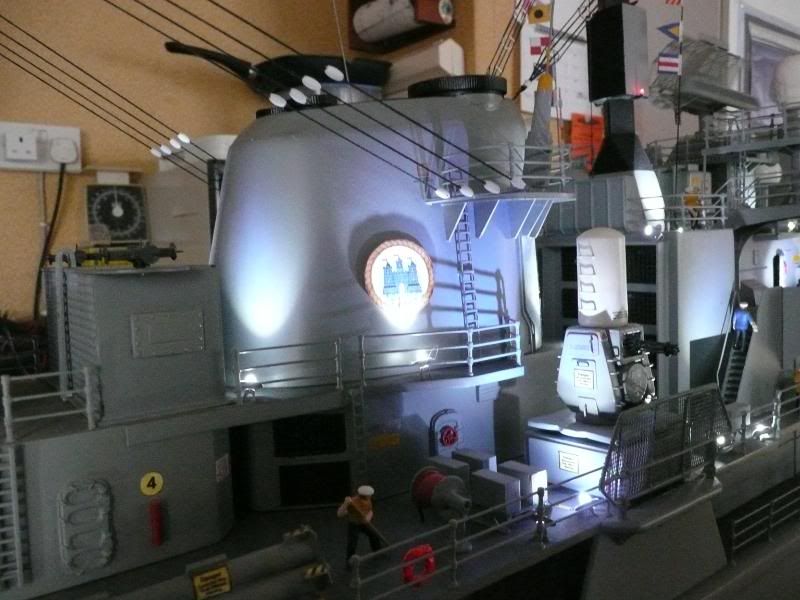

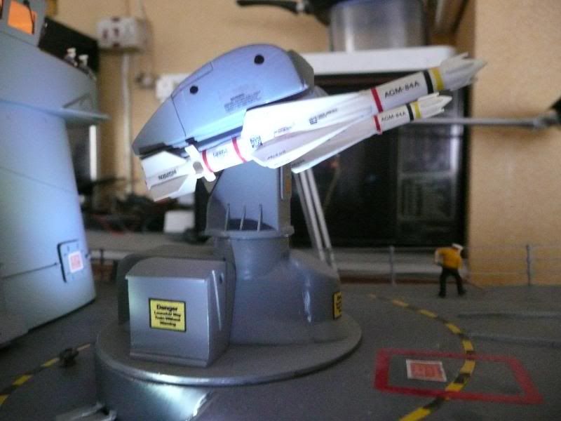

seadart launcher an missles
PostPosted: Tue Apr 20, 2010 6:03 am
Joined: Thu Apr 17, 2008 5:11 am
Posts: 106

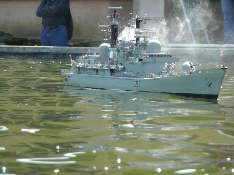

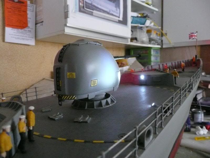

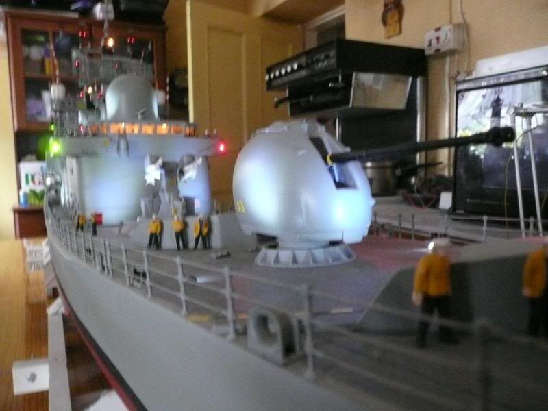

main gun
overall shot of her
an sailing underway up local pond
hope you all enjoyed these pics an i wil post the scratchbuild if anyone would like to see it ?

OK Guys gimme a couple of days or so to upload the build of her to photobucket an then i will post the build on here an i will try an answer your questions about lighting an the smoke unit as best i can

One thing I noticed though, the Sea Darts have lettering indicating they are AGM-84A missiles IE, Air Launched USN Harpoons. Just wondering.

Cliffy B wrote:
Looks great man, top notch! :thumbs_up_1:
HI Cliffy B well spotted on that she has been to numerous shows an on a web site forum over the last 3yrs or so an only one other person noticed it (DAMM I BOUGHT TO GOOD A CAMERA AN IT PICKS OUT THE DETAILS TO WELL :big_grin: ) Now i will tell you how that came about i scratchbuilt the seadarts missles from some harpoon missles off an old aircrarft kit an used the decall's from them
as they are so tiny an its a hard job gettin the right decall's so needs must as they say how's that
chris

Good enough man :heh: Lord knows we've all done that now and again, its all good. I doubt too many will actually notice it.

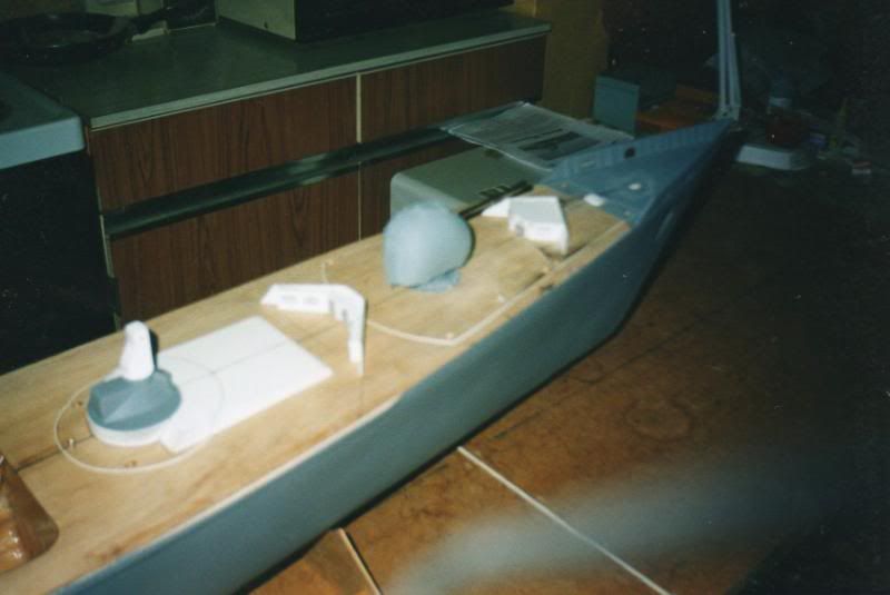

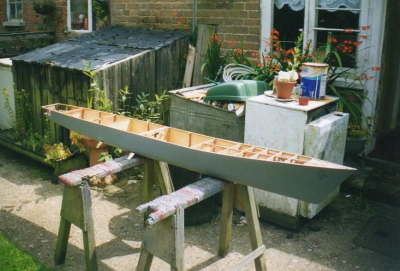

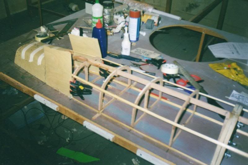

hi guys well here we go on the build

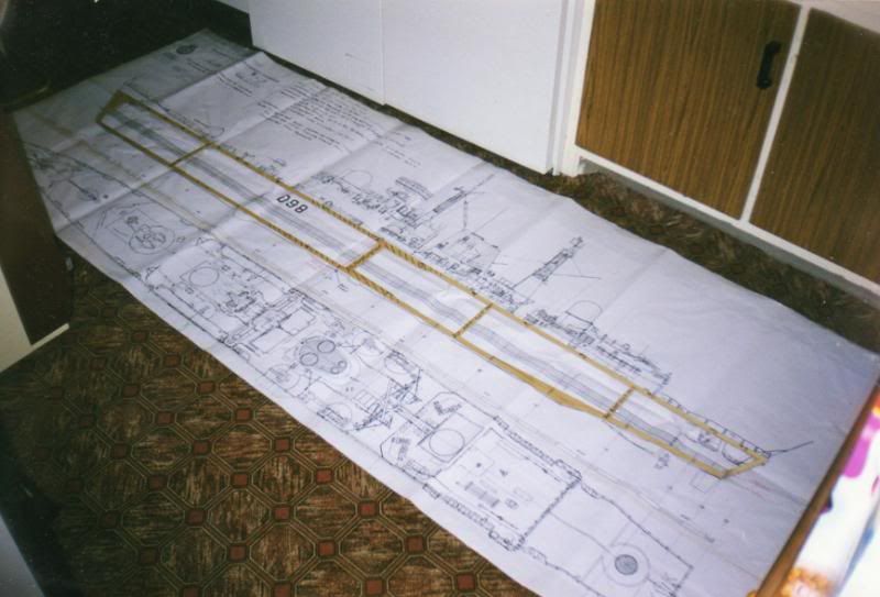

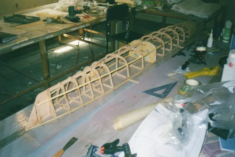

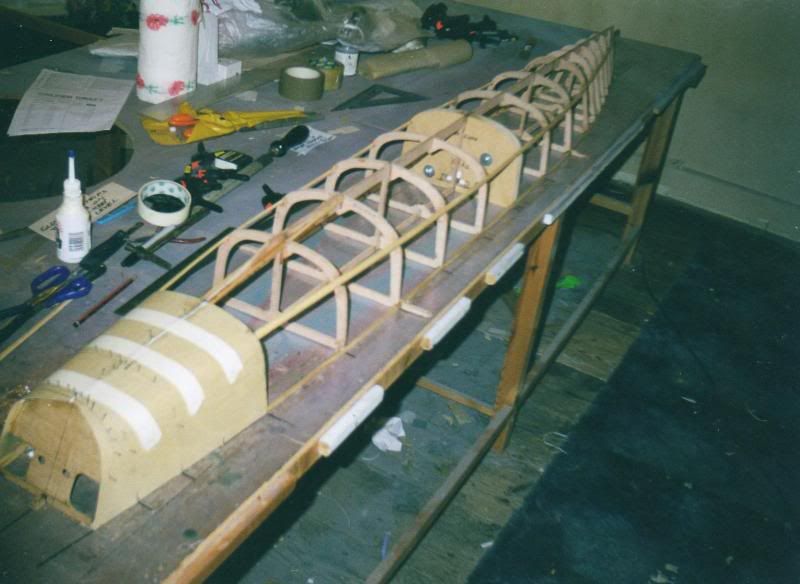

keel cut out

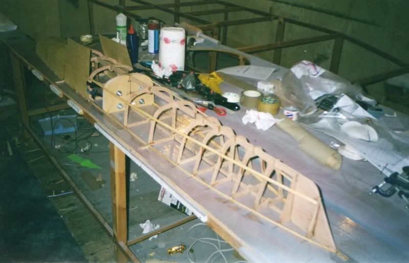

keel laid with hull frames an screwed down to board to prevent warping

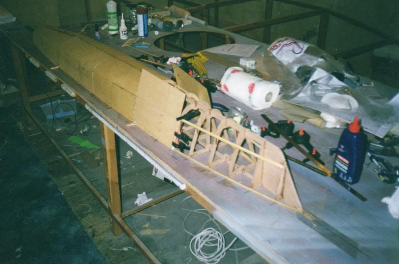

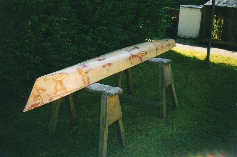

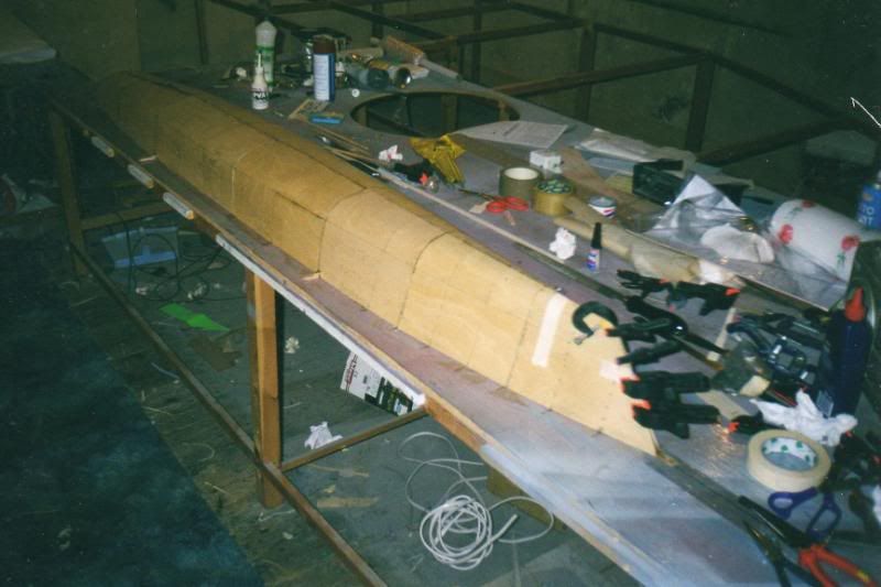

here now ive started to cover hull in 1/32nd plywood wrapround as i call it i have done this on all my builds that are in wood an then lined inside with F\G
glueing the bow
more to come
chris

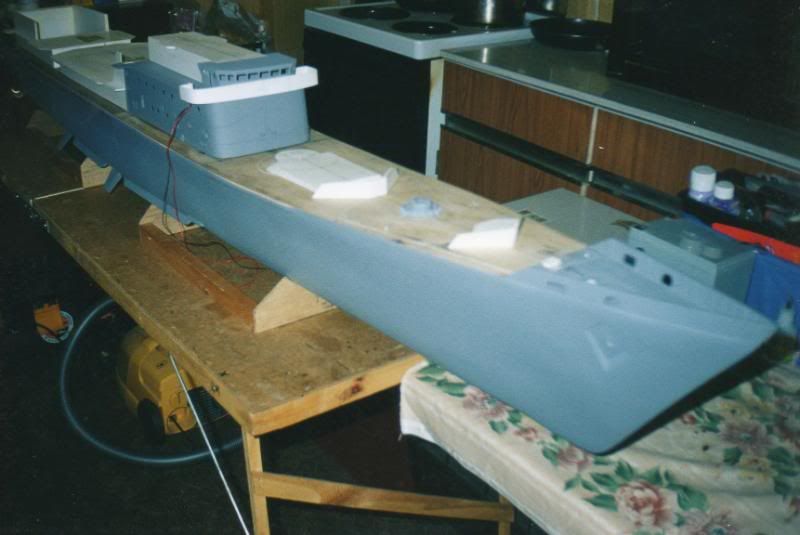

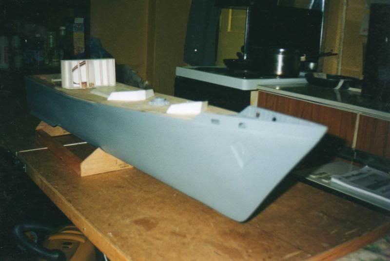

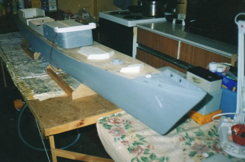

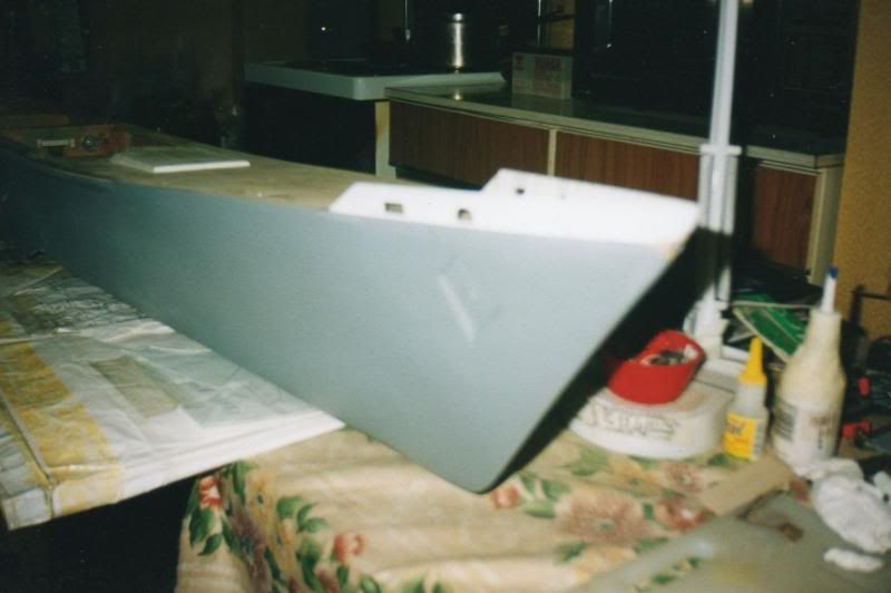

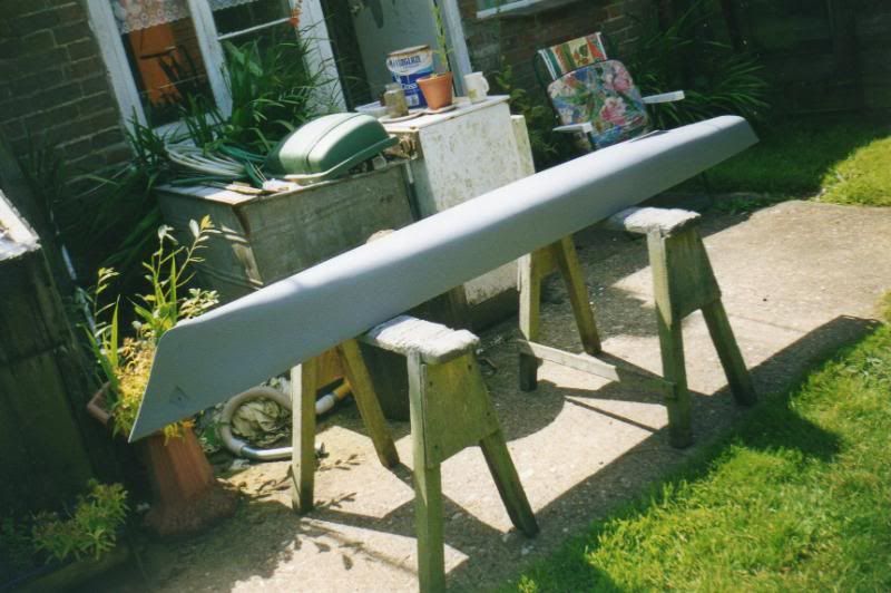

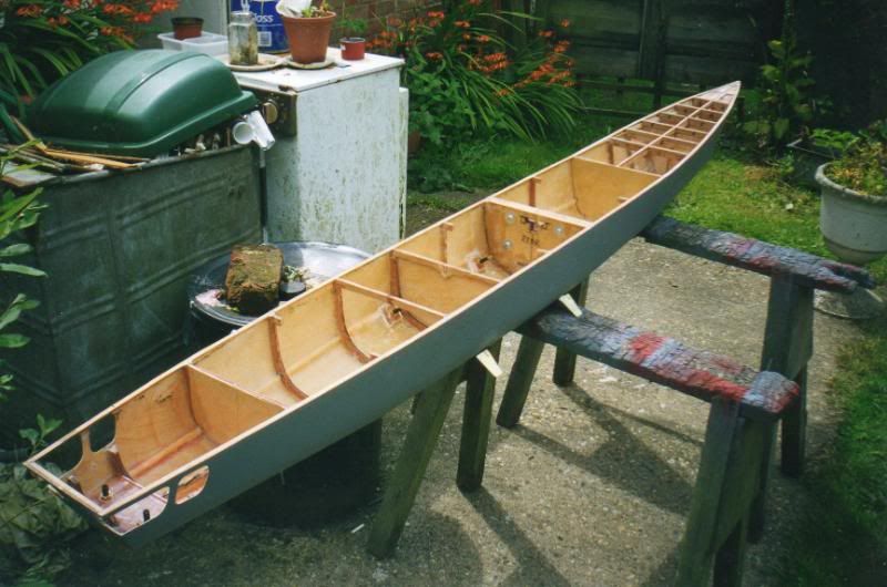

hull sanded down an sealed with sanding sealer for a nice smooth finish
hull sprayed in grey primer to show any cracks to be filled with plastic wood filler
curved bow fitted
working stabillizers fitted these are made from large rudders an cut to shape

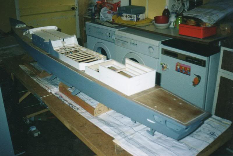

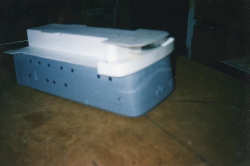

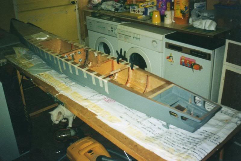

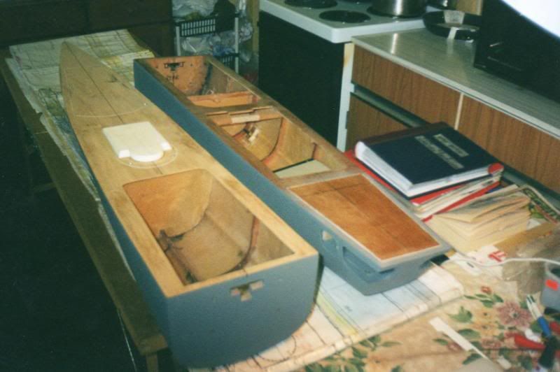

hull cut in half for ease of transpotation

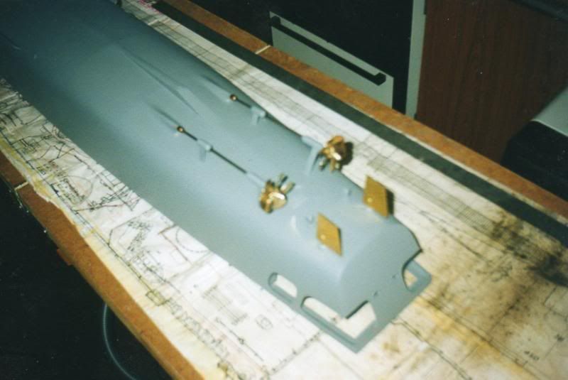

fitting sharfts
both sharfts an ruddres fitted

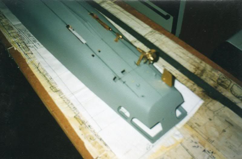

here just fitted the bullwark edinburgh was the only batch 3 that had this fitted it was put on to keep the deck dry as poss as she had a phalnx gun mounting fitted between the seadart an the main gun

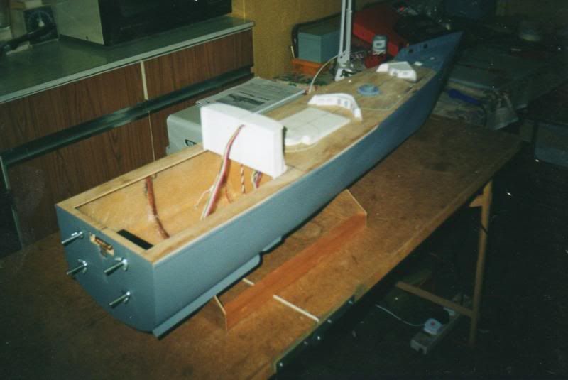

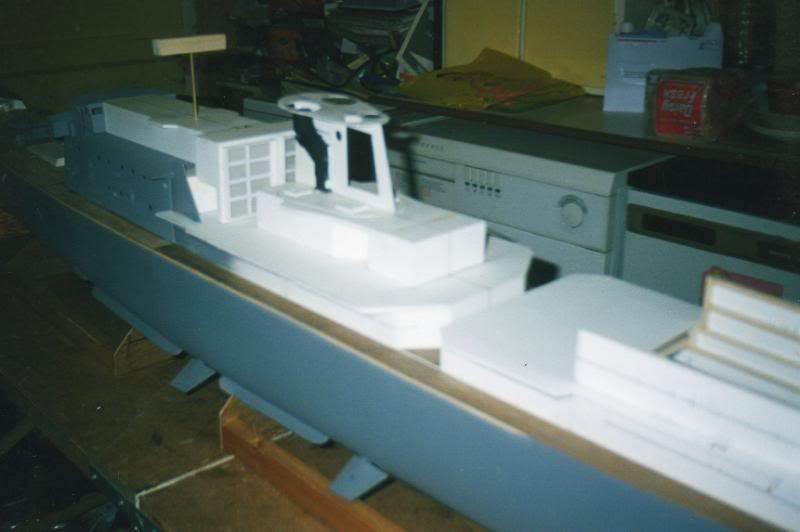

detail goin on
PostPosted: Thu Apr 22, 2010 4:08 pm
Posts: 106

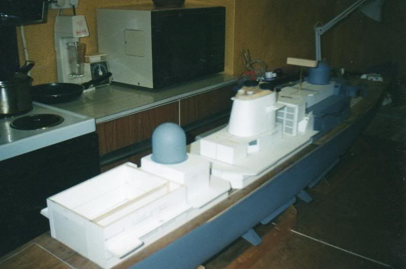

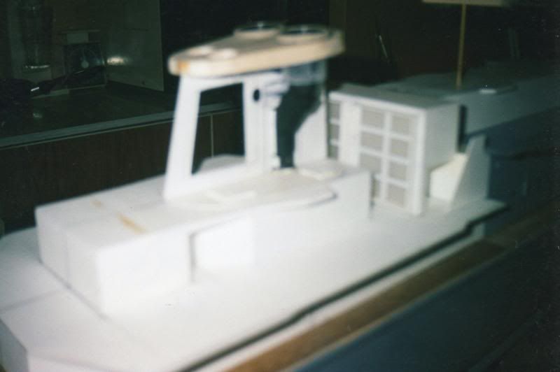

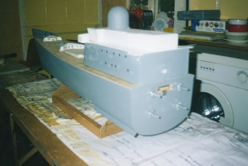

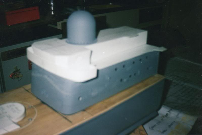

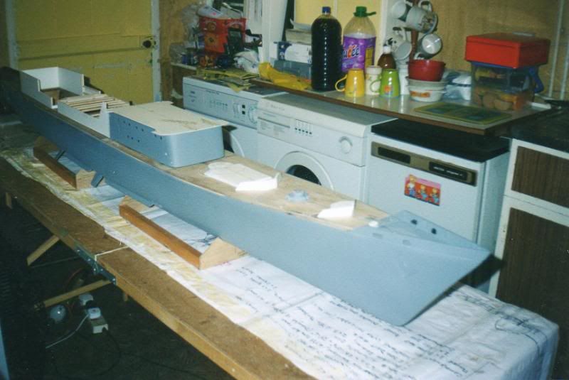

S/S now started
wireing being fitted in S/S
BRIDGE S/S underway
i think its a type 909 radar dome now made (i made this model about 6yrs ago)
shot of the hull jiont

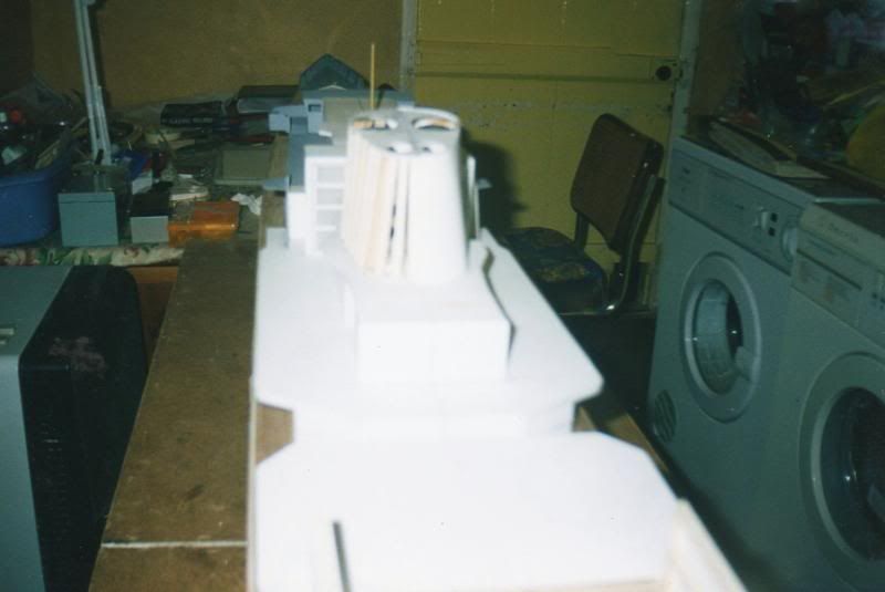

painting S/S in progress

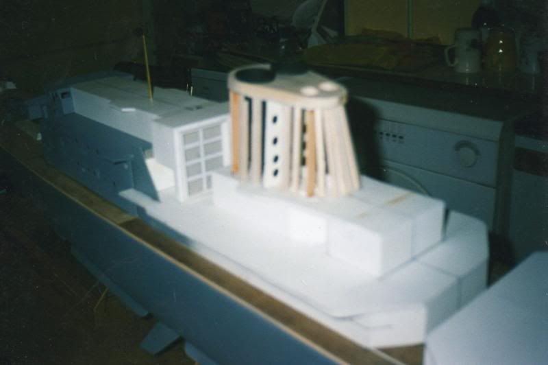

funnel build underway
a funnel uptake tube is fitted as this model will have a smoke unit fitted
beginning to build funnel in
half way there
an covered
more to come
